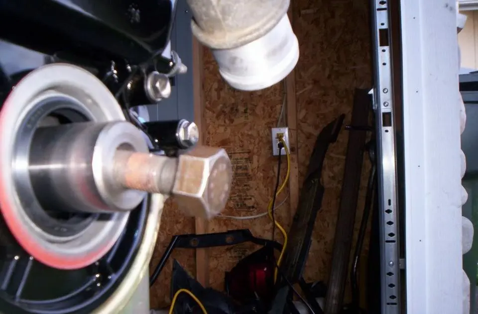

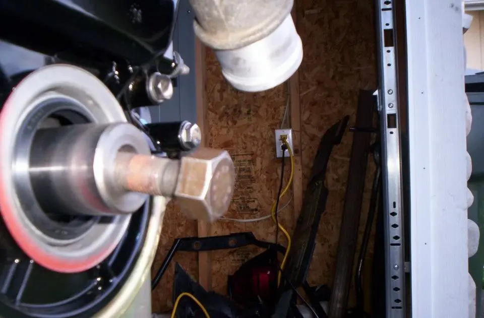

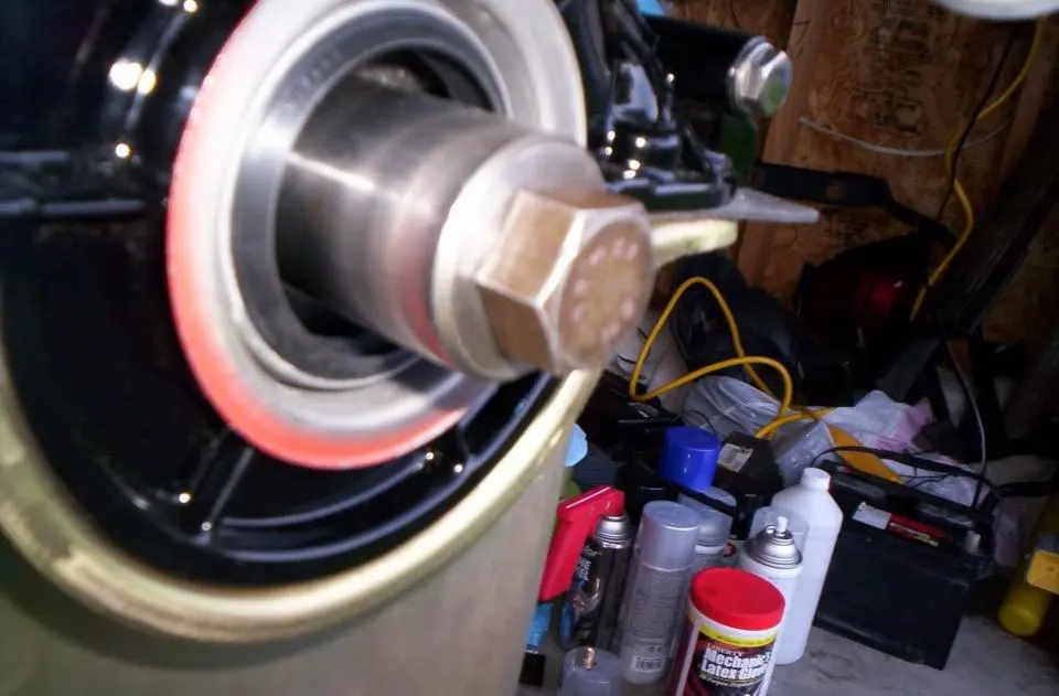

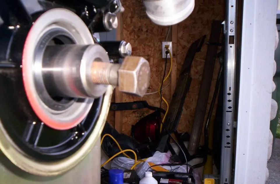

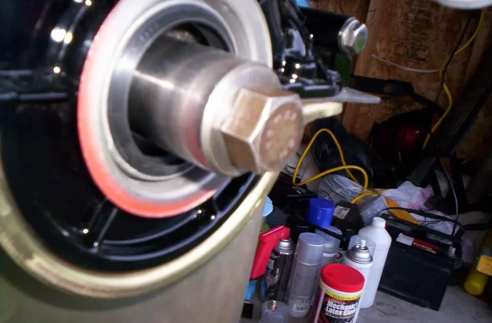

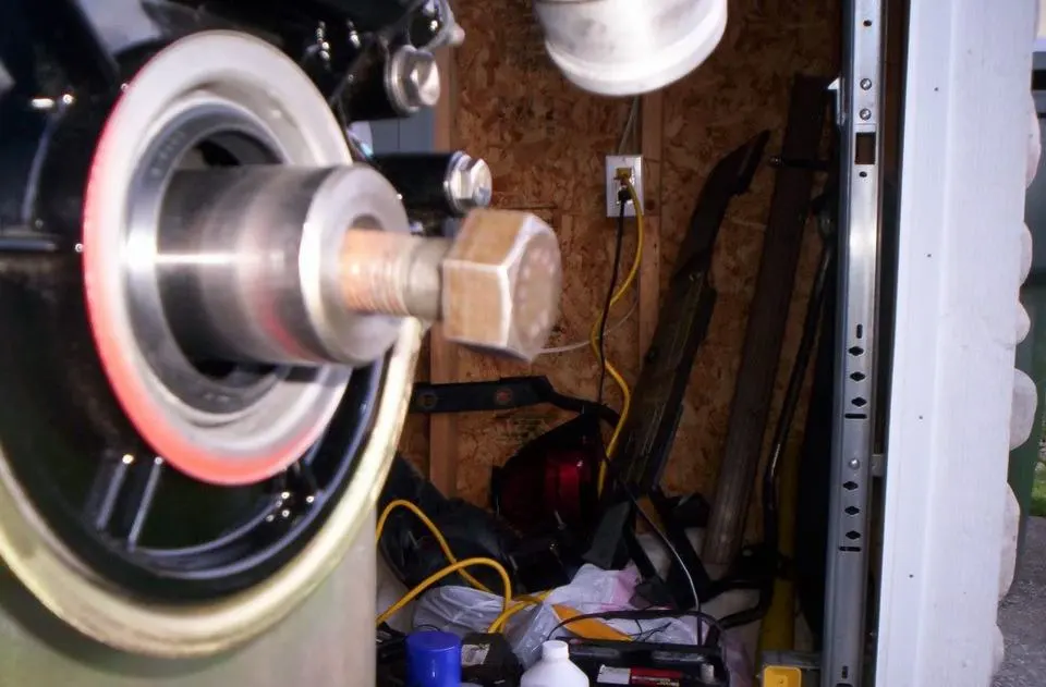

Here is a Pic of the major issue, as you can see the Balancer bolt that I got from the same engine building shop is half way in the hole, yet is just hanging there. THis is due to the fact that I can push the bolt in and out without a single thread blocking my path.
I was told that:
"In 40 years (name of shop) never seen this, in hundreds (or thousands) of cranks, I haven't seen it and Scat says that they've never had it as an issue. So if it's a problem on this one it's as odd as it gets."
So if this is true, either 1. I REALLY need to start playing the lottery, or 2. Its not the correct crank.
Well anyway's I was told that I need to load the engine onto my truck and drive it over to the engine builder so he can see what the problem is. Me and my wife tried to load the engine today, but it was too heavy for her to lift off the ground. And since this shop is only open till 5pm and only on weekday's I have no clue how Im going to get this block there, since all my friends work until 5pm or later also. Anyway's enough of my b i t c hing, I am just really frustrated about the whole situation.
Thanks for listening, Im sure everything will work it's self out in the end.

Mongoose said:
Will, When the engine was in the shop getting balanced, didn't they have to have the balancer installed on the crank?
Roger
You would think so, but I honestly have no clue. This whole engine is brand new from the Dart block to all the enternal's. I have been to this machine shop when I went and got the balancer bolt, and he has a shop full of machining equipment, and everything is done there from what Im told.
Will

Will already has a proper balancer bolt. That is the issue. The proper part does not fit. He bought one from that engine builder and he also went to a JY and grabbed a stock one, they are both too small.. Will also does not live more than 10-15min from the shop that built the motor and it is supposeldy THE premier ford motor shop. SO a Home visit I think should be a no brainer given the $$ that was spent on this block. That or you can pay my lawyer when I shove the motor up your a55 would be my point of view. I will not say who it is as he has for now decided not to name them, but I would be very very pissed if I was him also. Given that the Crank MFG does all thier cranks the same via machines and has never seen this that points to two things, it is not the right Ford crank, or the builder modified it....

If you read Will's first several posts in this thread, you will see that he says the shop built the engine. He also says that this problem was found when he had the engine home and was trying to "put it together." I may be wrong, but I took that to mean that the shop built the long block, and he was putting his balancer and other miscellaneous pieces on(pulleys, etc.). In this case, the machine shop seems to have the right crank in, for his chosen displacement. They likely installed the wrong part number, but haven't yet figured out if they grabbed the wrong one, or if Scat sent them the wrong one.
Let's say I have a dart blocked 347 being built for a procharged car running 29psi on C-16. Because I know what I am doing, I may ask scat to give me a crank with a BBF snout, as opposed to a SBF snout. This will help prevent me from snapping off the end of my forged crank, as my blower puts horrendous amounts of pressure on the crank snout and bearings. For this, Scat may use a larger, deeper fastener to further aid in providing added strength to the end of the crank.
Now that you know there are multiple part numbers and variations on part numbers floating around machine shops and manufacturing facilities, you may see the "house call" issue differently. Most machinists, plumbers, etc. know rough thread styles and sizes when they see them. As a master engine builder, one could probably tell fairly accurately, what fastener is actually needed for the end of Will's crank(instead of assuming it is stock and being too lazy to look). Once he has done this, he can begin to sort out what crank was actually used, or whether the correct crank was modified at some point by Scat. In order to do this detective work, it is fair that he travel fifteen minutes to Will's house to view the damn thing. Hopefully, the solution is to simply give Will the correct bolt(once he figures out what that is).
Everyone on this forum knows how the aftermarket works, as we are all enthusiasts who have modified vehicles. We also know how the aftermarket SHOULD work, but sometimes doesn't. I am confident that this builder will get things squared away.
If you use your theory, which sounds very likely, wouldnt it be more efficient to call Scat who built the crank and see what they use for a crank bolt? The bolt sitting in the crank doesnt look quite right to me...has it been tried in a stock crank? Again, its not the builders issue- its the people that machined the damn part. Let them figure it out. :nonono:
I know your engine builder-not personally, just his reputation- and I think it is completely rediculous to blame this on them. IMO your gonna look pretty silly when you find out you were simply not using the correct bolt. :notnice:
