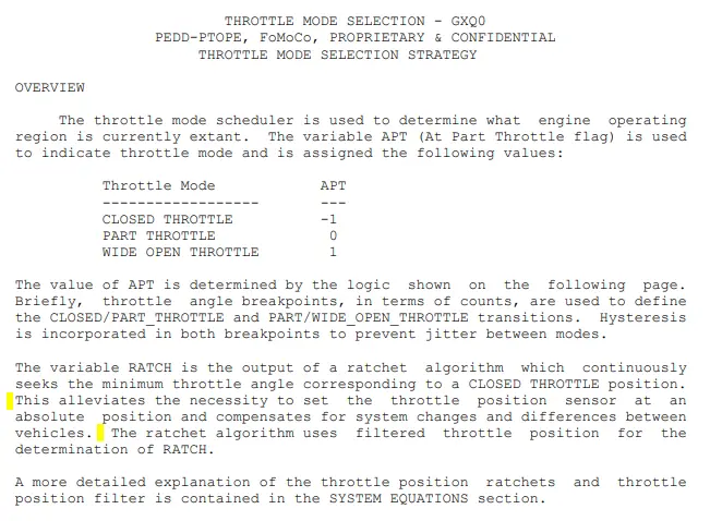

EDIT: This post applies to 86-93 5.0 Mustangs.
Seems to be a common myth, so lets sticky a thread explaining how the TPS works. Jrichker has provided the basic TPS guideline to follow. But here's a snip of the A9L GUFB which is the programming logic. This is a Ford internal Doc (don't ask how I got it)
Pay attention to the part highlighted in yellow. I've posted a few more snips of the ECU GUFB related to TPS strategy in post #42 that highlight the ladder logic.
So with that said, adjusting your TPS to .99999999 volts is not necessary at all. The ECU has a logic to account for variations due to production assembly. The TPS is not adjusted at all on the assembly line. There is a general range the computer will accept as idle voltage for the TPS. This range is 0.5 - 1.25 volts. ANYTHING within this range is acceptable, and if you notice, the range is quite wide.
If idle voltage is outside this range, a TPS code is generated by the computer.
Code 63: Throttle Position Sensor signal too low (under 0.5v)
Code 53: Throttle Position sensor signal too high (over 1.2V)
Code 23: Throttle sensor out of range (with engine off)
Therefore, the only adjustment really necessary is to verify the tps voltage at idle is anywhere between the above range. If this is a FORD OEM tps, it should be. Aftermarket TPS's might be different and require you to slot the holes to get it in range. If it is in range, then you are fine. No need to chase the mythical 0.99 volts that has been tossed around for years. Upon vehicle startup, the computer will take the base idle voltage, and apply a certain voltage value to that number as the trigger point for WOT operations. I've seen 2.71-3.13 throw around as the value increase over baseline idle voltage as triggering WOT. The value is adjustable and can be changed by tuning
To make a long story short. If your idle TPS voltage is anywhere between 0.5V and 1.25V...you are good to go.
