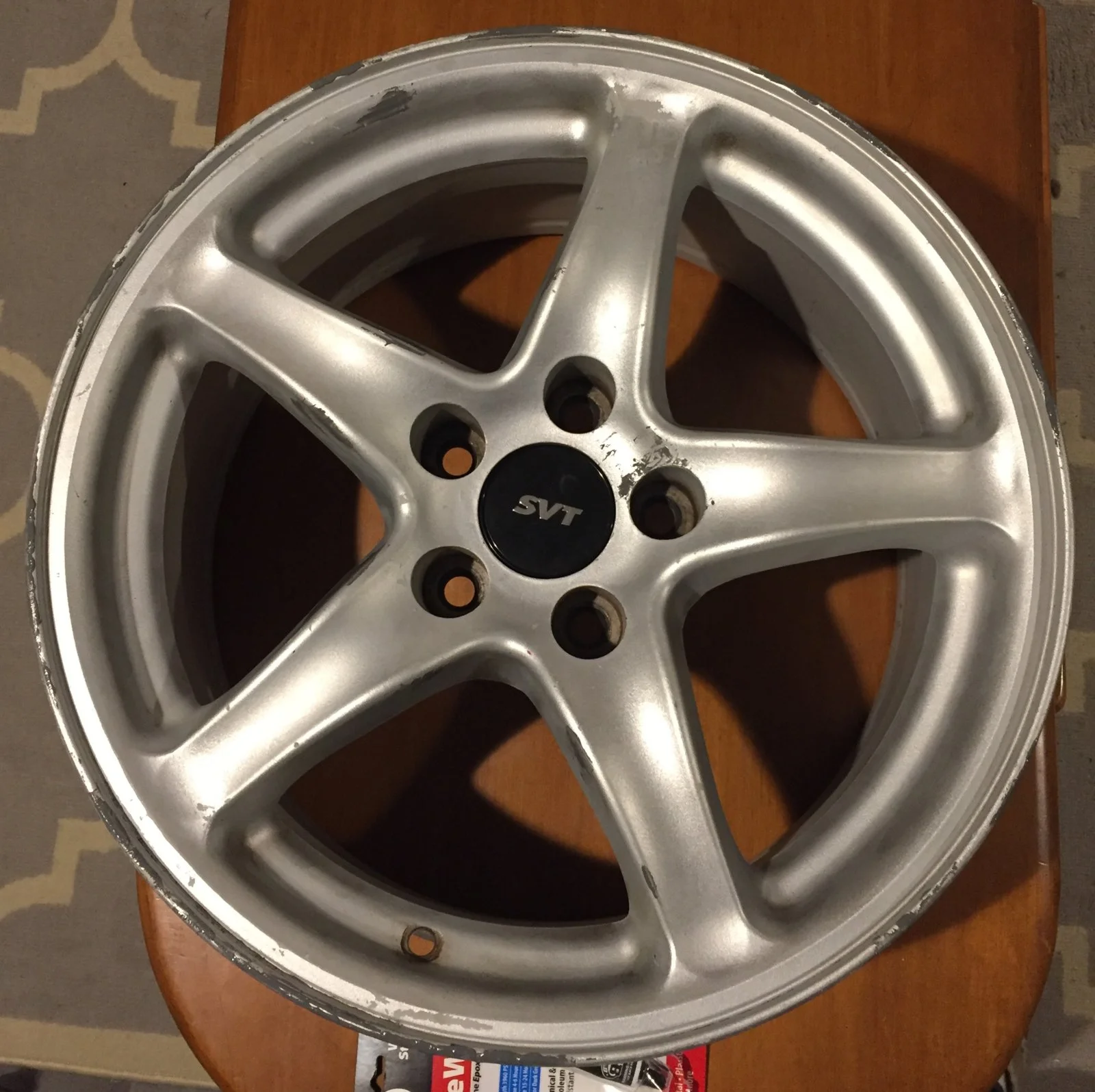

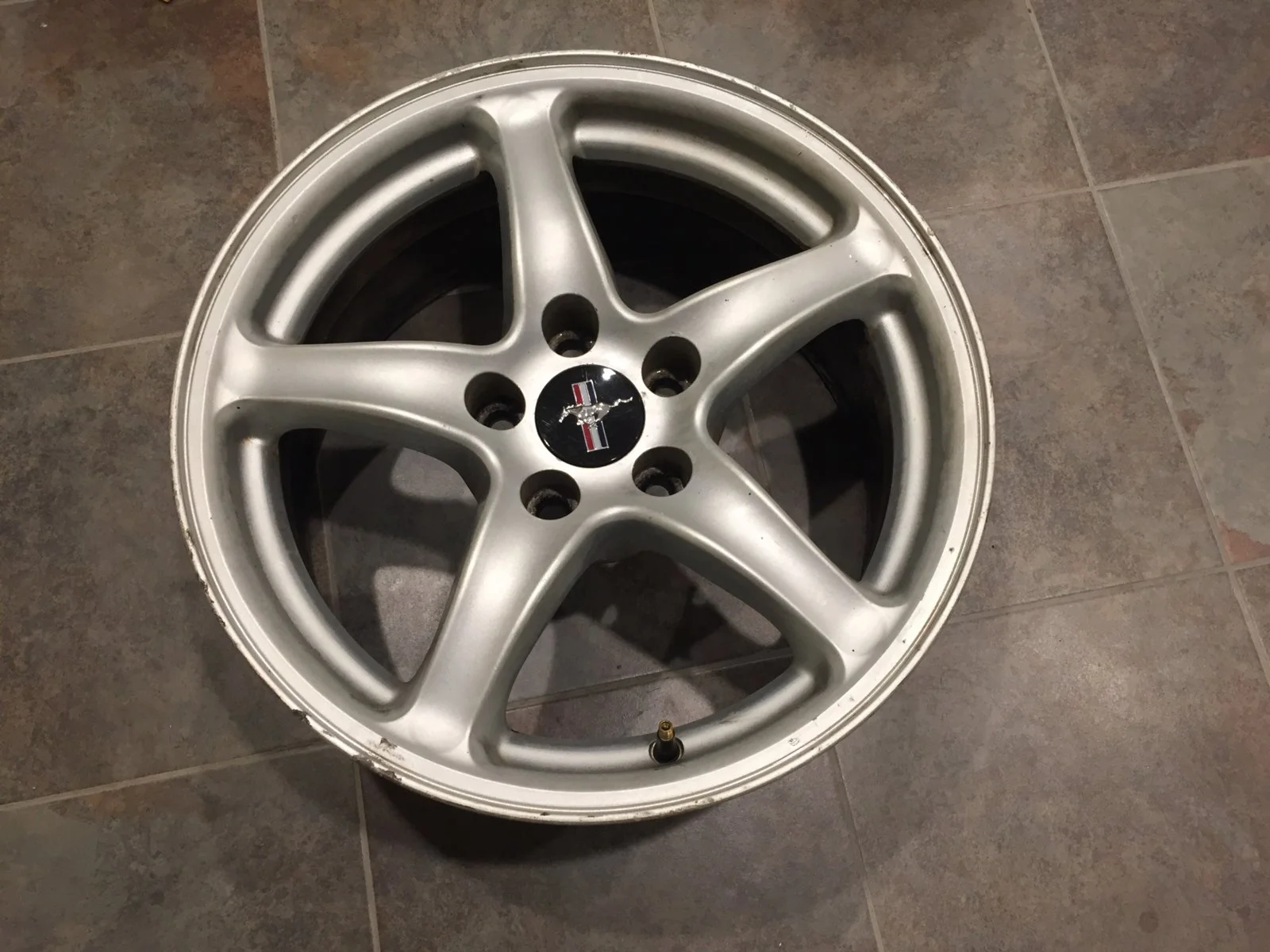

Picked up a set of '98 Cobra wheels. They need a little TLC so this thread will detail my failures and successes of restoring them back to somewhat like new condition.
Restoring a set of argent 91-93 pony wheels should be same process...if you didn't want to buy a new set

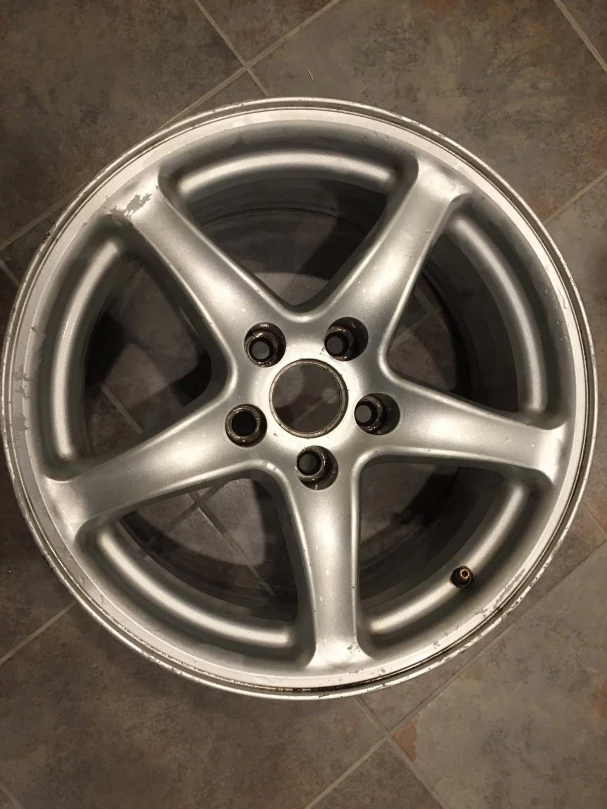

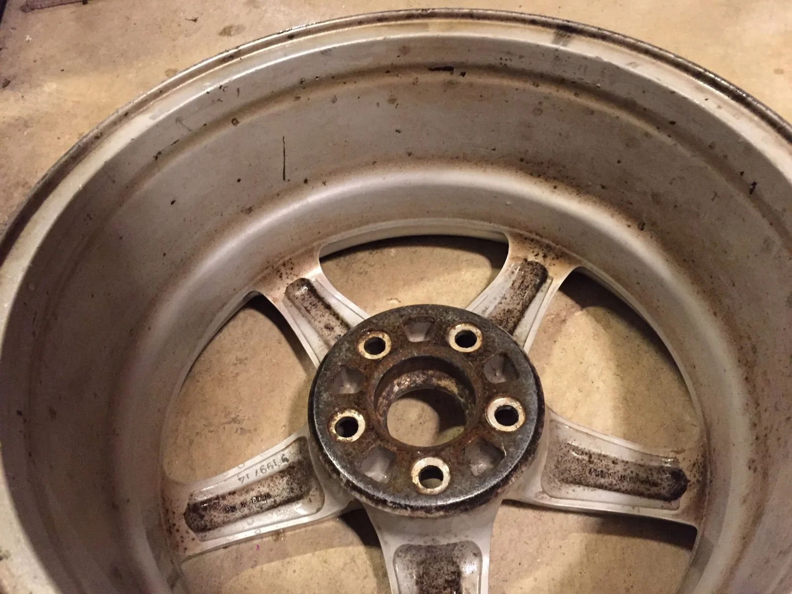

The subject wheel. Greasy, covered in red brake dust/rust with some minor curb rash

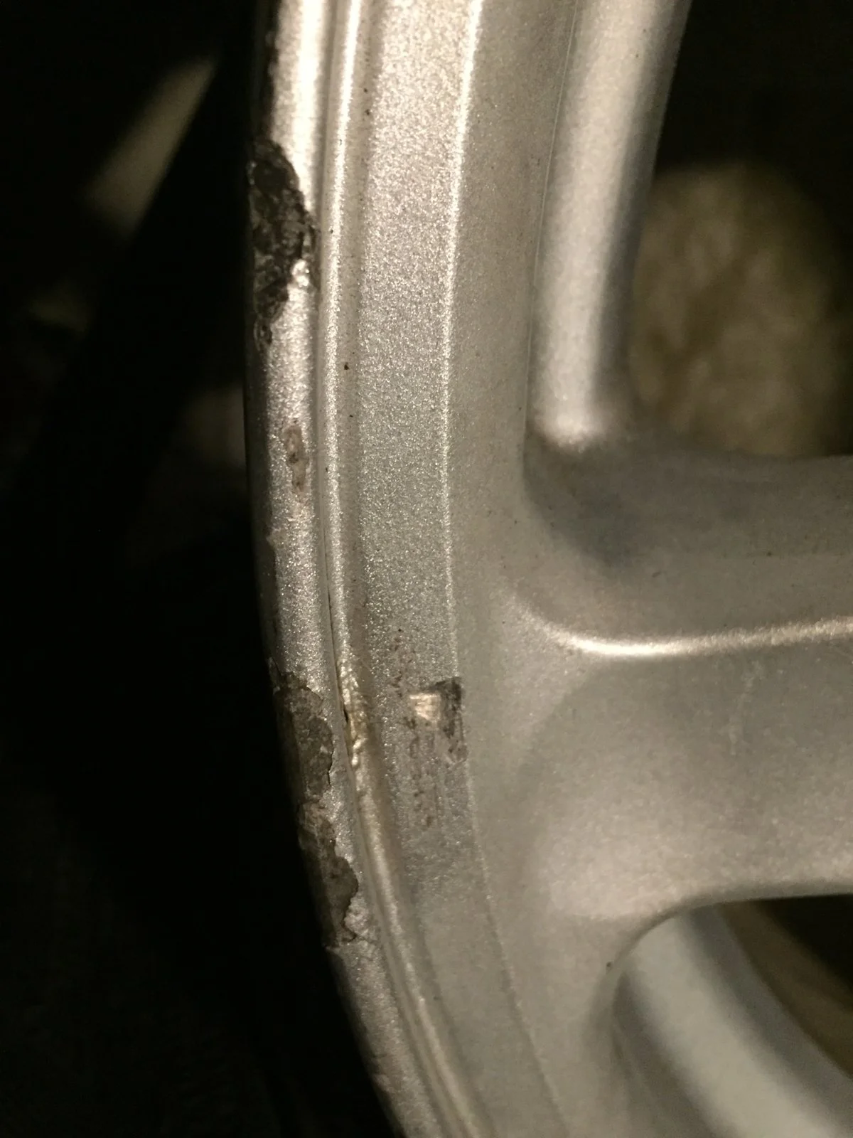

What it needs the most is a fresh coat of paint, but I'll need to fill and sand some minor rash areas like this

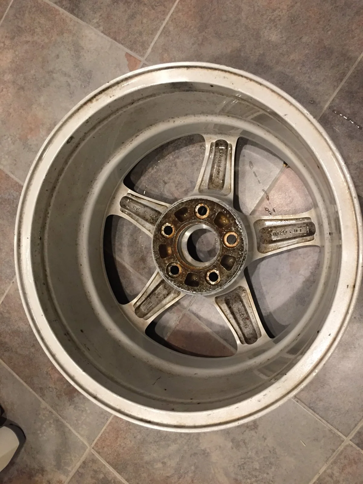

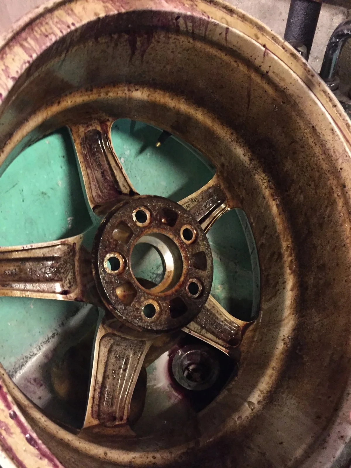

First up, cleaning. Quick powerwash followed by a cleaning with Iron-X which really does a good job breaking down the brake dust. Then a hand sand with a sanding sponge on the barrel and inside and scotch brite on the face
Iron X application
Much better
After initial sanding. Not going crazy here just wanted to clean it up a tad before i try to repair the rash

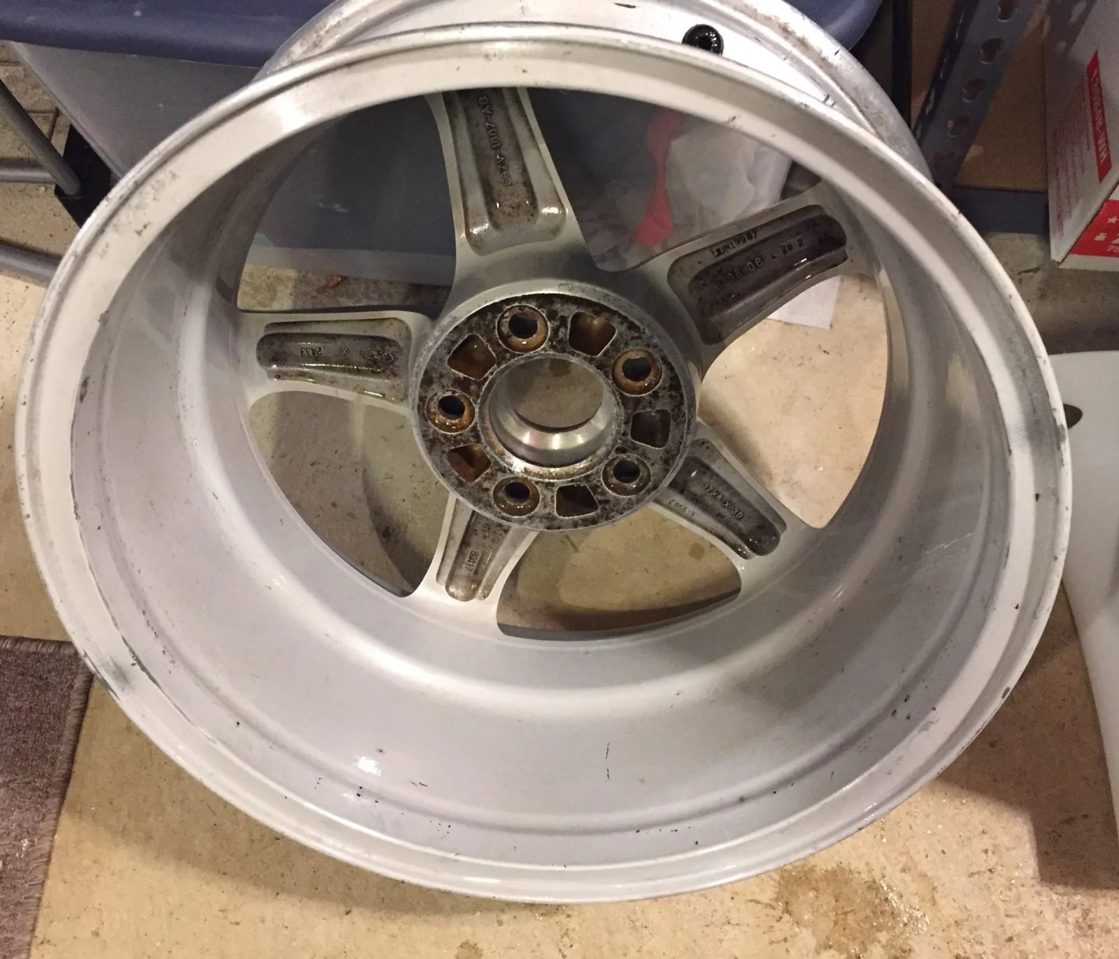

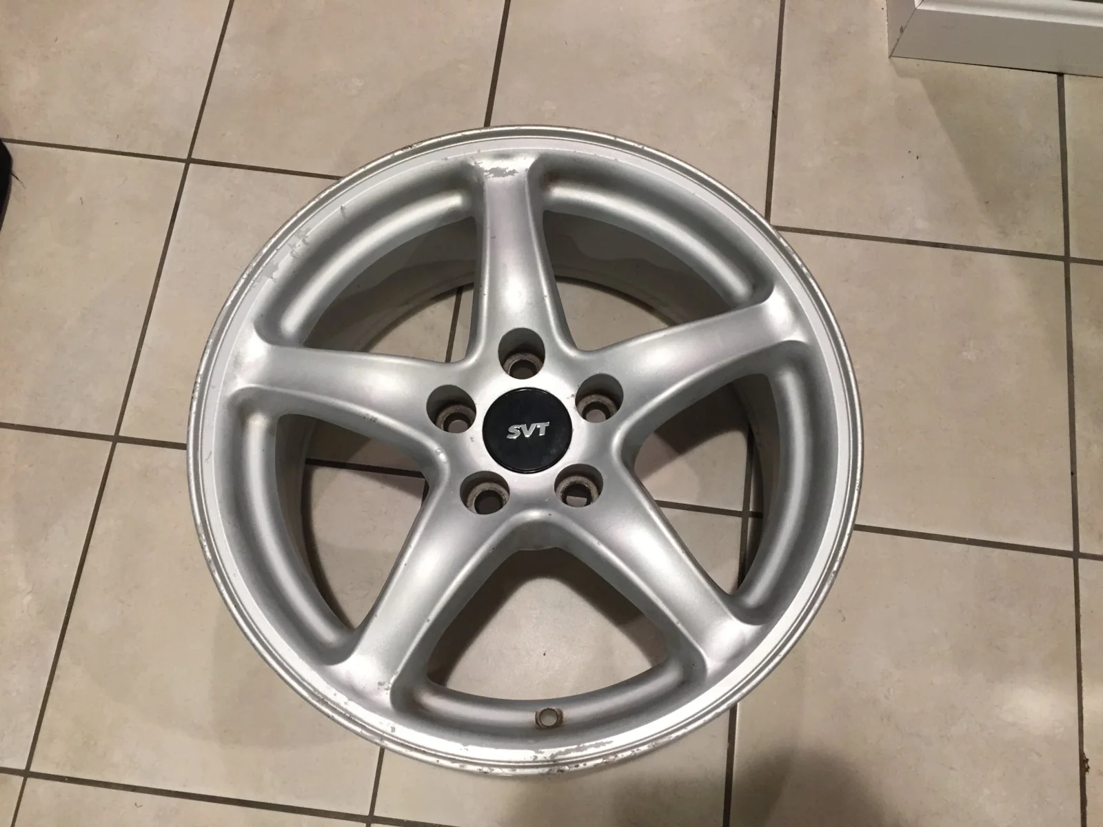

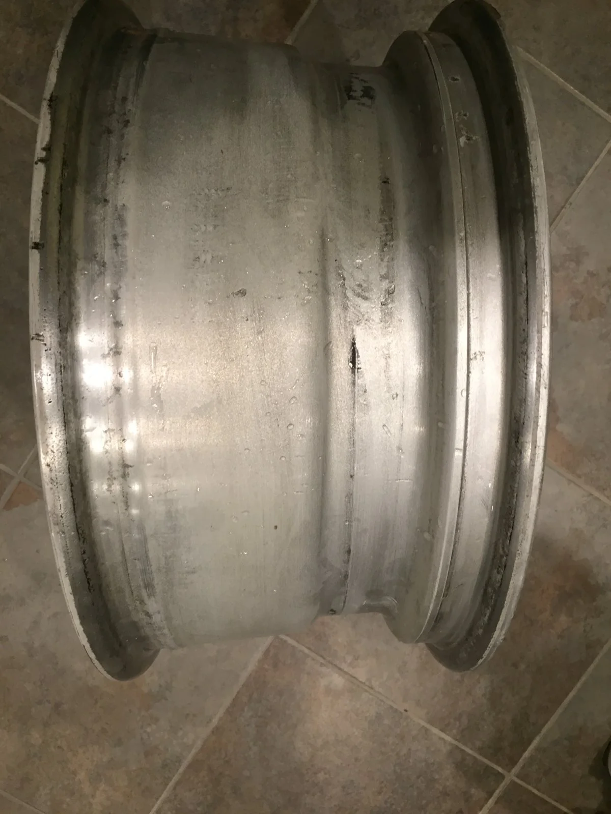

Rainy night here, so I spent a little time on some additional sanding on this rim
I used scotch brite on the face of the wheel, and a sanding block for the barrel and inside portion. Did it in a slop sink with some water and spent maybe 10-15 minutes to get it to this point. Just need to find a tool to get inside the lug holes.

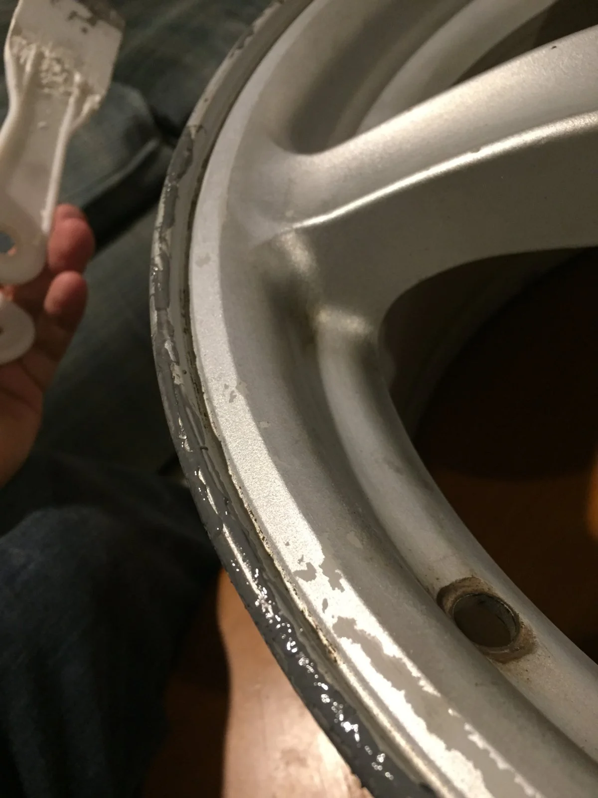

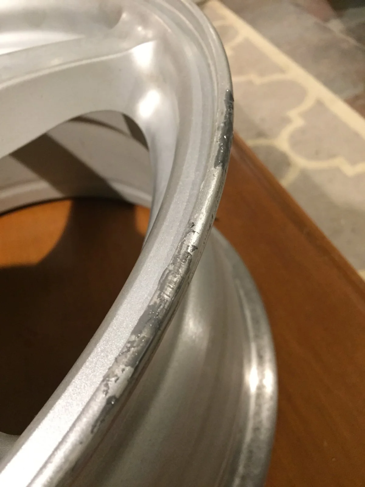

I used Marine HB weld as filler. I went with the "less is more" approach and put on as little as possible to repair the curb rash and some dents in the spokes.
Finished and set aside for 24-48 hours to fully cure. You can see I didn't do much to this wheel, just the edge and a few small spots

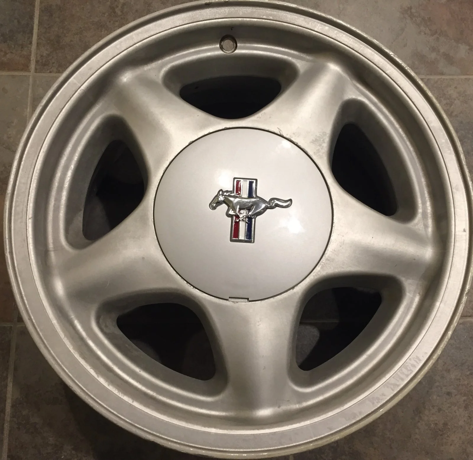

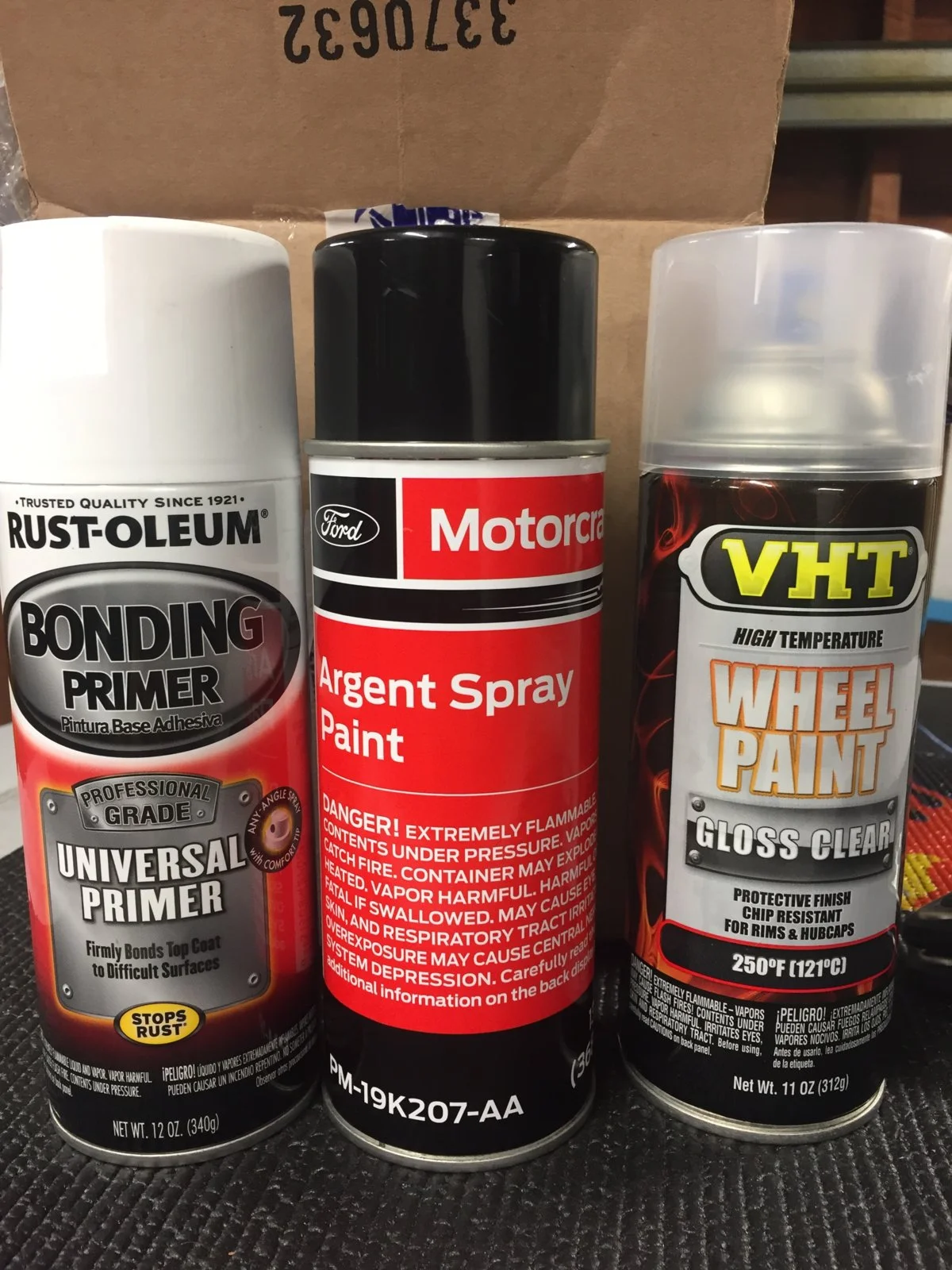

The paint supplies. I'm curious to see how this will turn out so I decided to try a test wheel first. I want to know if I even need clear with the Motorcraft paint

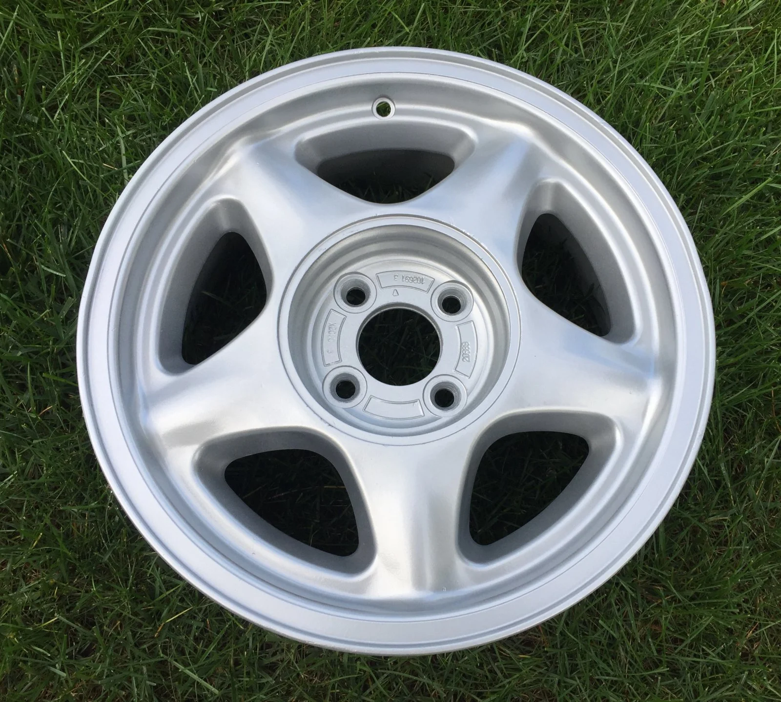

Subject test wheel. Decent wall-hanger pony wheel with faded paint and a new, NOS (of course) center cap. Could use a fresh coat of paint.

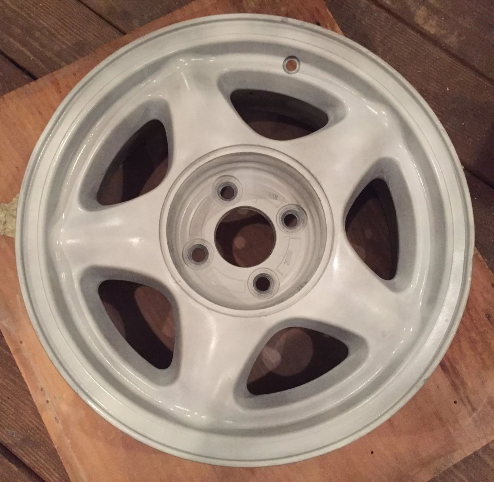

No real prep was done to this wheel. Didn't even scotch brite the surface. I just want to see how the final product will look.
Thin coat of primer.
Tomorrow is set to be very humid, so I may delay a day or two to spray the Motorcraft argent paint on. I want to make sure conditions are right

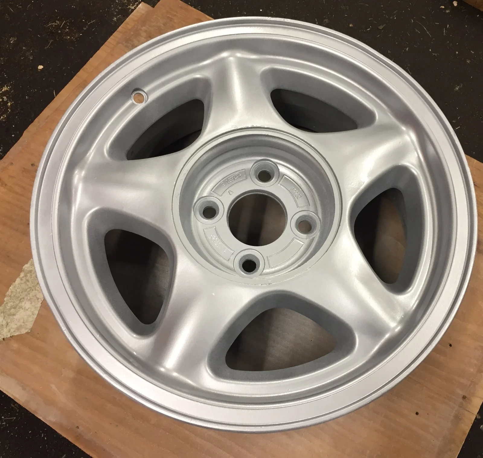

First coat of Motorcraft Argent paint. Pretty good paint. Goes on nice. Color matches the center cap very well. This pic below is pretty accurate to in person
I'll do another thin coat in the AM and then decide if I want to do the clear coat.

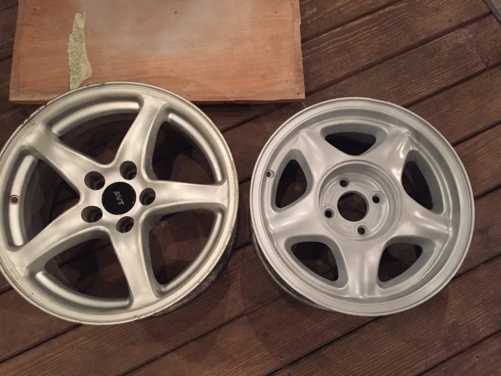

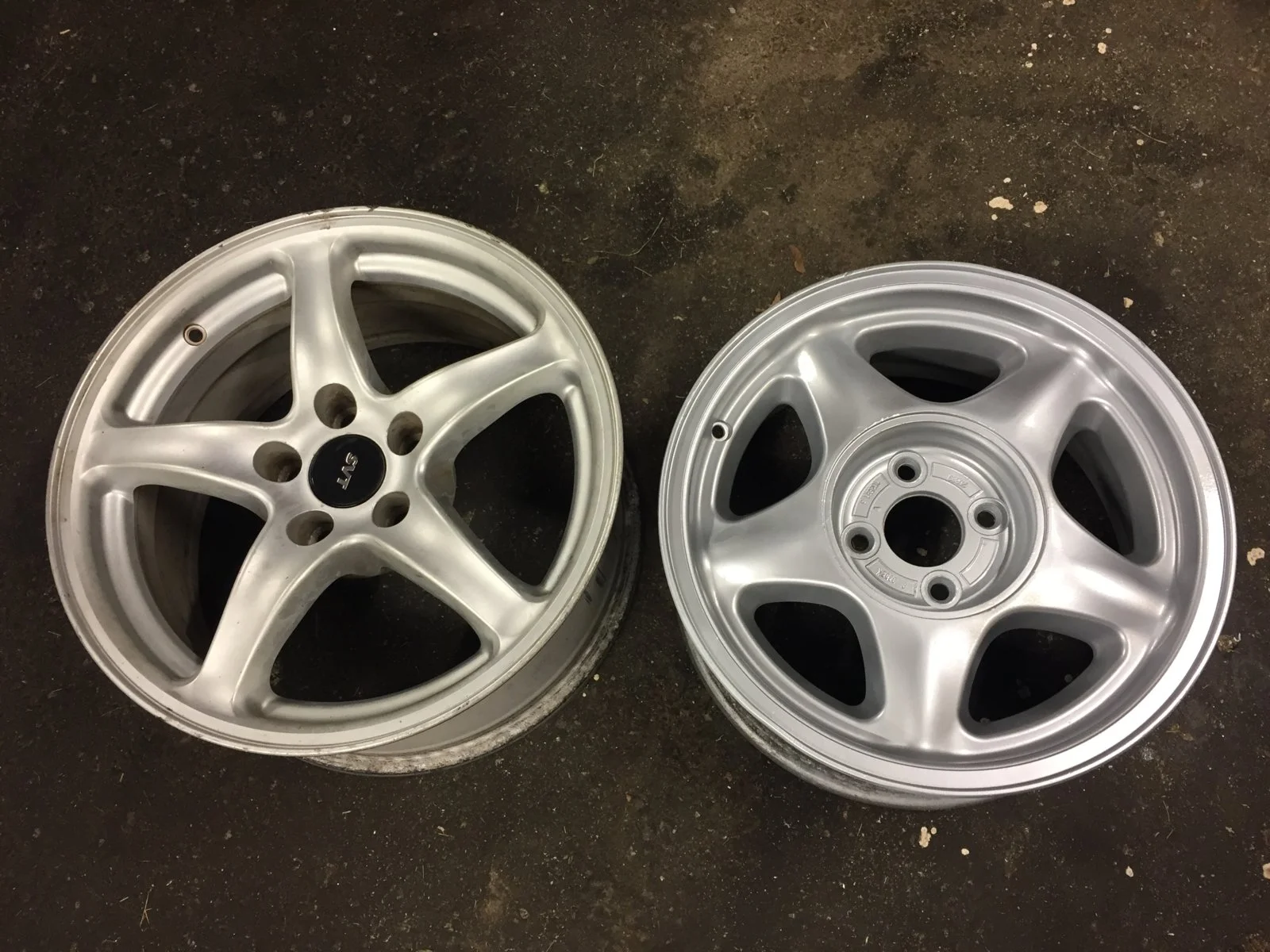

Color isn't 100% match to the Cobra wheel, but I like the nice clean new shade of argent. Will look good.
At $20 a can, if not going to go too crazy painting this pony wheel. I will paint both sidew of the Cobra wheel however. If I can get two done per canill be happy
Given that this wheel is a test, I accelerated my painting.

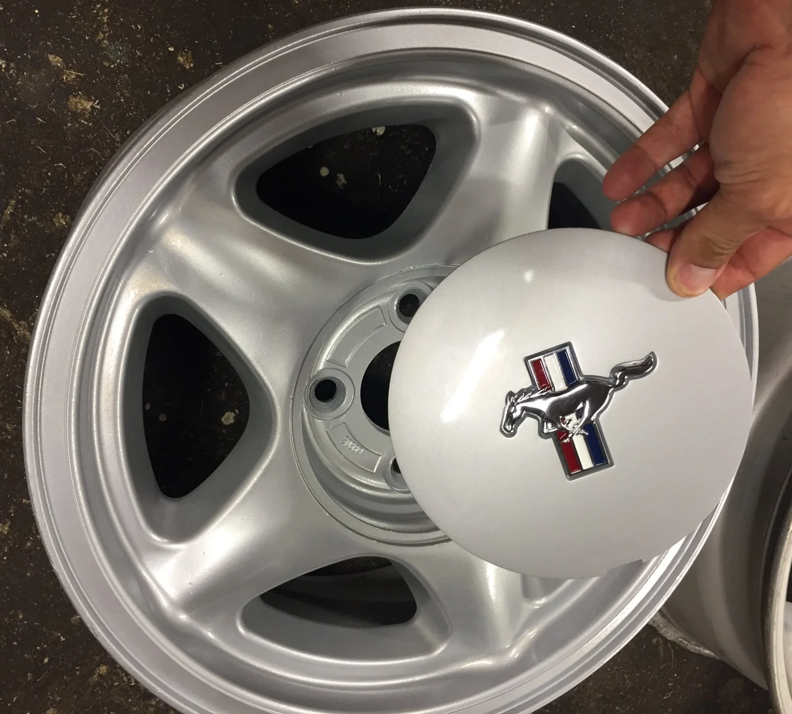

Decided to try the clear coat. Definitely added some depth and shine to the wheel. The color matches the center cap, but if I was redoing the pony wheels to actually use I'd have to clear the cap. Compare to photo above of the Argent paint only. It's flatter
Compared to the Cobra wheel. Not 100% the same but I do like the brighter color.
JB weld not fully cured. No sanding yet. Stay tuned.

Took a photo of the completed test rim in the morning sunlight. It's a nice clean, new, shade. I like it.

Will that clear be durable, being it's not a 2-part clear? It might also yellow on you.
No idea. That's why I did a test wheel first. The Motorcraft paint looked pretty damn good as it is without the clear.
To be honest, the oem rim looks a tad yellowed anyway. Not that I want this to yellow.
I may not use it. Might find myself a self etching primer as well
