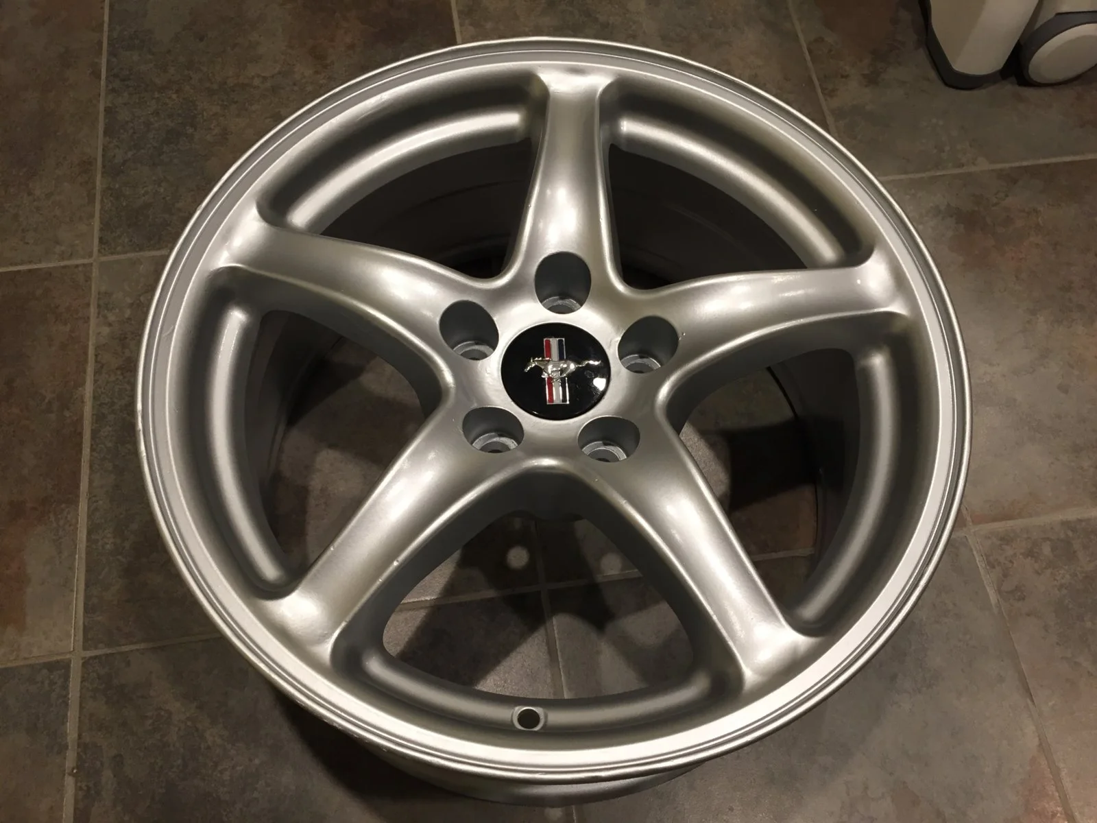

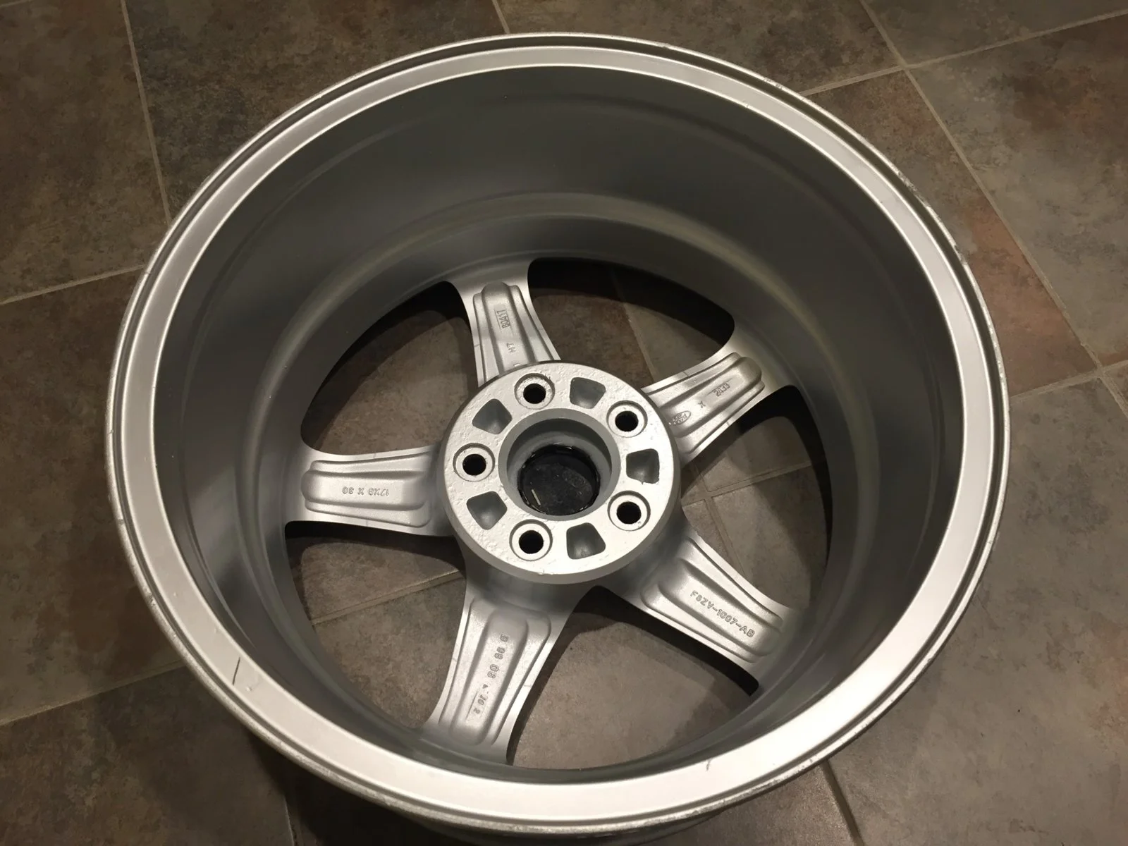

I've started the second wheel, but likely won't post daily updates. It's in better shape than the first one, so less to do.
I also realize I'm not a fan of the svt caps. The Bullitt caps look way better. Last pics for now. Still nervous to see what happens when I go and try to get a tire mounted

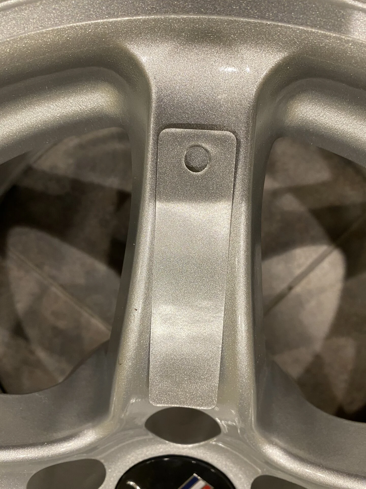

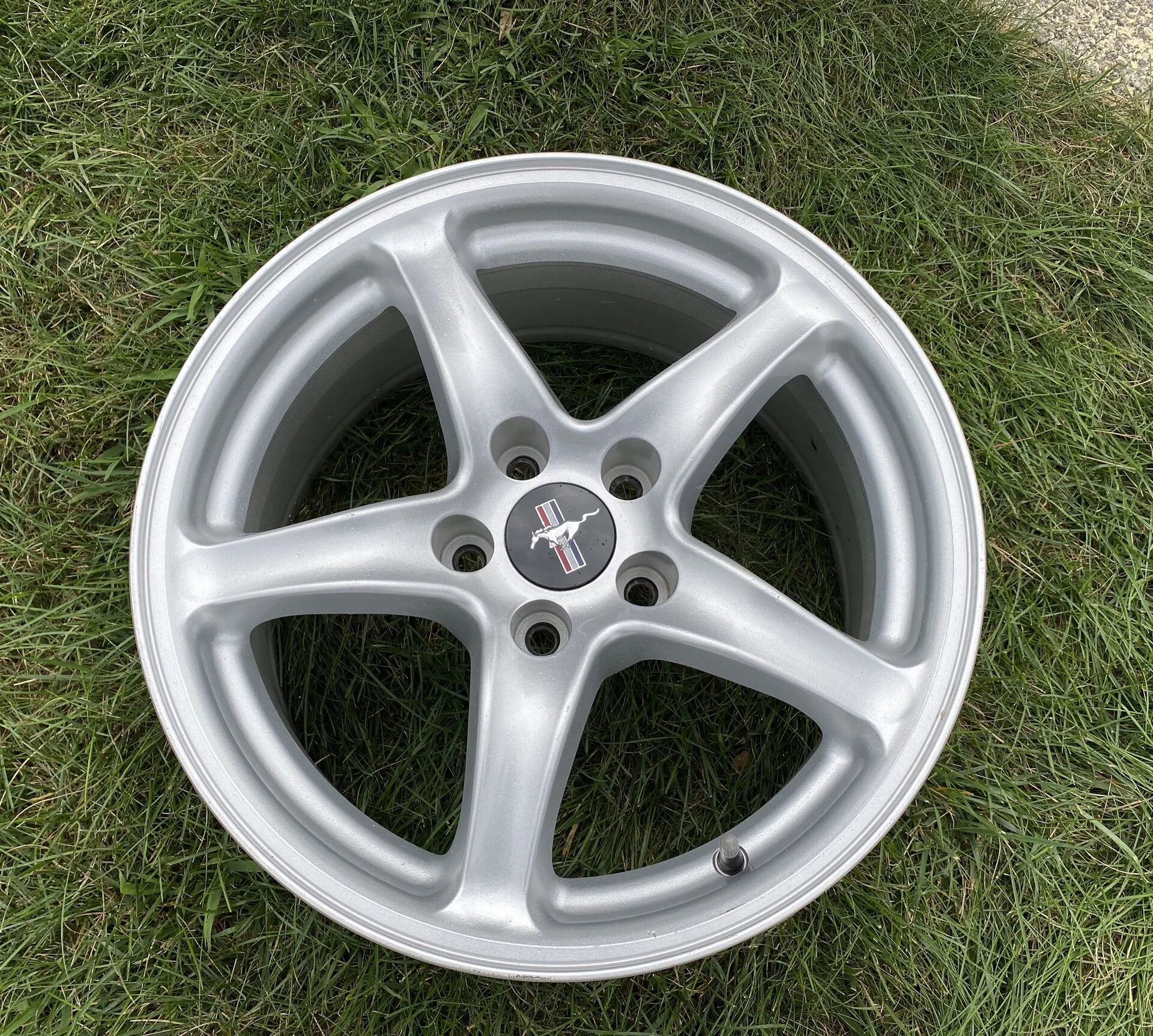

FYI, if anyone is looking to powdercoat after fixing a wheel.
www.prismaticpowders.com
many shops can get their powders so shouldn’t be an issue.
their “Silver Oar” color is a spot on match for the OEM finish. Matches my ‘98 Cobra wheel perfectly. Would prob match a 91-93 pony wheel as well
This wheel is OEM paint. it’s a different wheel than the refinished one earlier in the thread. I have not refinished it
