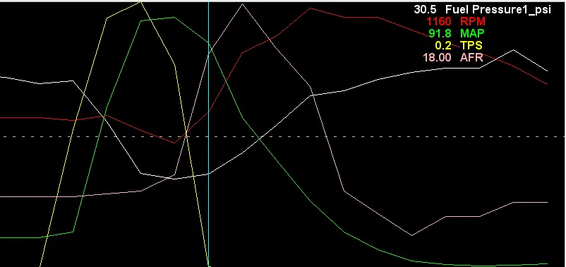

Found this in my logs. I want to put this here just so i have a record of it and it doesn't get lost.
This was with the vac line off and capped. So fuel pressure was static 39psi
For those not familiar with megalogviewer, the blue verticle line is the snapshot in time and to the right are the numbers at that moment and the corresponding colors.
So yellow is my TPS. Essentially when i hit the gas for a rev. You can see MAP immediately follows (0.1s behind the TPS hit), so no funky things happening there. White is my FP. I'm sitting at 39psi and then the rev comes and it drops to 30.1psi. It then recovers. You can see my RPM dips, and my AFR goes lean. Not shown is injector pulse width. It goes from 3ms to 14ms during the blip, so it's trying to add fuel.

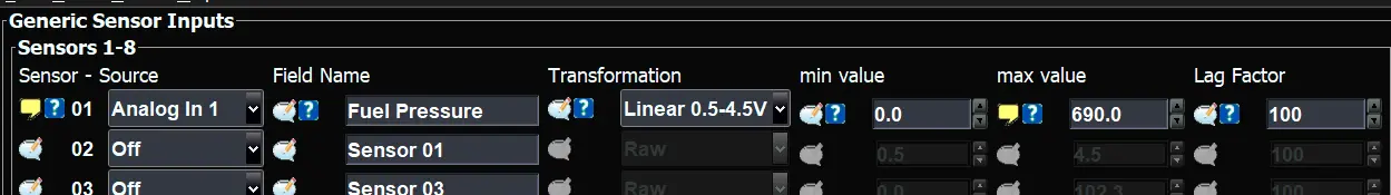

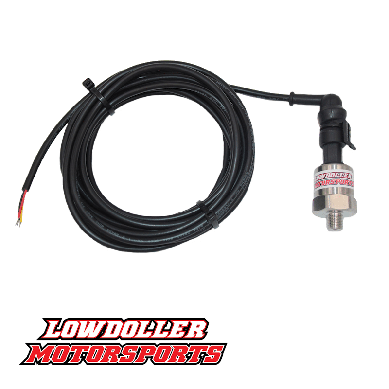

@Mustang5L5 I have a theory that could explain all of it. Been thinking about this for a while. Can you post a screen shot of your fuel pressure sensor set up in your software. You should have a screen with units and sensor types. Open them up to show the choices and what you have selected.
Edit- Also a pic of your FP transducer
Here you go.
This is the exact main transducer i've been using.
LDM 0-100 PSI Pressure Sensor
LDM Pressure Sensor 0-100 PSI & 15ft cable with 90° boot combo; Fast-Response Pressure Sensor for fuel, oil, coolant, etc.
diyautotune.com
