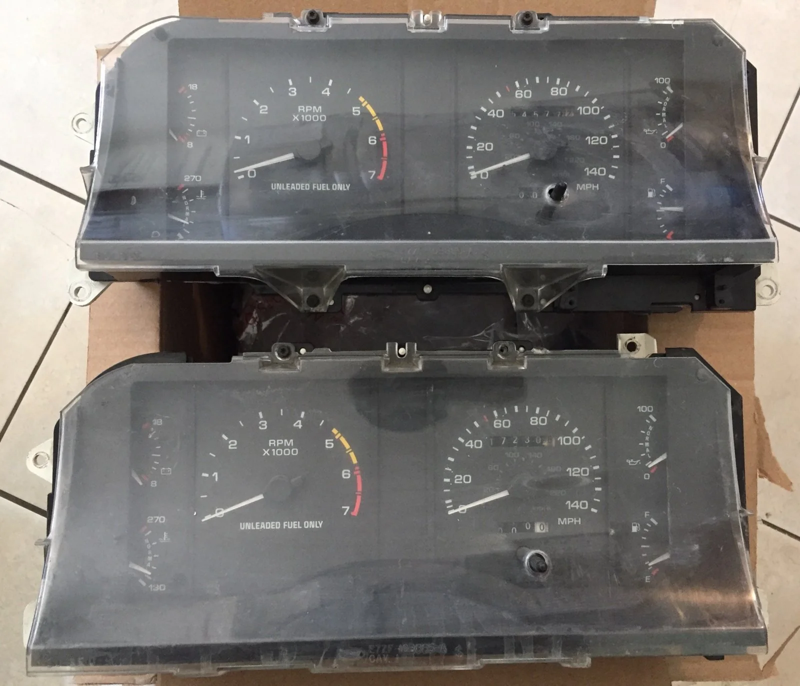

Didn’t need this, but couldn’t turn them down.
2x 1989 140mph Guage clusters for $50 for both
No idea how they work, but I might fix one up, add leds, match the mileage and toss in my car.
I like my white face gauges...but they light up like poo at night

2000xp8
SN Certified Technician
Aug 8, 2003
8,061
1,646
194
NJ
Feb 15, 2020
#2,010
  • Feb 15, 2020
  • #2,010
Ditch the white gauges.
I don't miss mine one bit, they were crappy at night and really don't fit the fox interior.
Maybe find a 160mph if you like unique?
I have a black matching saleen 170mph in my car.

I had the white face gauges in my vert, went good with the white interior but it sucked at night.

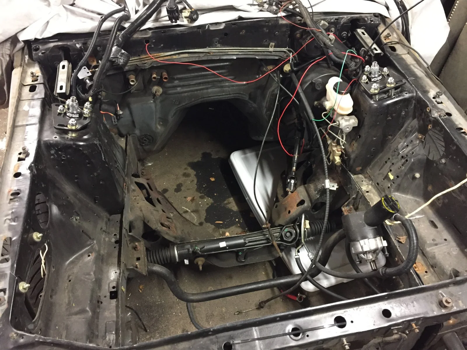

Started stripping down the engine bay. Not gonna lie...I scared myself a few times wondering how I’d get this back together again. But you know it will end up fine.
But this was scary
But not too bad now

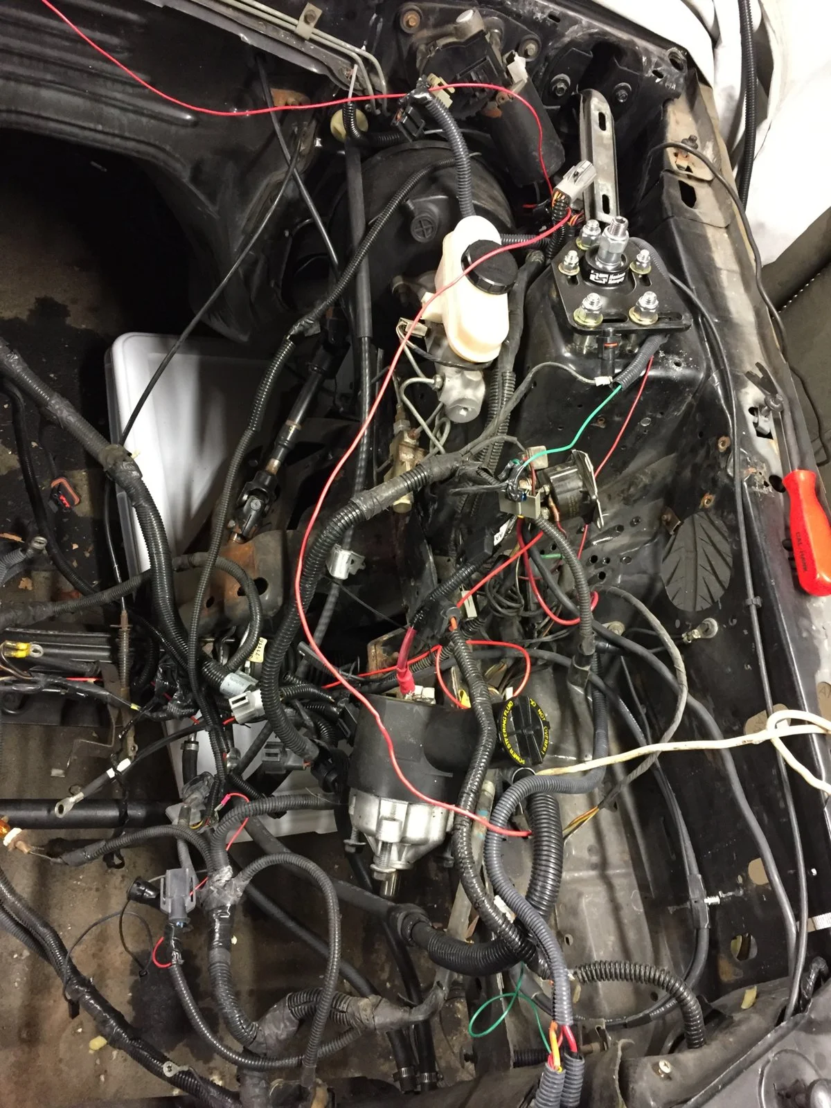

The good side. The frame rail repair here should be minor. Two small bubbles but I want to see how weak they are and patch if needed.
This is the side I’m dreading though. Hard to see til I yank the MC out
Btw...where can I get these new?

Taking good pictures of it all before disassembling is my go to move. Time is a factor in remembering where it all went and in what order it goes in to make it fit right. Keep up the good work.
