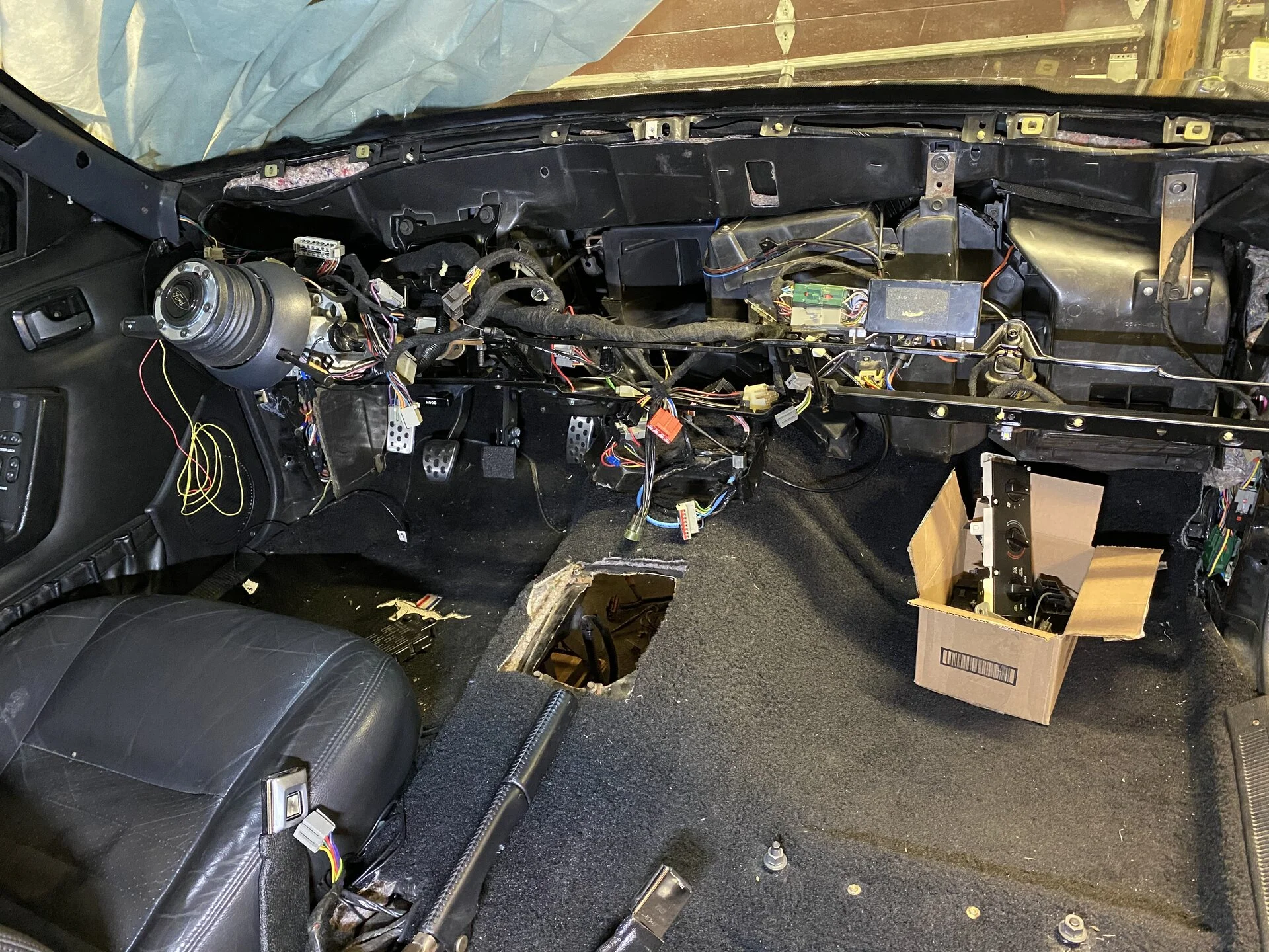

Looks great! A bit overwhelming as far down as you went with interior too.
On the throttle cable if the outer sheath is ok. You can have a competent snow truck accessory shop make you a new cable they are standard ends. That's what I did on my carb set up after fighting with the cheap plastic ends on the aftermarket replacement.
The sheathing is actually cracking and splitting. Still usable, but i'm giving thought to buying the really nice used cable on Ebay. I did find new replacement cables, but they seem to be all plastic.
Interior isn't as bad as it seems. I took a bunch of pics so hopefully I can get it all back together this week. I just want to get the main plastic dash part back in, and leave everything else out. I'll likely pull the carpet as well and do some work under there.

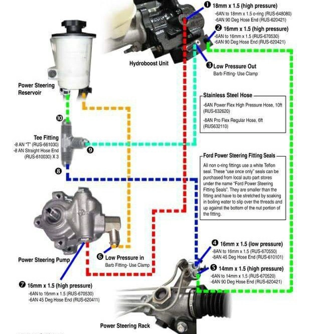

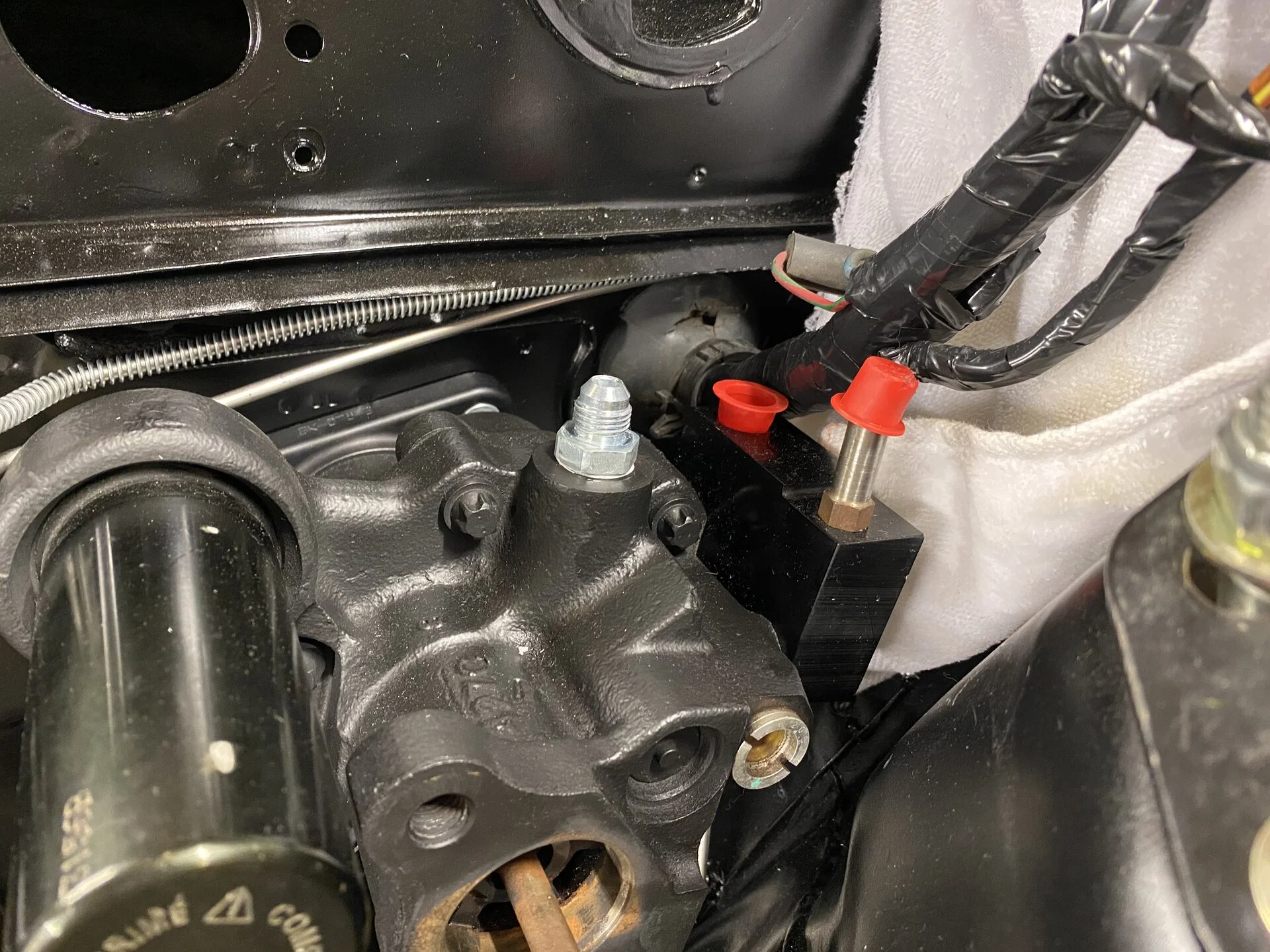

Started putting together the hydroboost brake lines, started by ordering the conversion fittings. The OEM lines won't really work for me where the Windsor pump mounts. Max motorsports offers a kit to convert the power steering rack to 6AN. SO I bought those. I also bought the fittings to convert the hydroboost unit itself to 6AN as well as the power steering pump to 6AN.
I figure I test fit the fittings and such now, and then run the hoses at a later date once the engine (and PS pump) are mounted. I'll have to find a clean way to mount the PS fluid reservoir as well.
Here's the diagram I am using as a guide. I'll likely stick a PS cooler in here as well which I believe should go somewhere on the blue line.
This applies to a 99-04 hydroboost. The 96-98 unit uses different fitting sizes

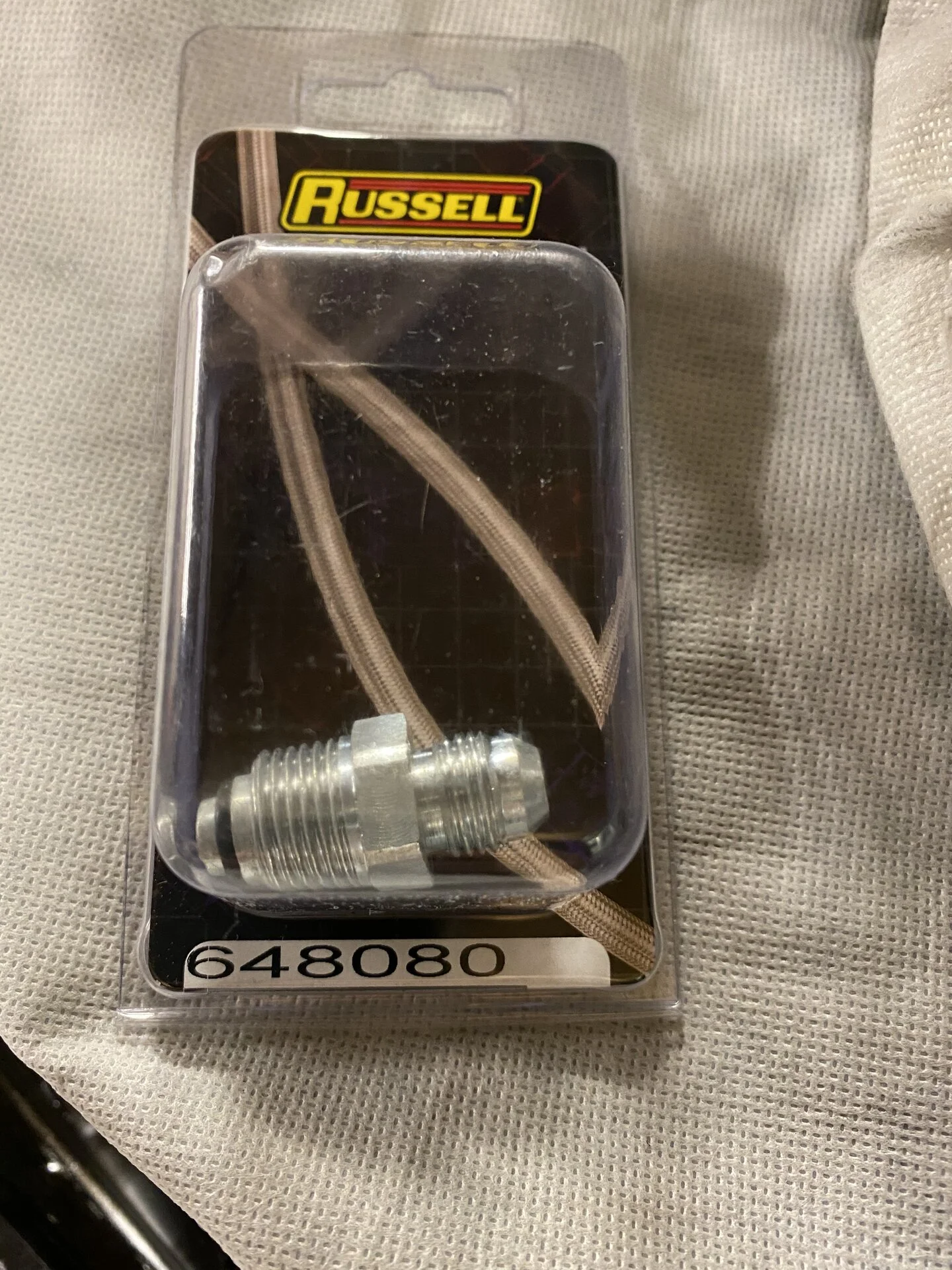

Bunch of orders in the mail and stalled until they arrived.
did get one of the hydroboost fittings in. Russell 648080 will convert one of the ports to -6AN

I'm just finishing up the same project engine bay, brake lines, dash frame rewrap harness blah blah. Your pics are helping me along. my question for you is can I bolt the frame and wiring to the dash before installing?
Not sure. My concern would be the weight, and feeding it through the firewall. If you had two people it might be a bit easy to do this though.
Easiest route might be to bolt the dash to the frame, and then feed the harness in where it needs to go, and then if you can get both doors wide open you can probably manage feeding the harness through the firewall while you walk the dash in place.

Yup. That wiring harness is pretty damn heavy and awkward.
Way I did it was the wiring went in first, and then I put the frame in. In hindsight, I wish I had assembled the wiring to the frame and clipped it all in place. The frame itself is light in the grand scheme of things.
Laying the plastic dash over the bolted in place frame is pretty easy. Just loosen the 4 bolts on the column up to drop it a couple inches, and remove the multifuction switch and the dash part is easy. I actually installed my dash, and then realized I needed it off for a few more tasks so off it came opeagain.
I'm actually going to pull my entire interior at some point. I want to put some sound deadener under the carpet, and weld in the rear 3-point seat belt mounts to install 90+ rear belts. Everything's gotta come out anyway, so not sure if will install the dash at this point.

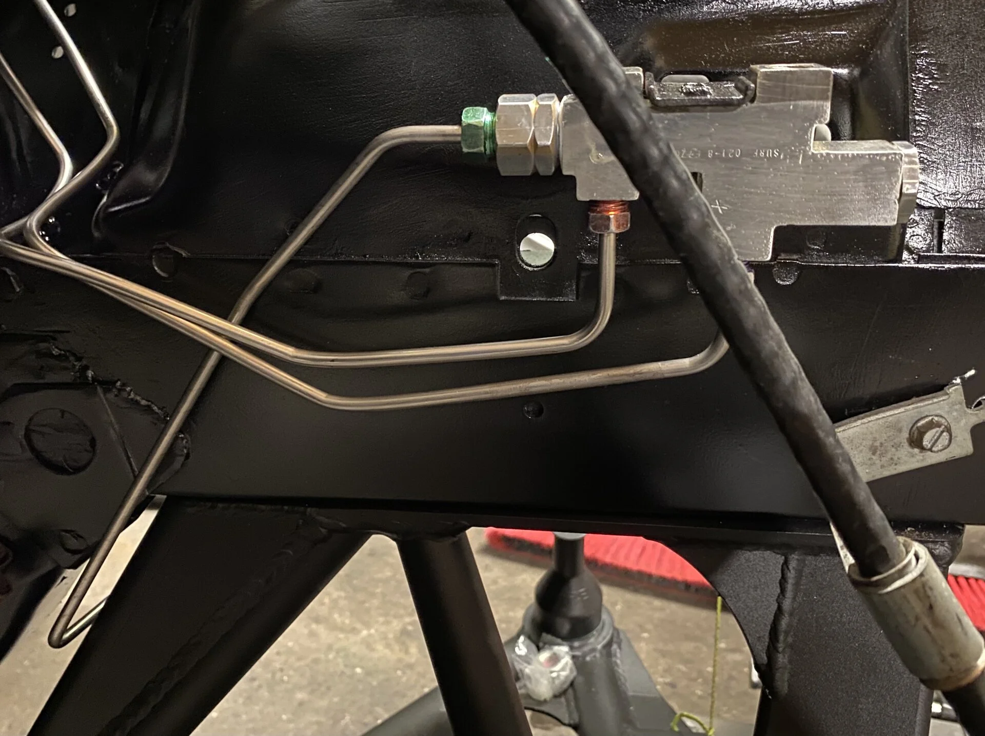

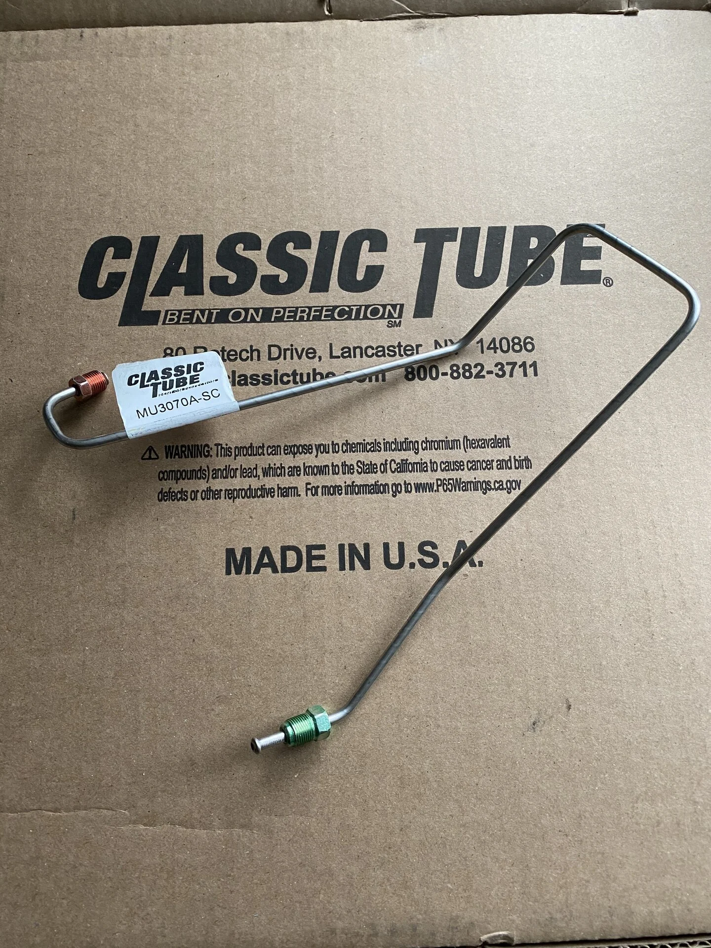

Brake line arrived today.
94-95 non-ABS drivers front line. Fits into the fitting I installed on my stock combo vskve.
$45 plus shipping from Classic Tube part. Part number MU3070A-SC
mocked up in place. I’ll have to come back later to asjust and clip into place
this gives a very clean 3-2 conversion without a slew of fittings and adapters
