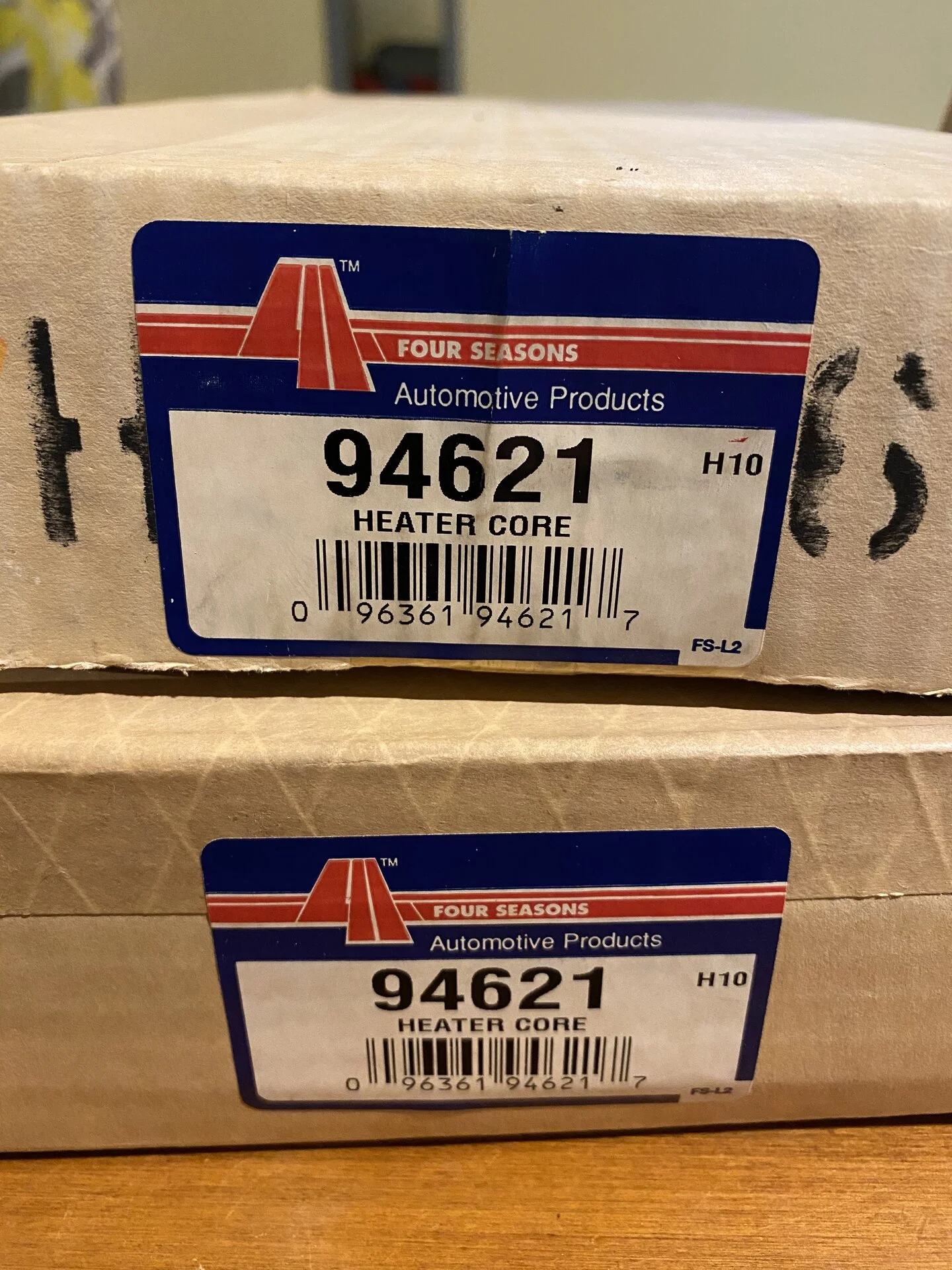

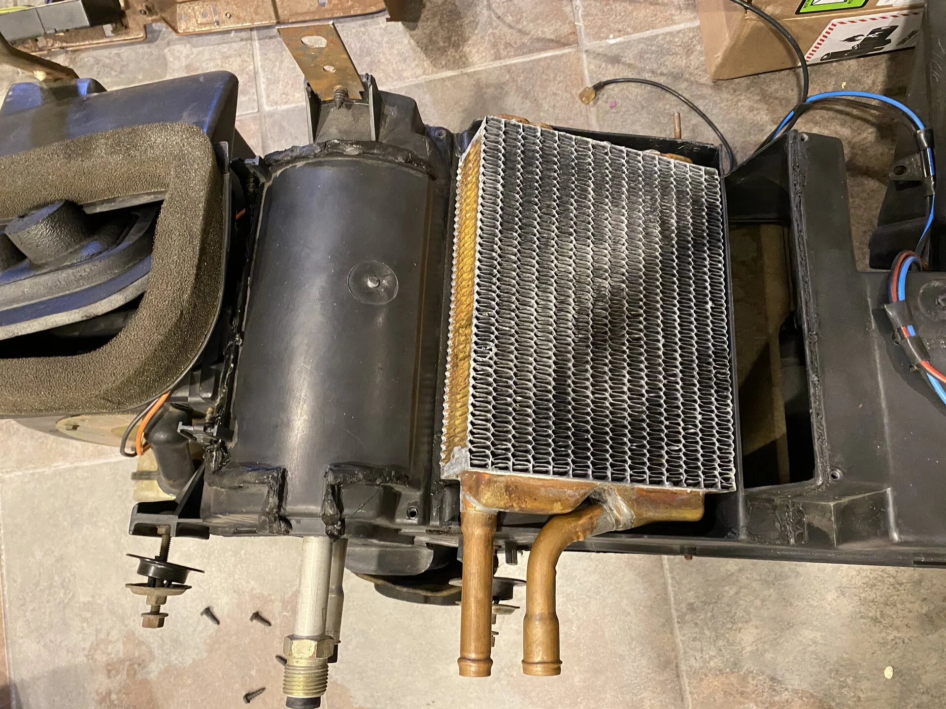

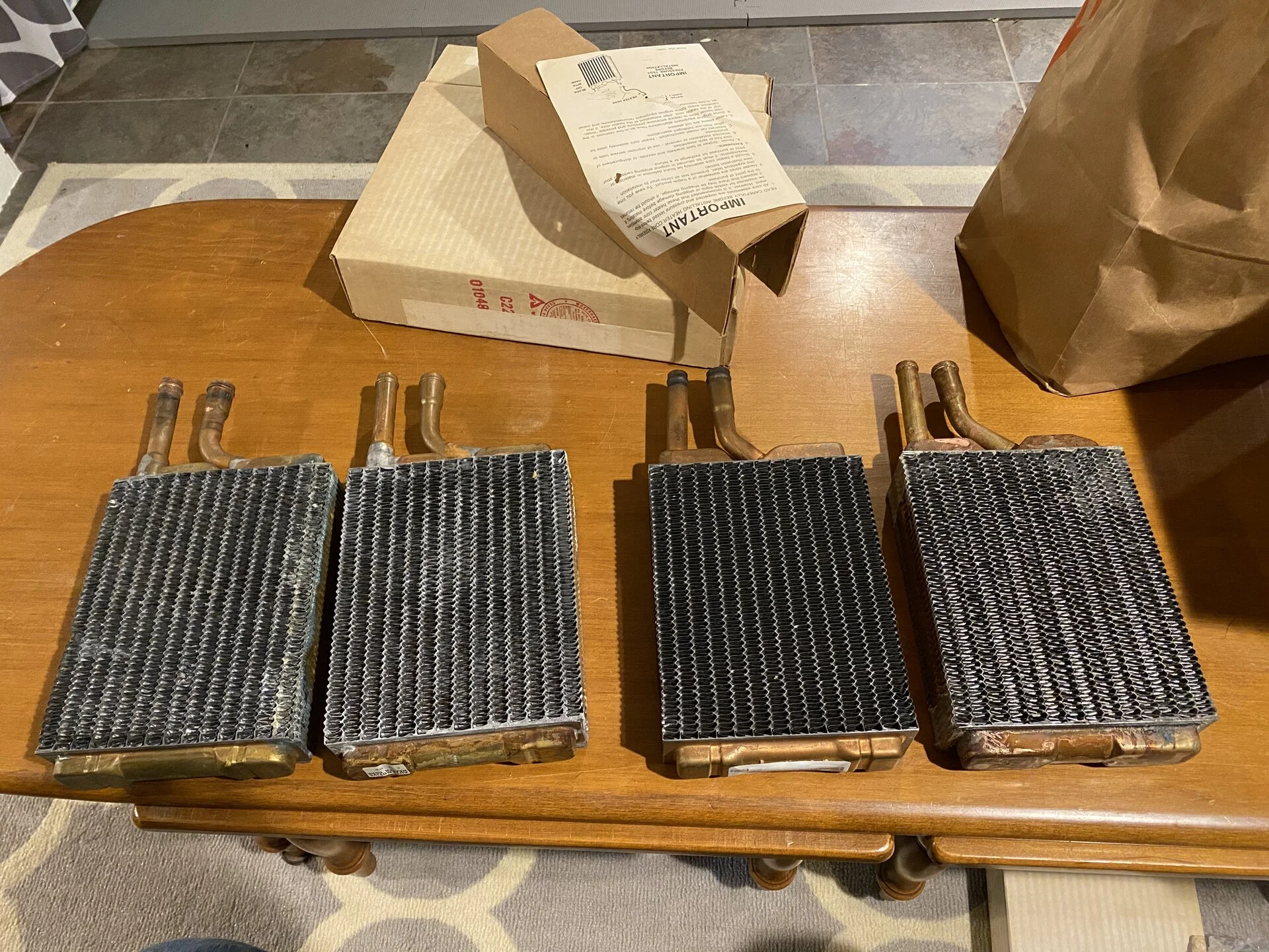

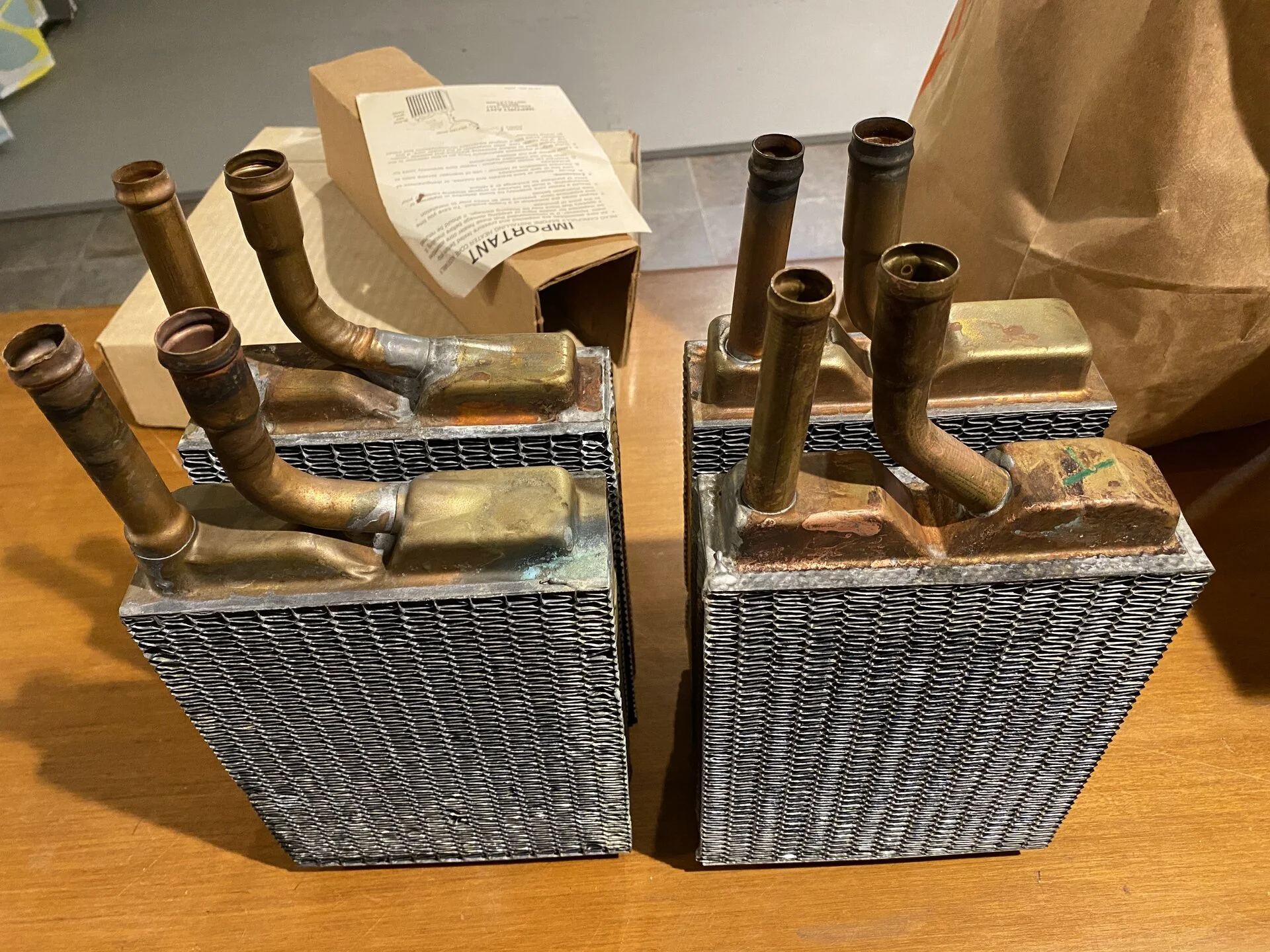

Back to heater cores. Tracked down an old set of Brass 4 seasons cores. Compared them to the FoMoCo made cores, and they are identical.
paid $35 each. Can you tell which is which? 2 four seasons cores, the Nos core and my “bad” core
So to be more specific. The 2nd from right is the NOS core. Left most one is the core I pulled from my car. In the above pic, it looks like the two 4 seasons cores. No FoMoCo label on it. I wouldn't be surprised if the core i had in my car the last 20 years was a brass parts store replacement.
So, i'm picking the best of the two, and installing that. The NOS unit will go back into the box and get put on the shelf. Maybe i'll sell it one day, maybe I won;t

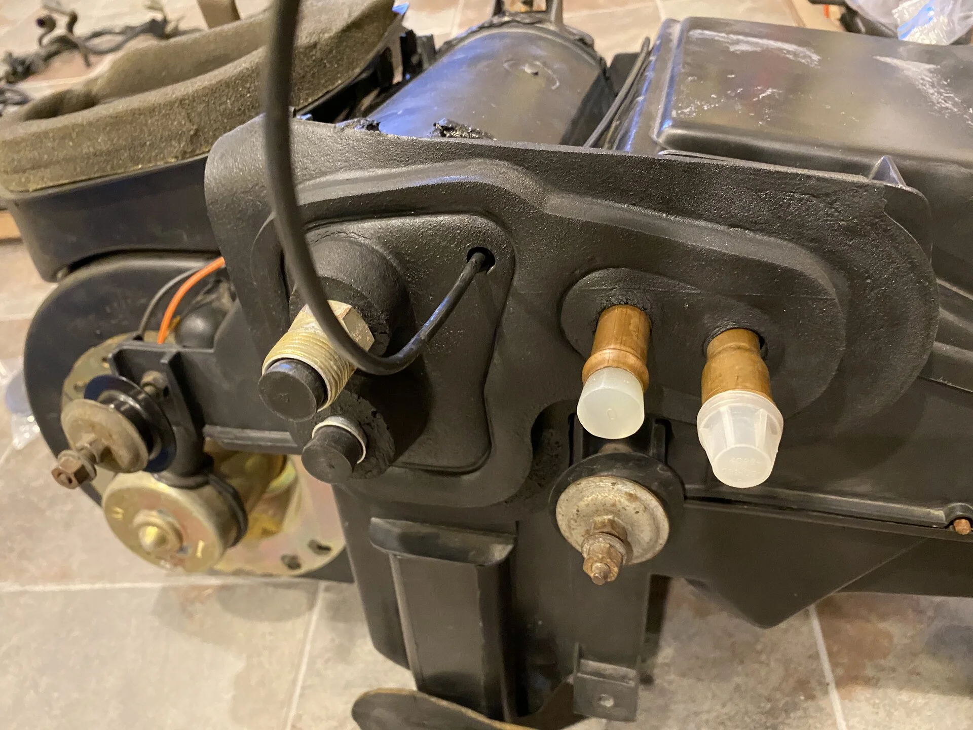

Made a decision about the heater core. After careful examination, I believe the motorcraft core and my old 4 seasons cores prob went down the same assembly line. So o stuck the best of the $35 brass cores in.
I’ll keep the other four seasons brass core, and my originsl core which I could always repair.
the Ford core will go on eBay. It’s getting listed pretty damn high, so it will likely never sell. I’m sure I’ll get some entertaining offers as it sits on the shelf.

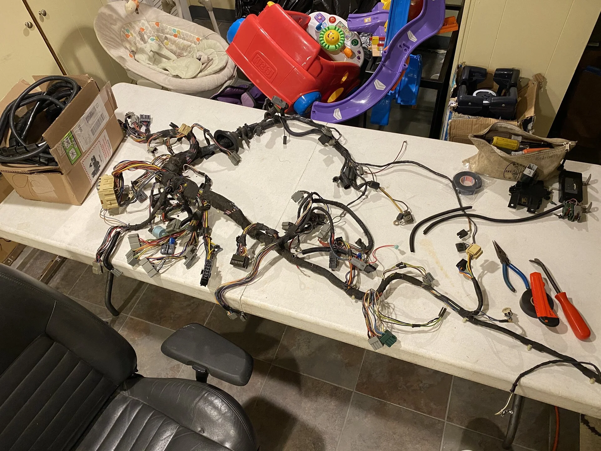

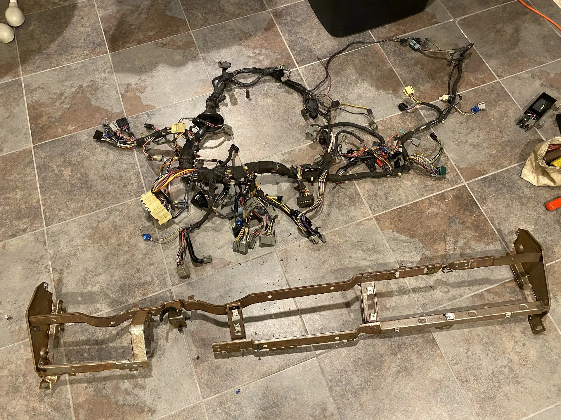

Pulled the dash harness off the frame. Took about 20 pics of where everything routes. Going to scuff, clean and paint the metal frame.
Made myself a work area to reloom and clean up this harness. I have a few sections to resplice where I cut the alarm out.

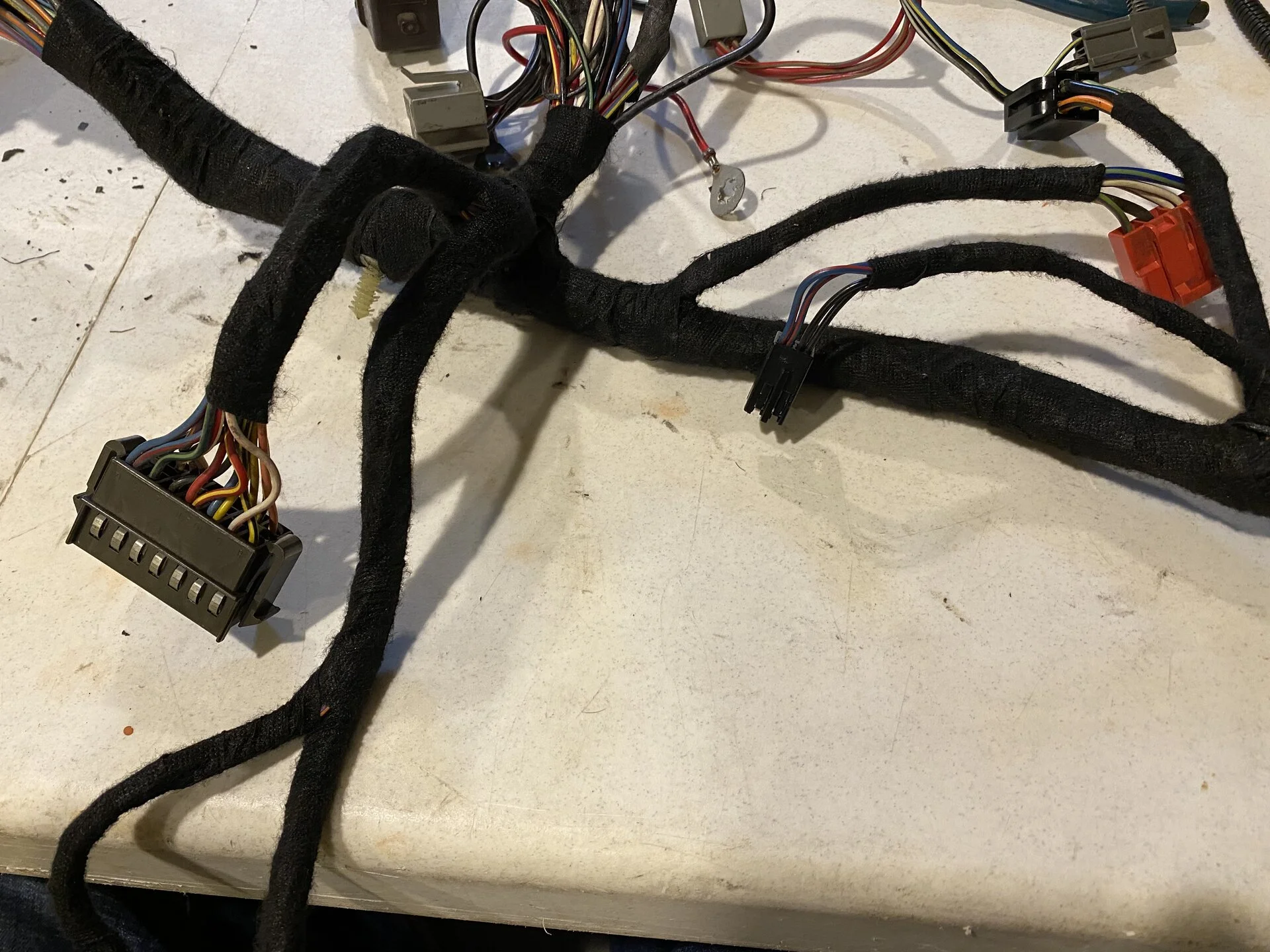

Much better, although in hindsight I wish I went with a gray or something not black, so it contrasts under the dash so I can see where things plug in and such. Oh well

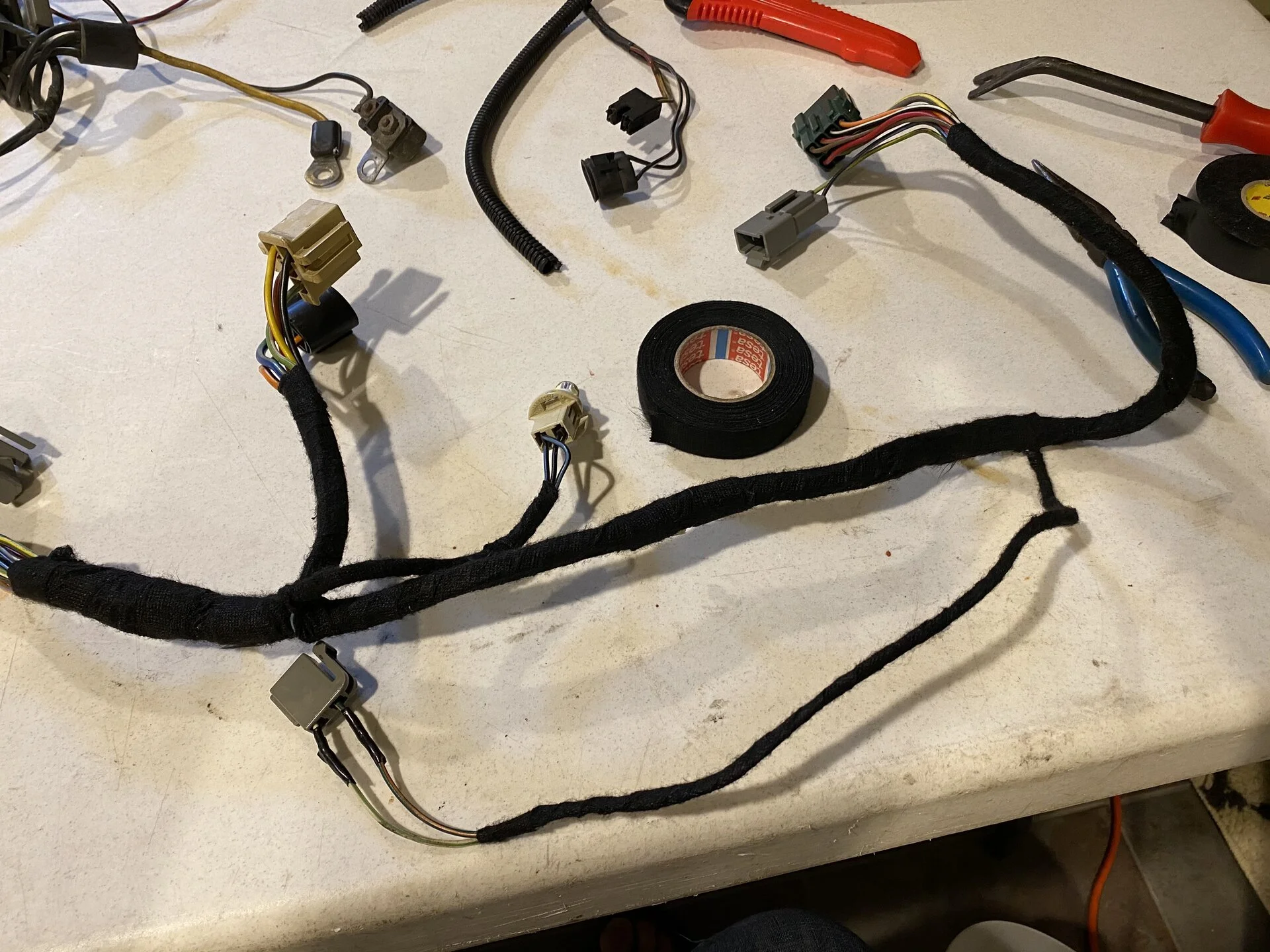

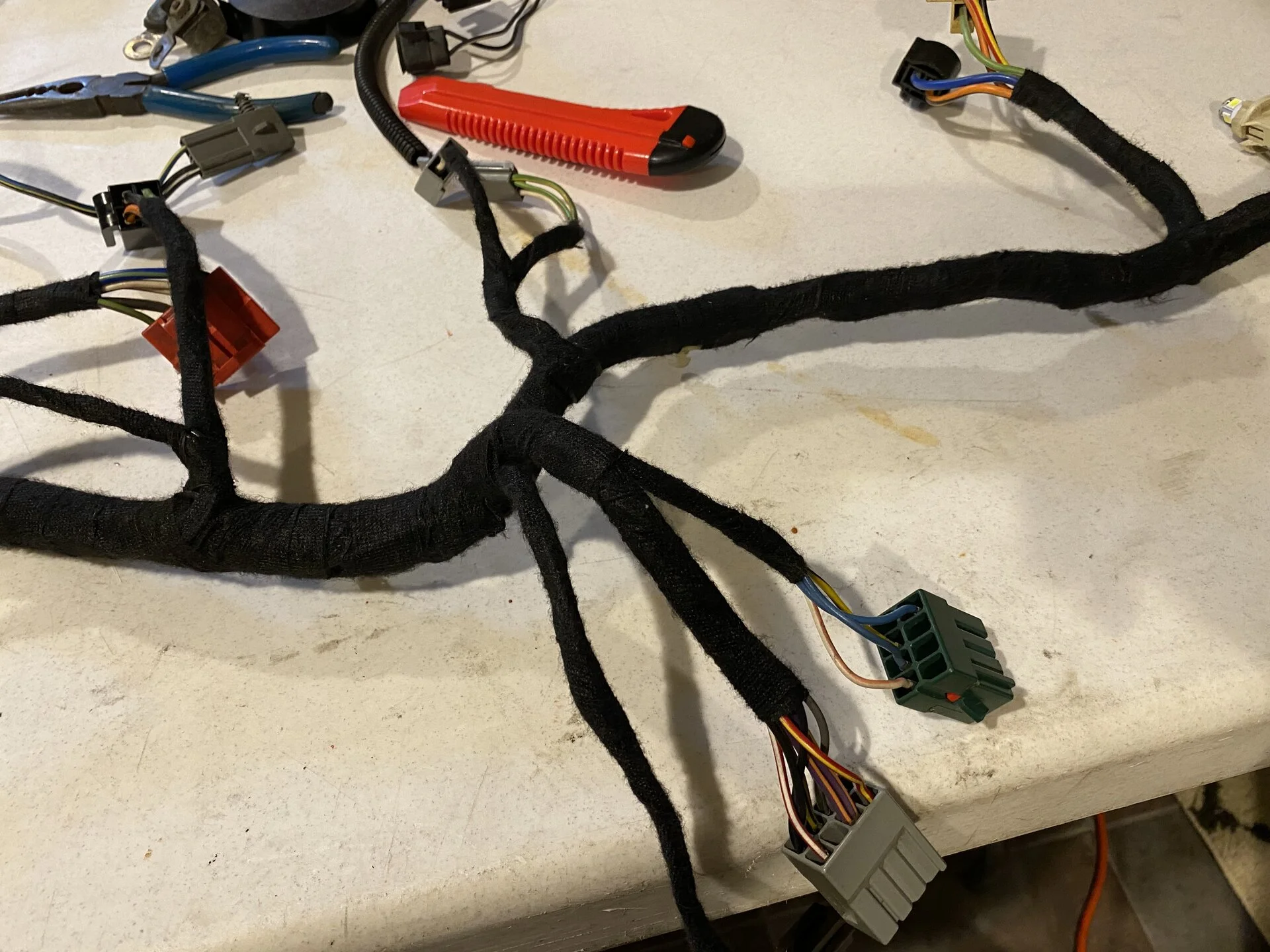

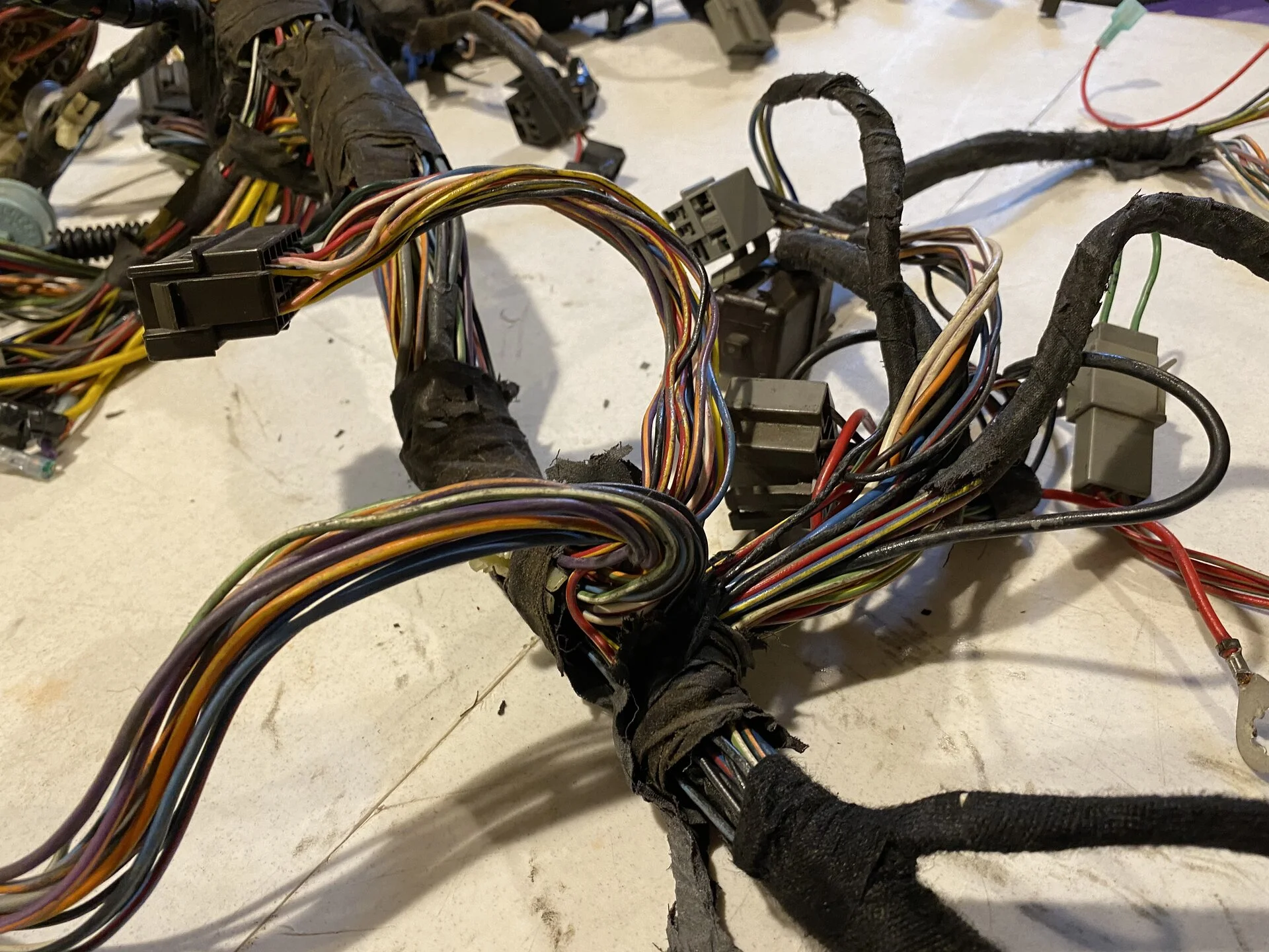

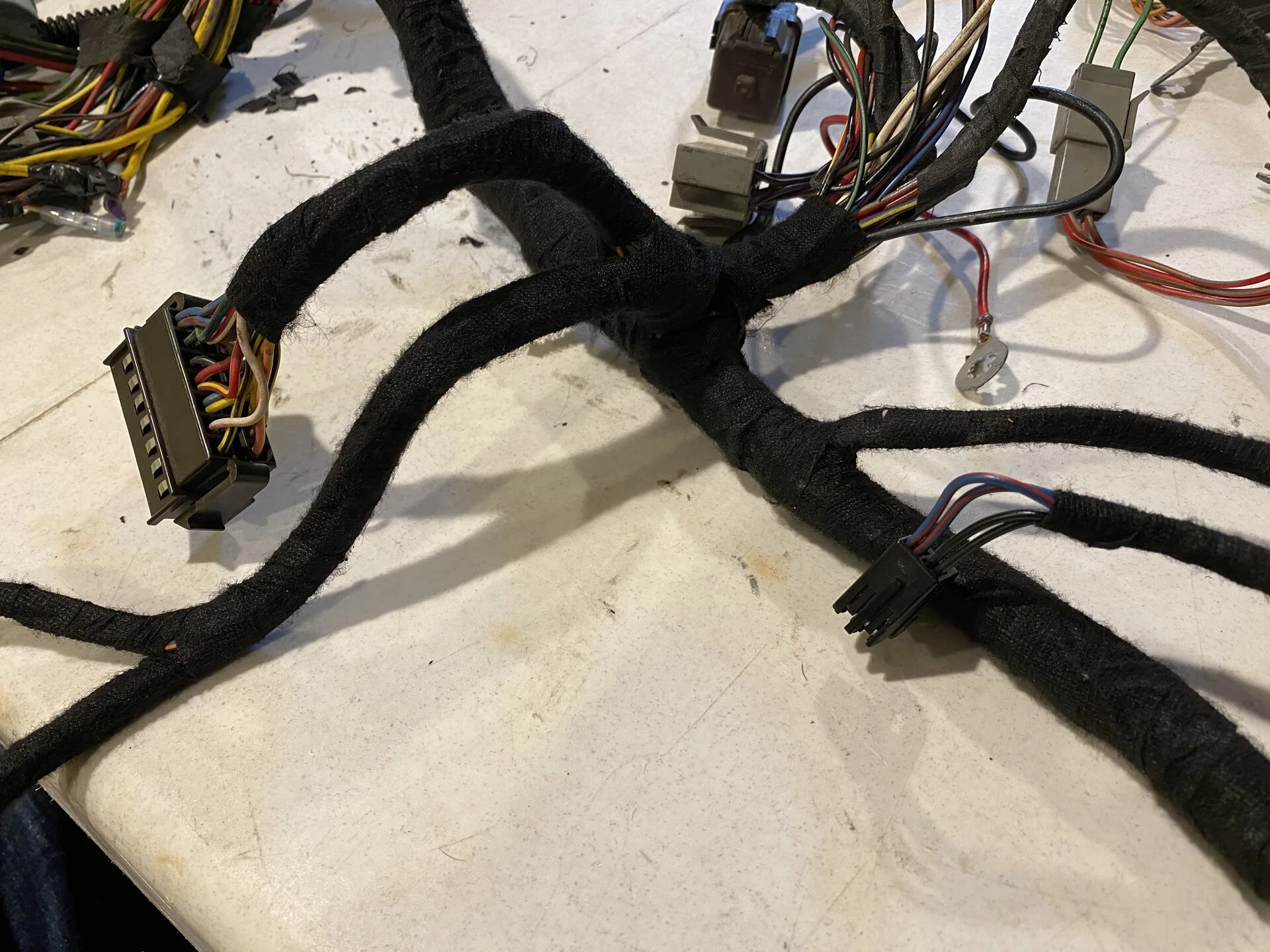

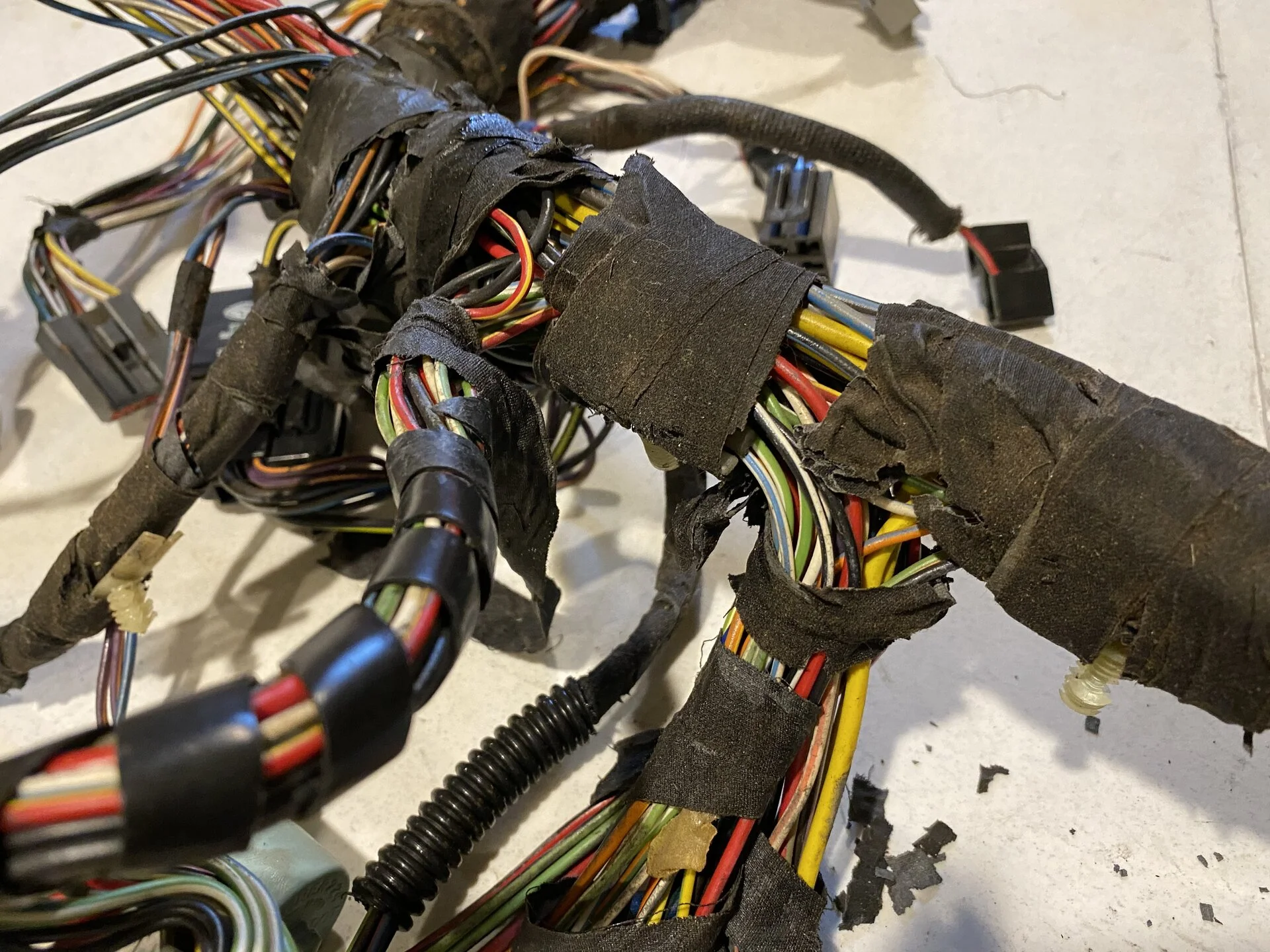

Decided to mess with the dash harness while watching football.
the original tape holding it together was an oozy, sticky mess that pulled apart easily.
bought some Tesa tape and pulled the old tape off, inspected the wiring and went to work rearapping it.
Example of the crumbling tape
before
Same area partially wrapped
Some more progress
ran out of tape, so had to pause to order some more.
Reactions: Olivethefet, RaggedGT, Noobz347 and 3 others
