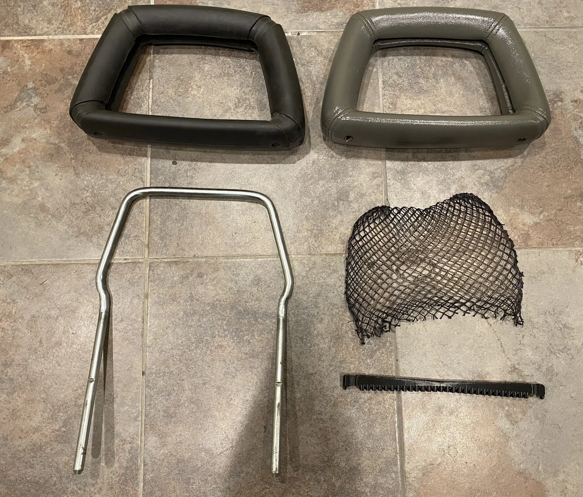

I also broke down the one Recaro headrest with the damaged netting and mesh bar.

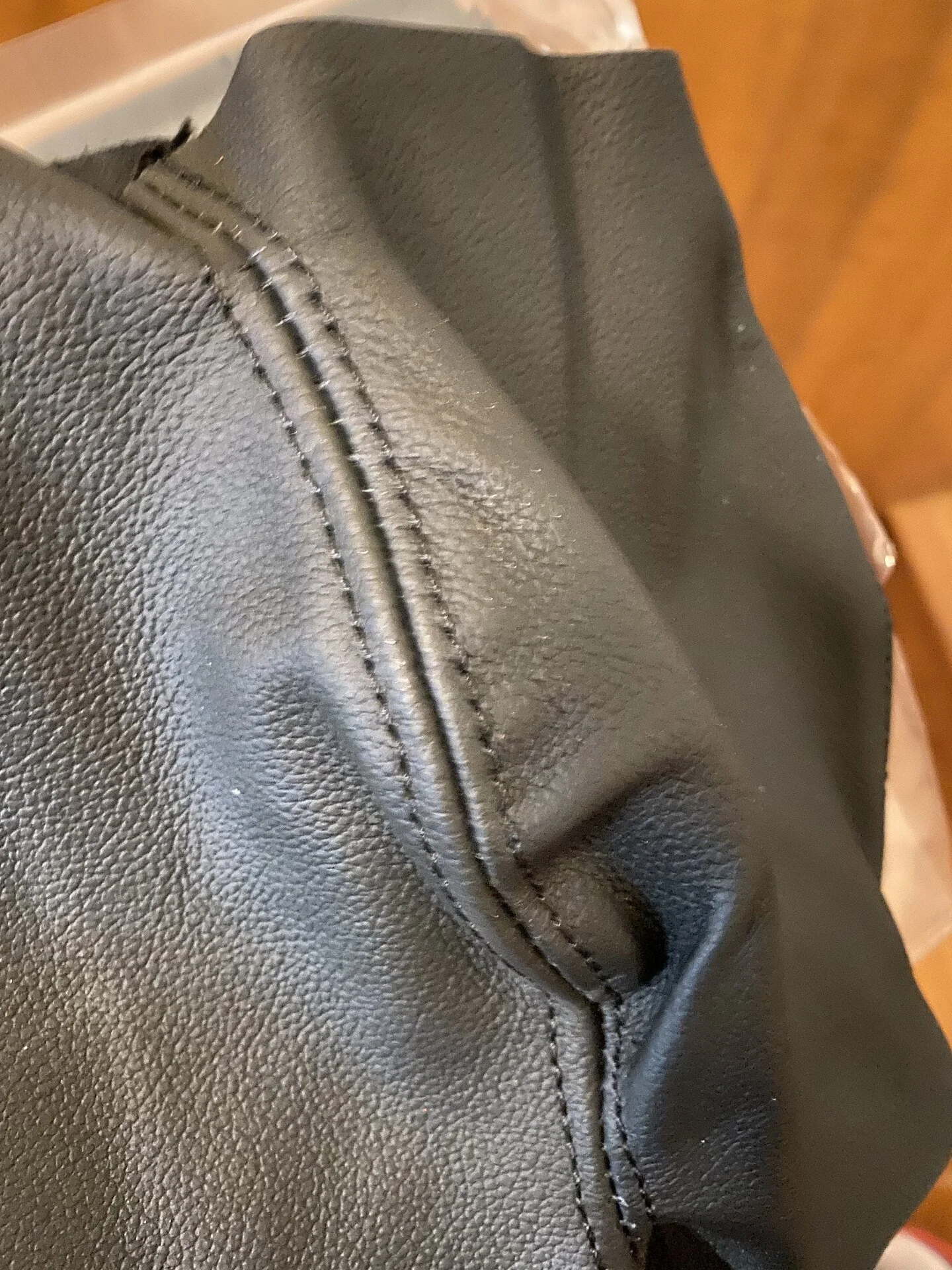

my $46 headrest covers showed up from that shady upholstery company. Of course they messed up. I asked for red stitching. I did not get red stitching.
fired off an email, so we will see what happens. In the meantime I tried to fit one on. A little bit bulky, and needs some trimming. I think I could get it on, and make it tight.
realistically, I may have to have a shop handle this (with a properly made cover). However, given that I have months before I can even drive the car again, I’ll keep working on this, so I can say I did it myself.
I’m debating just cutting apart the original leather cover, getting some material and threading, and trying this myself.

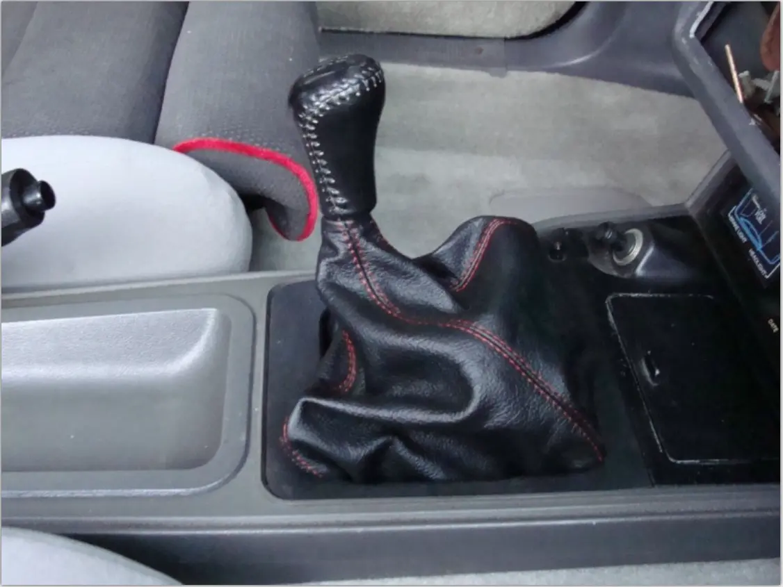

I get mine from here:
RedlineGoods shift boots
Genuine italian leather automotive interior accessories, shift boots and much more.
www.redlinegoods.com
I'll refer to to this page specifically: https://www.redlinegoods.com/notsupported.php
Stangnet would [more than happy] to host the reveal thread. We can make it a feature for all of their other Mustang accessories as well.

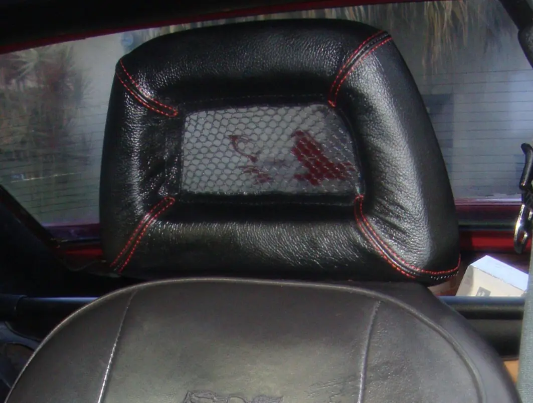

Not a bad idea. But would the pair of covers count as one item, or 2? $70 deposit, or $140?
I'd also need to sacrifice the leather cover from one of my headrests. Granted, if I were to do it on my own, I would need to do that anyway. Let me contact them and see if they've done it before. They are located in Europe, where Recaro's fall out of trees practically. I can't imagine they've never done it.
Problem is, i don't want to pay $140 for something similar to their halo headrest for the 86 Mustang. This looks terrible. The material doesn't tuck around the mesh properly. I want material to mimic the OEM recaro setup. My seats look too damn goo to do a hack job here.
I was actually thinking of dying the grey covers I have. The reality is, they are dyed already - very well. The original material is a brown leather, and at some point someone did a fantastic job dying them because I can't get any material to flake. Nothing to lose. They won't have the red stitching though.....

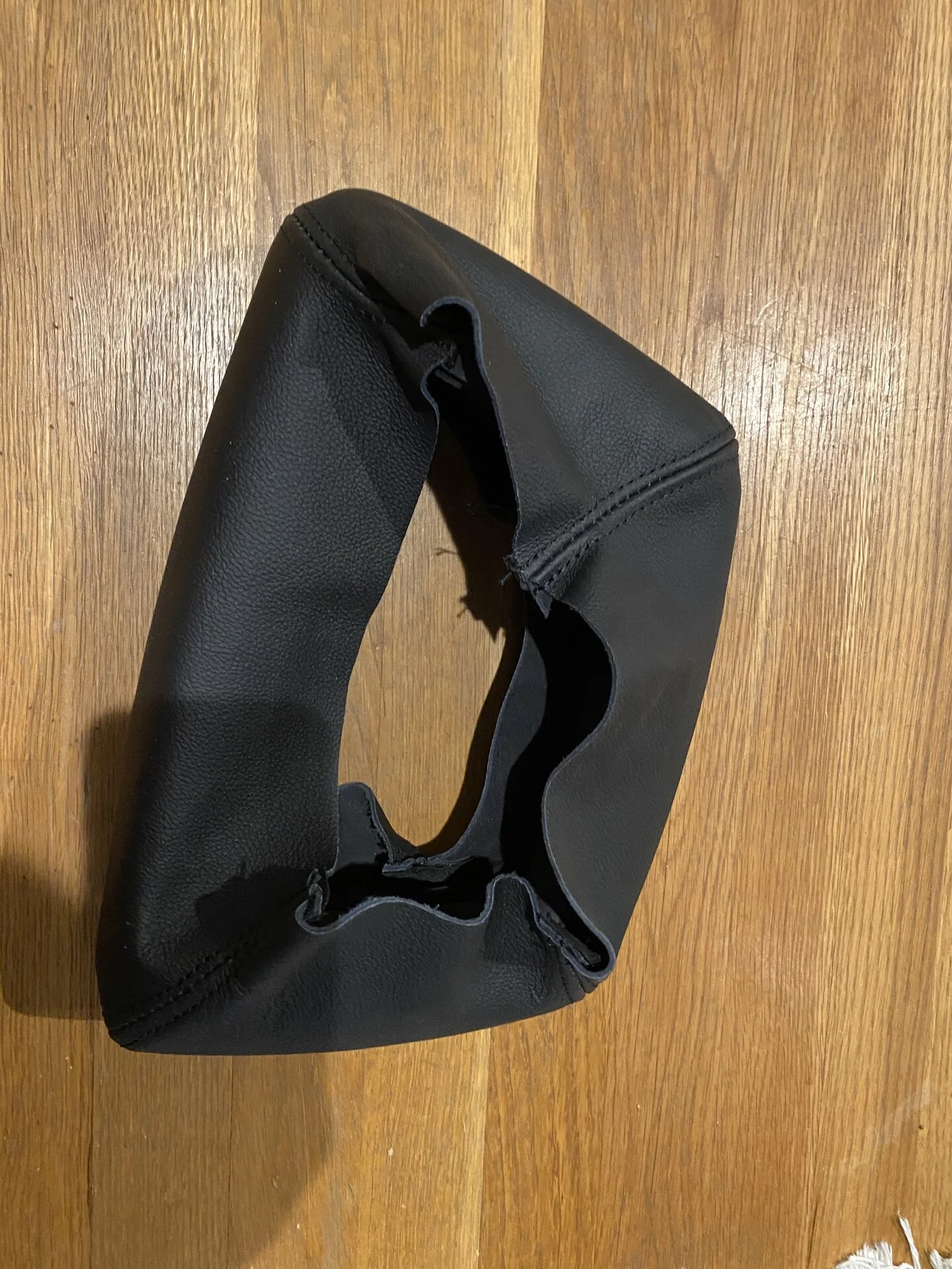

Ok, shady shop responded. They want me to send the coverings back and will exchange it.
Considering they aren't really usable due to being too bukly, plus the wrong stitching, I might as well roll the dice and see what happens.
Or maybe I save my money on shipping and just call it a lost cause. Now that I've seen their work, and the poor fit, not sure I want to put more money into something I know I won't be happy with.

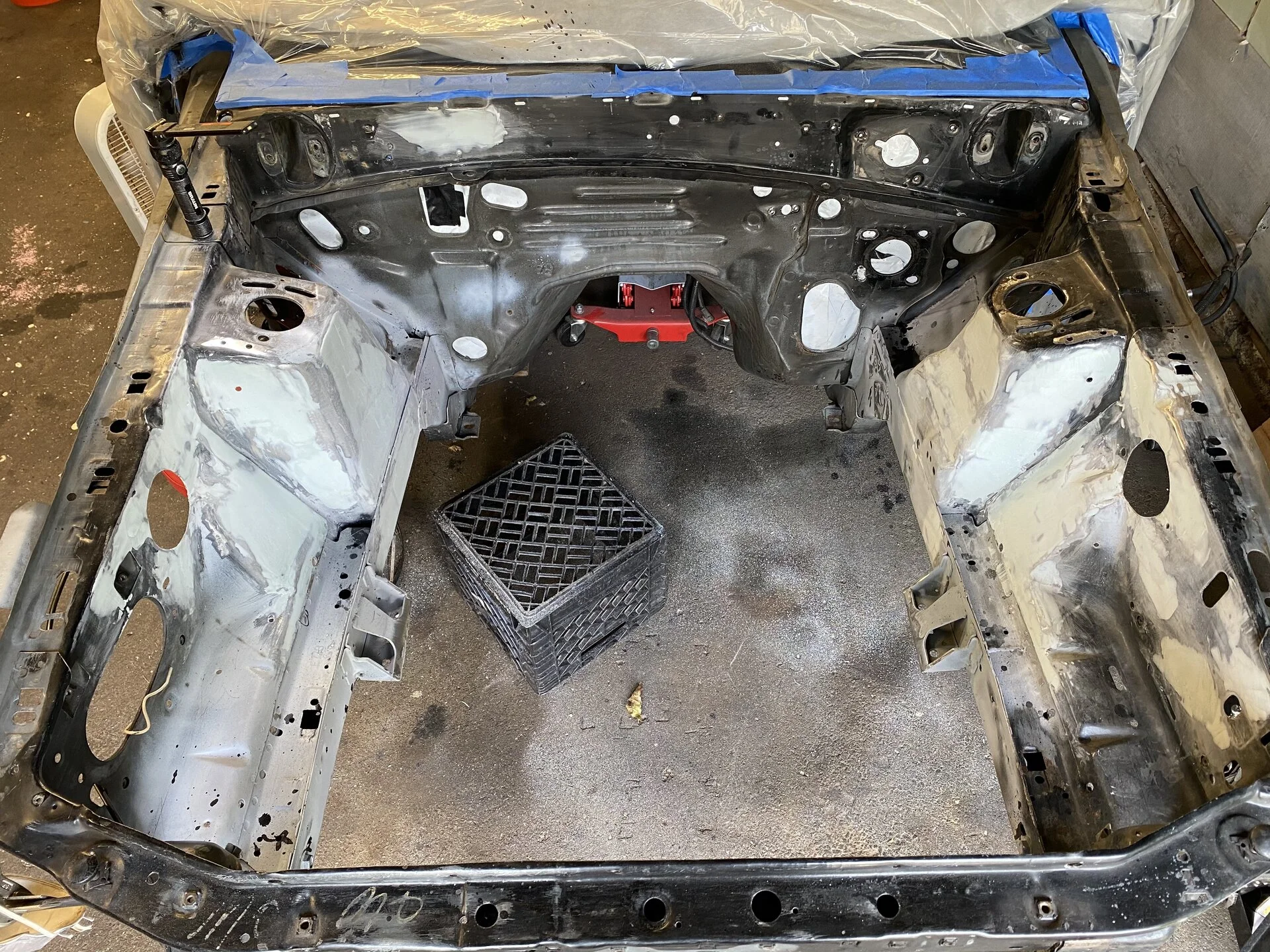

Just plugging away.
I’m almost done with the filler. Just basically smoothing out wgere I welded up the holes and trying to not go too crazy. Almost to the point where I think it’s good enough. I’d hate to think what I’d be going through if I decided to just smooth out everything. Even this is a lot of work.
next up will be to scuff everything, wipe it all down and start with primer.
I can see light at the end of the tunnel. Body work will be done and I can get back to doing mechanical things, which is more of my comfort zone....

So mustamg engine bays are typically fully painted right? They are also painted in a paint that can typically withstand solvents right?
I did an acetone wipe of the firewall and found the black paint easily came off without much effort.
Bottom left, you'll see some black paint that remains, as well as into the trans tunnel. That's the POR I spread about 15 years ago. Glad to see it doesn't come off easiy. I may actyally add some more POR-15 in that lower area while i'm here.
But, it's interesting to see that below the firewall seam, the black paint came off easily and down to the E_coat. Above the seam, it remains. Wasnt the only spot i was able to wipe the black paint off. Rad support and aprons also had paint wipe off, although not as much. I couldn't go crazy though as i obviously needed to stay away from the body filler. I found out the hard way that acetone softens that right up. Oops. ALl fixed now.
On the plus side, i'm pleasantly surprised to see all the other sheet metal is in really good shape. Well..other than the frame rails. But no rust around the cowl and base of windshield as well which was a relief.
With all these fumes and solvents and paints, i ended up buying a supply air respirator. Pump goes outside in the fresh air, and then a 20-25'hose feeds fresh air to my mask. The smells of the filler and acetone give me headaches. When i'm done, i'll sell the respirator off.

Acetone is pretty strong stuff. It doesn't surprise me that it removes paint fairly easily.

Aparently it doesn't affect POR-15 too much I guess.
Anyway...as you can see, getting slowly closer. I am just waiting for some finishing putty to show up. I'm chasing small imperfections in the filler with more filler and it's just making more work. So I got some finishing putty.
I'm learning...slowly. I wish I could trade body work with someone for something easy like rebuilding a T5.

Yeah, it's nasty stuff. I forgot to add that it removed the paint instantly. The SPRAY PAINT PRIMER put up more resistance to removal than the factory black engine bay paint. Just surprising.
Speaking of volatile fumes and such, this is the respirator system I bought. I got a used setup off ebay.
Amazon product ASIN B00GAG8APUView: https://www.amazon.com/Breathe-Cool-Supplied-respirator-darkening-welding/dp/B00GAG8APU
Mine isn't a welding helmet and has a standard hood. But I used it today for an hour. Garage stunk up of acetone and body filler fumes, but I had that thing pumping air from out in the yard in my face the entire time. It worked really well.
