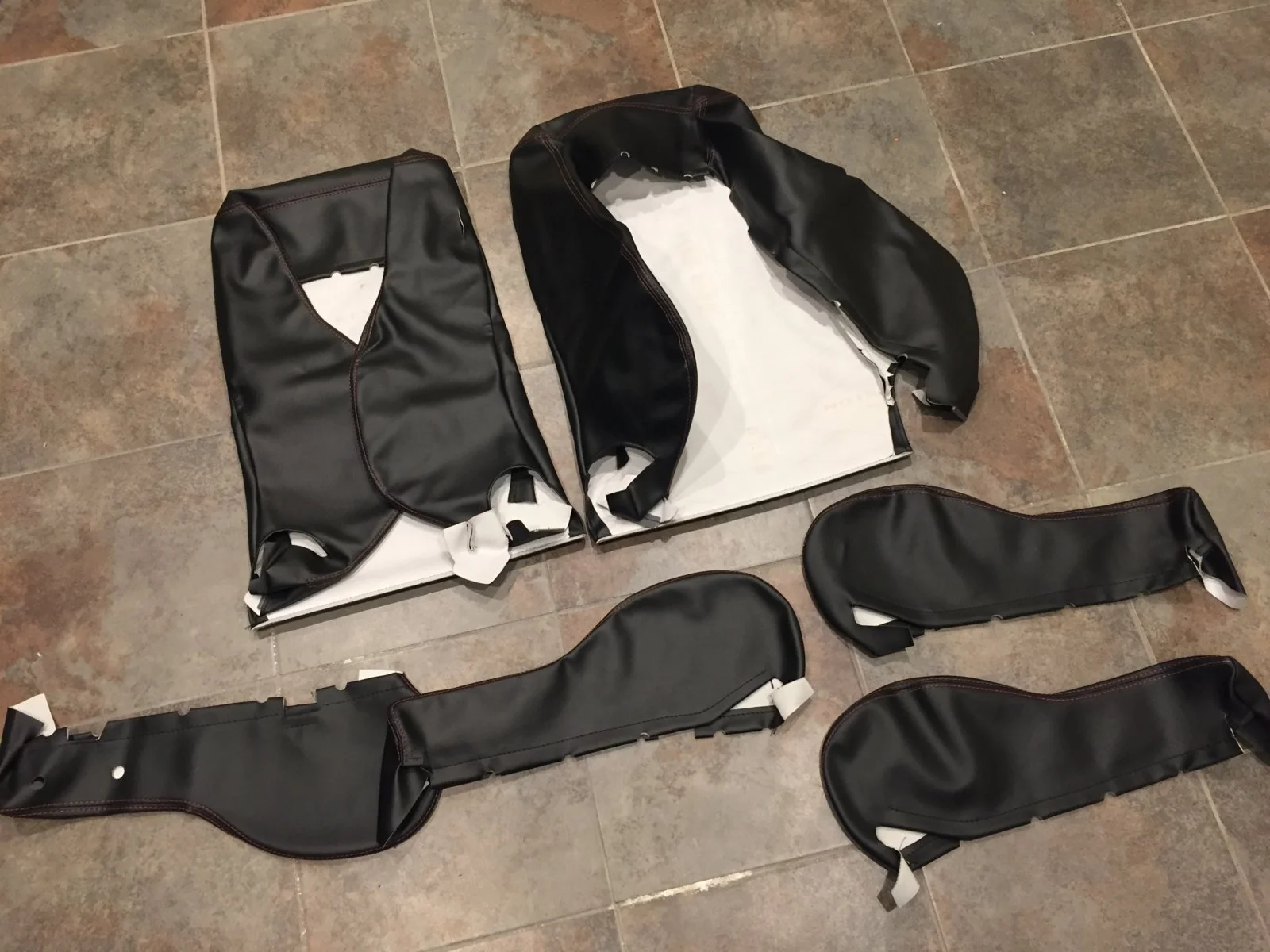

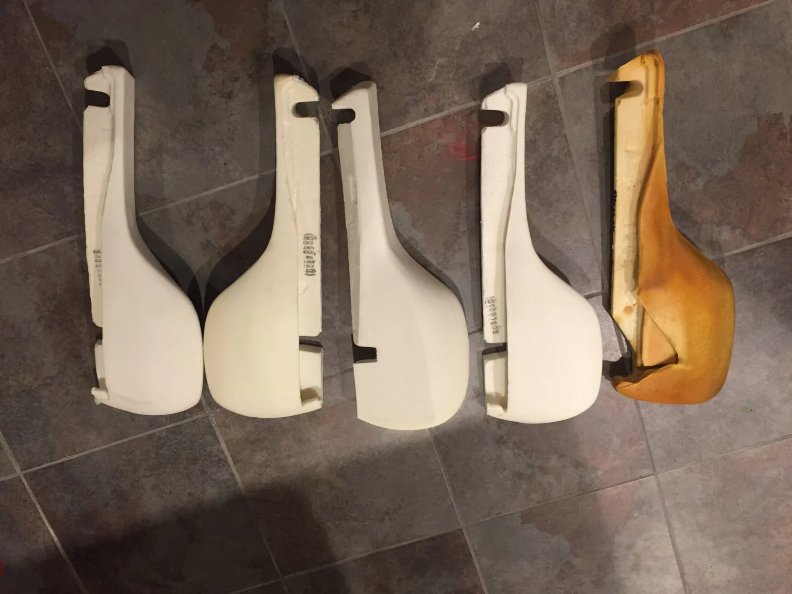

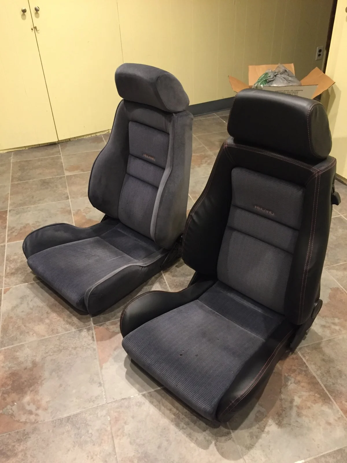

This is what I bought. Everything to duplicate the above seats minus the center sections. I'll still need to get those redone.
In the pic, all four lower bolster covers, the upper jackets, headrest covers and a bolster for $150/shipped. That bolster alone is about $100/shipped.
I'll just dump my extra parts on eBay when done.
In the mail. Hopefully this idea works out as good as it seems in my head
Oh, my other bolsters arrived from the UK today. Selling that original on EBAY along with the extra bolster I'm about to receive. Should put $100-125 or so back in my pocket.

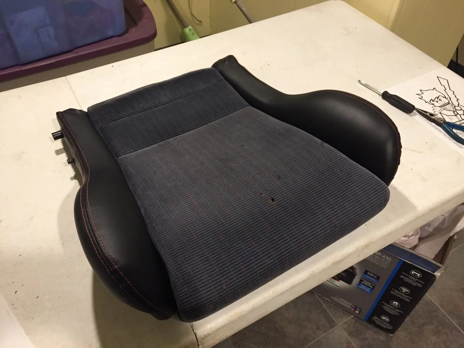

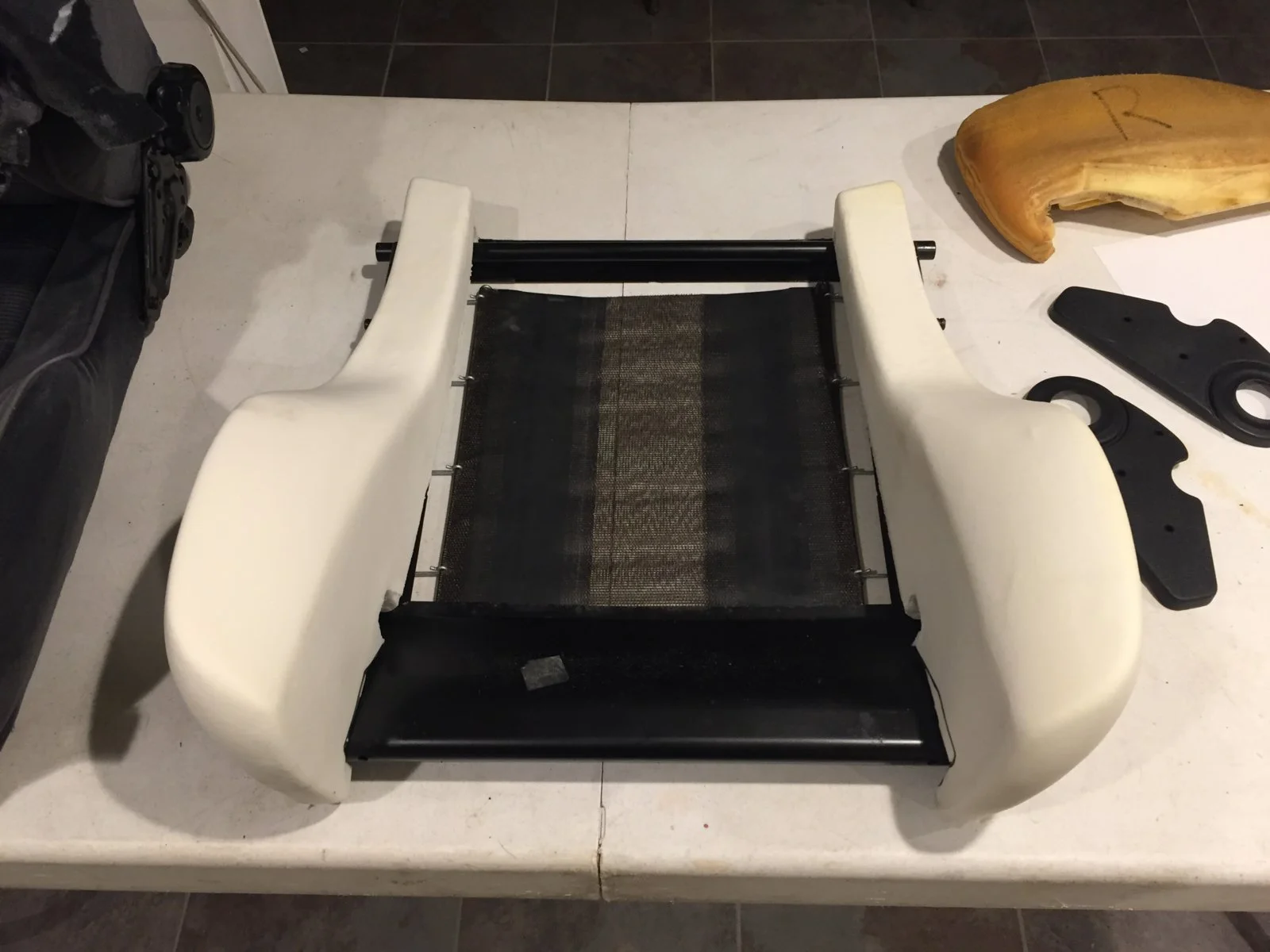

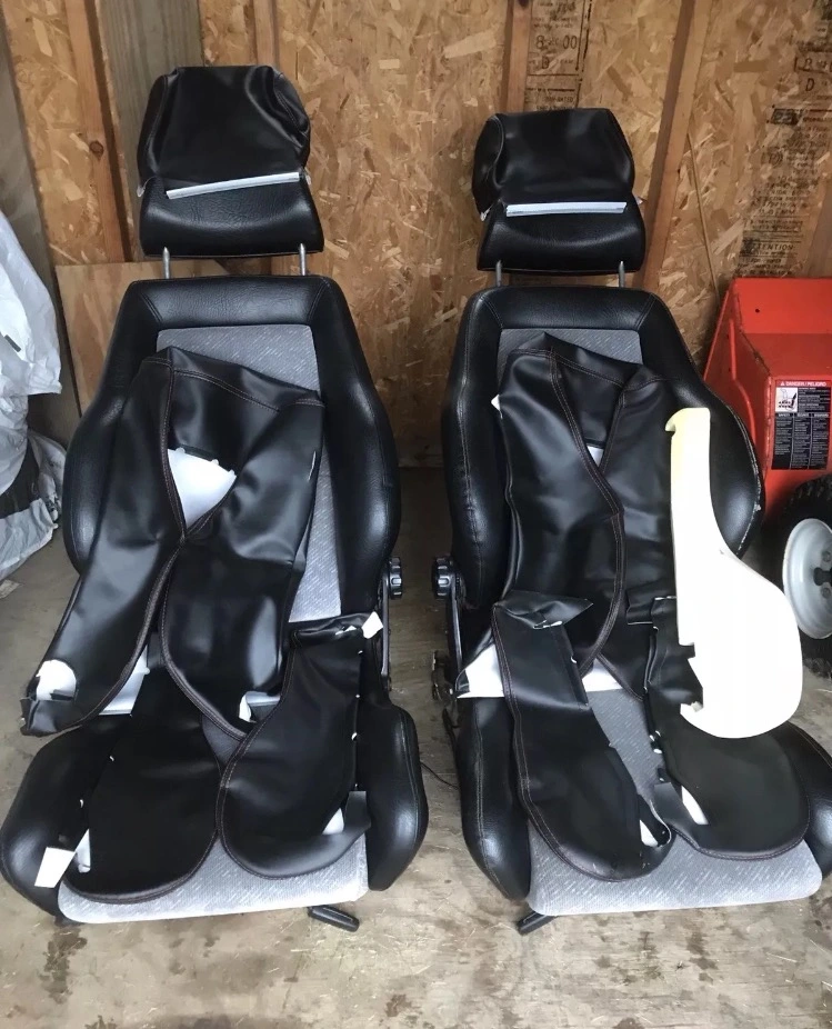

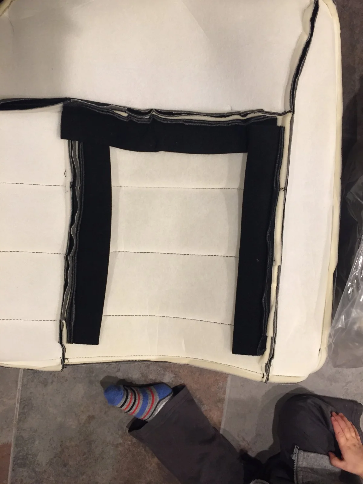

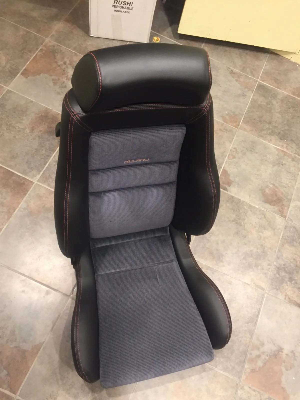

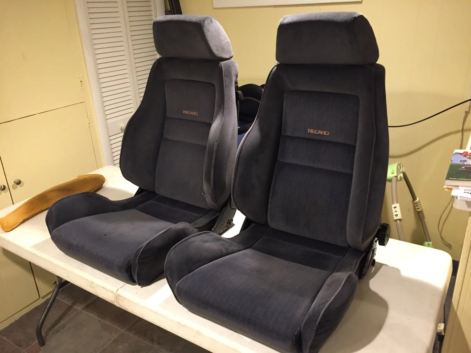

Since it's so easy to put these seats together, I threw one back together just to see fit and finish of new bolster.
Good to go. Just needs to be recovered now. I plan on reselling these old covers as well. The VW guys scoop these up.

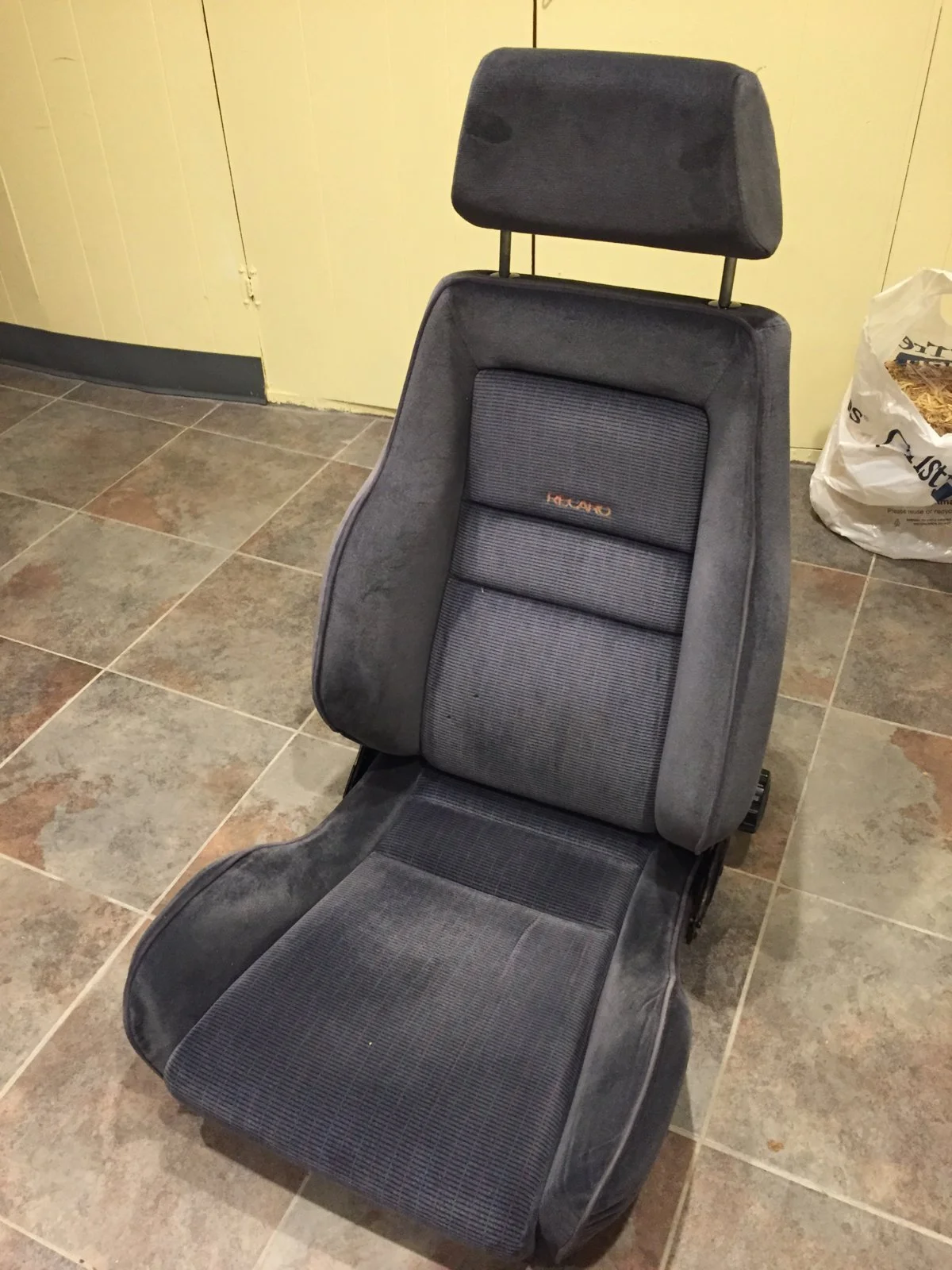

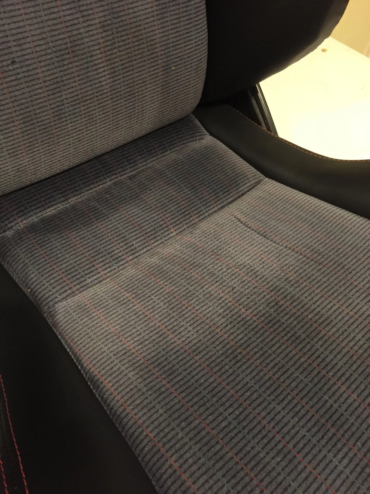

Eh, I did the other one too. These things are so damn comfortable. Washing the covers was a great idea as it brought a lot of life back into the material.
Stay tuned for the new covers. They are in the mail

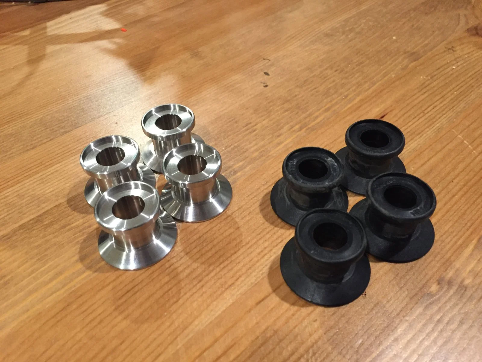

These are the rollers that the flip forward latch catches onto. The originals had some wear that translates to a loose fit. I looked online and new rollers were available...for $70/shipped.
So I whittled some out of SS myself. Made them a little tighter as well

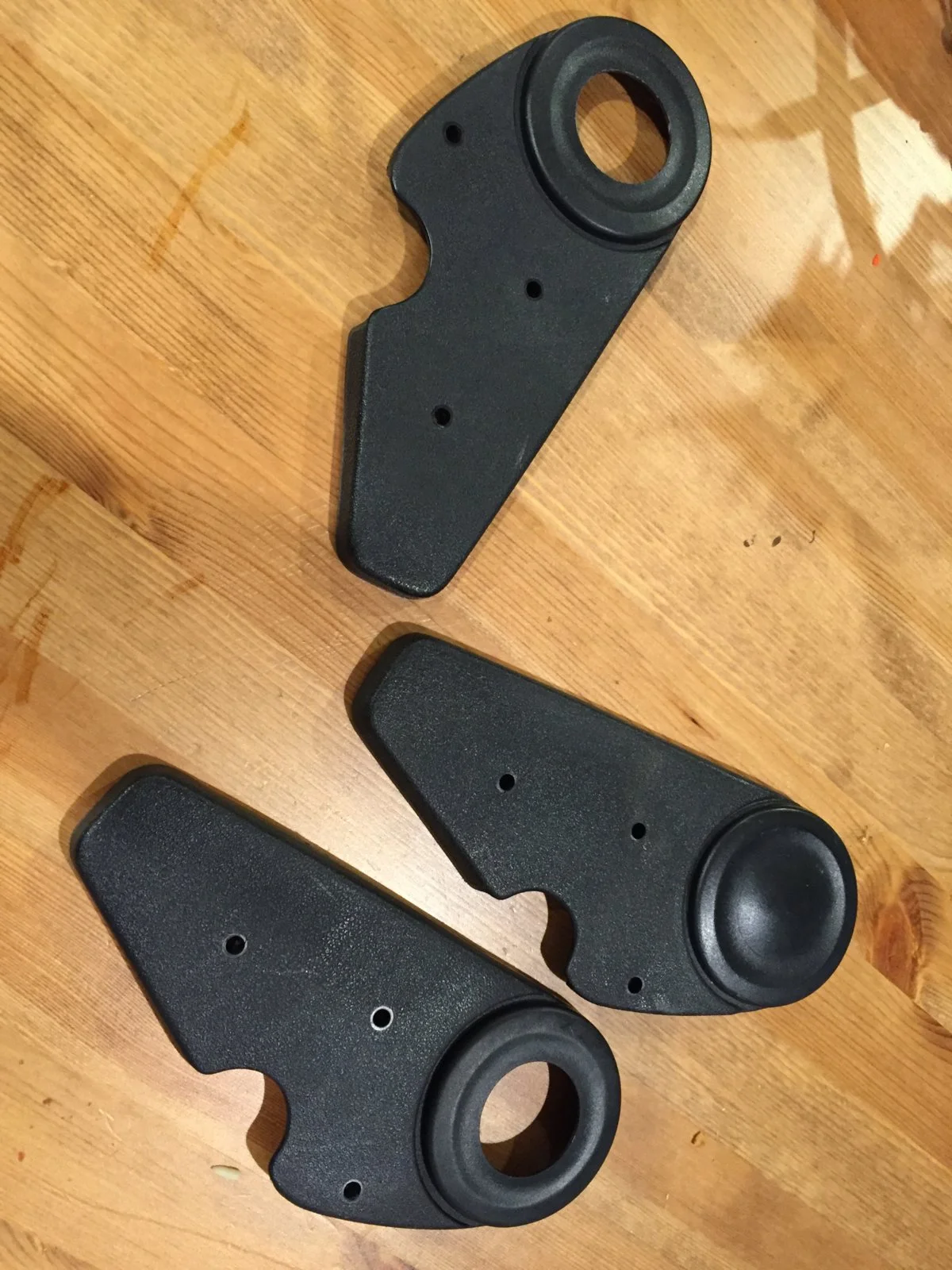

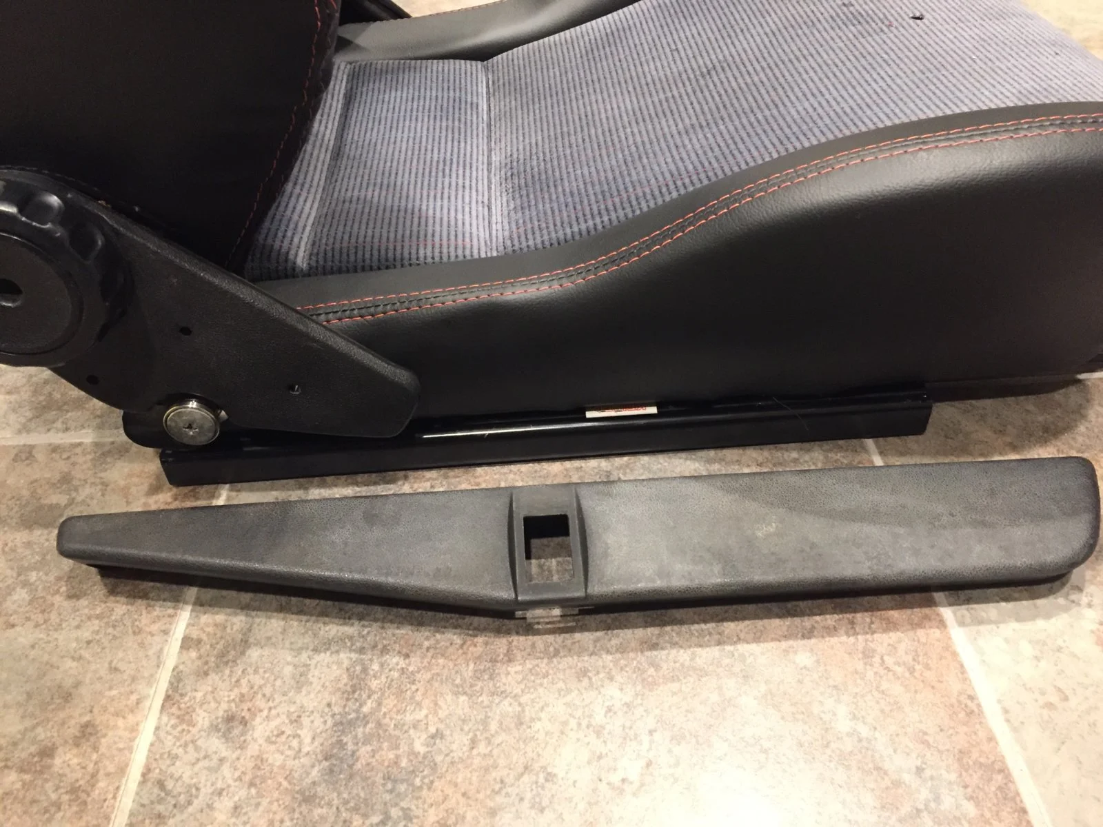

Side plastics are mostly here. The last one is on its way from Erope. These weren't bad. $50 or so total. They are VW parts which lack the Recaro branding but are much cheaper.
Part numbers, for reference;
With adjustment knob hole:
Left - 191881479
Right - 191881480
Without hole
Left - 191881477
Right - 191881478

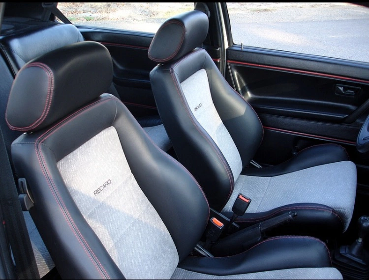

I posted this before, but this is How it should look but I don't have the center inserts.
I'll see if I can get one set on tonight

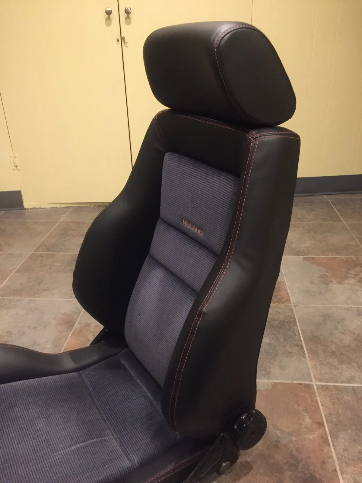

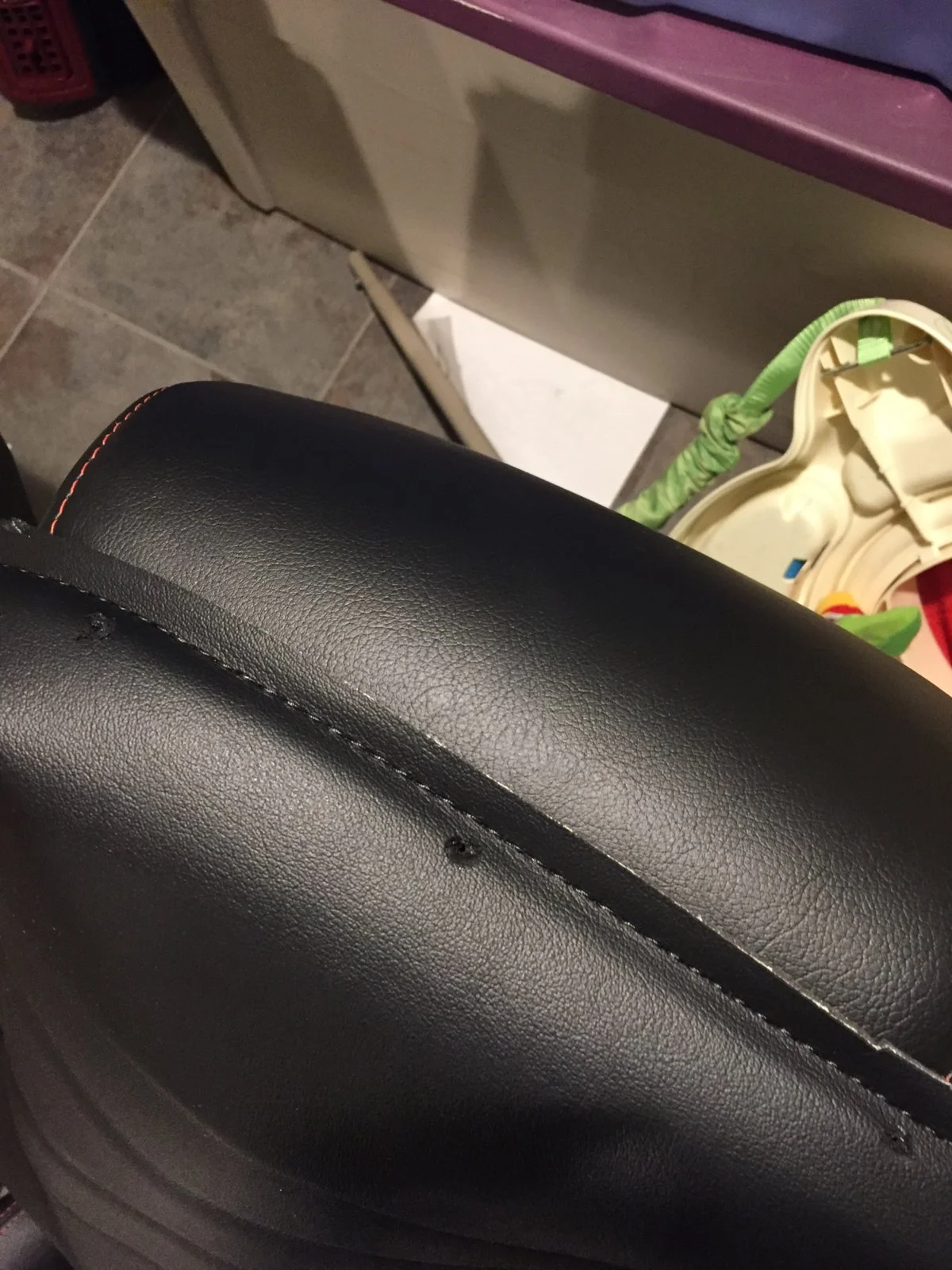

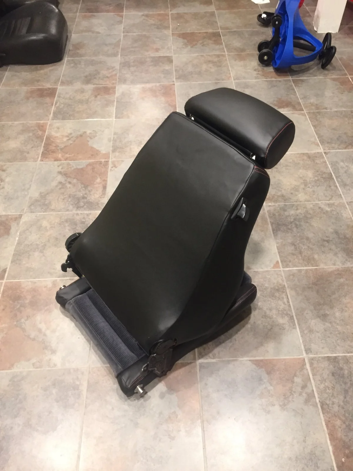

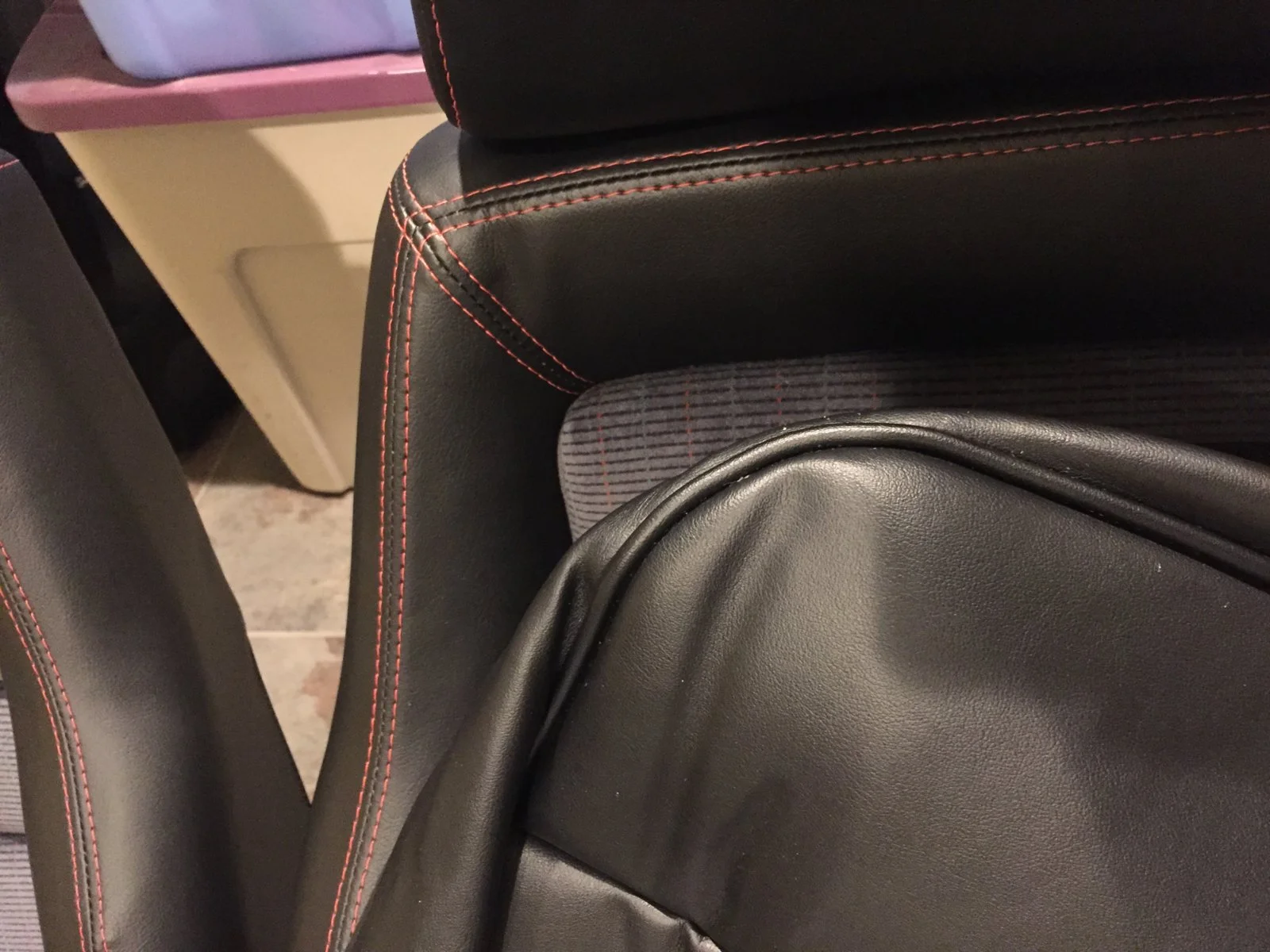

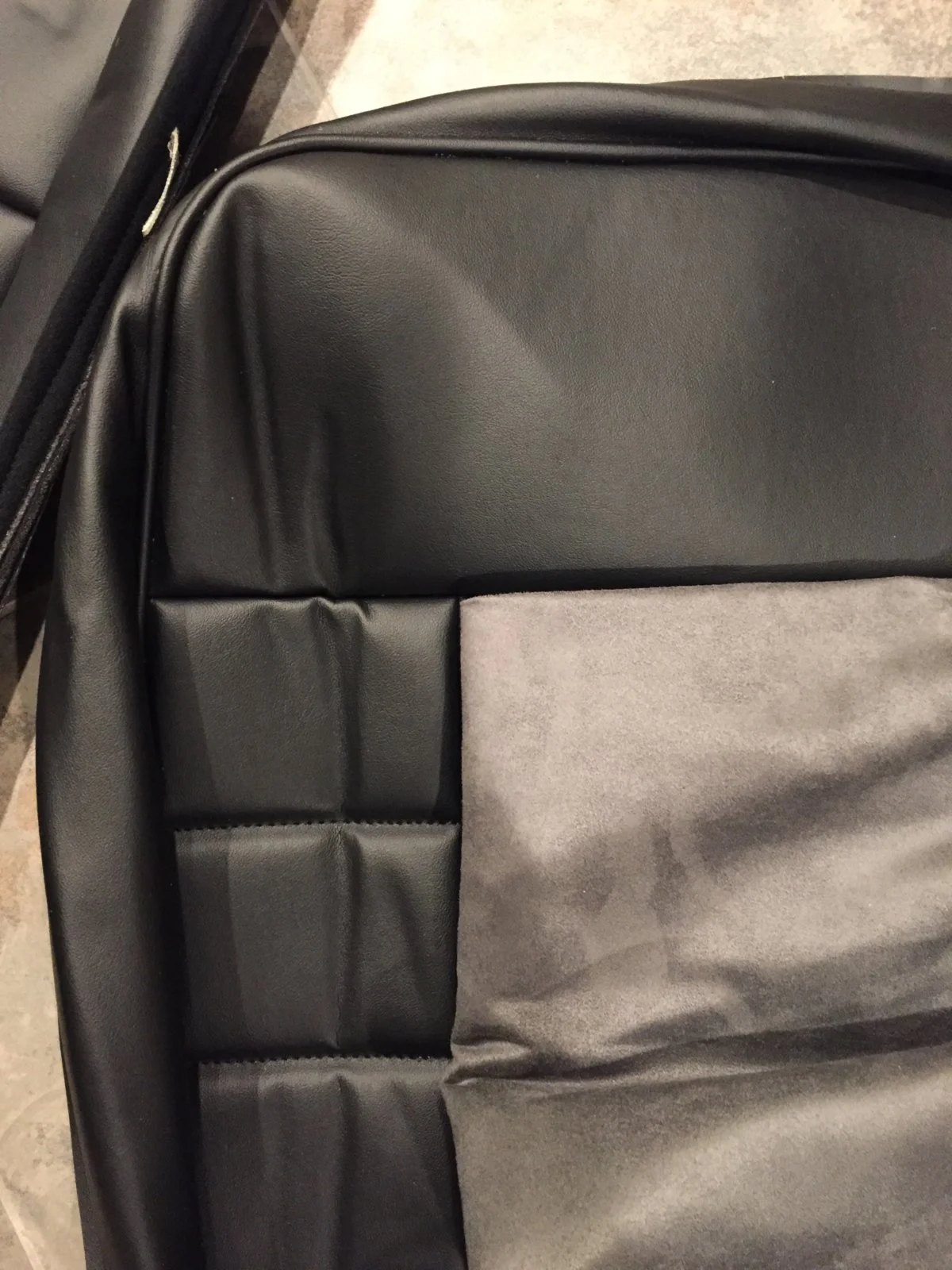

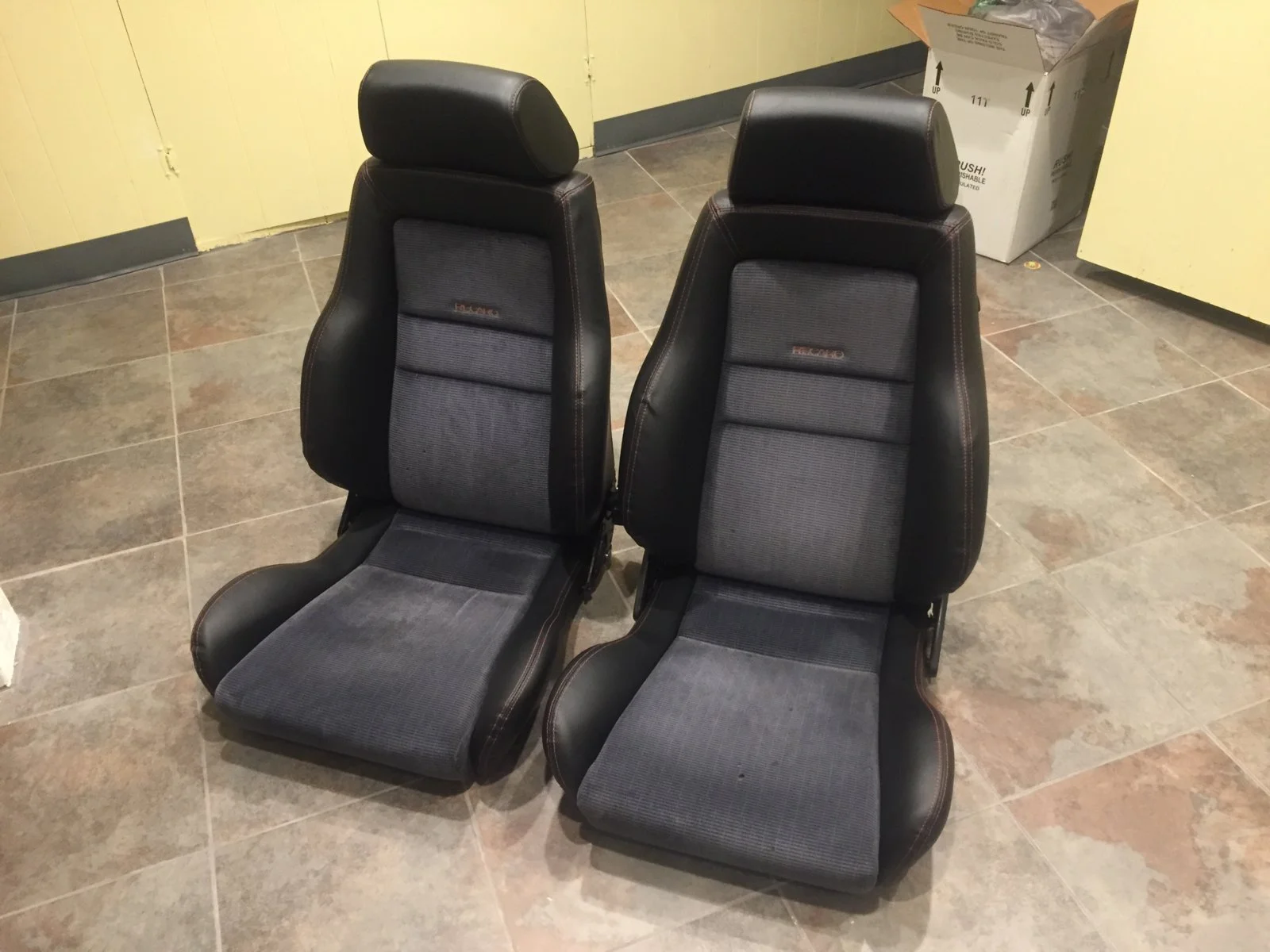

Worked on one a bit tonight. Not quite done with the top. Got all wrinkles out of bottom bolsters but top needs a little more work. Headrest cover is also being a PITA. But had to stop here for evening. One thing I've always disliked about aftermarket seat covers is when they look loose and wrinkled, so i'll definitely be working these covers a bit to get them stretched on nice and tight.
But for $150 I'm pretty satisfied. Fits pretty tight once I get it all stretched on properly as you can see from the bottom bolsters here.
Just need to work that inner side bolster a bit more to get that material to lay flat and get the headrest clipped properly so it's tight as well.

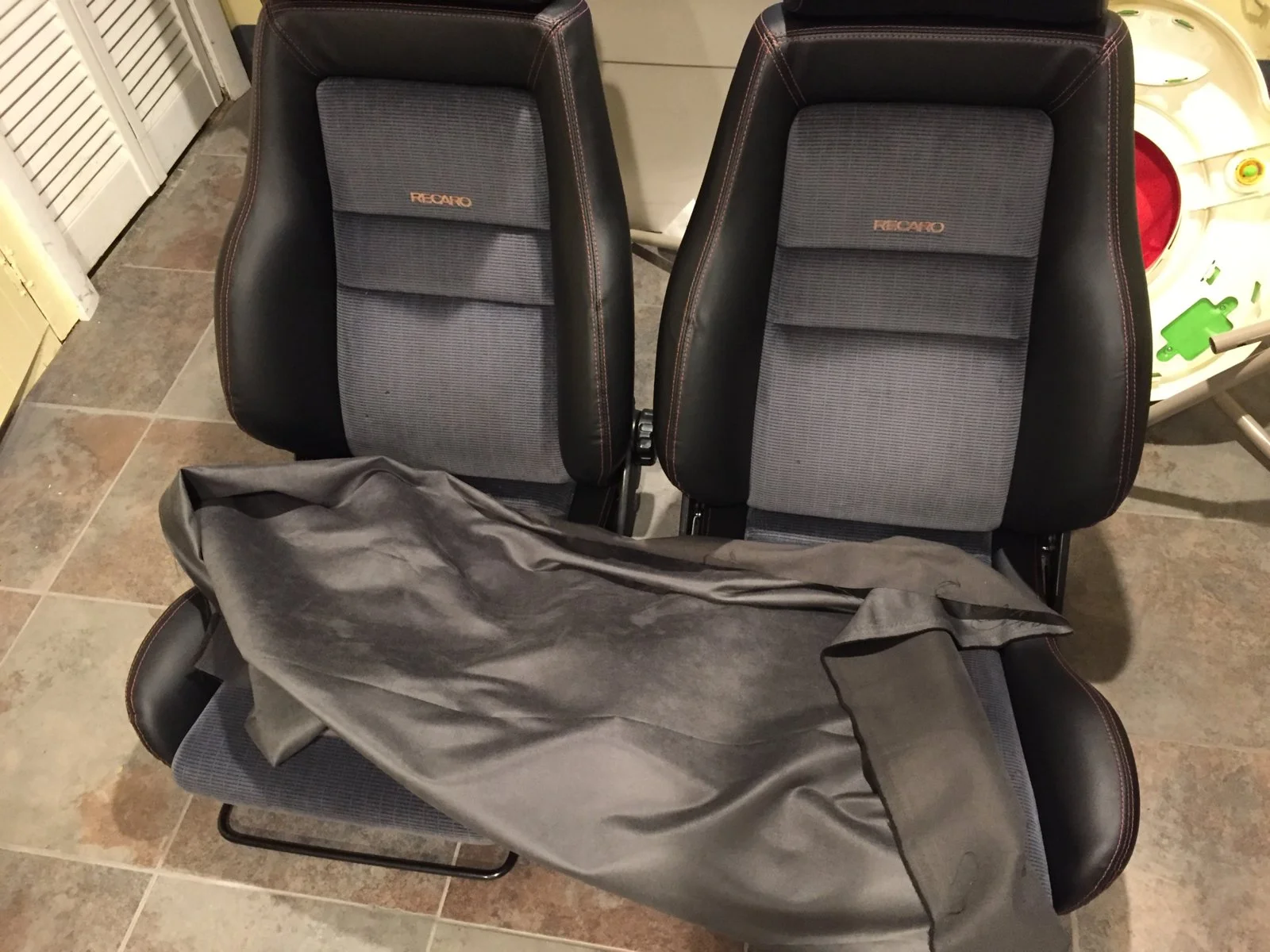

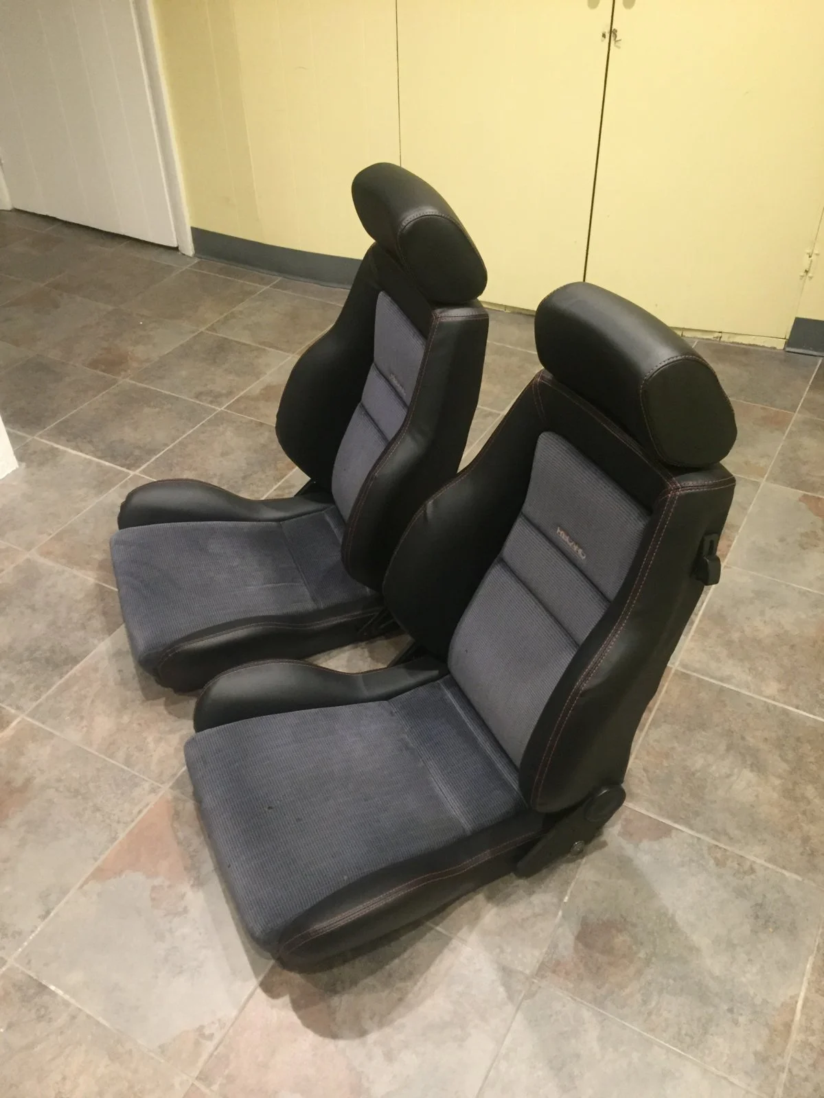

Done for now. Wish it was sunny and 90 to throw these in the sun for a few hours to tighten them up a bit more. The seats themselves were easy. The headrests were a bitch.
I've got Recaro sliders in the mail, and just need to get the seat mounts.
Center section is actually blue. Looks purple for some reason.
Now to decide on what to do in the center? Vinyl? Cloth? Alcantara? Black? Dark gray? Light gray?
Toss me some ideas.

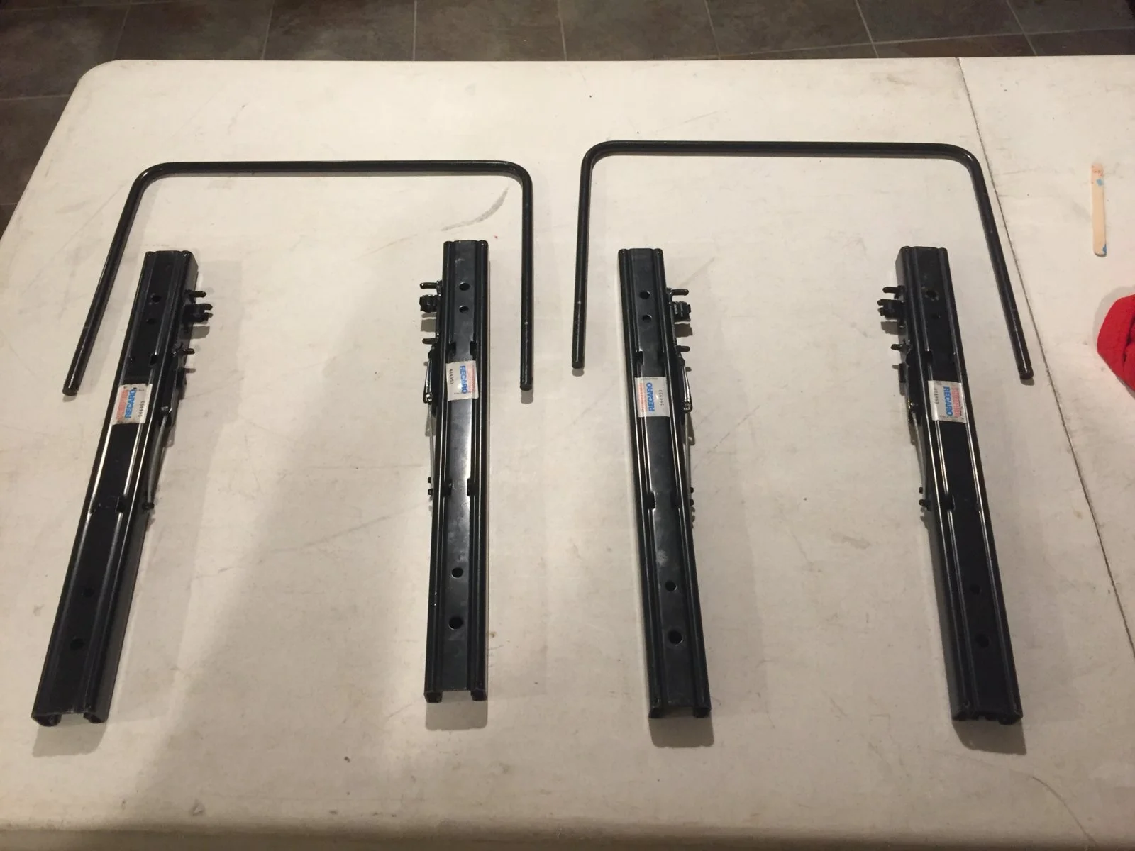

Sliders came in. Bought them used as I hated the idea of paying $135 each
Recaro Brand

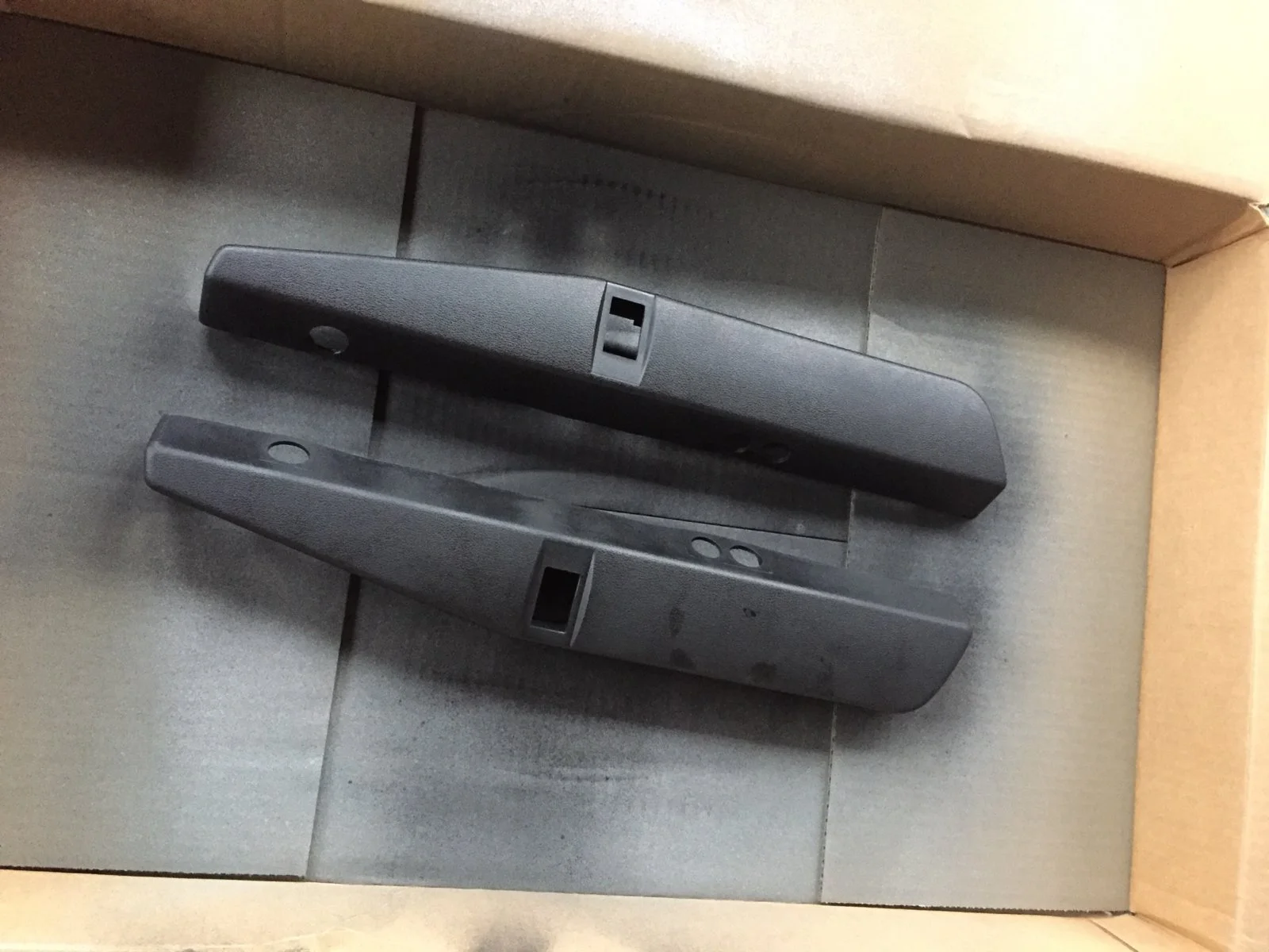

So since the sliders and seat mounts will be exposed, I was searching for a way to cover them up. Picked up a set of Recaro side skirts from a VW.
The hole is for a switch, which I have. Unsure if I want to use it though. I have thought about adding a Mustang style lumbar bladder and the switch would work well.
However I also though about filling the hole and covering the entire panel in some matching fabric.
For now, SEM black paint.

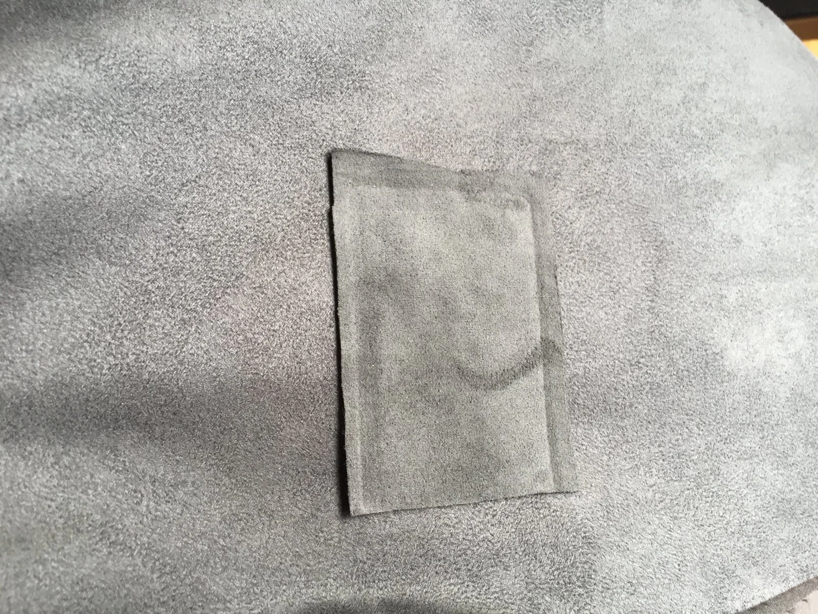

I bought a yard of gray alcantara that matched the unisuede sample I got from TMI. I'd like to recover the door pocket trim panel on each door to match the seat. Of course that won't be until I actually do it.

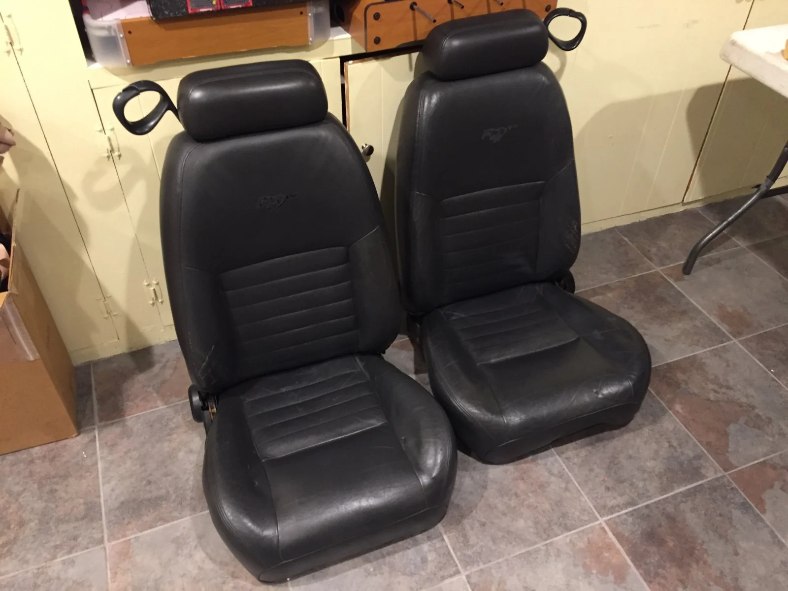

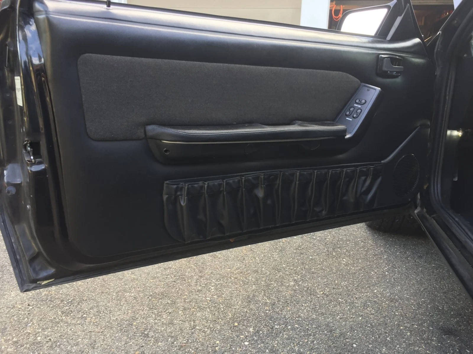

Scored a set of door panel inserts. I'll try stripping them down and recovering them with the alcantara. Of course I should wait on that until I get the centers redone of course. But my plan is to replace the black tweed inserts (those seats are long gone but wish I kept them) with alcantara
Still getting quotes on the centers. Got a few "holy crap" quotes.
Remember when I almost did this?

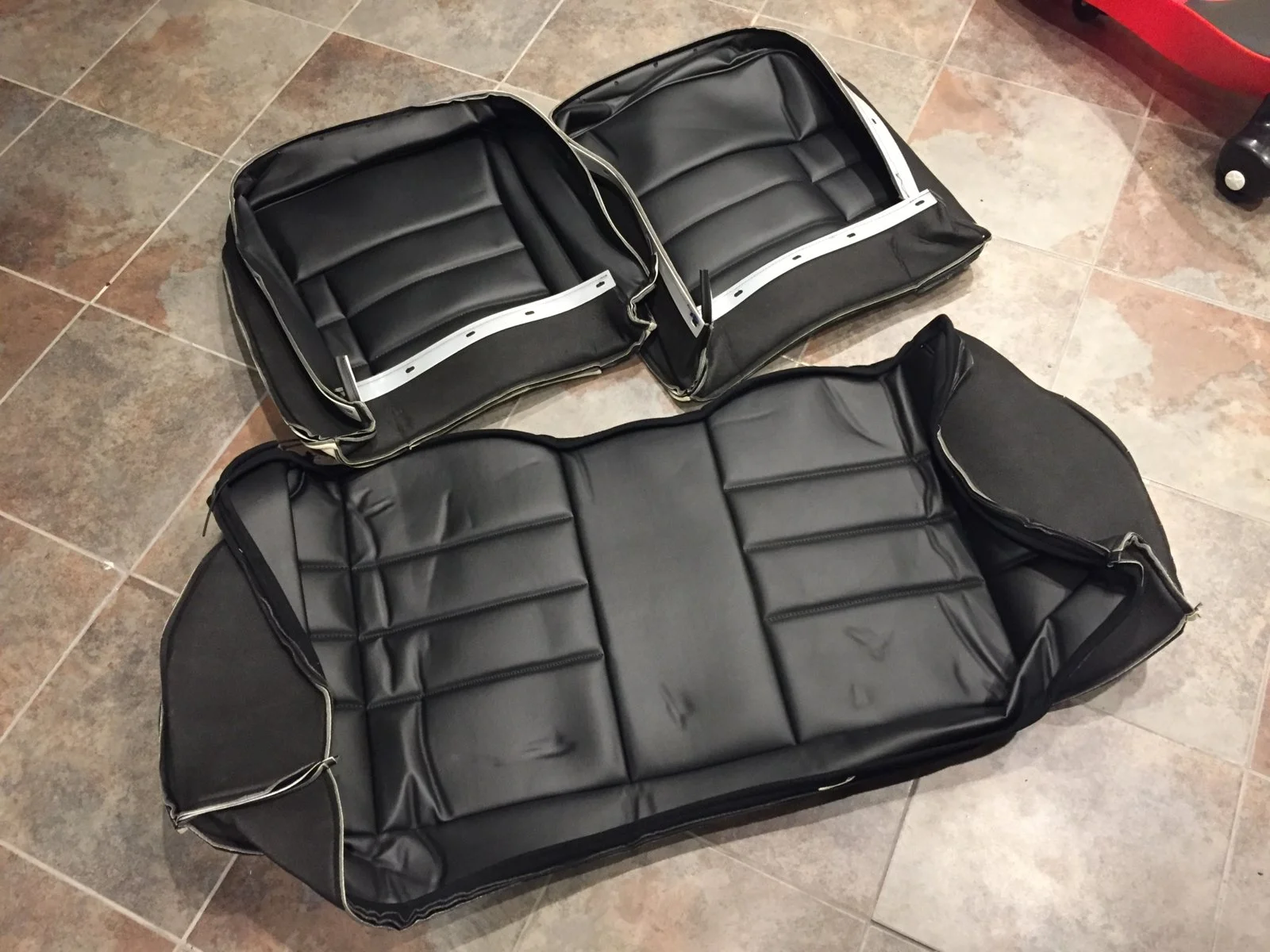

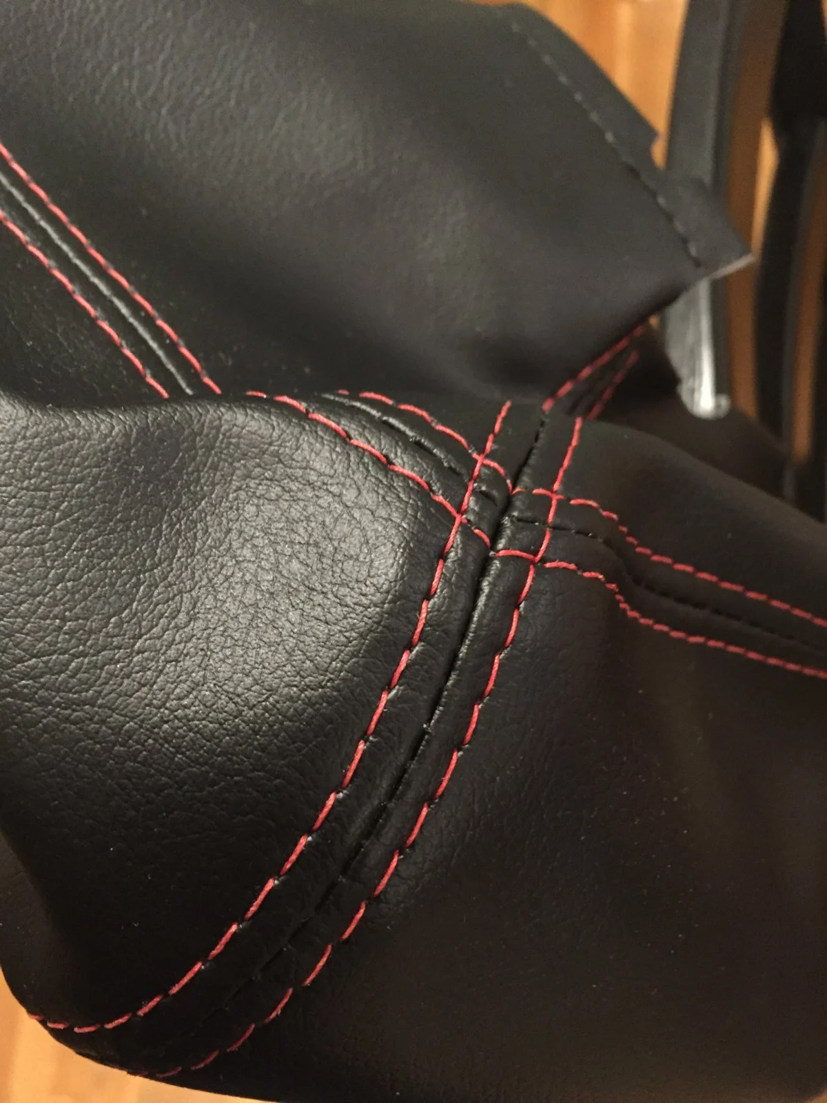

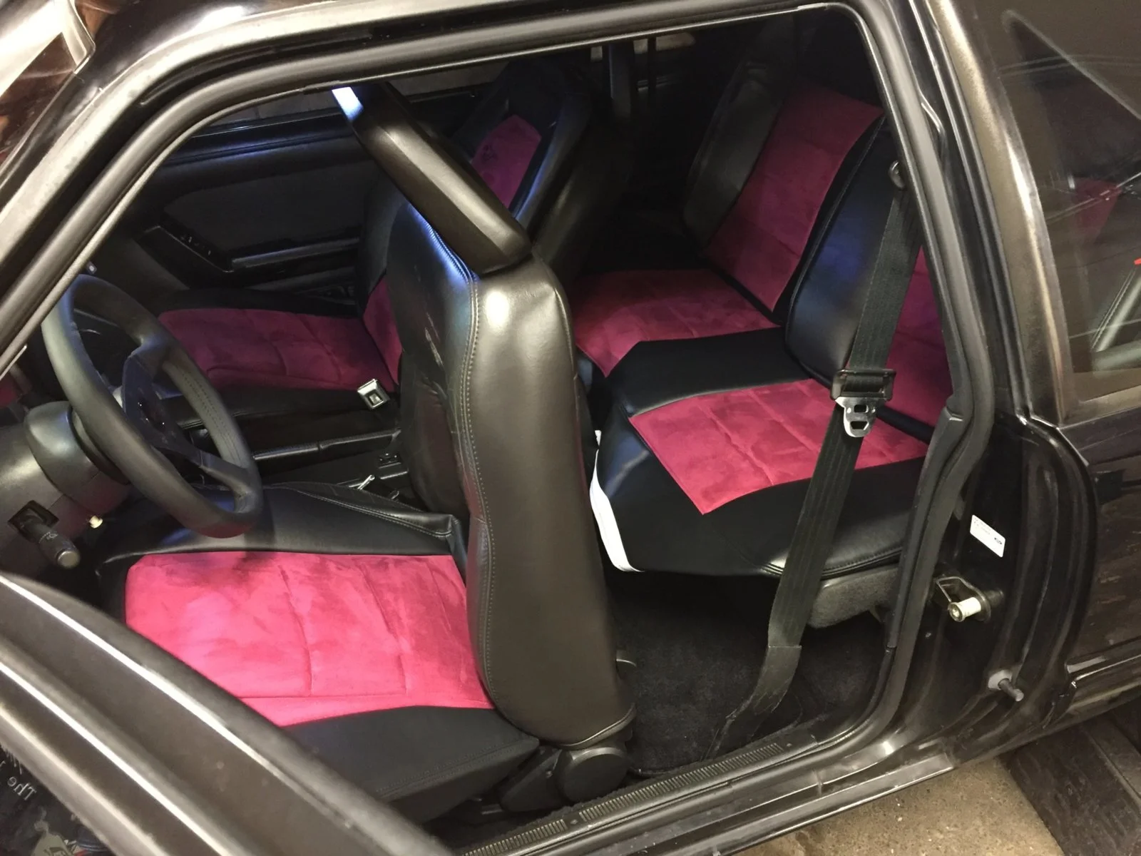

So I took advantage of LMRs 10% off Black Friday coupon and bought the Corbeau rear vinyl seat kit. Its most likely not what I'll run long term in the rear, but for $130/shipped I'll toss it in for now and revisit a custom rear seat later on.
It's pretty close, but there are differences such as piping vs the red stitched French seam. Headrest of the Recaro (you can see the red stitch) vs one of the corbeau covers
Later on I'll have the whole back seat redone. Maybe they can use this and just change the piping to a matching seam and add the alcantara inserts. That will come later.
Oh and one shop quoted me $780 for just the inserts on the front seat. Still searching around. I need a passenger seat mount too at $140. Oh I gotta finish my MM coilovers still. Need $700 worth of struts and a bumpsteer kit.
That's why the corbeau kit is going in the rear for now.

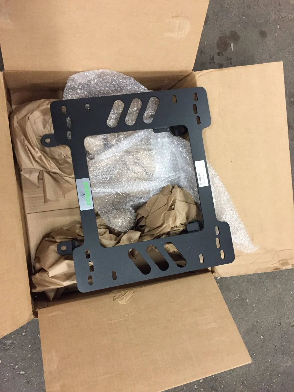

Seat bracket is here. Nice piece, however for $140 each they should give you hardware. Instead that's $6 each seat extra.
But it's nice and strong
Now let's toss one in
