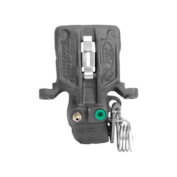

Interesting. So it bolts right up? What pads the Taurus or Sn95?
I want to know this as well. I maybe be changing over to these to add with my 05-09 GT front calipers that Im running

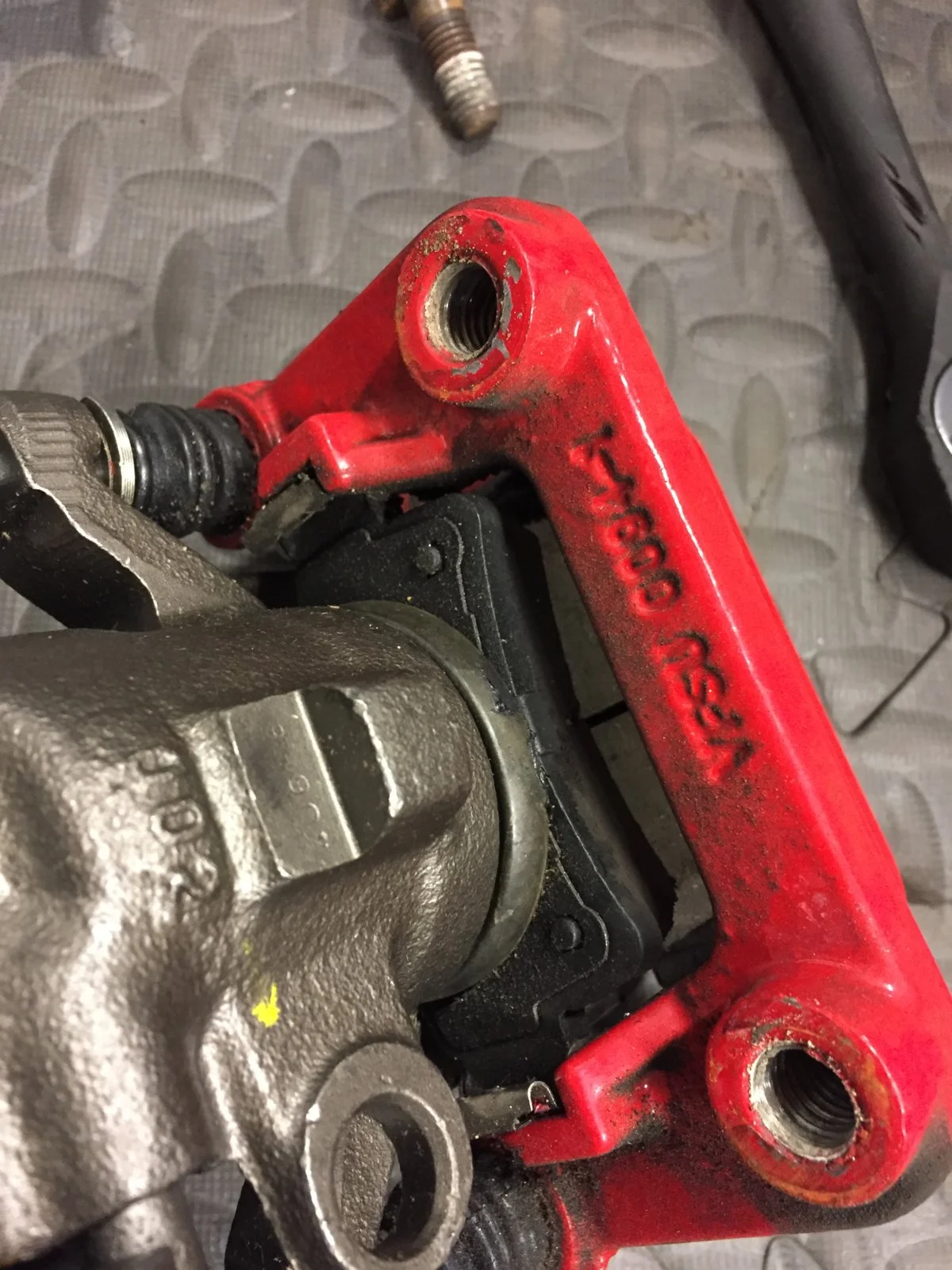

Sn95 pads.
The only part you need to change out is the actual caliper that has the piston. Everything else stays the same.
Cardone 18-4537, and 18-4536
This is all you need to swap. Everything else is SN95 mustang (rotors, brackets, pads, line, e-brake, caliper bracket)

Interesting...so they use this in a true 4 door passenger car and not the mustang of those years.
On a 10.1” non-vented rotor as well.
The 93-00 Lincoln Continental got the rear 43mm calipers as well
Selecting an MC to use with these and the ATS Brembos is tricky. I’ve been doing some math and ideal MC is in between the 93 cobra 1” and the 94/95 GT 1 1/16”.
The 1” is a bit on the soft pedal side, and the 1 1/16” might be only slightly firm. Looks like 1 1/16” might be the one to try

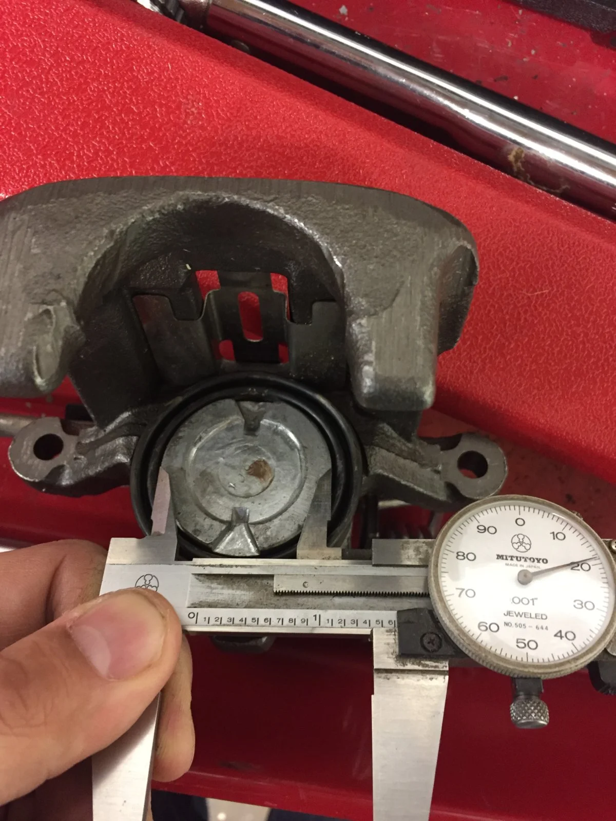

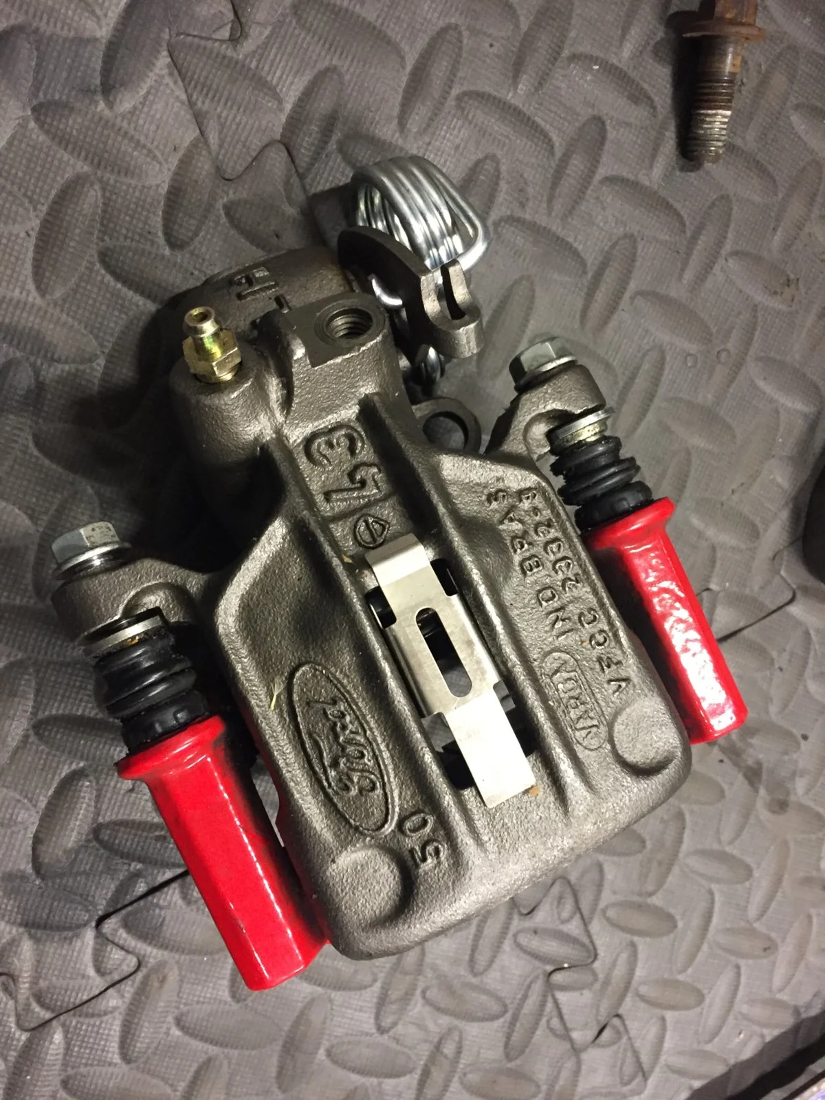

Some more Caliper pics. Fits perfectly
I measure right around 41-42mm but can’t really fully measure the piston OD. Online spec claims 42.8mm

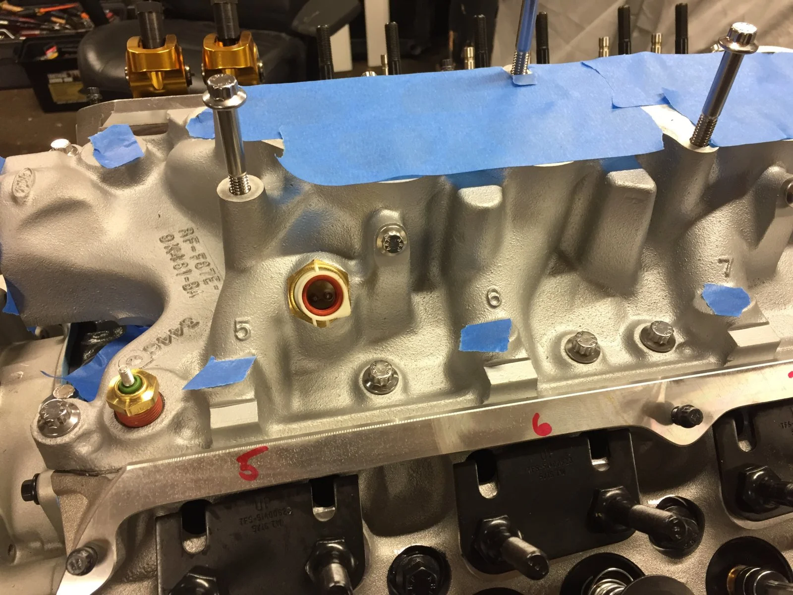

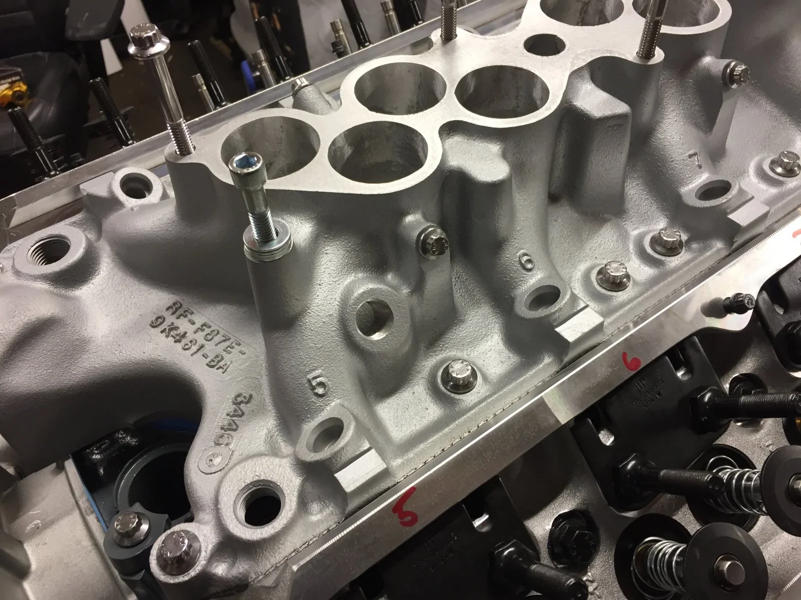

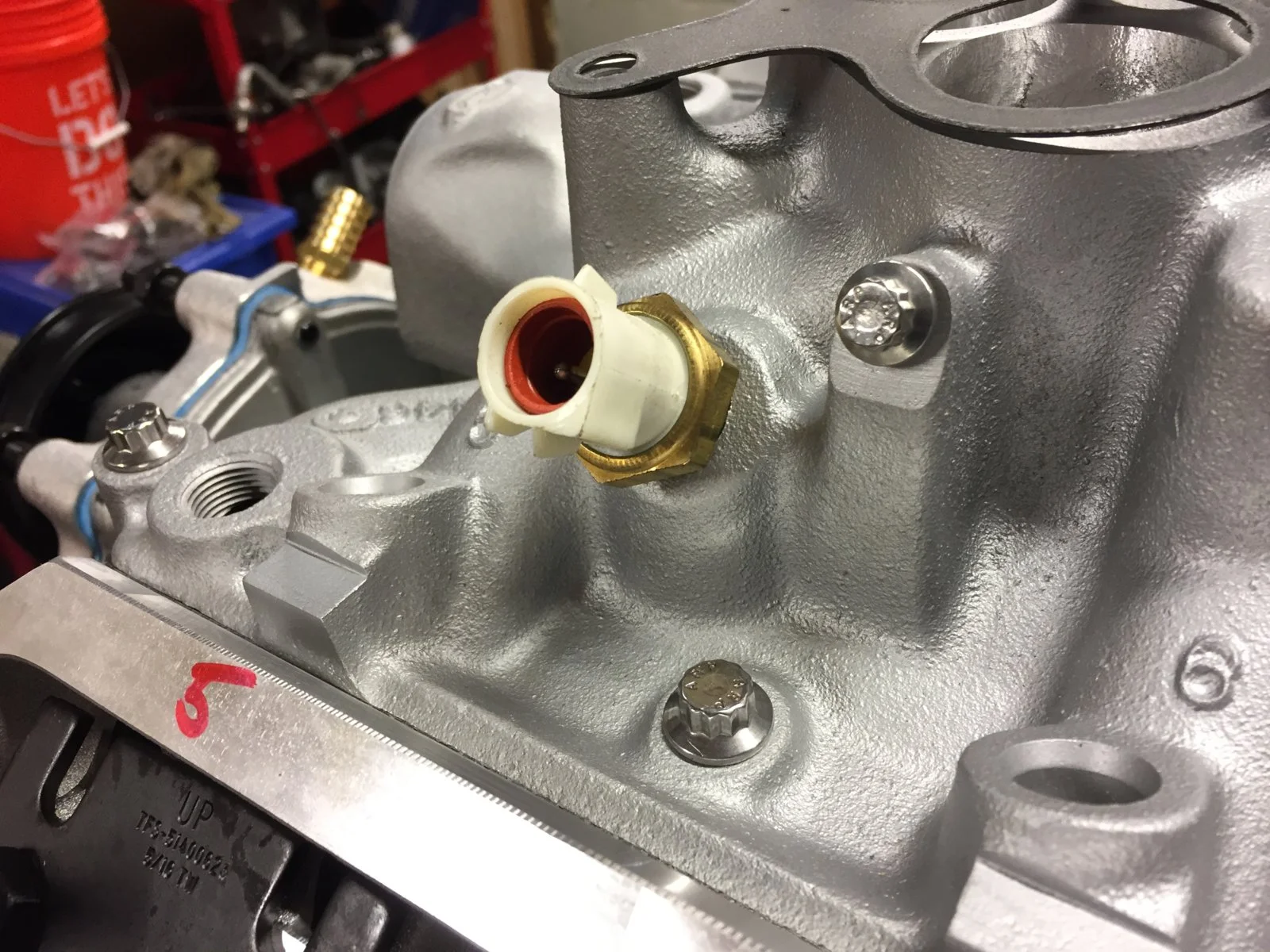

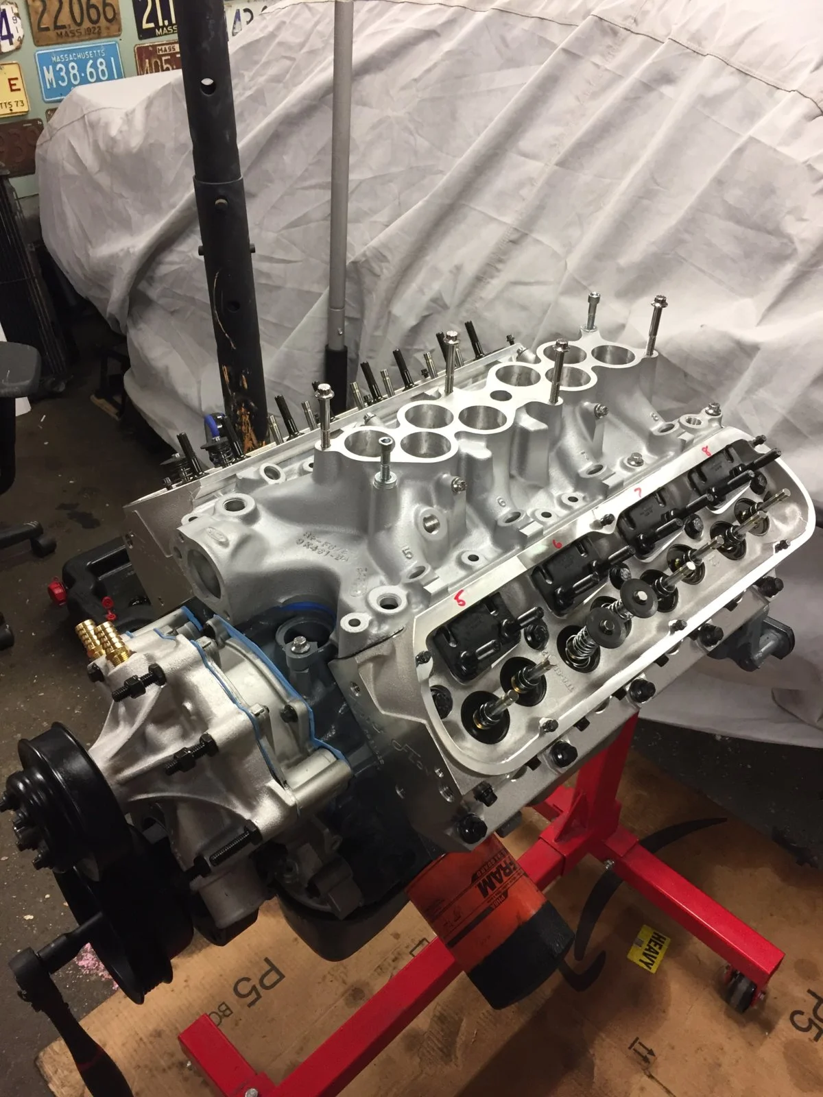

Back to the motor. Finalized my pushrod meaurement. Ended up at 6.800”. Most people say TFS heads are 6.700-6.750”, but I felt I got a tighter pattern and closer to the center of valve with 6.800”.
With that done...I bolted on the intake
Took the opportunity to dress it up a bit with ARP hardware and new Motorcraft sensors of course.
Now, it’s all the little odds and ends. Need a new PCV grommet, the nipple for the egr coolant line, misc other hardware. Plus I need to “restore” everything else, like the heater tube and fuel rails.
Oil pan stud kit comes Friday. That’s next.
This motor really looks nice. Can’t wait to get it in the car...and hopefully it’s oil leak free!!

It's normal for me to not pay attention to a stock 5.0 build, but your attention to detail, and obsessive level of perfection- ( numbering the ports on the head, when an arrow pointing to the front, or the letters p&d would've made that an automatic thing) , make it so I just have to follow this. You make a build/progress thread what it's supposed to be-- A place to learn something, not just a bunch of pics with a "look what I did" caption at the bottom.

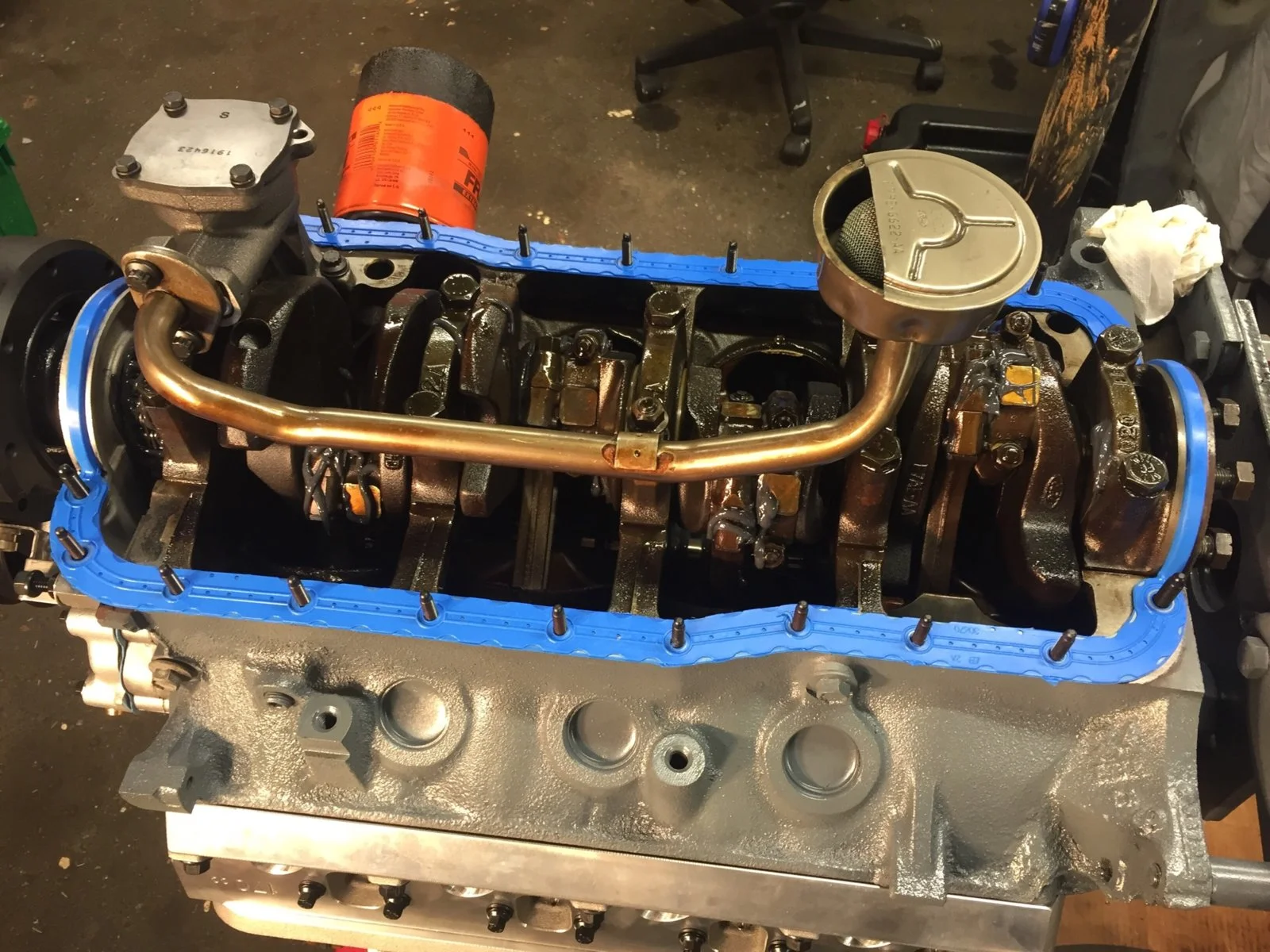

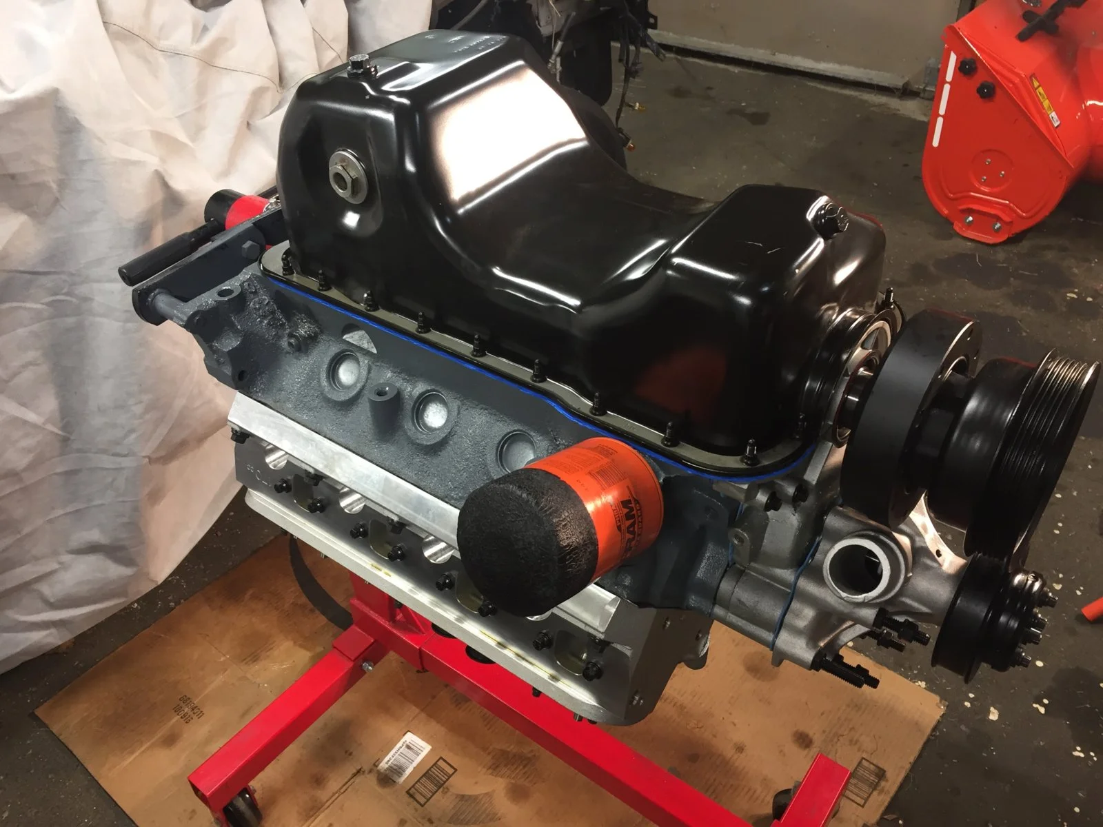

Just plugging away.

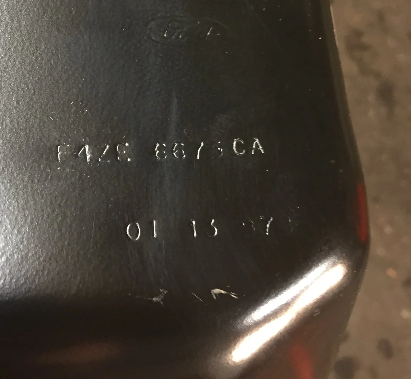

ARP oil pan studs, felpro 1 piece gasket and a NOS oil pan I picked up a few years ago
Reactions: Olivethefet, 90sickfox, Rdub6 and 2 others
Mustang5L5
Mod Dude
Feb 18, 2001
43,336
18,062
224
Massachusetts
Dec 1, 2019
#1,494
  • Dec 1, 2019
  • #1,494
Now my big oops. Needed 6.800” pushrods.... I ordered 7.800
My new Ford racing dipstick doesn’t fit the block hole. Need to investigate this.

What's wrong with the fit dipstick ahhhh I mean dipstick fit?
Slowly getting there
I used the same dipstick on my car. I had to use a bench grinder to wire wheel off the chrome plating where it goes into the block. That allowed it to fit nicely in the block.
