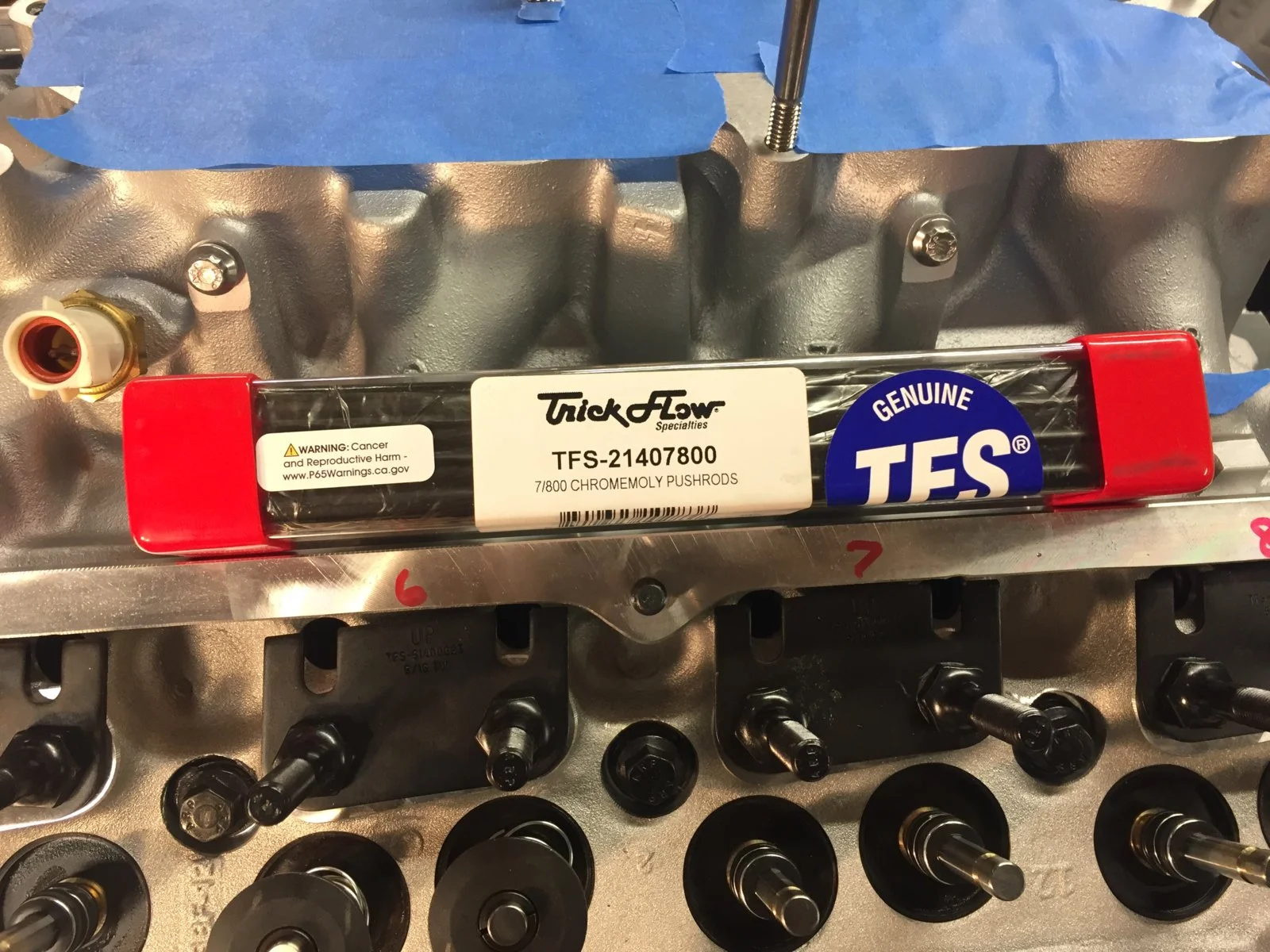

Now my big oops. Needed 6.800” pushrods.... I ordered 7.800

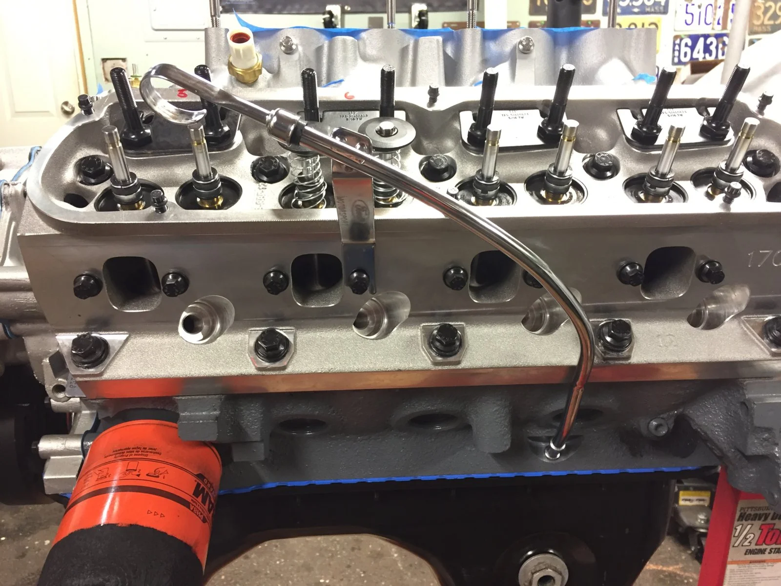

My new Ford racing dipstick doesn’t fit the block hole. Need to investigate this.

Wayne Waldrep said:
I noticed in an earlier post you said 7.8 first then 6.8 the next sentence. I just thought it was a typo. It's my fault for not saying something!
The engine looks really good though!
I don't know how I brain-farted that one. I've had 6.800" written on my white-board for a week now. Guess I was just juggling too much a once. Oh well.
I bought from summit, so should be easy enough to return and get the right ones. Fortunately this isn't holding anything up

02 281 GT said:
I used the same dipstick on my car. I had to use a bench grinder to wire wheel off the chrome plating where it goes into the block. That allowed it to fit nicely in the block.
You're just a magnet for NOS parts at great prices, aren't you?
That's what I figure i'd have to do. Shouldn't be too much work I guess.

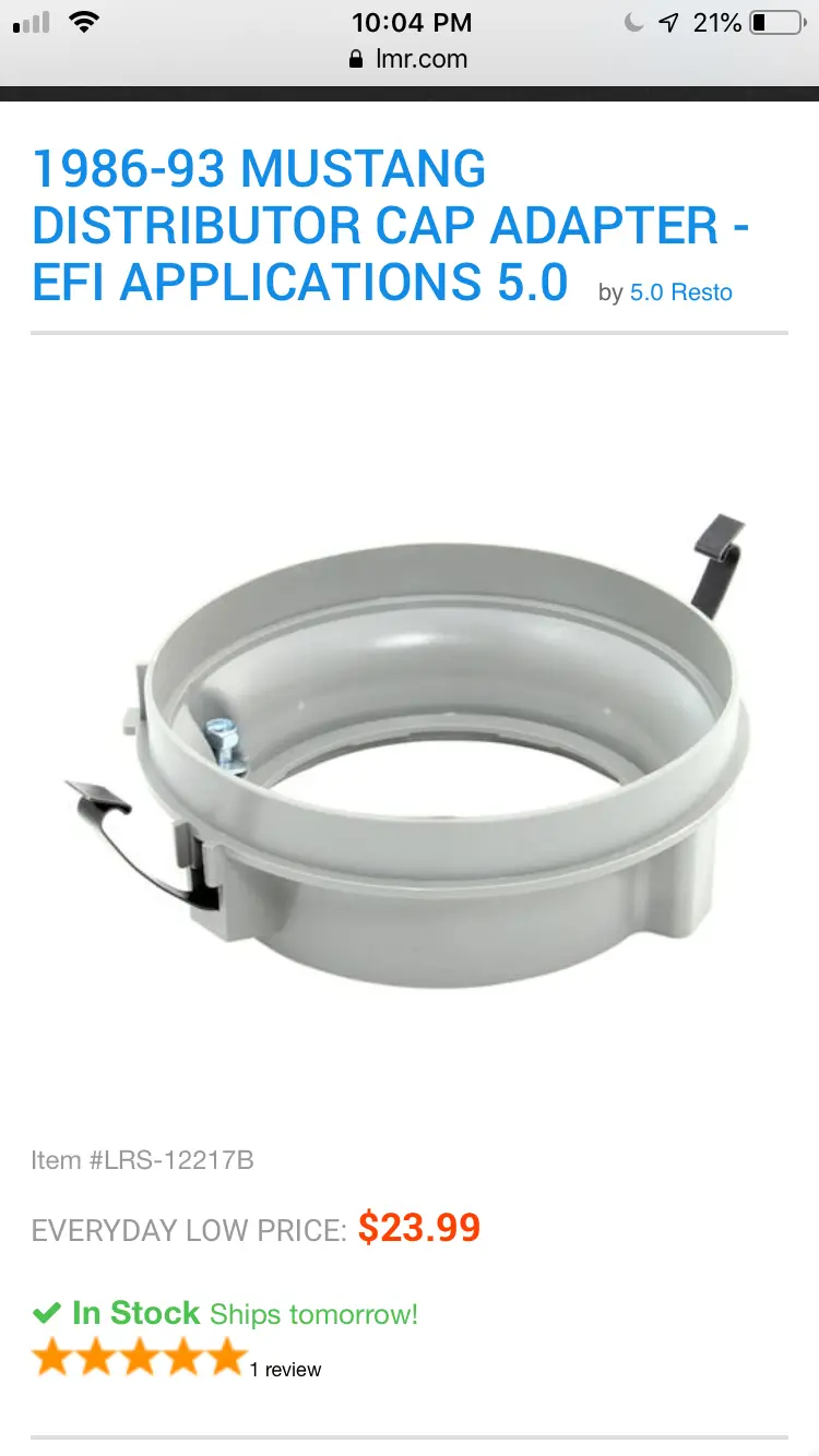

Anyone ever see this part in black? Or am I better off painting my existing?
Time to start refurbing various brackets and parts going back on the engine that aren’t new.
I trust my original 31 year old dist more than a reman
Wayne Waldrep
Before I post a pic, do you have one of yours?
20+ Year Stangneter
Apr 14, 2003
1,338
659
143
Cuba, AL
Dec 1, 2019
#1,509
  • Dec 1, 2019
  • #1,509
I paint mine black. Never seen one made in black.

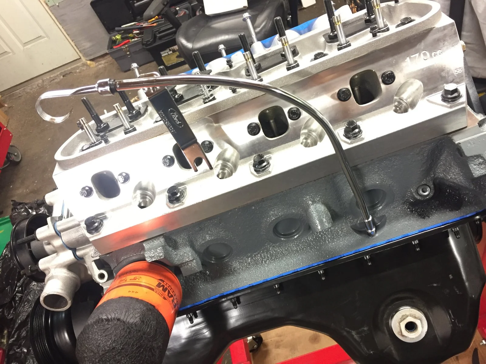

A little massaging of the dipstick and it went right in.
I realize the header needs to go on first. But it gives the illusion of progress.
Oh and ignore the FRAM oil filter. I had it kicking around and will just use it up until I do my first oil system prime. Then i'll toss a nice Motorcraft FL-1A on it

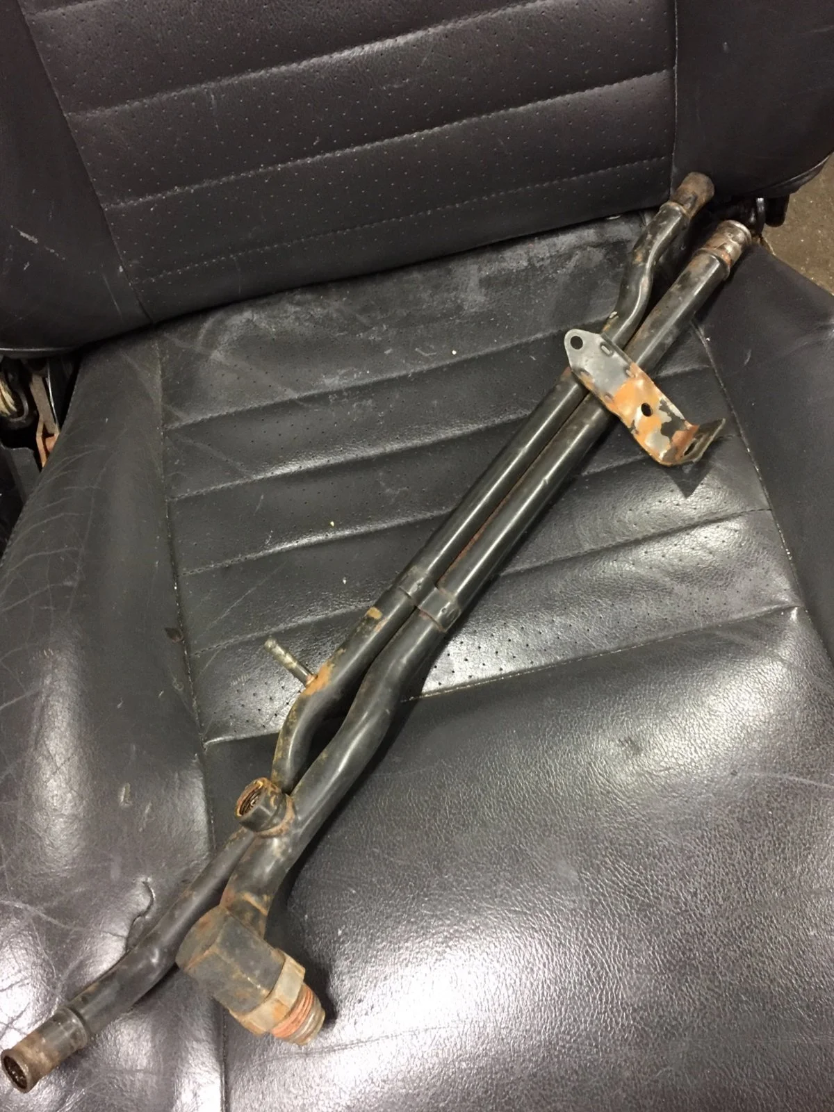

Put a couple drops of oil on the nipple so it seeps into where the o ring (or plastic wedge, can't remember) seals the line before you install that heater tube.
just say'n.
Mustang5L5
Mod Dude
Feb 18, 2001
43,340
18,069
224
Massachusetts
Dec 2, 2019
#1,515
  • Dec 2, 2019
  • #1,515
just say'n.
I was wondering if I should replace the O-rings while i'm here...
How To: Repair Your Leaky Coolant Hardline. ***PICS***
Tools Needed. A vice. Hammer or mallet. Tapered spindle (or something similar). Pick. Supplies needed. 2- O Rings (size 1/2 ID - 5/8 OD - 1/16 W. Can be found here www.theoringstore.com/index.php?main_page=product_info&cPath=367_23_22&products_id=1111 ) Silicone Grease. A Scotch Brite pad...
www.stangnet.com
Or, since it wasn't leaking, I should just leave it alone and apply some oil and call it a day

Not that hard to change if it does leak. Couple drips of oil and stick that dude on there.
what could go wrong?

I replaced my heater tube about a year ago Mike. I ordered it through a Ford dealer here in Albuquerque and it came from Denver. They still had some in stock. $75 + tax
Reactions: General karthief
Mustang5L5
Mod Dude
Feb 18, 2001
43,340
18,069
224
Massachusetts
Dec 2, 2019
#1,519
  • Dec 2, 2019
  • #1,519
Did some searching. Part number is E6ZZ-9D424-B
I checked online and was able to get one for $53 plus shipping from Tasca.
Decided to buy new since it was in a visible spot on the motor. I also got new because the rust area around the egr nipple is a bit suspect.
Reactions: Hoytster and General karthief
BlakeusMaximus
Still got to try a little lube on my speedo head
5 Year Member
Jul 12, 2017
2,477
1,349
173
Dec 2, 2019
#1,520
  • Dec 2, 2019
  • #1,520
Yeah Id replace that too Mike.
