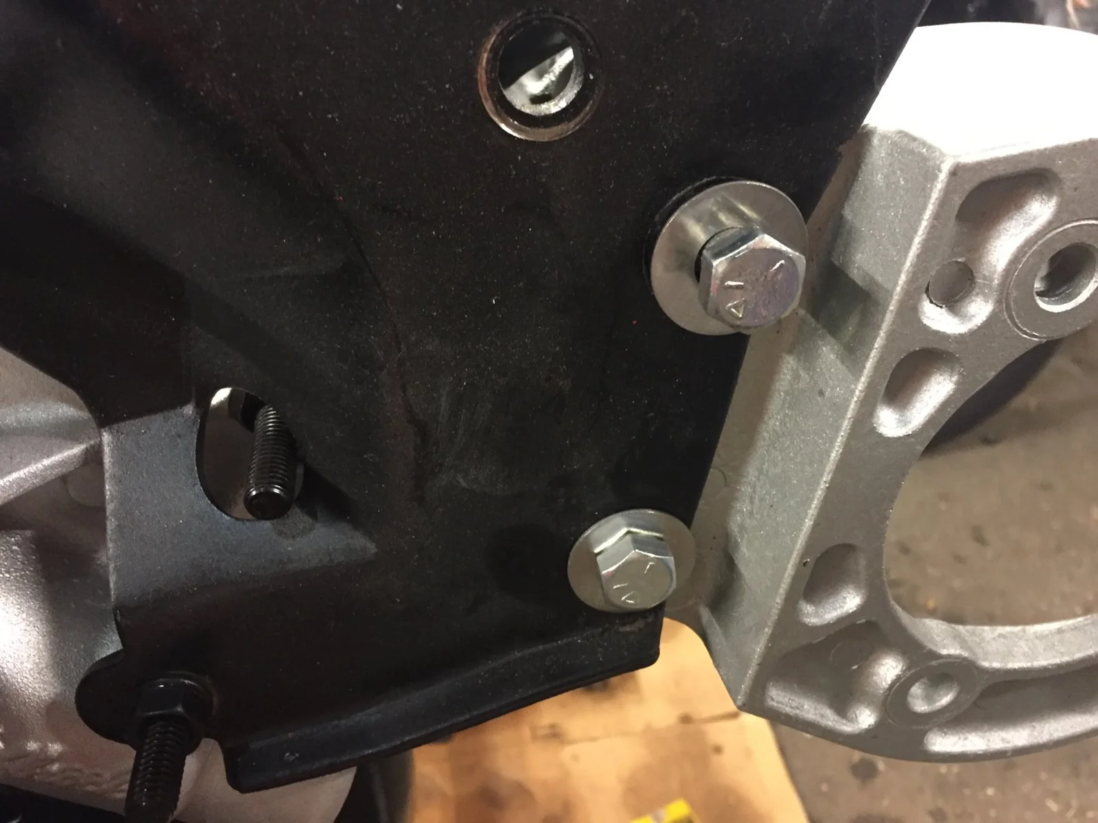

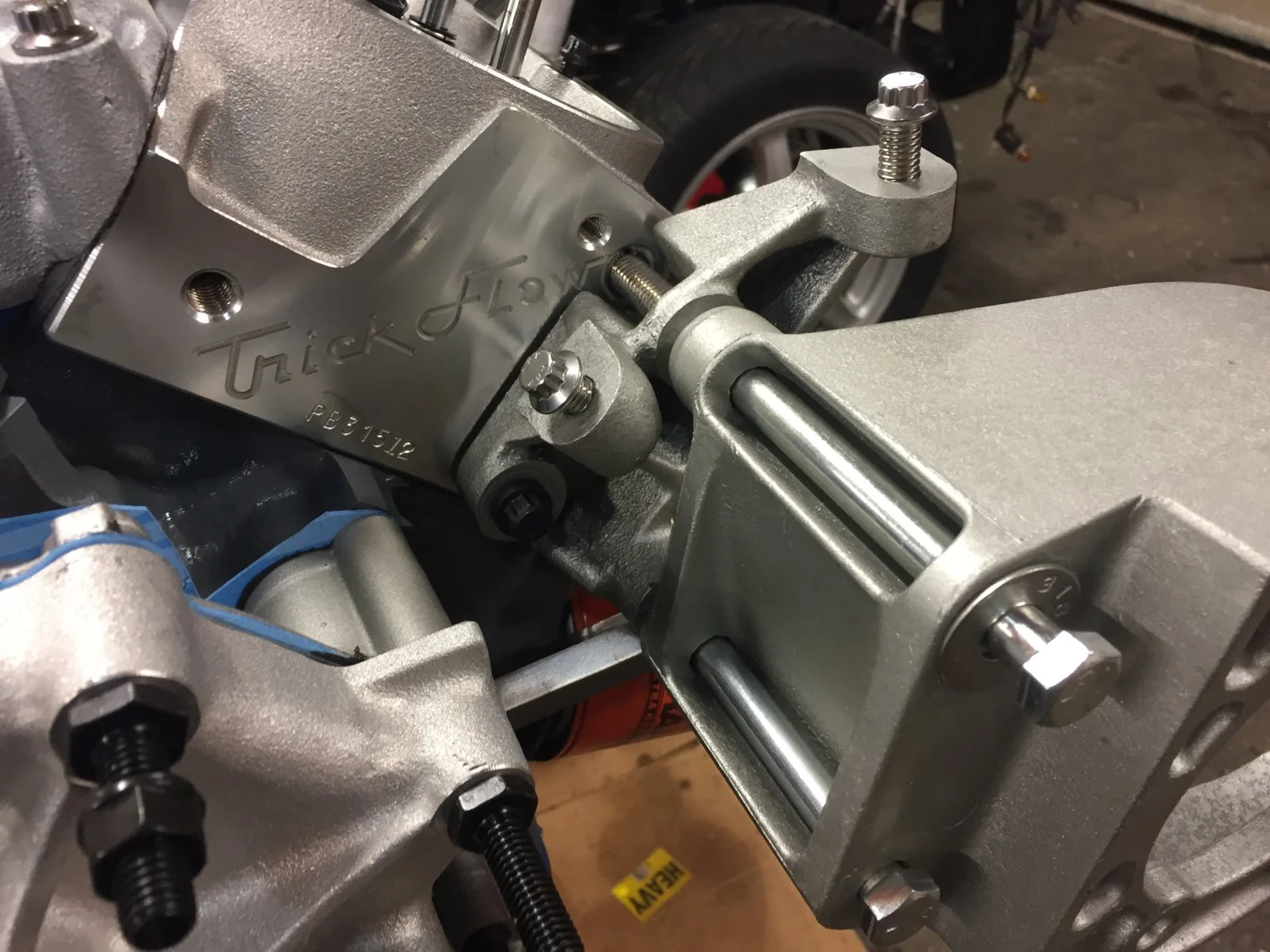

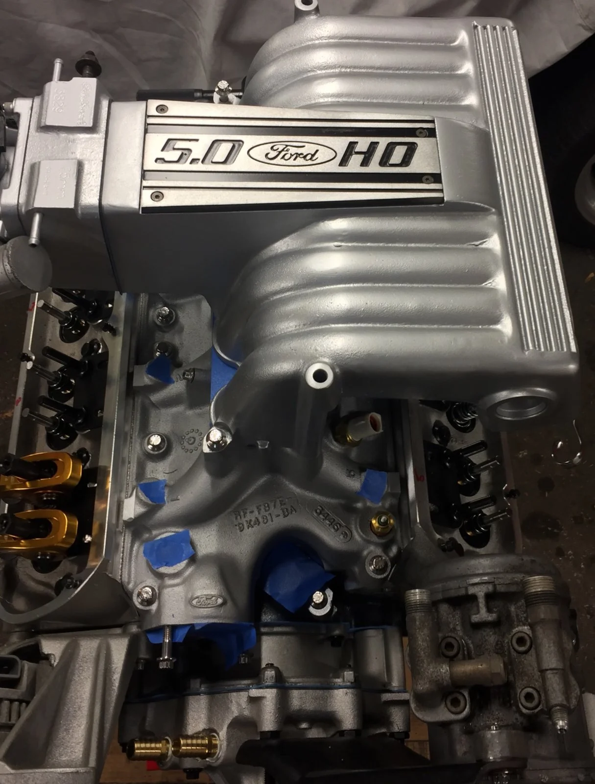

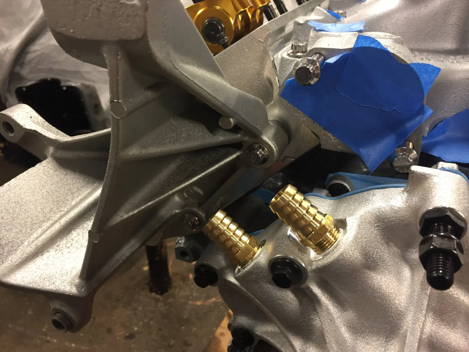

Started mocking up accessories to replace hardware. I could have reused my old stuff...but I like everything fresh. These brackets are painted. Still need to clean and paint the black ac brackets
Not a big fan of this though. Finding 4.65” and 6.5” bolts in a attractive style is tough.
I know the top one is a stud...so I can try and locate one and at least buy a 12pt nut

Not too bad, probably won’t notice them once it’s all put together and in the car.

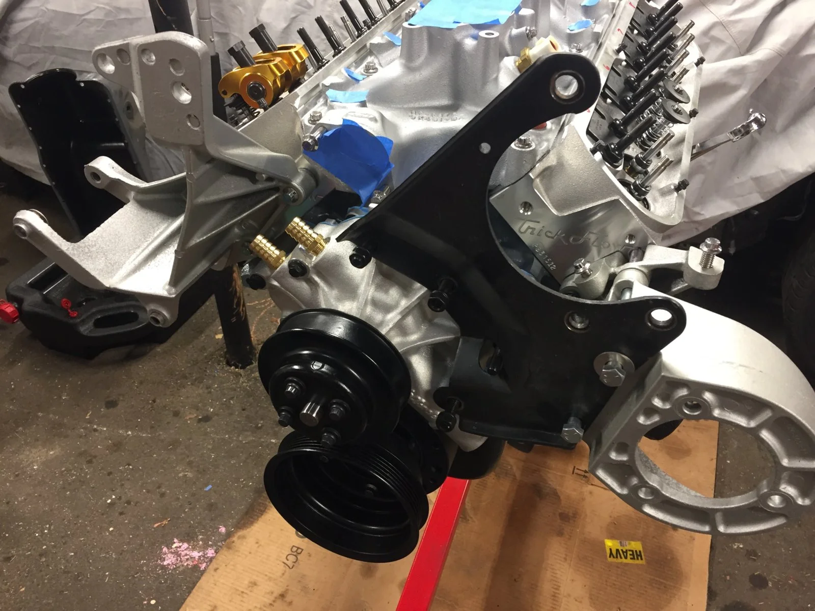

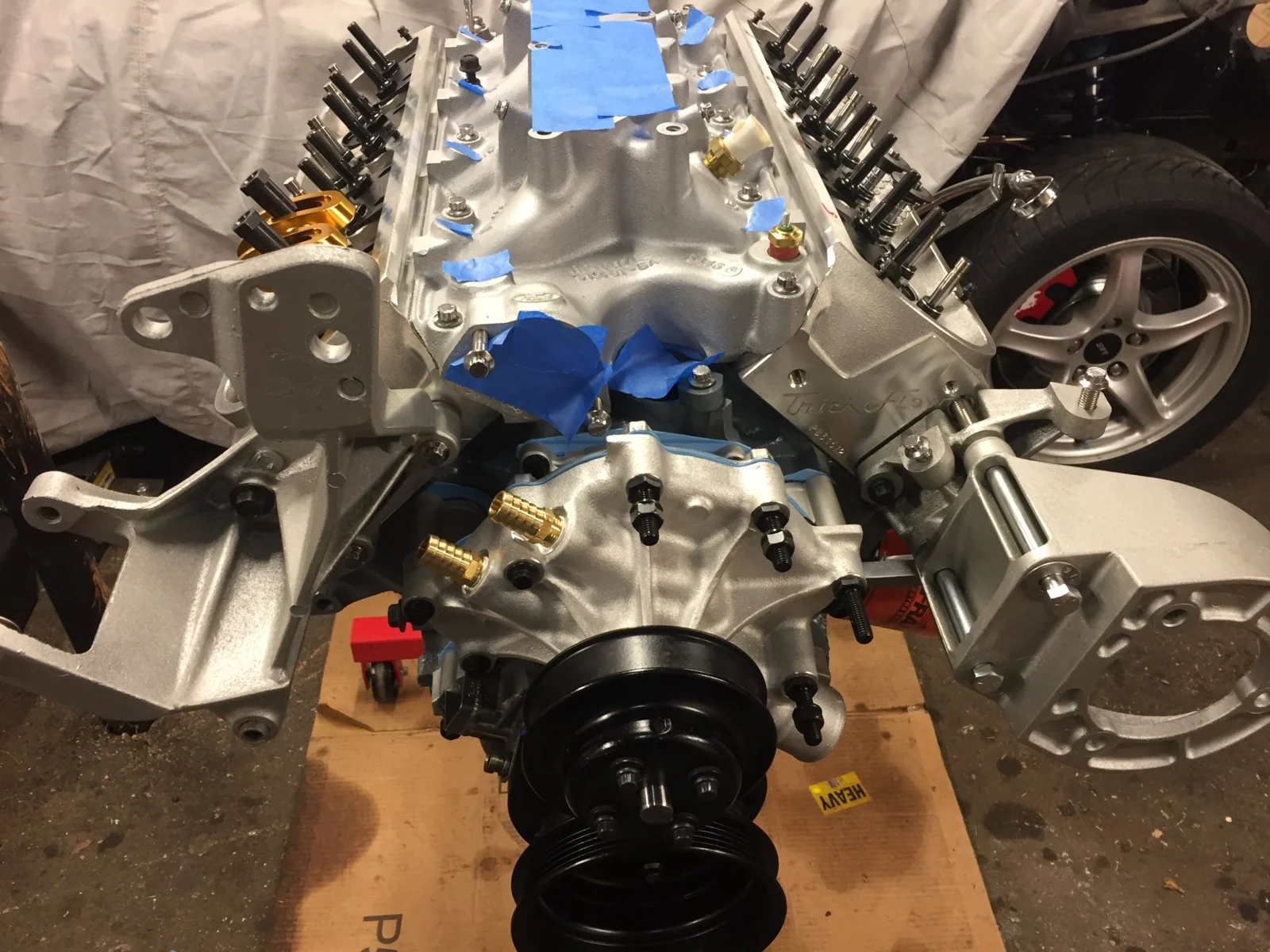

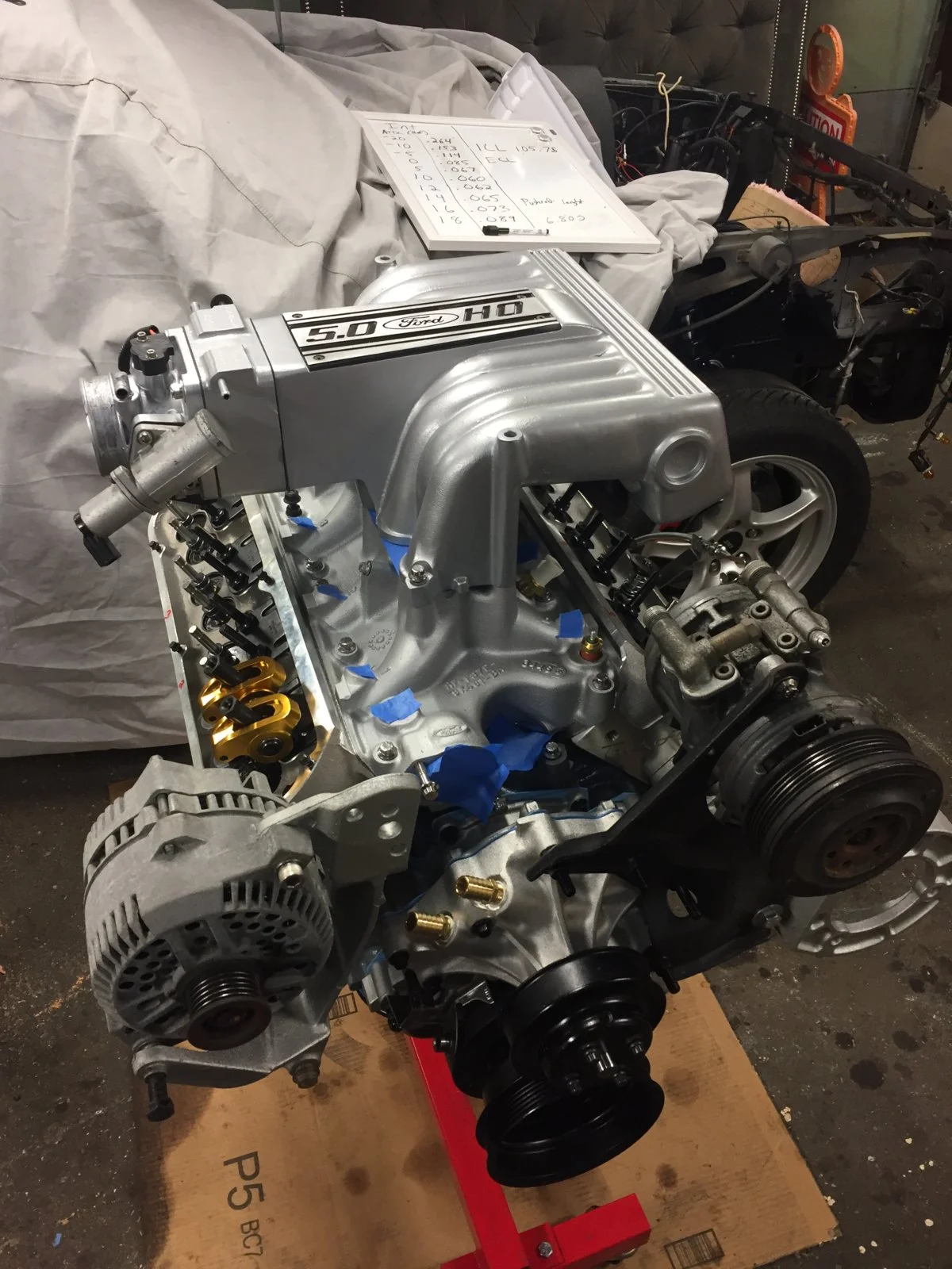

May have gotten a little carried away. Now to take it all apart again
Needs those badass Ford Racing valve covers

Now you need to clean up that alternator and AC compressor!
I know. The AC compressor will likely be a core for a reman unit. This one has been open to the elements for way too long to attempt to use.
I wonder if I can separate the alt housing and clean/paint it.
Regardless...i'll work on that on the side. I wanted to see what hardware I had and what I need. I'll finish cleaning it all up, then remove it and box it up for later. I'll need it all off to lift the motor, so it will have to go on once the engine is back in the car.

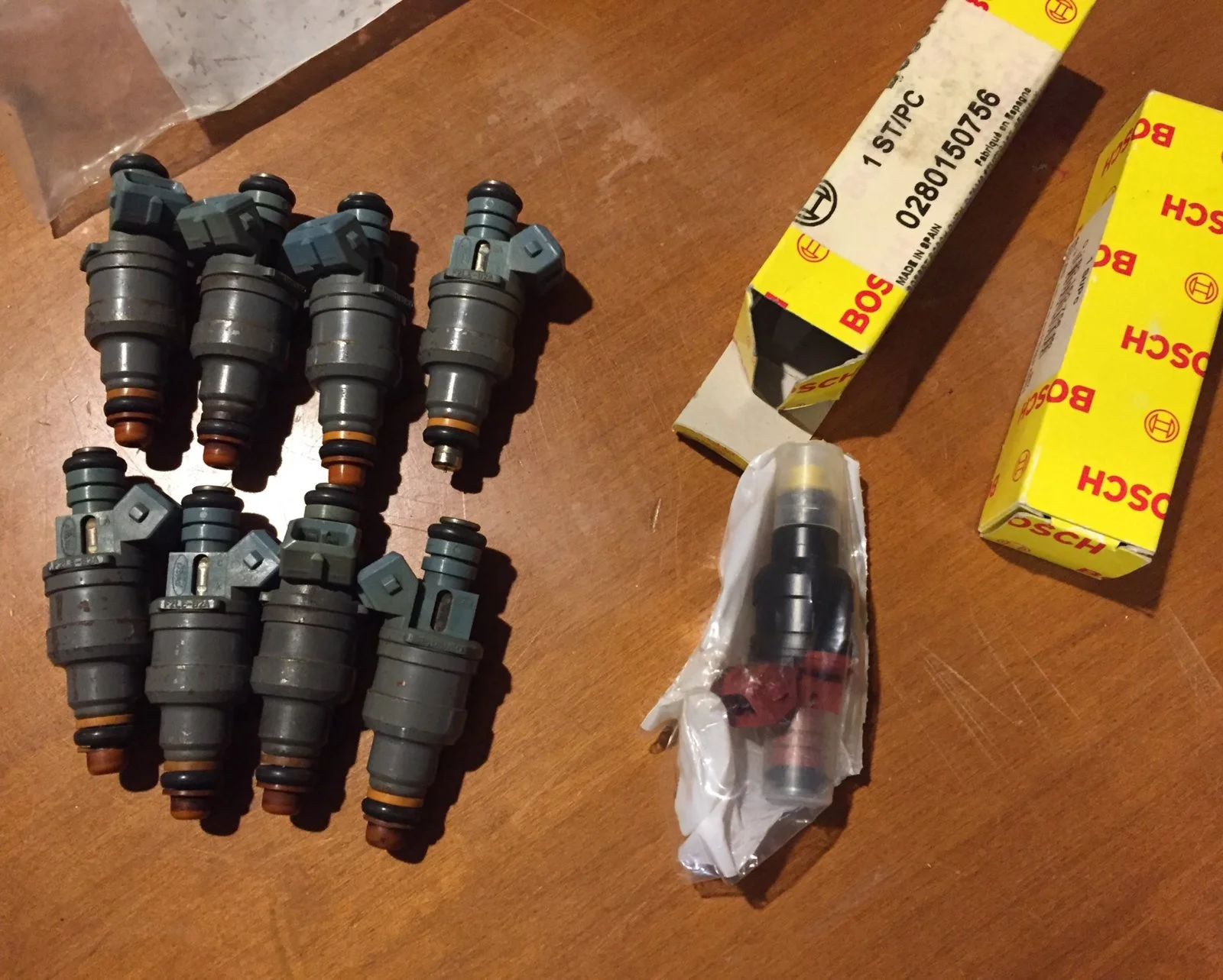

Ok, intake and accessories are removed. Started painting up some brackets.
Sorting through my parts.
I have used 24# injectors, or new 30# injectors.
Which would you run.

New 30# can't hurt.

Either will do fine with the combo your running. Imo with the ms3 it wont matter which you choose.
True, but the intial startup and shake-down will be on the A9L with "calibrated MAF". So I want it initial startup to be ok.
