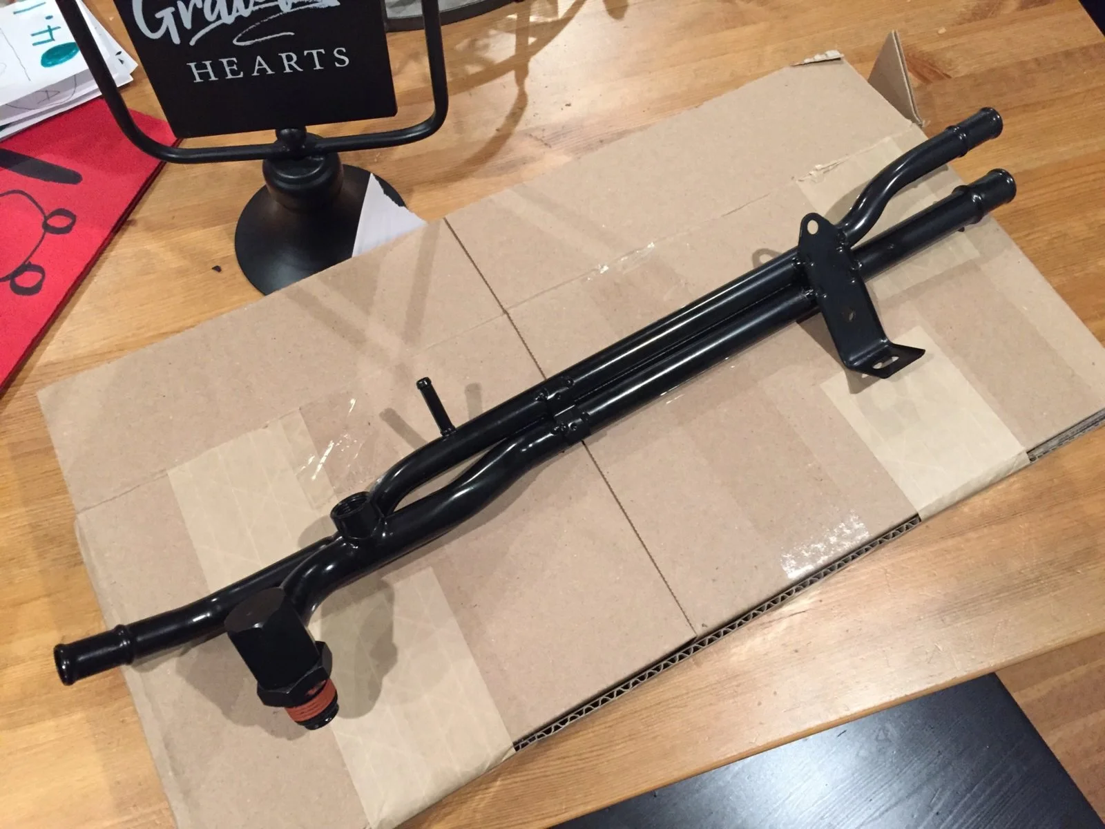

New OEM heater tube showed up. Only $55 or so from Tasca Ford. Made rather recently. Surprised of all the parts for Ford to continue making, they chose to keep making this one.
Part E6ZZ-9D424-B
Reactions: Boostedpimp, 02 281 GT and General karthief
Part E6ZZ-9D424-B
Gee thanks man. I thought I was doing good with my several extra of those too. Mine don't look like that though!
Part E6ZZ-9D424-B
SOB!!! I paid more then that for the Resto one form LMR....
