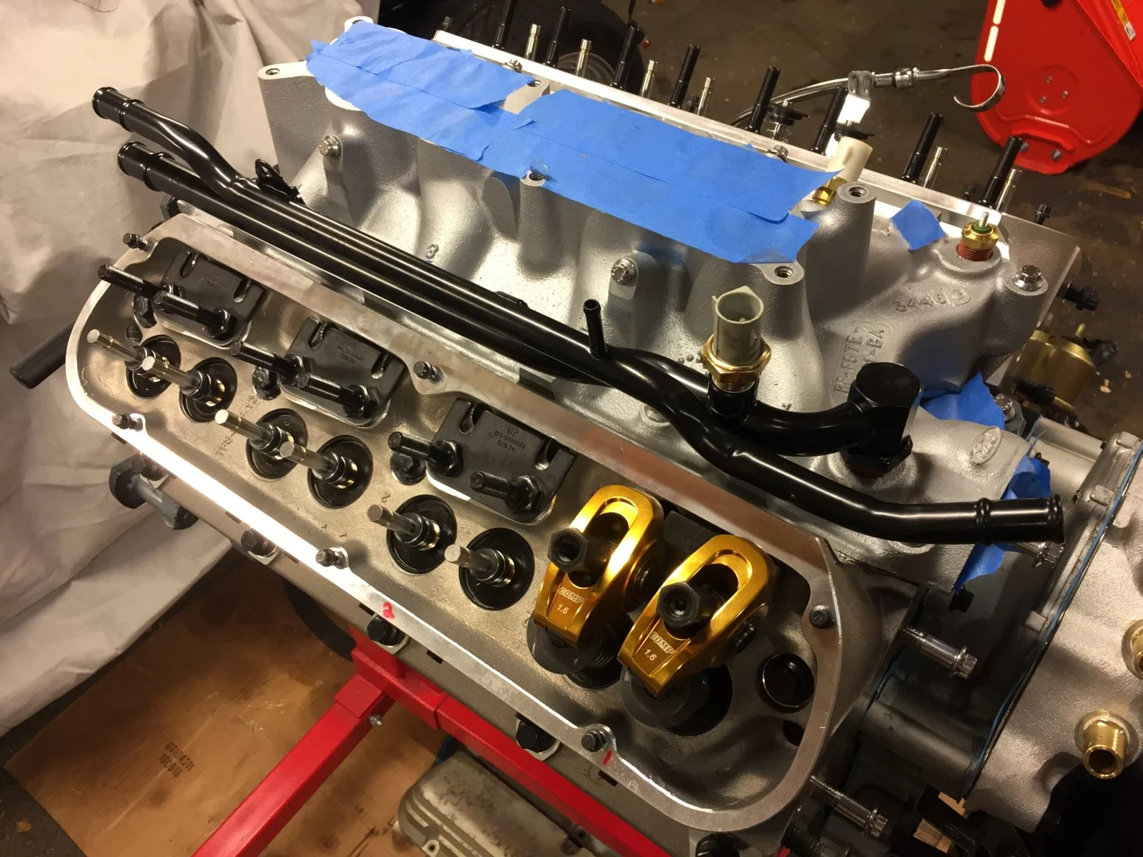

One more piece installed.
Slowly progressing but the holidays are the main reason

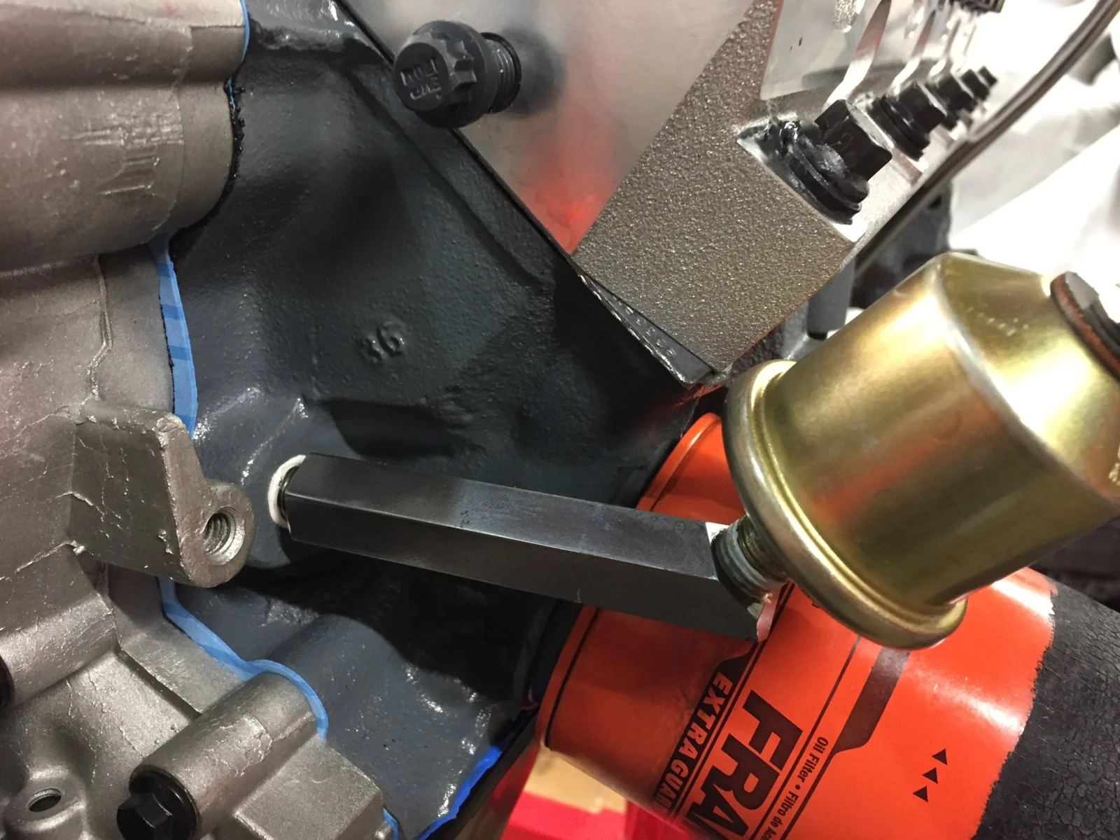

A little more details cleaned up and installed.
Quick hit on the polishing wheel for the oil pressure extension, and a new Motorcraft oil pressure sensor. Before install, I hit them both with high temp clear coat hoping to retain their "new" look as long as possible.

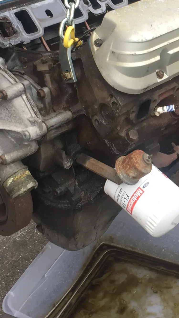

Just for reference....this is what I started with

Do you plan on monitoring oil pressure with the MS3? if so i can link you a sensor that works well and is cheap (18$). you can place it on the passenger side of the block [i think].

Not so concerned with oil pressure. It's something I feel the stock gauge (idiot light) is good enough to handle for my needs. I had a mechanical guage on there for years, so I got to know what the stock guage read and what that translated to on the real guage. I actually trust the pressure on this motor, so not something i'm overly concerned with.
I do want to log fuel pressure though.

Ok i like to log them... MS3 has oil pressure safeties ect.. fuel pressure uses the same sensor. You want to pick one with the pressure that is most often used in the middle of the range where the sensor is most accurate. I use an 80psi sensor for oil and fuel pressure.
simply amazon or ebay 80psi transducer and pick the one you like the most, you can also go the oem route but the mounting options are more limited.

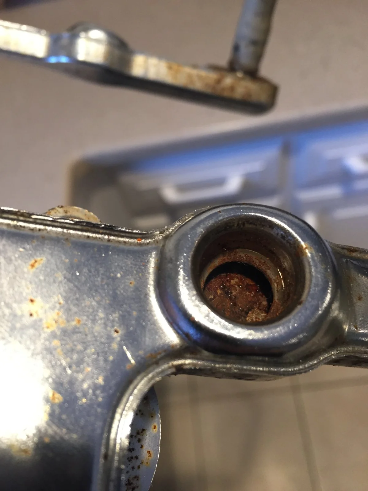

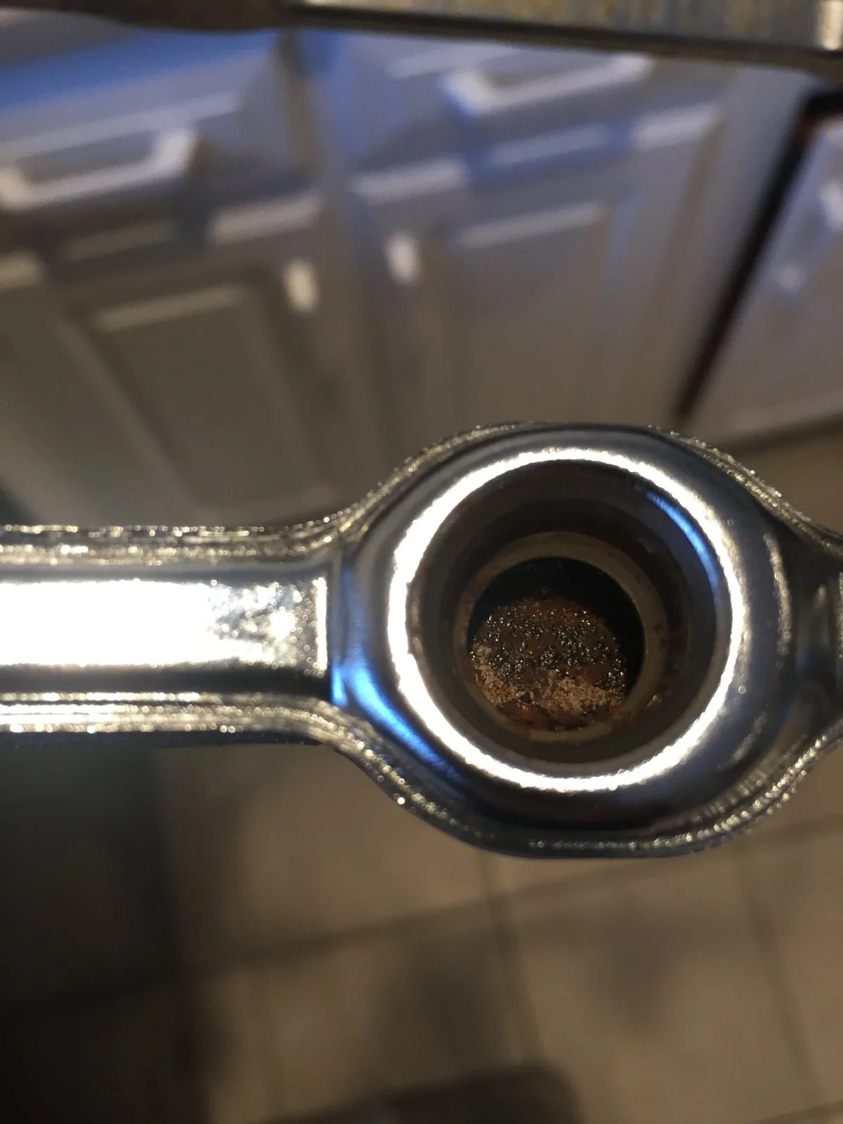

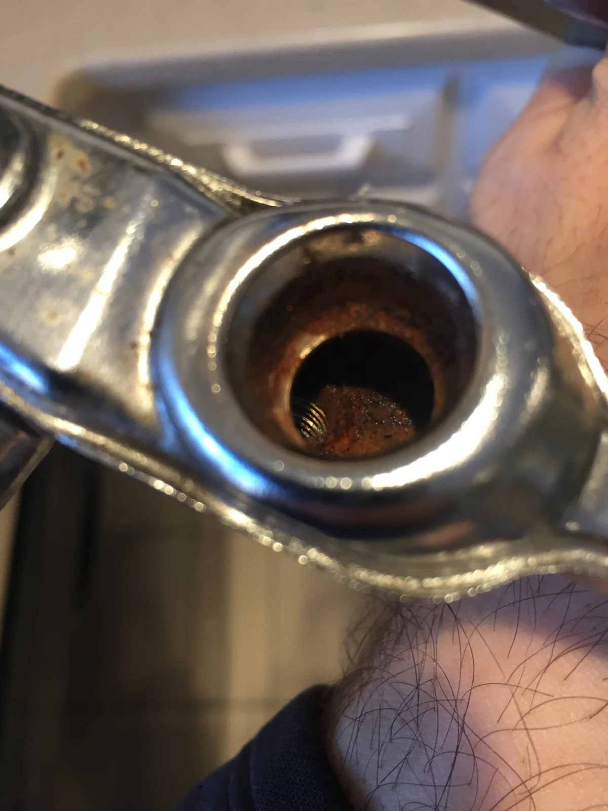

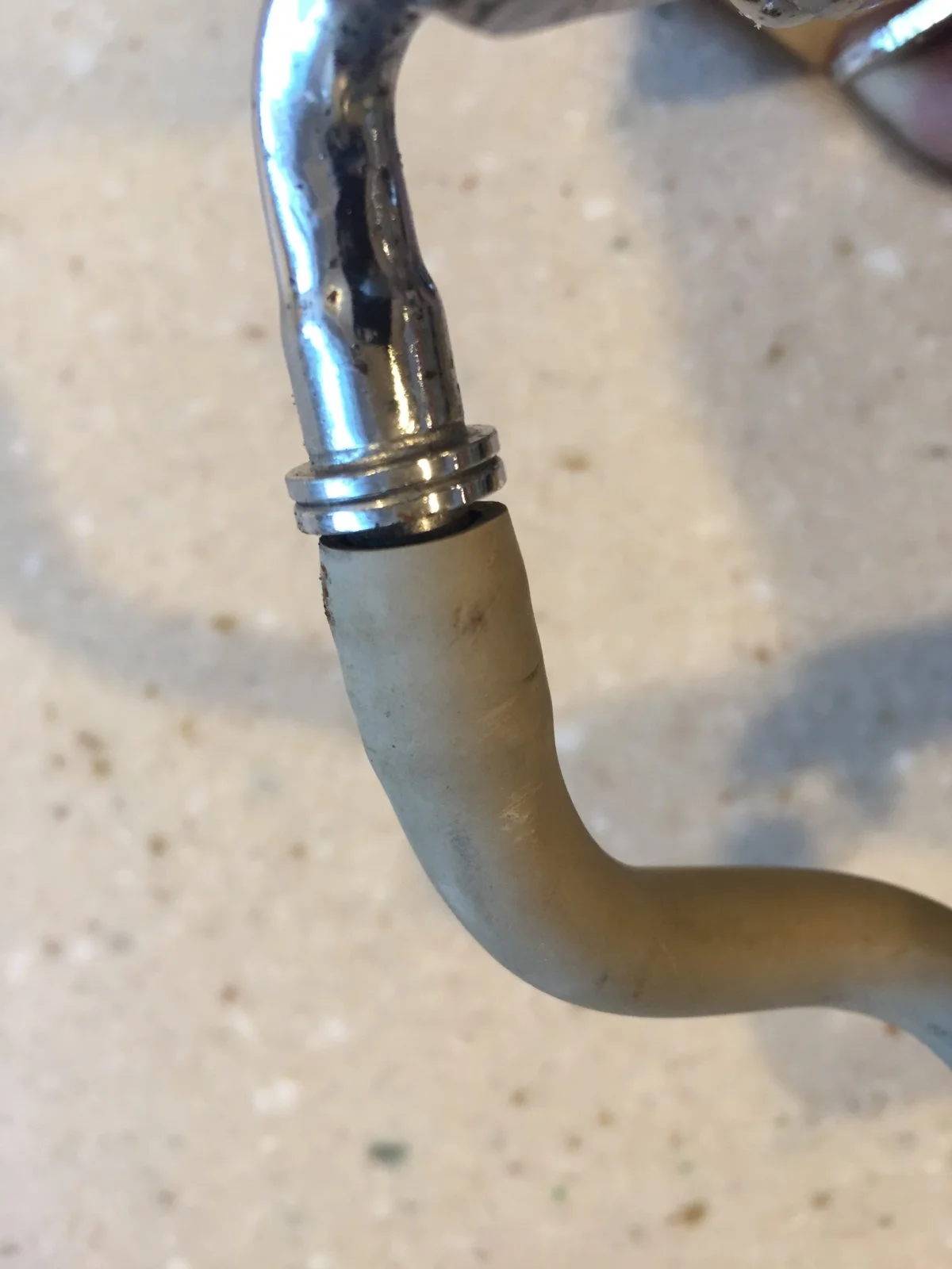

Got my SN95 fuel rail.
Rather disappointed. What do you guys think of this?
also, one of the crossovers is loose. I can pull it off by hand

could you submerge is that wd40 rust remover or evaporust? it seems to strip rust completely to clean metal.

I’d be looking to return it. Who knows what the rest looks like inside the rail.
Reactions: Mustang5L5, BlakeusMaximus and (deleted member)

I'd return it as well. Will Explorer injector rails work? We don't have rust issues here and I could try to find you one at the local yard. I could also see if I could find you a Fox body one.

Pretty krusty. Where did you get it from?
