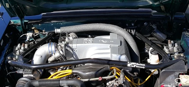

General karthief said:

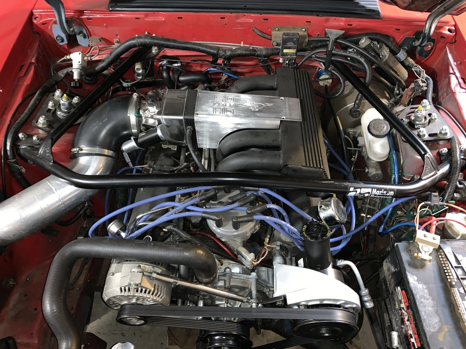

BTW, I am in need of a cover for my tubular intake.
I bought one off eBay, not an original but like $80ish shipped and other than the fact it does not match the paint I currently have it's great. Once I decide how I want it to look overall it'll match.

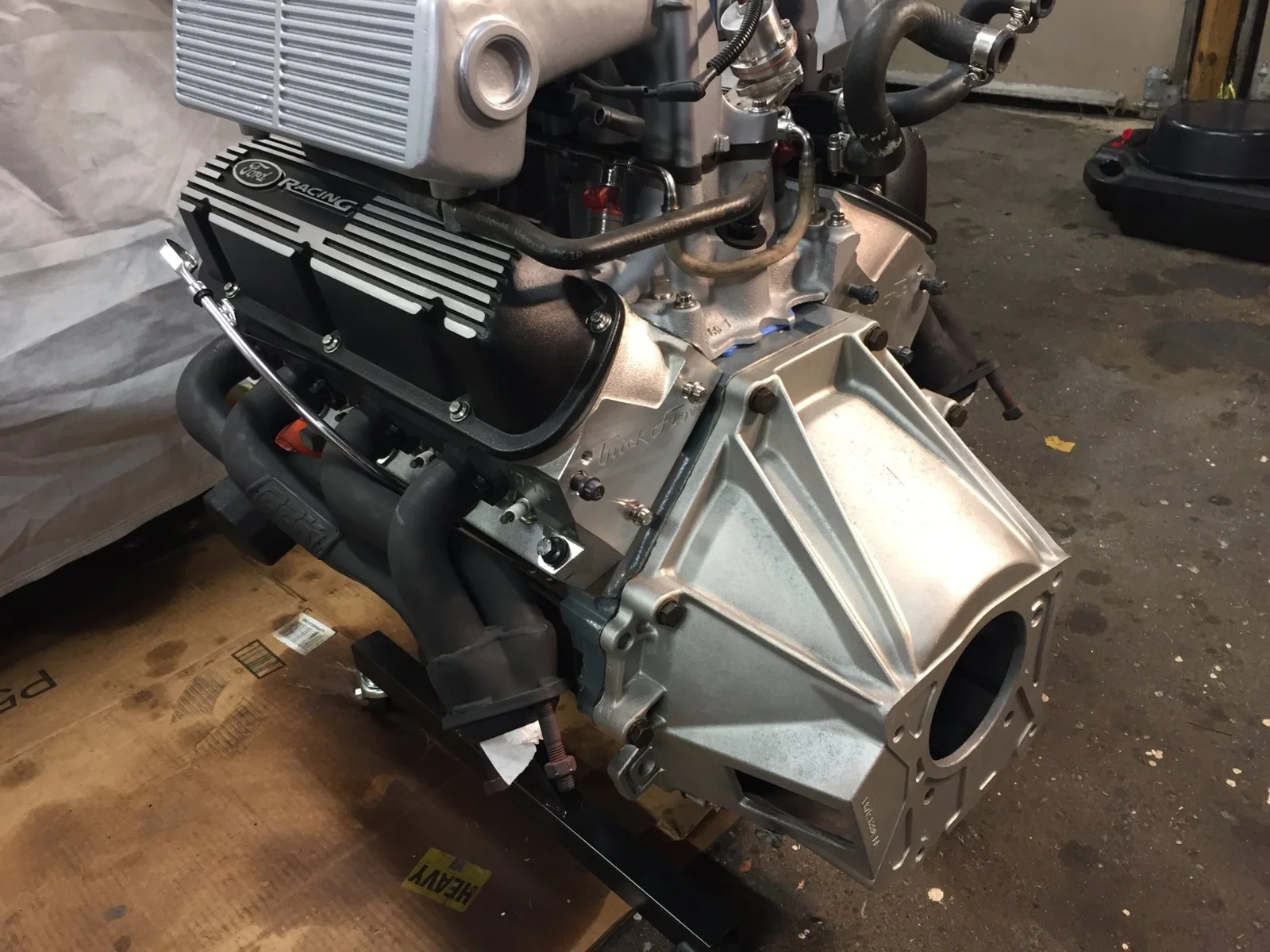

Man that's cool having the engine on the stand like that!

Not sure I like the intake with a cover.
your intake cover looks good

I like the cover. I have the ebay repro one on the black GT
and the 5 billion dollar original one on the 7Up Convertible.

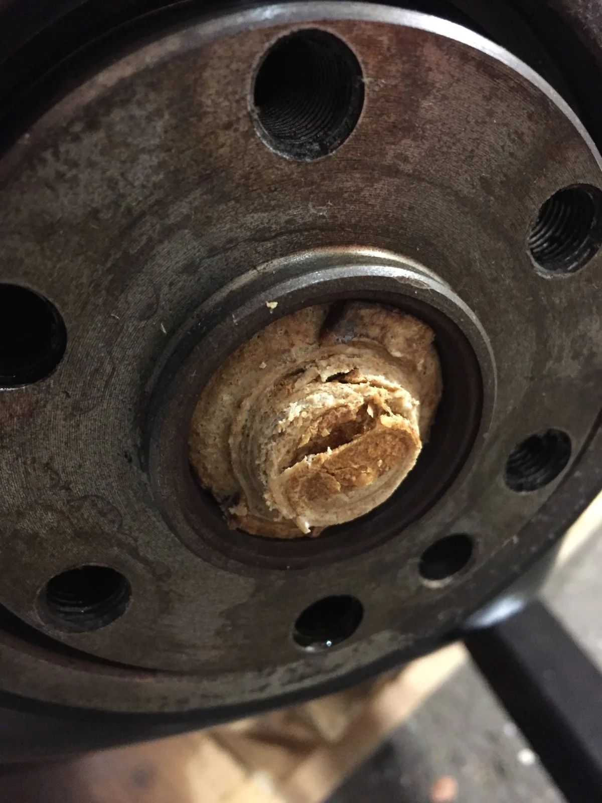

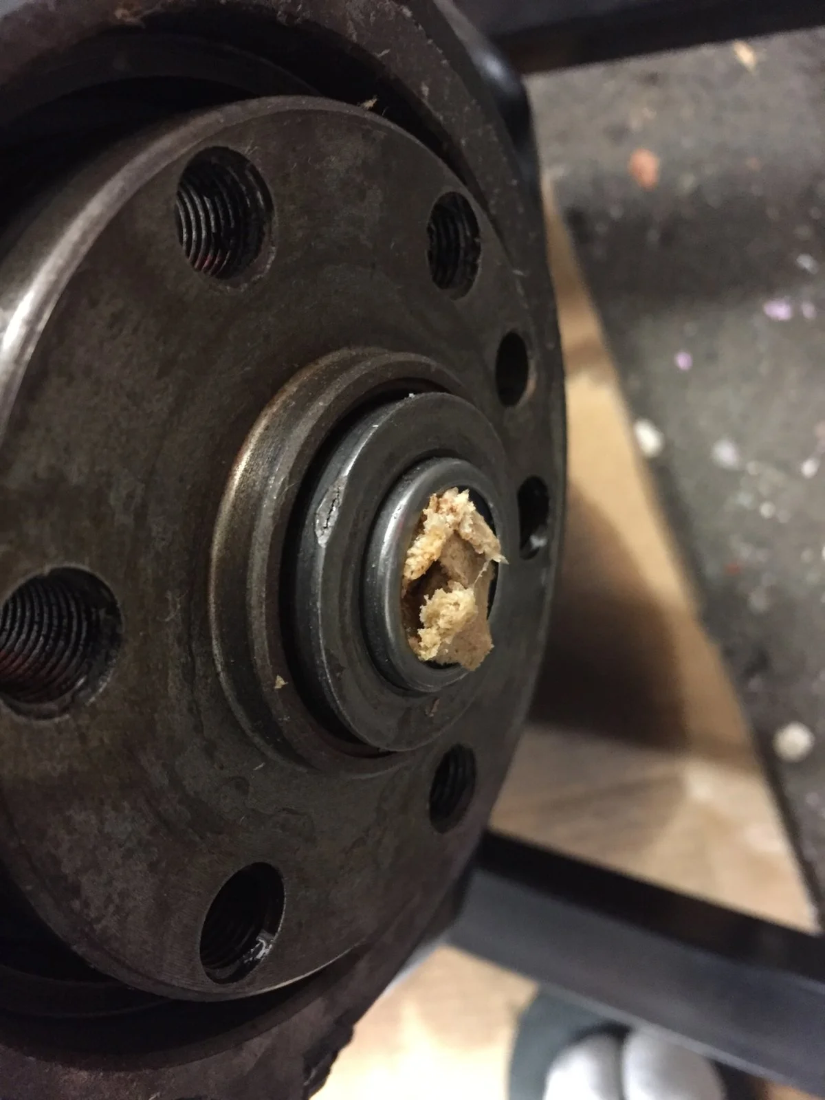

Ok, got some garage time.

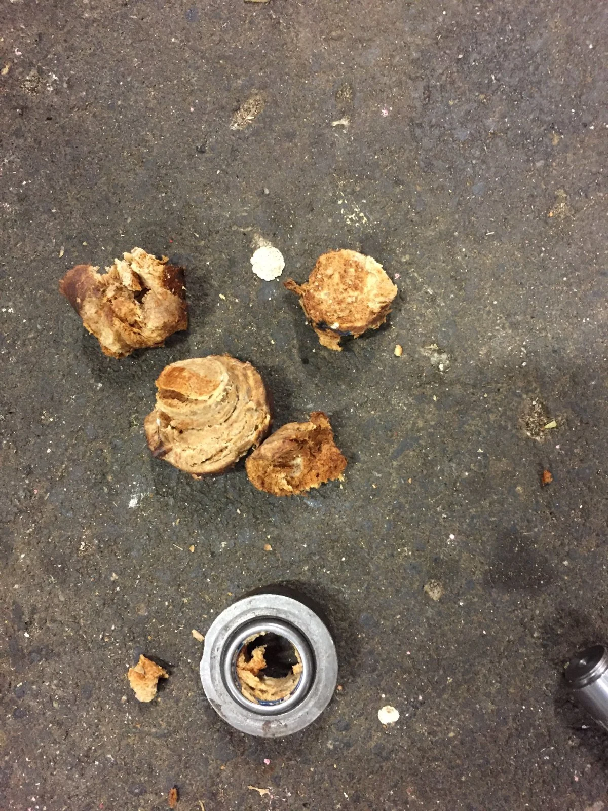

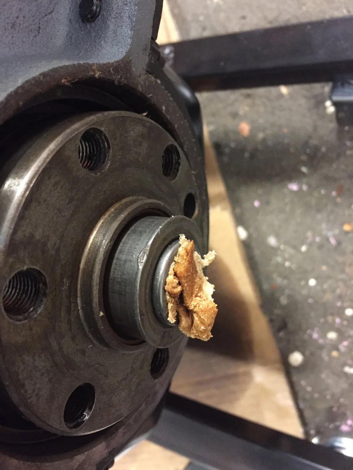

Step one, remove old pilot bearing. I tried the bread method.
One slice later
Reactions: awing, Olivethefet and 2Blue2

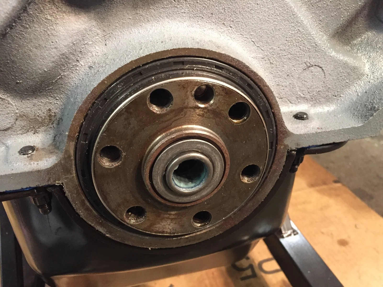

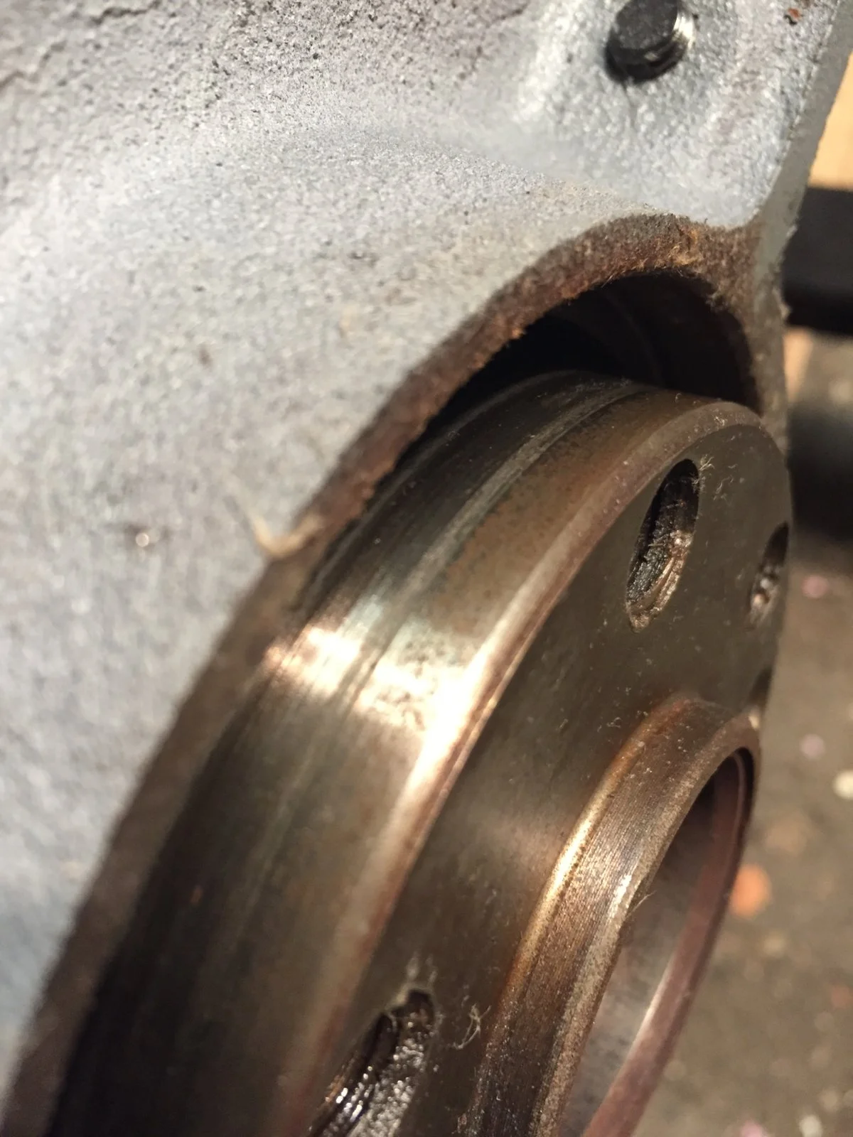

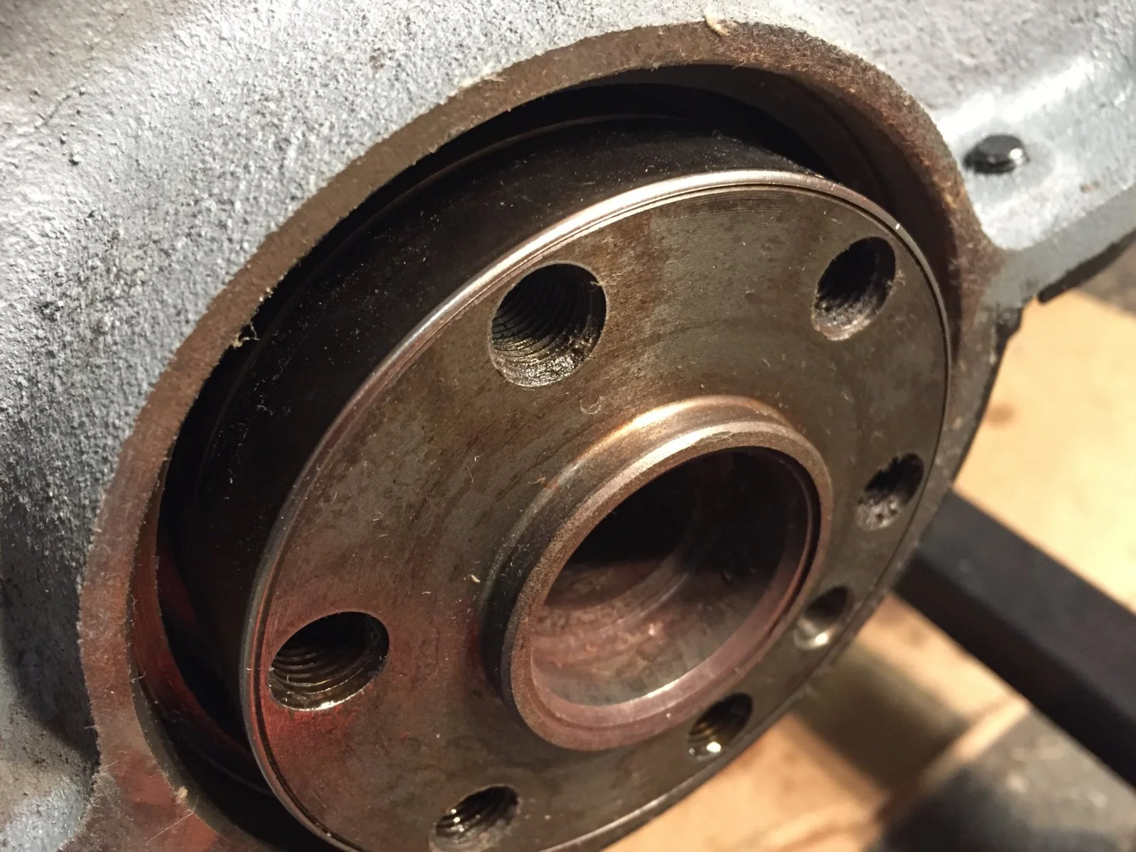

Decided to sleeve the crank. Used a felpro sleeve and this install tool
With the right light, you can see the wear groove. You can’t feel it, but it’s obvious here
Sleeve was easy to install with the gel pro tool. Light taps with rubber dead blow and it’s in
Reactions: Olivethefet and 02 281 GT

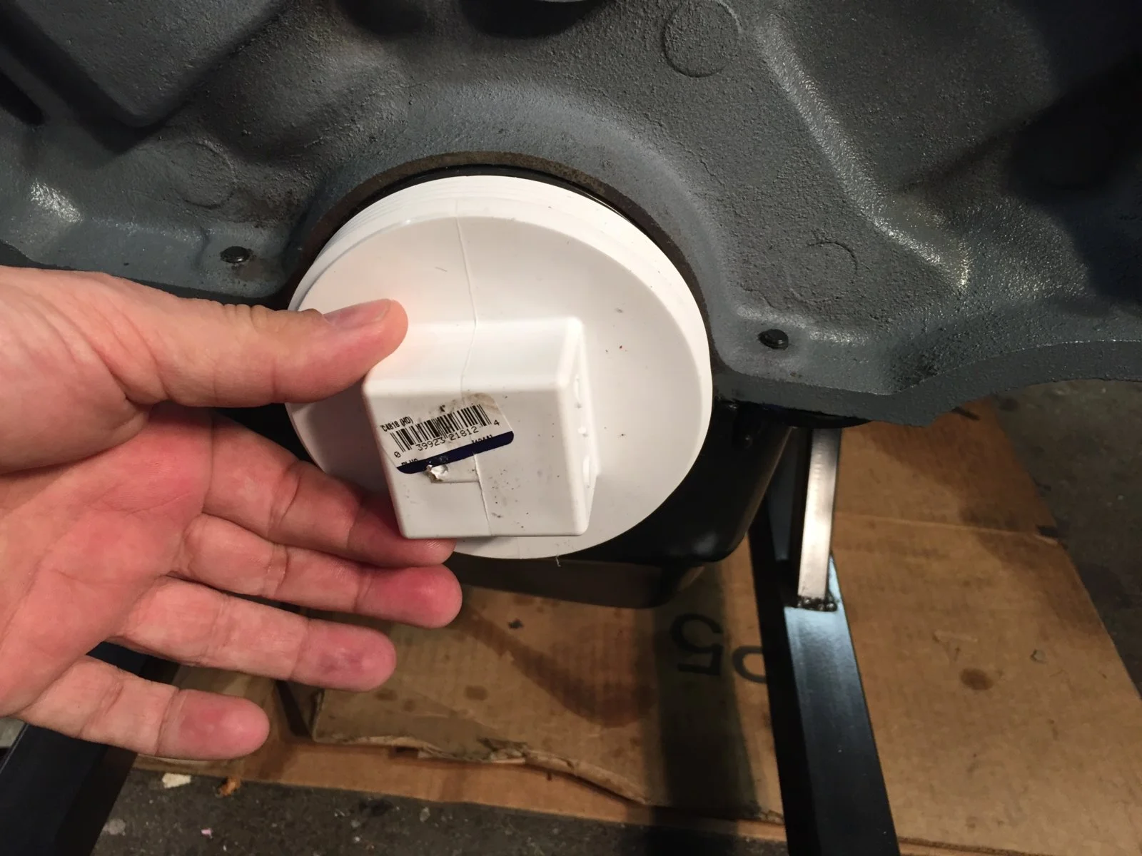

Next up rear main seal. Lubed up, and my $2 install tool. Finally, new pilot bearing installed.
Reactions: Olivethefet, 90sickfox and 2Blue2

White or whole wheat?
Reactions: Wayne Waldrep

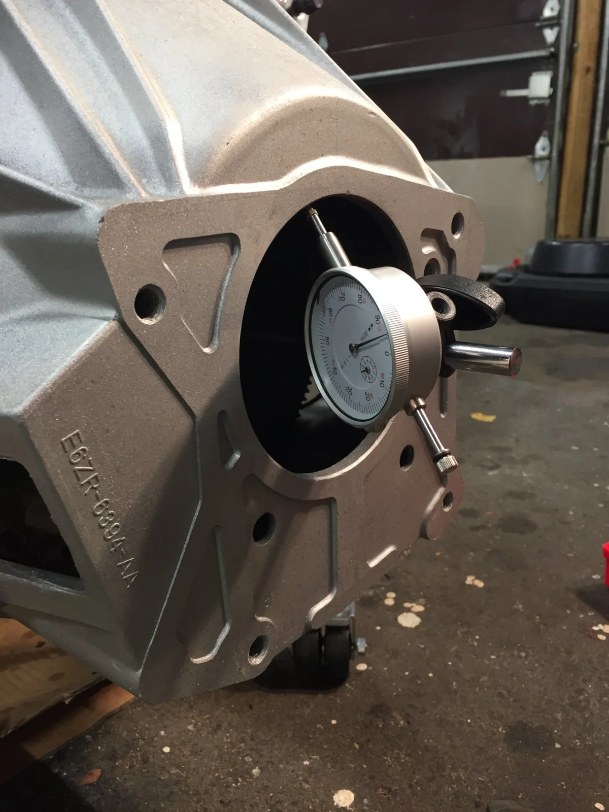

Threw on the flywheel and bellhousinh and indexed it. I got about 0.010” of total runout.
Now to break it down again, and reassemble it permanently

Is there some goop that goes between the seal face and sleeve? What stops the oil from exiting there?
Wheat bread recommended
A sealer is “optional”. It’s not a loose fit. It needs to be driven on.
So, press fit and spans the width of the groove. Never saw one before. Just worked out that I've never reused a crank.
My old one leaked though... fo sho. Even after having changed the rear main seal.
Then the blower came, new motor... You know the story.

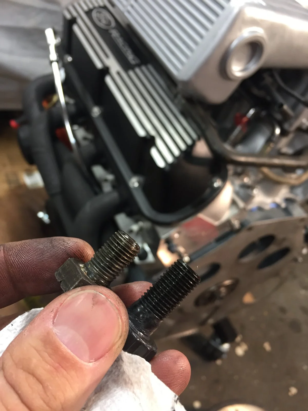

So...um...oops?
Was on the home stretch of bolting up my pressure plate. Torquing my bolts...and one got tight...and then got loose. Yup, stripped. I made sure to chase the threads out, but too much disk dust in there I guess.
Anyway...need a new flywheel now.
Pulled it all apart and called it a night. I thought I was going to have this All buttoned up tonight.
I’ll order a new Ford flywheel in the AM
Btw...not the first time I’ve done this. Just call my the flywheel stripper
Stripped clutch bolt in flywheel: can it be repaired??
I was in the middle of my final torque sequence when my last clutch bolt stripped out the threads in the flywheel. They are completely gone. Question is, does anyone know if this can be repaired?? Or am i better off just spending the $100 for a new Ford flywheel from summitt?
www.stangnet.com

Btw, my new ARP flywheel bolts are just a tad longer than the OEM bolts. This an issue? I assume not

Have you decided what/if you're putting anything on the threads to sell them up since the holes go thru?

The ARP bolts state moly lube under the head and blue loctite on the threads.
I used red. I like my legs
Also the reason I ordered a new flywheel rather than try to fix the stripped hole
