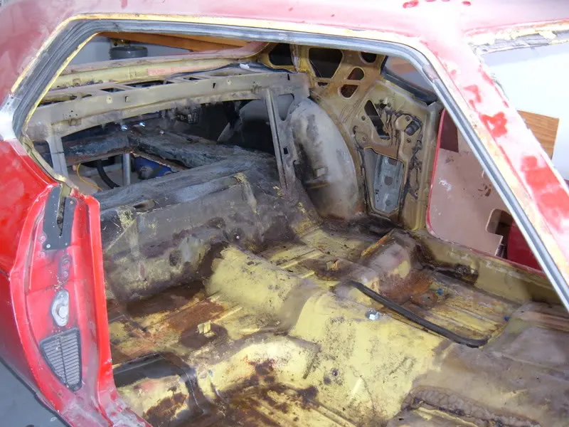

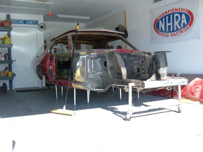

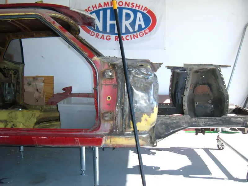

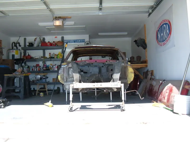

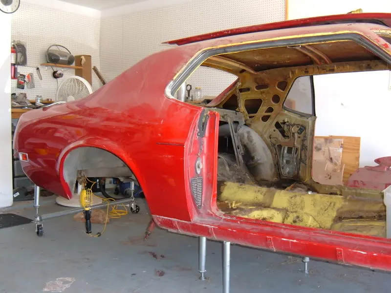

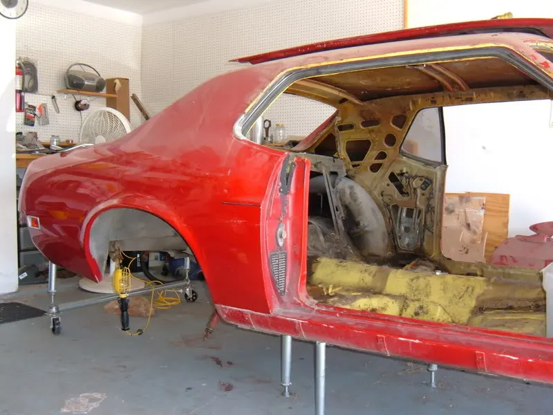

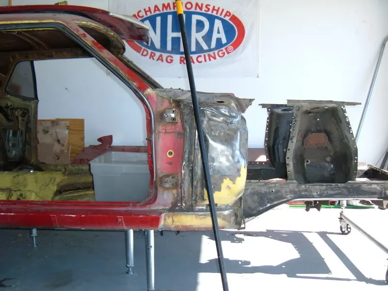

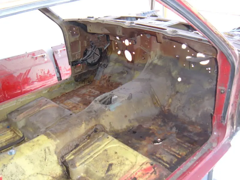

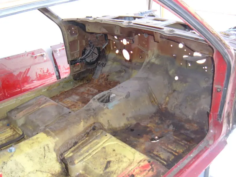

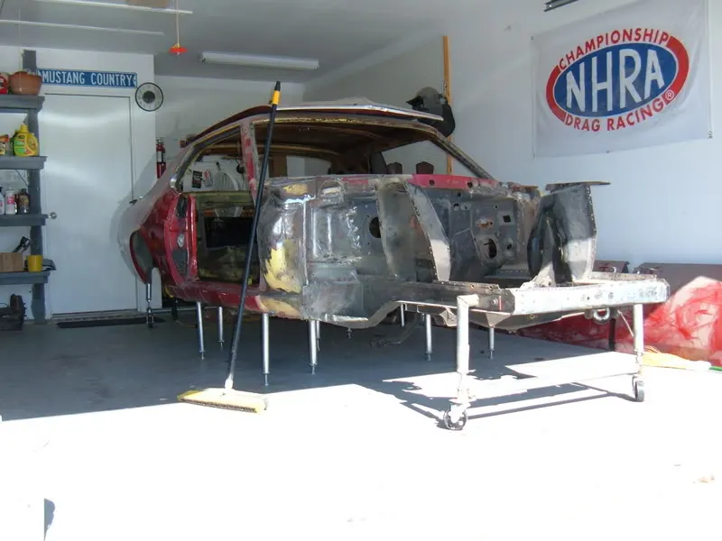

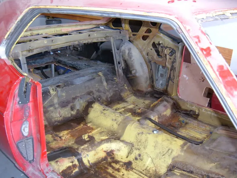

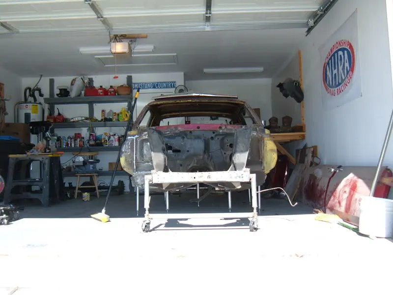

This is my first time posting on this site, I have a 1970 mustang coupe I am working on. I thought I would post up some pics of my homemade frame/body leveler. I am in the process of making new floor pans/Sub frames/rear crossmember/firewall/roll cage. I am basically trying to beef everything up and tie the two subframes together.

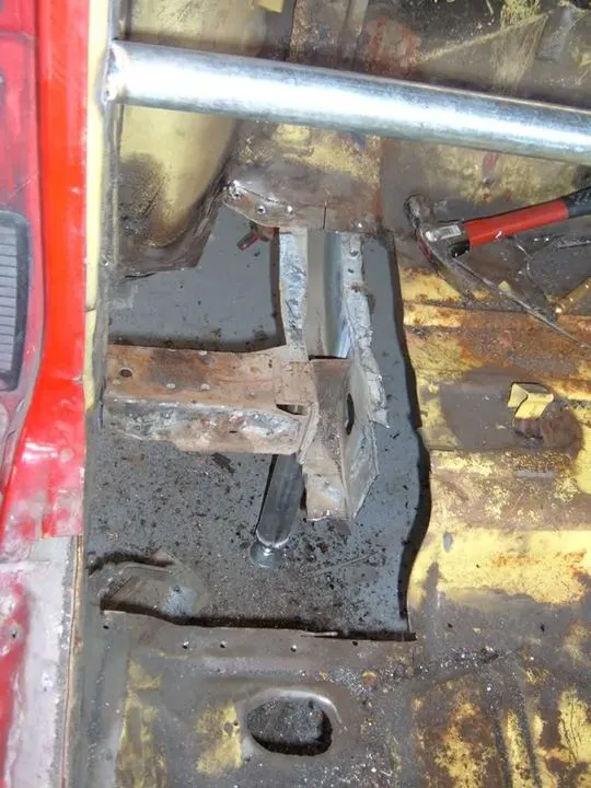

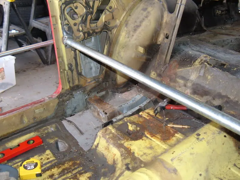

My first step is cutting out the rear torque boxes (I think that is what they are called) and putting a 2X4 cross member w/ intergrated Driveshaft loop where they were located.
Next step I will tie into the rear and front subframe with some box tubing and join them at the new rear crossmember.
There is going to be alot more but I will post up some pics as I progress.
Anyways here are the starting pics. Looks little rough but everyone has got to start somewhere.

I'm not quite in that same boat, but I'm feeling ya on the floors and stuff. As soon as I can sneak the camera link cord from my folks I'll post the most recent pics of my hibernating stang...

Nice project! I'm creating a frame jig (for lack of a better term) for my project. There are other similarities with my project. Checkout my garage from the link.

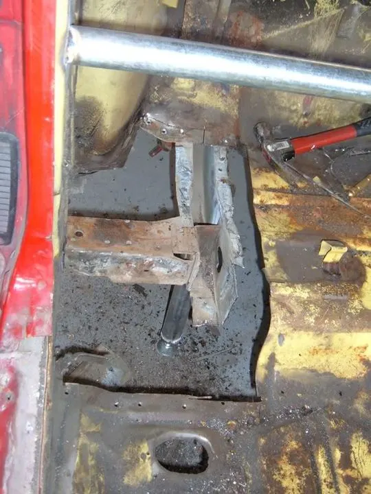

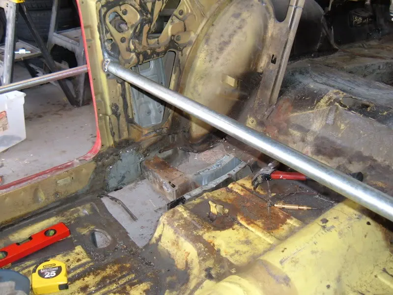

I got the rear tourqe boxes (I think they are called that) out yesterday. Also my new rear seat pans came in yesterday.

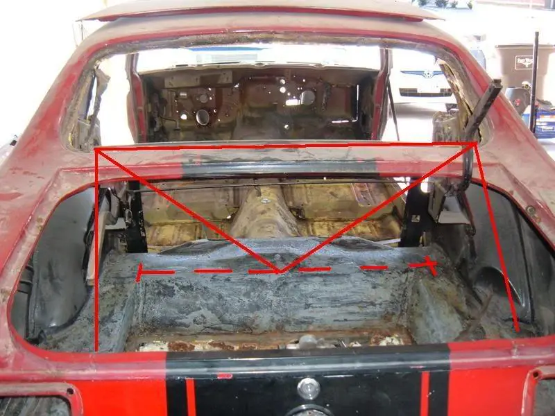

What's your plans for frame upgrades, standard 6 pt cage? Very interesting to follow. :nice:

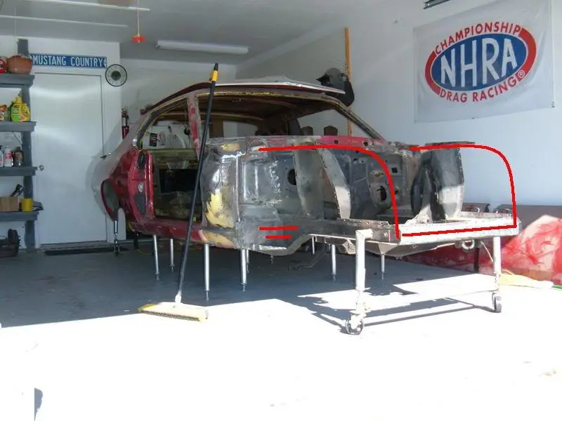

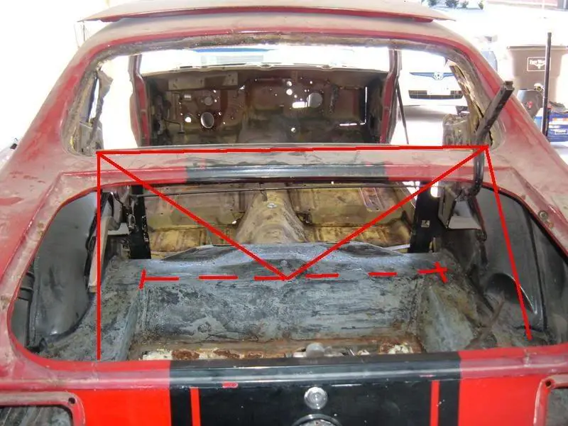

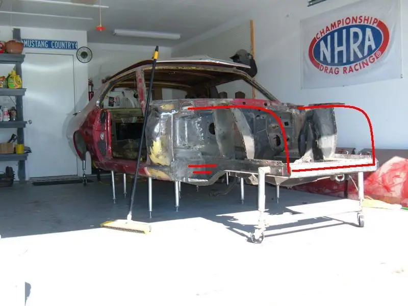

I plan on a stand 6 point cage for the interior and tie into the rear frame rails in 4 spots in the truck (2 on each side), one in the frame rail located and one that goes diagonal to the middle pinion bump stop.
Kinda like this, please excuse the rough PaintShop editing:
The dotted red line that bar will be located under the truck sheet metal, attached to the sides of the frame rail.
For the front I plan on something like this:
The two side bars will be behind the fender aprons but attached to them to add support. I plan to run 1 bar threw the front crossmember tieing both sides together.
