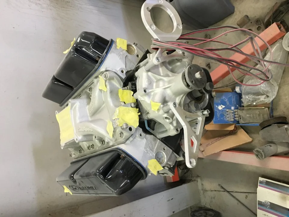

The stock 5.0 was rebuilt with new rods and Pistons (not forged), GT40X aluminum heads with roller rockers and a comp roller cam with appropriate hydraulic lifters. Nothing real wild, just new. Bored .030 over mainly to have clean cylinders. Also an Edelbrock Perfomer RPM intake. MSD distributor. It will have a Quickfuel carburetor 650 or 680 (depending if I want to go manual secondary or vacuum). It has an Edelbrock water pump as well. It turned out to be real close to what FRPP offers as a crate engine, btw. It does have a nice set of March pulleys and brackets as well.

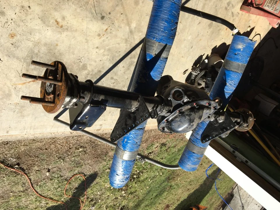

The stock 8.8 rear end has been narrowed 1.5" on each side. The tubes have been welded and welded on brackets for coil overs (for a much later mod). I have a set of Strange five lug, 31 spline axles cut to length for the narrowed rear. Still need the differential, probably will go FRPP on this. Not sure where I want to go with the gears, maybe 3.73's. It will eventually have 18" wheels for the back. I can fit 10" wheels with a -4" backspacing. Would like to fit 285 tires back there, already rolled the lips on the quarters. Might need to beat in the inside of the wheel well a little.

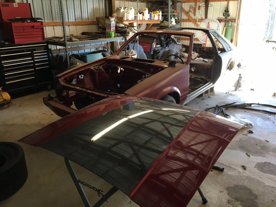

All body work is done!! Woohoo! Going to paint it this weekend at my brother's body shop in Stillwater. I'm buddy's with the local Akzo Nobel rep, so it will be Sikkens for paint. He is giving me all the materials, if you have painted your car, you know what that means. And I mean everything was given to me, from sandpaper to the cleaners for the plastic in the interior all the way to rubbing compound (hopefully won't need to rub too much!)

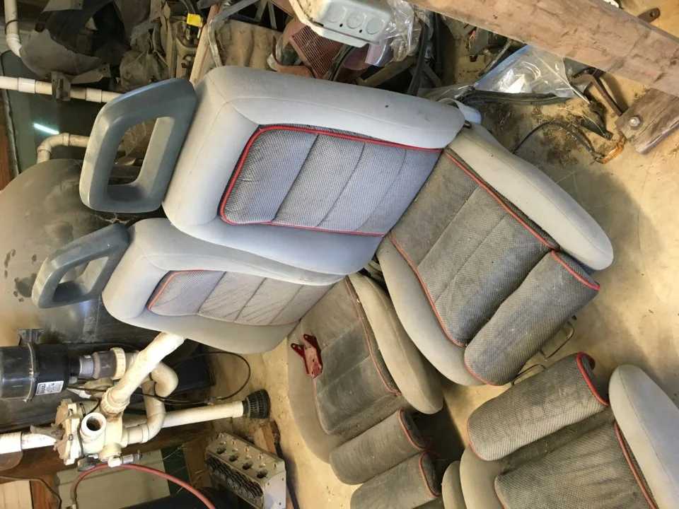

The stock seats are in freakishly good condition! I'm going to pull the covers off and wash them in the gentle cycle of my washing machine.

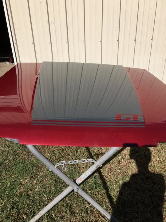

Okay, here's a few photos for now. You can see the hood is already painted. The GT decal is painted and sanded smooth. I will put on one more coat of clear this weekend to make it even with everything else.
Wish I had time to smooth the engine bay.
