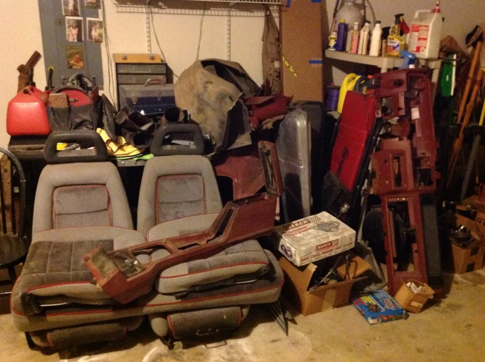

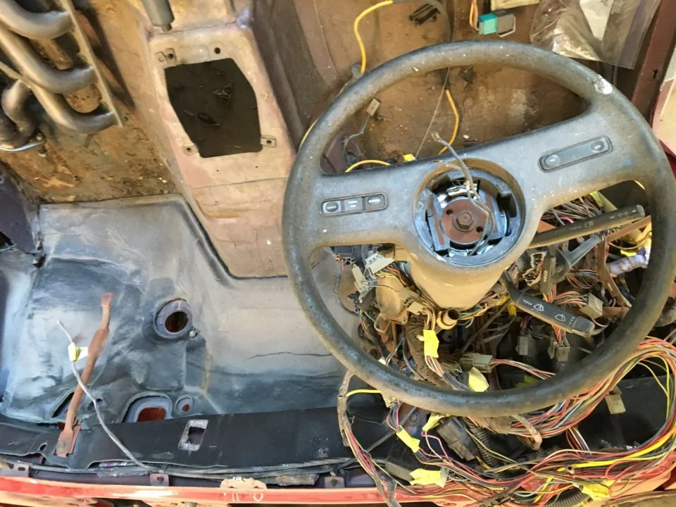

More pictures, the good,bad, and the ugly. image.webp The old cradle will be out before the engine goes in, I have it, just been too busy. image.webp image.webp I can't get the second picture to be right side up, soooo. What a lovely steering wheel, you must be thinking,yup. Sure looks dirty, doesn't it? It'll be much cleaner prior to me painting it this Sunday. She's dirty down deep inside! I will go take one picture in my garage of some of the pieces, quite a pile of crap, eh? I've got one month to make that pile of crap into a beautiful fox interior. I can do it. The new headliner can't be bought till the beginning of January though. Stinking Christmas is getting in the way. I don't know where my wife's priorities are!
I like the seats!

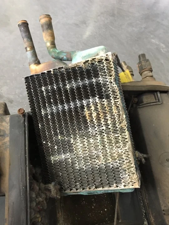

I had a few minutes at work, so I thought I would open the cover where the heater core is to see how dirty it was inside. I think I'm glad I ordered a new heater core! I also ordered a new ac evaporator coil and a fan resistor for the box. Time to wait for packages. BTW, should that insulation be stuffed there in the corner next to where the core goes?
do yourself a favor and only get a FOMOCO replacement heater core, and also install the restrictor in the return line. I 'd remove that insulation and lay down a sheet of foam HVAC insulation

Like everything else, I get started on something intending to do just one or two things, then I think,"while I'm there......". So I was just going to clean the heater box, then while I'm there I should put in the new heater core. Okay, the ac evaporator. Alright, new gaskets and foam. Now I figure those thirty year old actuators need to go. Got to find them though. I found one that's NOS, need to find the rest. Anyone got ideas on the vacuum line for the box?
