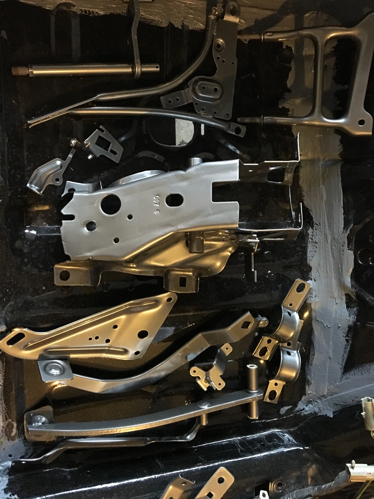

Here's the pedal assembly before and after powder coating. I absolutely love the color.
Can anyone tell me where I can find new bushings that are attached to the top of the brake pedal? @RacEoHolic330 ?
Reactions: 92NOTCH01 and skyline247

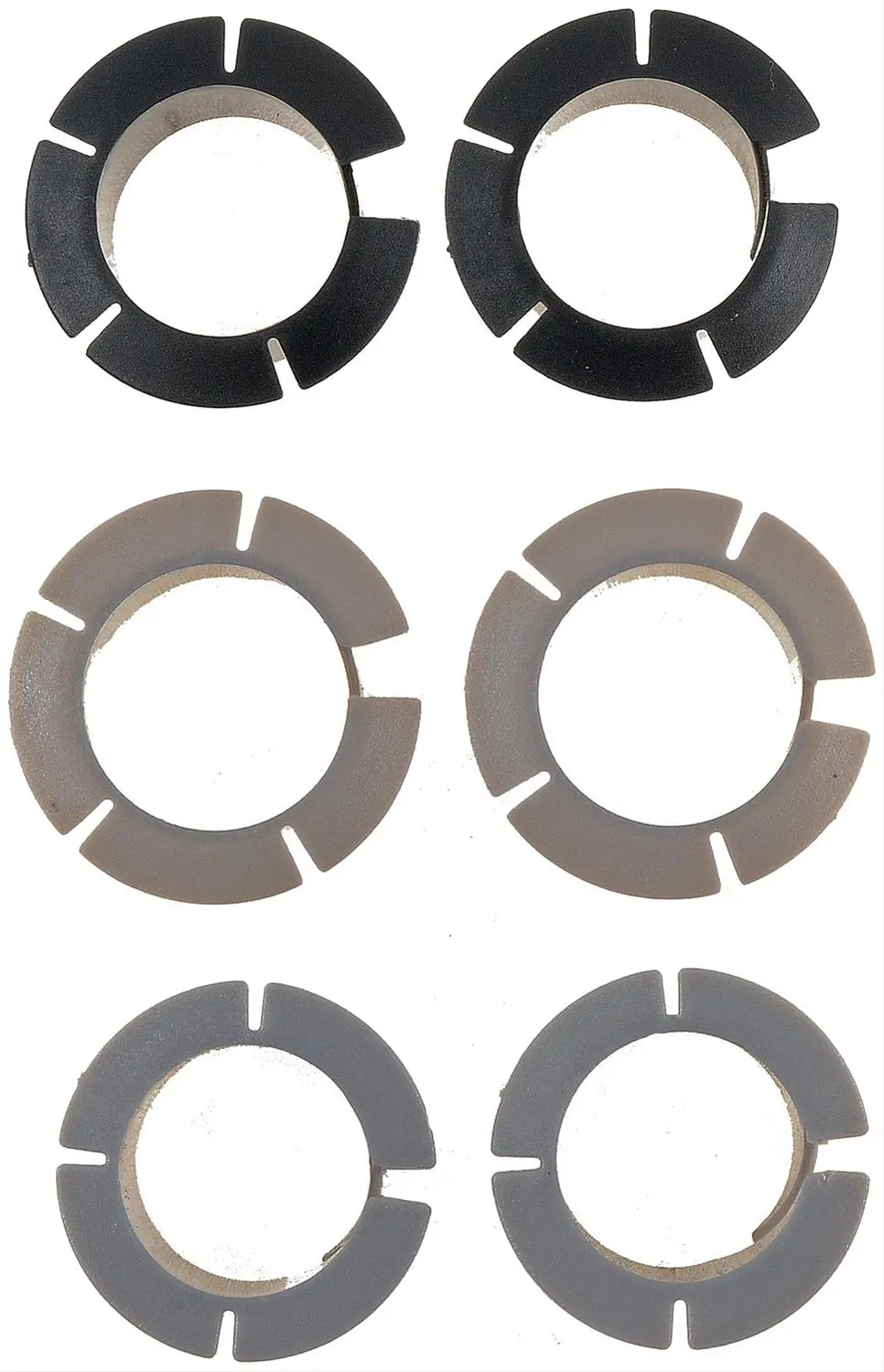

You mean these replacement brake pedal bushings?
They're everywhere......Dorman 74016. Like 6-8 bucks. Autozone.
Nah, I've got a new set of those. They go on the clutch pedal shaft. Though I'm not sure about all of those in your picture. The clutch pedal gets two. The ones on the brake pedal are considerably smaller.
I left them on when I sent the parts to the powder coater. Some reason the plastic didn't like the oven they use there.

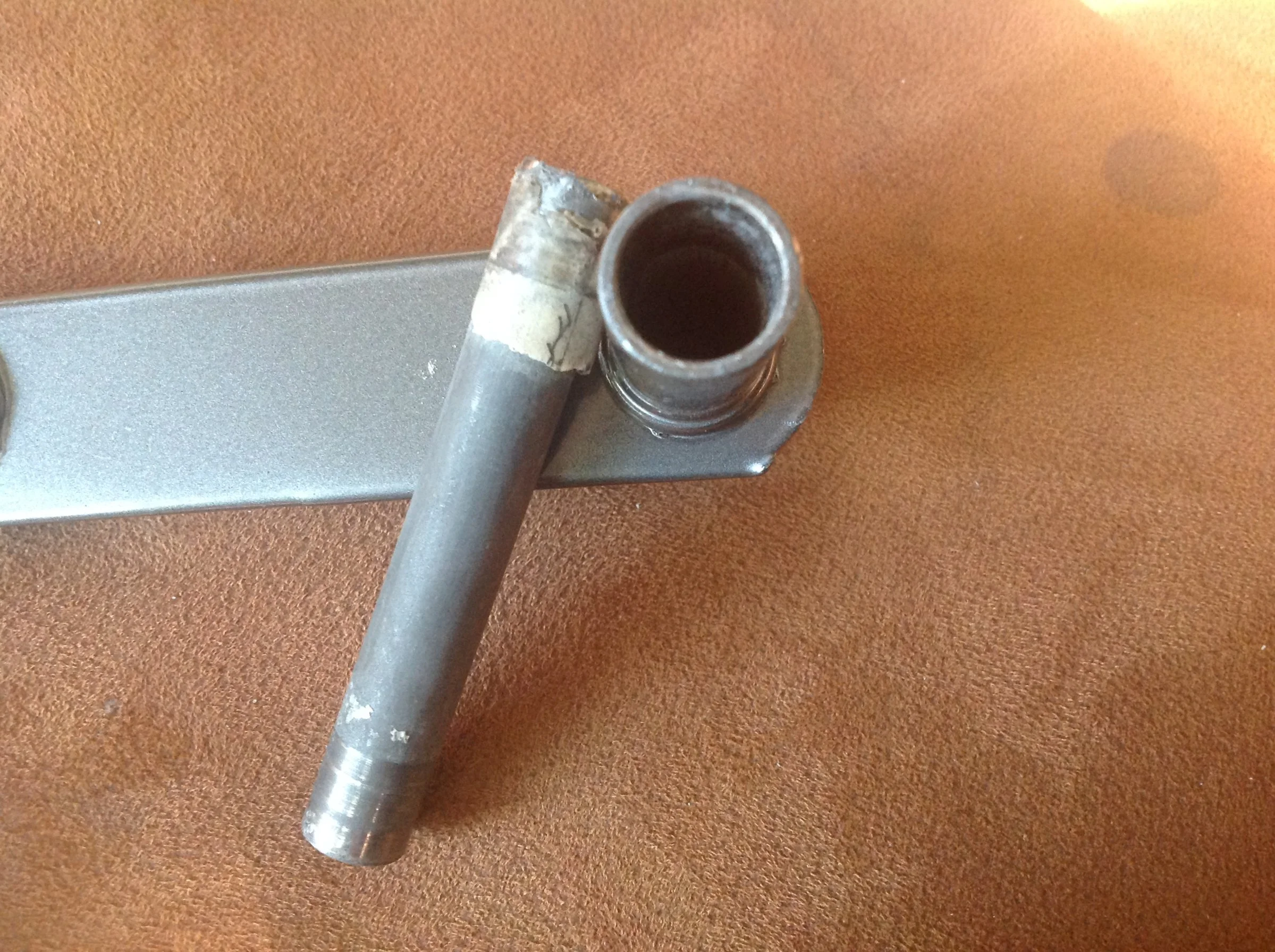

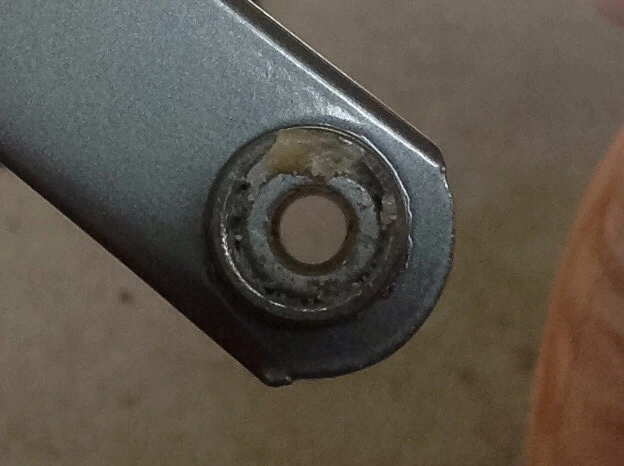

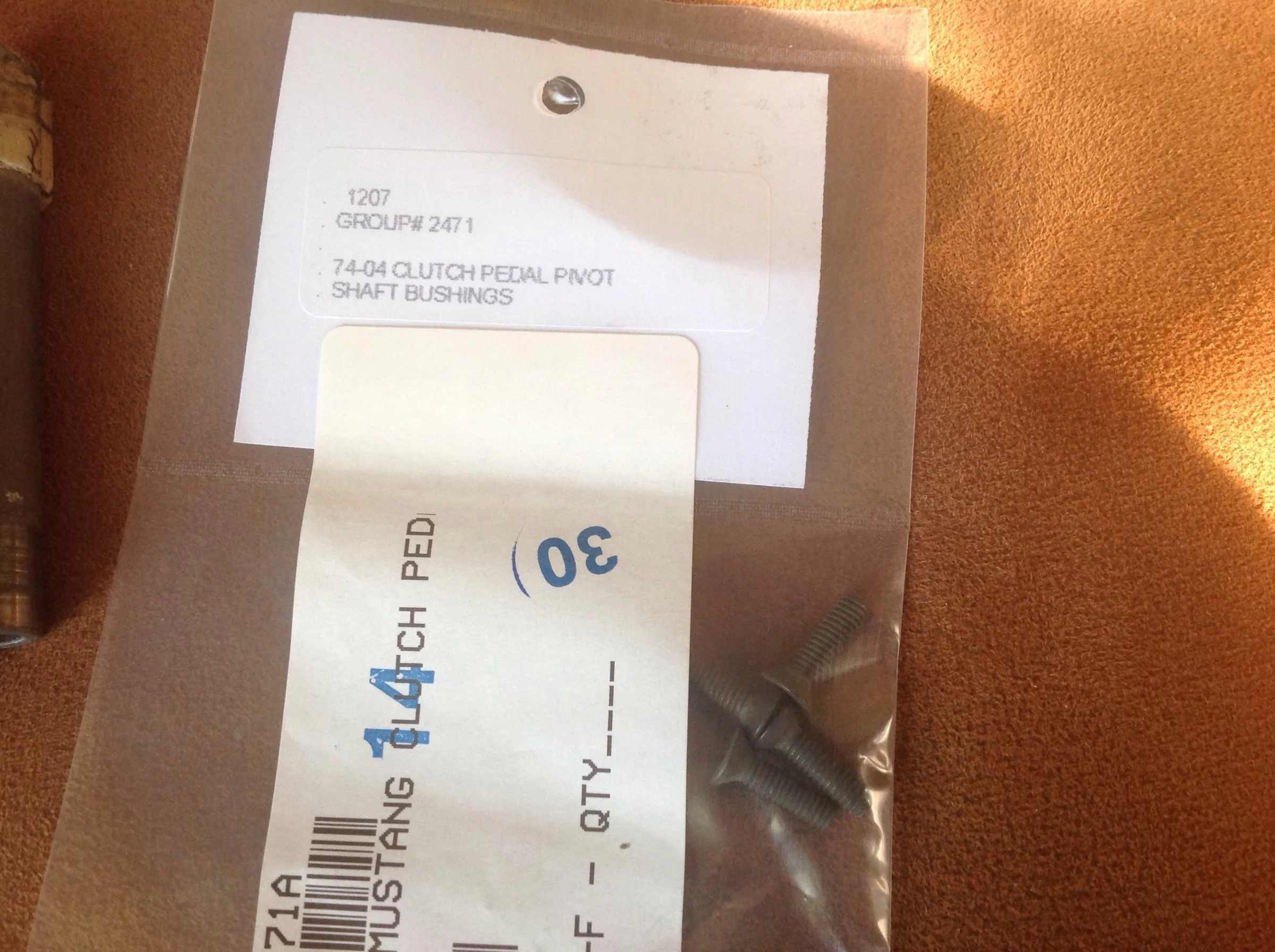

I think I'm learning things here. This is the top of the brake pedal, it looks like there is a shaft inside of there, doesn't it?
There is. I'm not sure how I missed it when I disassembled everything.
So, maybe I need to look a little longer at those bushing kits again.
I had already bought new ones for the clutch pedal, or at least I thought I did. LMR sent me a small package that I didn't open till now....the package even says clutch pedal pivot shaft bushings...what do they look like to you?

So I ended up going to Oreilly's and picked up a bushing kit. It seems as though no one makes the appropriate size for the brake pedal.
So I'm going to file two of them down to fit. So I'm going to have custom bushings! Sounds pretty killer, huh?
