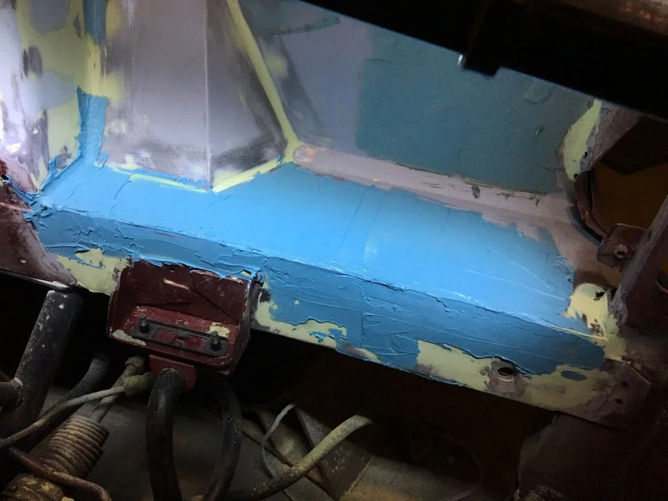

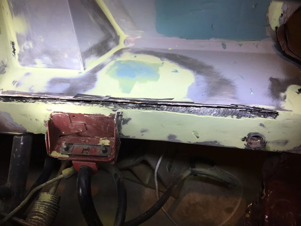

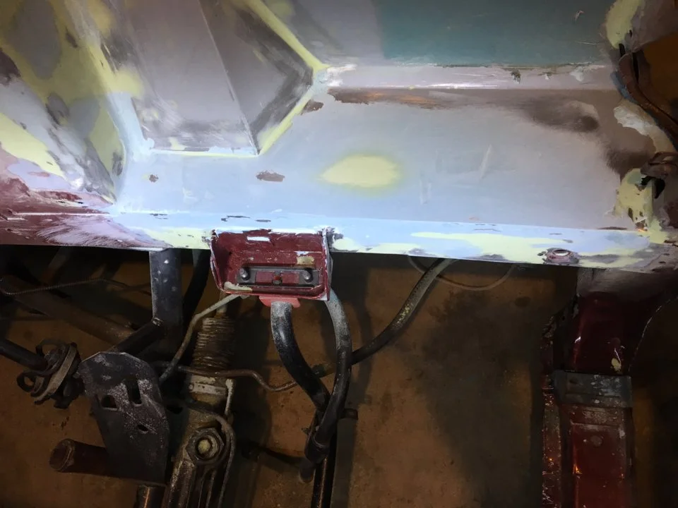

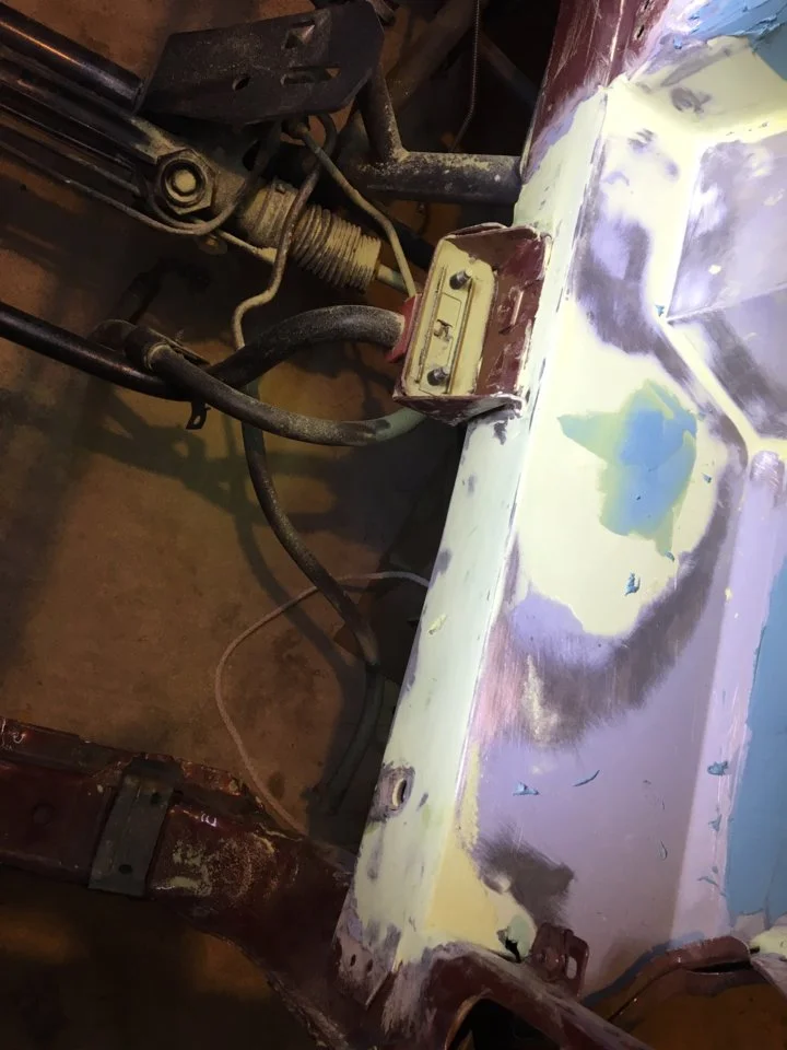

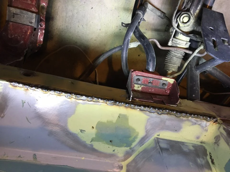

I did it, in about two and a half hours! My wife, on the other hand, who said she was working late (6:15!....6:15 is late?!) Came home as I just finished welding the edge again.
I dared to push my luck and ground down the weld and slung some mud!!!
At that stage, I was feeling cocky......Nay brother......I was the MAN. So I stayed out there and blocked the fresh bondo down! Jeez, the testosterone was flooding tonight fellas.
So, anyhow, I felt I pushed it long enough and came in and showered.
Pictures of tonight's progress:
In the beginning, there was an angled edge to the new panel. You had to be there to appreciate how much it sucked
And then there came grinding and cutting the edge of the panel, hammering the frame side straight up and grinding the edge to match the frame rail
Then I spot welded along the edge a little too fast and warped the lower panel, Yay......
Ground down the welds and put on fresh mud over my freshly warped panel
Then blocked it out straight as a multiple curved arrow
So, early tomorrow morning, way before normal humans are up(so I'll have @Boosted92LX and @madmike1157 to keep me company), I'll finish blocking out the filler. Then I'll glaze over it all with finishing glaze and block with 180 grit to prep for primering.
I'm not sure if I'll primer it tomorrow or go ahead and unhook the front suspension and clean up and POR 15 the backside first. I'll know by the time I'm doing it though.
I'll post more pictures tomorrow.
BTW, the right side is good enough for me. I'm not so OCD that I spell it CDO because that's the proper order of it!
