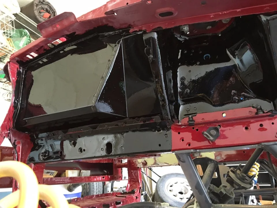

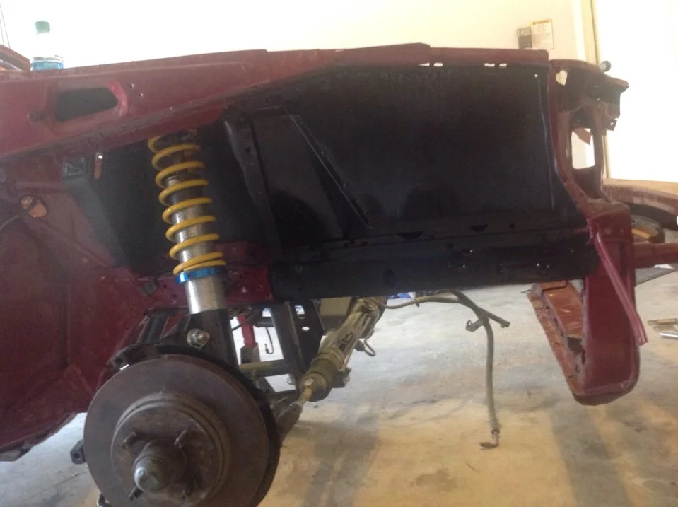

Got the insides of the shock towers ground down and sanded. I'm just using POR 15 on the insides and the back of the new SR panels.

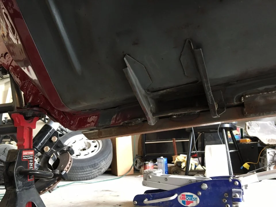

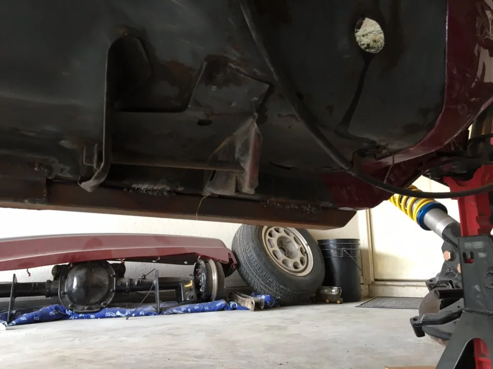

So, I got Doby up on four jack stands.
This gives me a chance to look around the trans tunnel. The left transmission mount is tweaked and torn. The right side is fine So, what do you think guys, hammer it back to where it should be and weld the tear?
Is there a replacement I should put in instead?
My brother dropped the drivetrain out so I missed this, I'm glad I saw it now.
Is there a reinforcement kit or something I should use with the mounts? It sure looks flimsy.

I've definitely had worse. Unless it's going to drive you nuts, I'd hammer it straight, tack it back together and go..
Nah, hell, I'm ok with doing just that. I was going to start coating the undercarriage tomorrow morning.

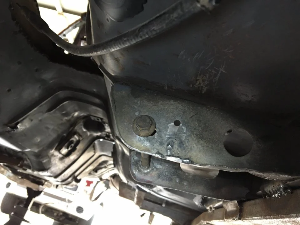

Wife is away, bent that bracket back into good enough shape, welded it up, ground a little bit.
It's so much nicer to weld thick metal, wire just flows out so nice. could have been a little prettier, good enough for me, I'm easy.

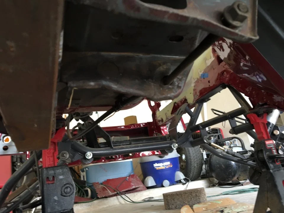

Got the suspension back up on the front. Tomorrow morning I'll be coating the undercarriage.
