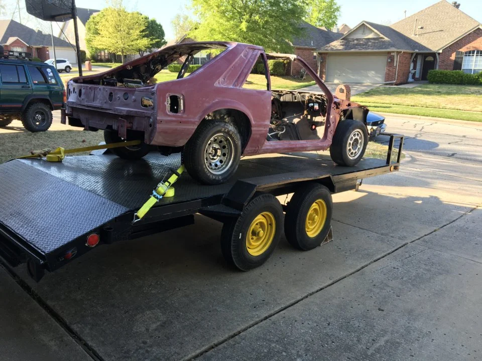

Here we go again! On the trailer for a date with the paint booth!
Tomorrow, engine bay and cowl area. Saturday, the rest!!!
