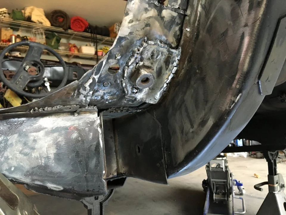

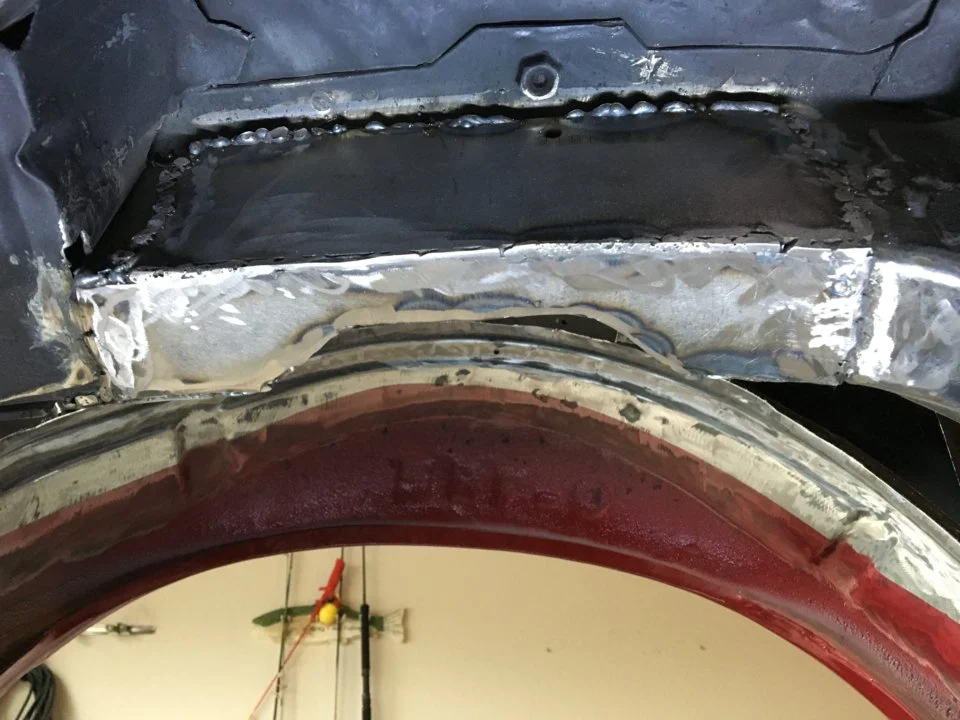

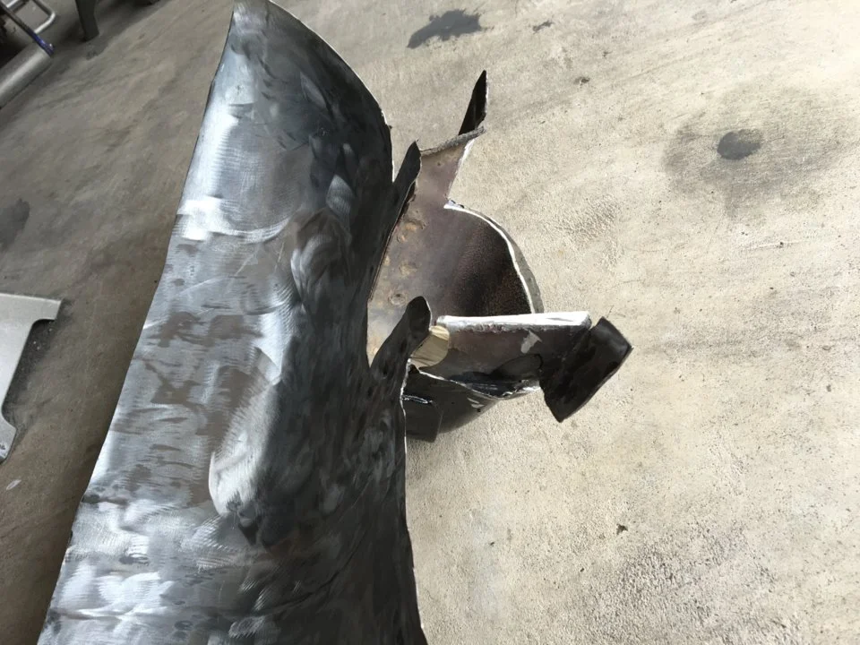

Ok, first thing, the shock tower I left attached to the inner tub and shortened it's bracket where it attaches to the frame, I don't know if you can tell, but, I cut off two full inches off that bracket. I then reshaped it to still provide strength for the shock tower by welding it to the frame later.
I got it pretty well cleaned up around the inner tub and floor.
I got the inner fitted. I just need to notch the frame now.
But, that's it for today. I have to get cleaned up and go to my grandaughter's birthday party.
I'll be back after it tomorrow. I hope to get quite a bit welded in then.

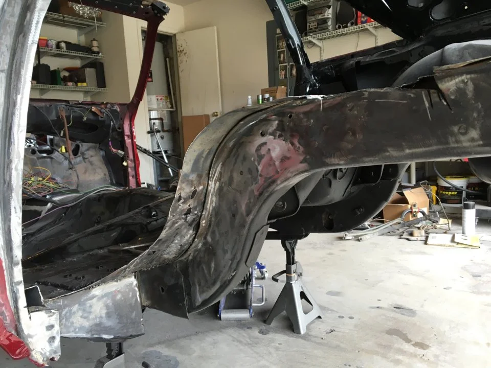

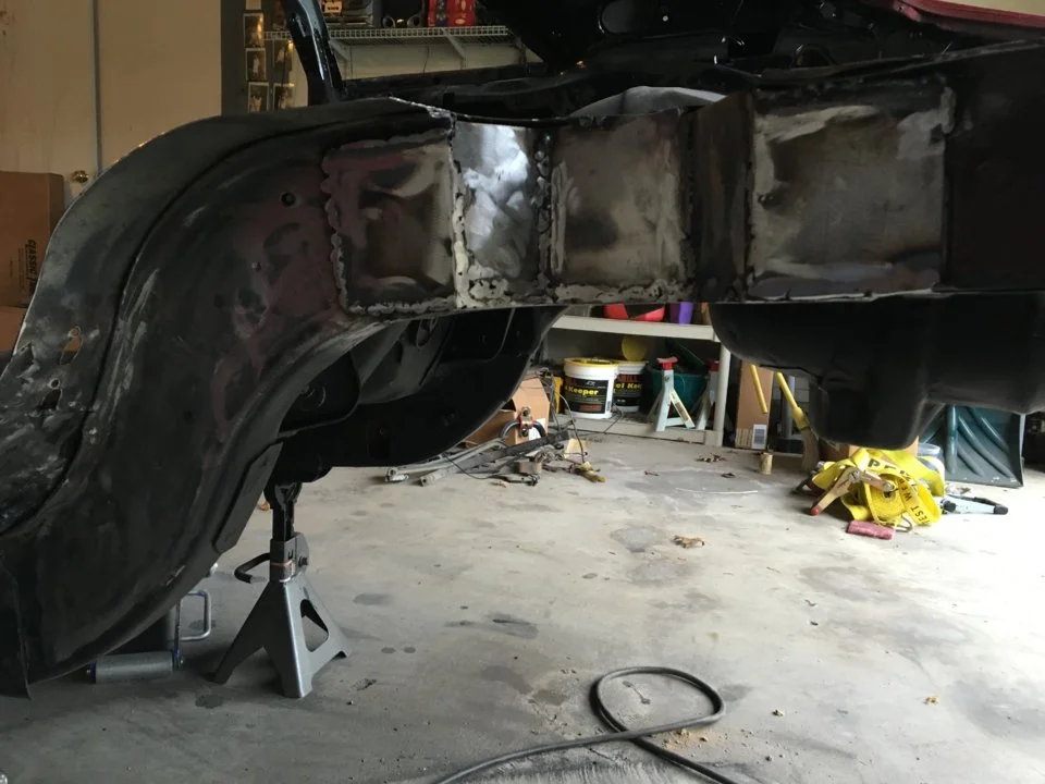

There's my frame notching. Had to beat the plates to curve with the frame, but nbd.
Got to clean it up a little bit.

This is the backside and underneath of the notch.So, the frame notch goes in 1.25".
