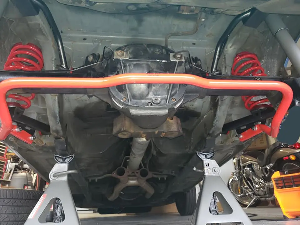

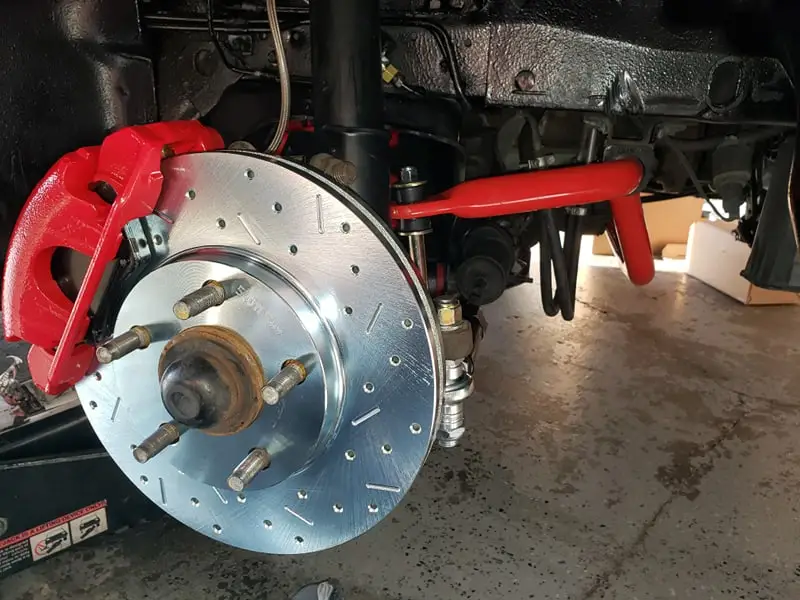

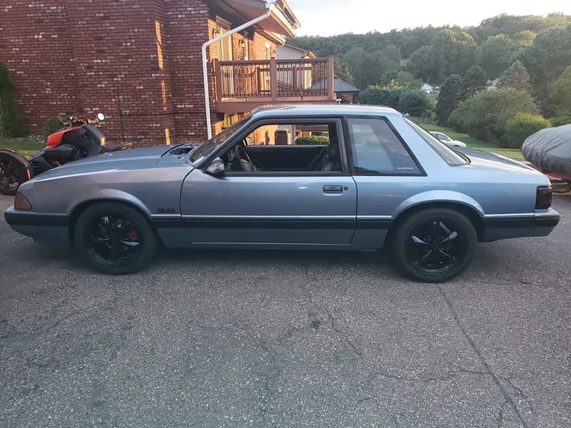

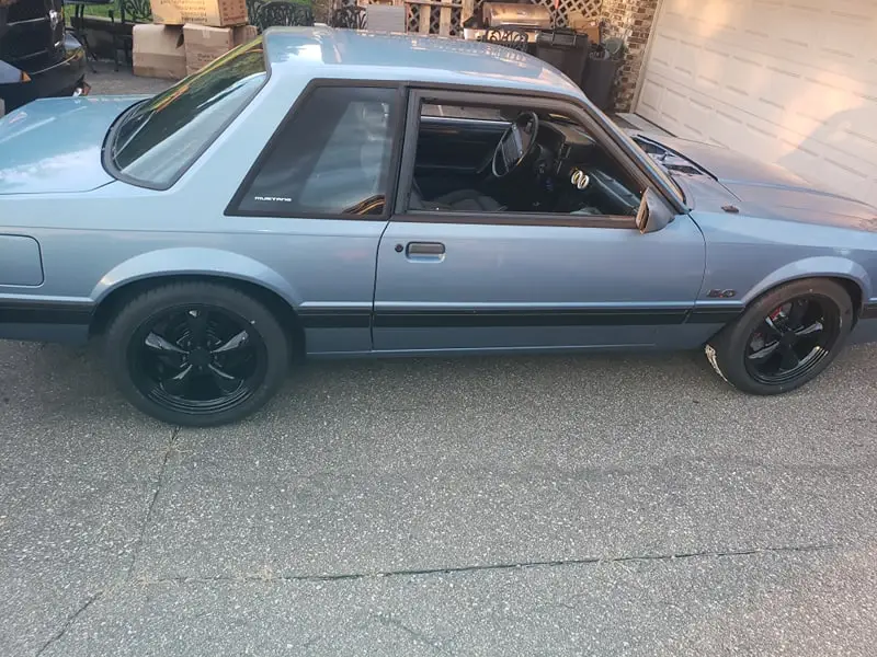

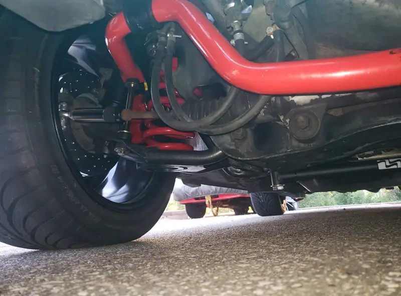

Picked this car up in May, Been doing a lot to it. Just installed BMR lowering springs,Upper and Lower tubular rear control arms, BMR upper bolt in torque box reinforcements, and Eibach sway bar kit,KYB shocks and struts and a Steeda rear upper shock tower reinforcement bar. Front BMR front tubular control arms .BBK strut tower brace. Mishimoto rad and fans, relocated the battery to the rear. Also just installed a MS2 Ecu, Taking it to get tuned on Sept 12th.
Need to install the rest the parts I got too been buying a lot from LMR and American Muscle, I think the UPS and FEDEX guys hate me. lol
