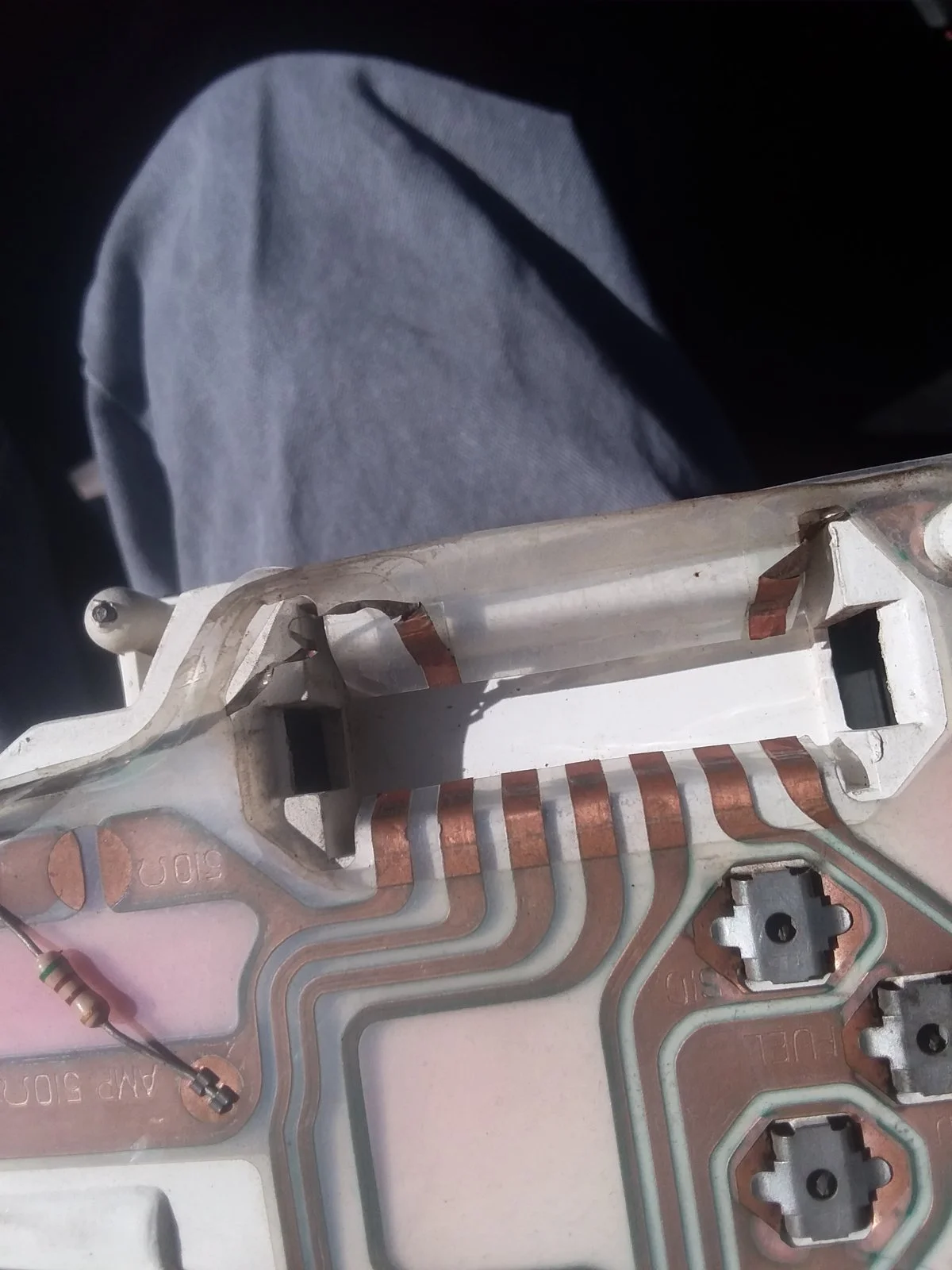

Could those bent up wires be my problem? The battery indicator bulb doesn't look burnt out to me.
