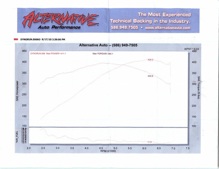

The car idles steady as can be at 900rpm, has no problem in traffic, and runs right up to 7k rpm if I push it that far. The tune is VERY safe, and I can easily run pump gas, even in 90*+ summer weather.
Its making 300+rwtq from 2k rpm, so its def not slow just cruising around. I am aiming for mid 11's as it sits right now, and maybe eventually throw a 100-150hp shot to run some 10's. :nice:

I never asked the tuner what the duy cycle was, but I'm sure they're close. If I put nitrous on it I'll prob have to go to 42's. In hindsight I should have just kept the 42's I had with my previous blower setup.
No track times yet, as its only been tuned for like a week now. I might try to go before the end of the season, but we'll see. I know its not gonna run awesome times, because it has 3.55's out back which are not optimal for this setup. I might go just to make sure I am right with planning on swapping in 4.10's this winter.
Nice combination, good numbers. I cannot believe the shop let you leave with a wacky a/f like that, though. Its going pig rich upstairs, well beyond the level of 'safe'. Theres power and rpm to be had with them fixing their mistake.

My truck was worse then that for a while ha ha. I was down in the 10's at wot. My last tune finally fixed that problem I think. I don't see where it's that bad I was told 12.8 was basically best for wot but around that area was fine. 11.9 ain't that far off of the 12 area. Not optimal but not like OMG GONNA BLOW UP bad lol
Don't get me wrong though I'll be honest this AF **** still confuses me
Nice combination of parts and results. I'd like to see your results with the tune optimized better, bet you'd hit 420 and improve gas mileage.

And MysteryMachine what he meant by 'beyond safe' is that it can be leaned out for more power. I will eventually lean it out a little bit, but I'm not complaining with the power its making now and I know its really safe.
