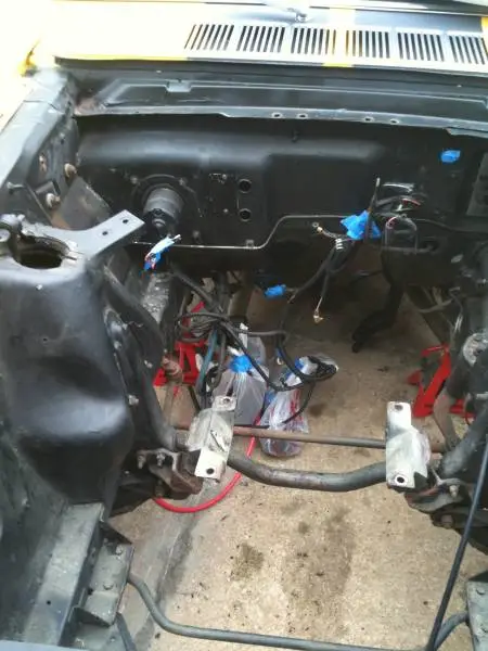

Here is what it looked like before (the only pic I had where you can see the engine)

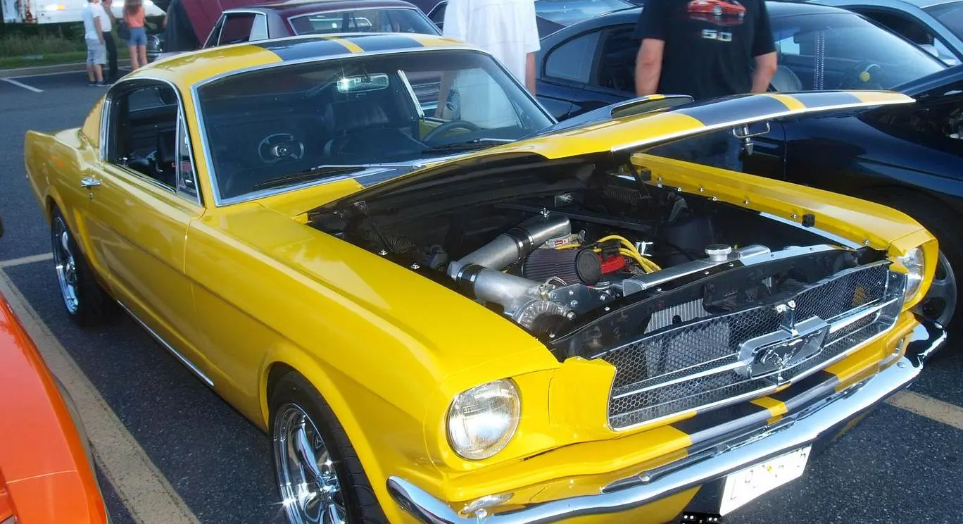

Just add the hood and the PCV hose and she's Complete. There is also a crankcase evacuation pump (that is hidden under the left fender that you can not see) using a pump for an 03 cobra.
