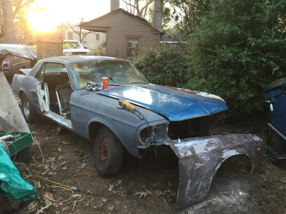

I introduced myself over in that column a few days ago so guess I should just jump on in the deep end . Billy B here out of east Texas and I'm trying to do a low-dollar 67 coupe to fastback build - a driver. I plan to use many parts I've either picked up over time or make some good decisions on where to put my money. Also doing pretty much all of it myself. So here's the stuff I have to work with :

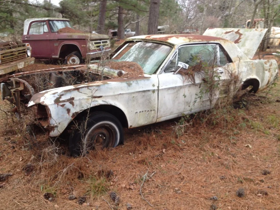

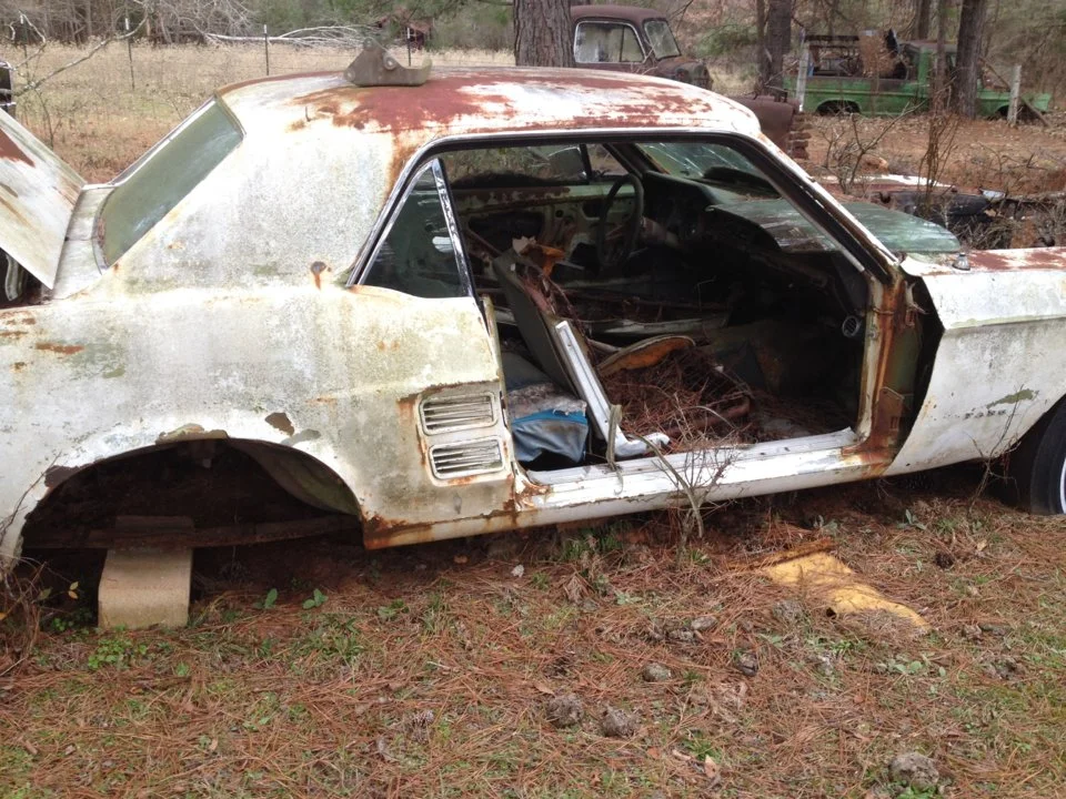

A 67 coupe - can we say rough - $ 200 price about a year ago if that puts it in context. I'll try to post pics of the start but even though it does have a tree or two growing through the back bumper it's nowhere as nice as the one I saw online today ( a 67 GT 500 outside an upholstery shop with a bush growing out of the engine compartment ) !
A 68 Galaxie 500 fastback donor car for the fastback to graft onto the coupe.
Two engines - an 89 Thunderbird 5 liter EFI engine w/o trans and a 351 Cleveland w/ a C4 trans intact.
And so far a 1959 9" Ford rearend ( 3.71) and an 8.8 rearend out of the donor 68 Galaxie 500.
To date the top has been cut nearly off the donor car and I've picked up a couple of usable front fenders and a nice hood from a local guy. I've been trying to do my research and kudos here to several of you guys ( especially "horse sence" from who I've gleaned much info )
I'll try and keep you up to date and incidently, I am serious about this though it might not make sence.
Billy B

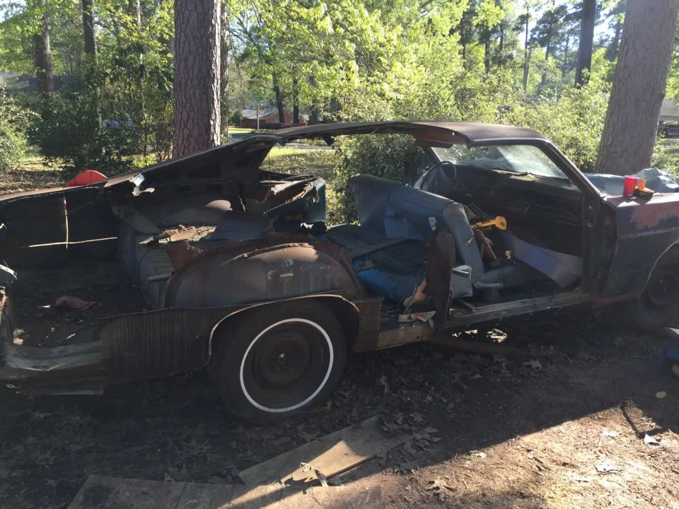

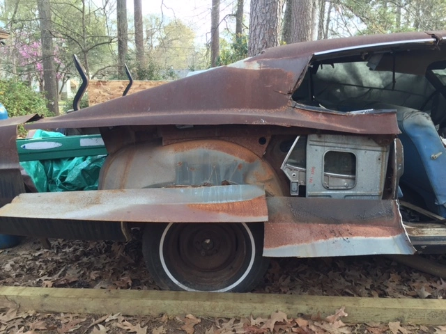

The donor car as it continues to disappear ;)

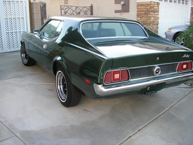

You most certainly have some work ahead of you! There is gonna be some metal work to make the trunk lid and rear window area, unless you plan on leaving the coupe part of that alone and only run simulated fastback "sail" panels kinda like 71-73 coupes?
The biggest thing I'd worry about if you go that route is visibility. It may give you one hell of a blind spot using that roof line. But it'll be different yet recognizable no matter which path you choose. I'm interested in what you end up doing with it.....

The plan right now is to pick up a rear window for a 67 fastback and conform the frame portion of my donor pieces to that. I wish Dynacorn would sell just the inner structure of their fastback conversion.
Dynacorn does sell just the inner structure , i have used it several times .I always buy it in the un welded form so i can make sure it fits correctly before it is all welded together .
Another problem you will have to overcome is the door glass .It is tempered glass and can not be cut ,it will shatter into a million little ice cubes .

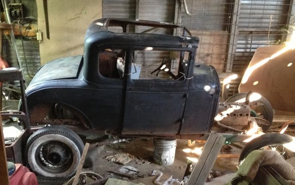

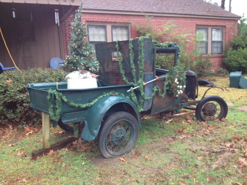

Guess I need to just sell off a few of these weird projects hanging around the house and yard to get the Dynacorn metal ! Besides I'm scheduled to have a bit of carpal tunnel surgery soon and since I'll be 69 next month it is possible I won't be able to finish all the projected projects I've amassed around here - hmmmm, got your 1929 Ford Closed Cab pickup, a 1927 model T ford roadster pickup, a 1931 Model A coupe waiting to be chopped and receive that 53 Ford Flathead in my drive, and of course the 1940 Ford 2- door in the front drive is going to give up it's transmission and rear end for that coupe. I already have a 39 tranny case so I can do the floor shift thing . But I'm not planning on wasting that 40 frame, it'll accept the 39 2-door front section that sits it front of it to receive a Dennis Carpenter rear coupe section. My first car was a 39 Deluxe Coupe and yes, I am trying to relive my youth ! LOL

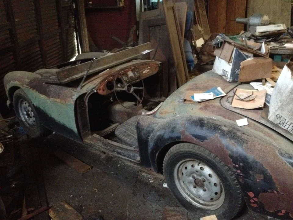

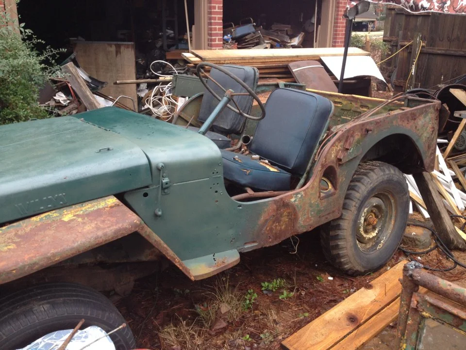

Of course there's also the 47 CJ2A jeep in the drive and the 60 MGA waiting on that engine and the 1931 Ford Pickup made from a 2-door sedan back probably in the 50s over at various storage places. Nearly forgot the12-15 old Triumph motorcycles in the back yard and back bedroom ;). I still don't understand why my ex left me ?
