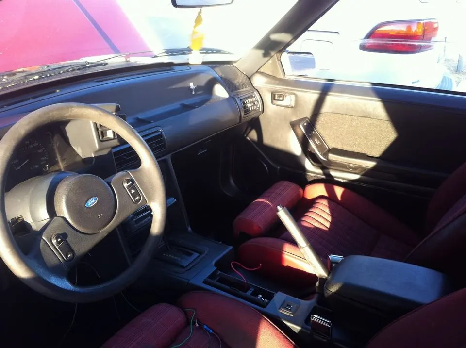

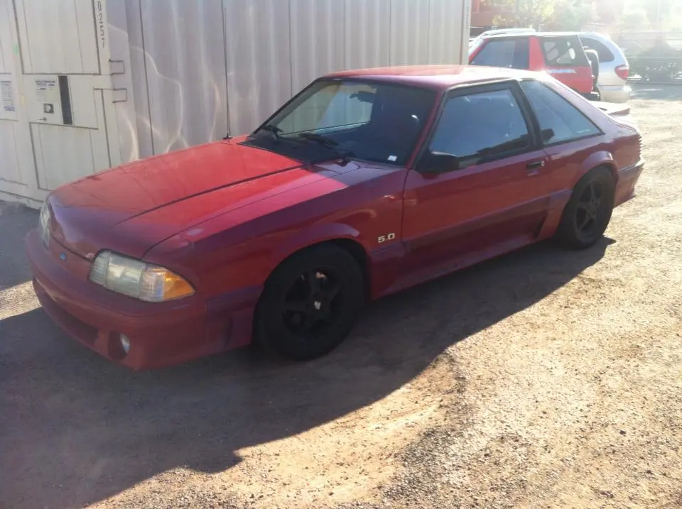

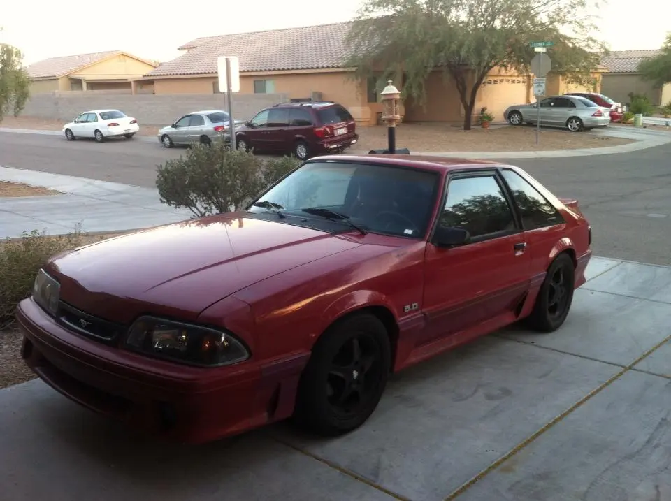

Well I picked this gem up for $4500
1988 Ford Mustang GT Hatchback - "Andariel the Demon GT"

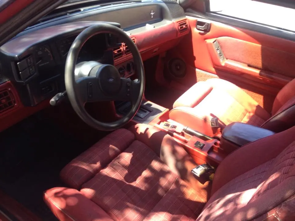

My plan is to drive it as is, change the interior black, and make her FAST....She needs to live up to the demon name right?

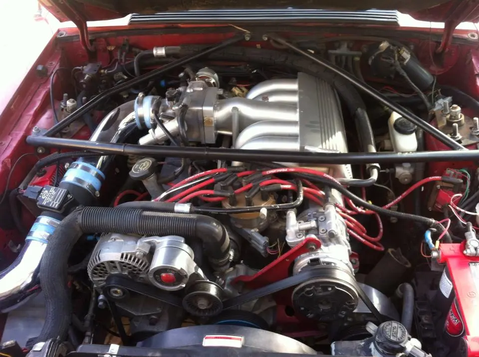

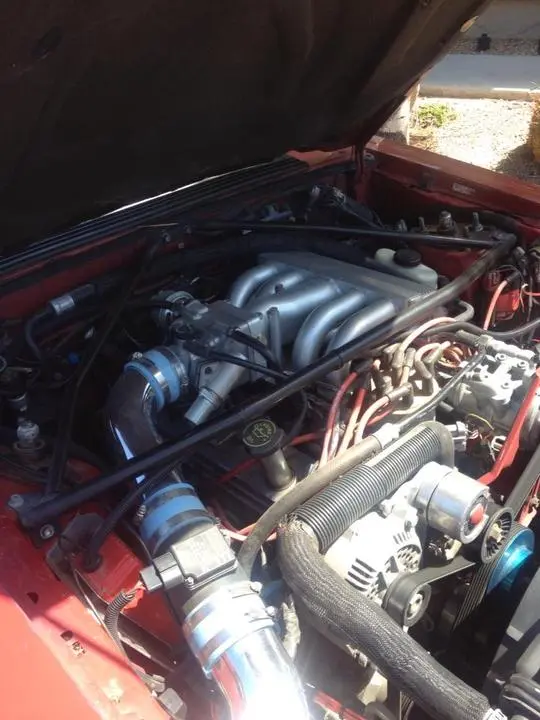

So this is the mod list the previous owner gave me..
GT40 block - Not true stock 302 block
E7TE Cylinder Heads - yup stock heads
GT40 Stainless Steel swirl polished valves - not sure
Intake 1.940 - not sure
Exhaust. 1.540 dual springs- not sure
E303 Camshaft- probably it lopes decently...
Ford Racing Crank Balancer - not sure
Ford Racing 50oz SFI Crankshaft Damper - not sure
Ford Racing High Volume Water Pump - not true
24 lb. Injectors - - not sure
GT40 Tubular Upper Intake -yes
GT40 Lower Intake - yes
Pro Mass Air - not sure
BBK Cold Air Intake -yes
MSD 6AI Ignition Coil - not hooked up but there
Single Electric Fan -yes sucked
3 core radiator - not true stock radiator
BBK Shorty Headers - yes with exhaust leak
BBK Off-road H Pipe - yes
Ford Racing 8mm Spark Plug Wires - yes
Adjustable Fuel Pressure Regulator - yes
BBK Underdrive Pullies- some of them
65mm Throttle Body - not sure
65mm EGR Spacer - not sure

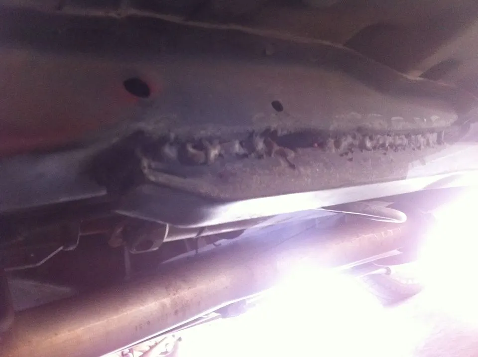

Kenny Brown Double Cross Subframe Connectors Welded - yes welded badly
Global West Strut Mounts - yes
Global West Rear Control Arms - yes
Poly Sway Bar Bushings - not sure
5 lug conversion -yes
16 inch Cobra Wheels - yes
2006 Mustang 2 piston caliper polished Front Brakes - not sure probably not...
2004 Cobra Diff - not sure
3.27 Gears - not sure
2004 Cobra 31 Spline Axles - not sure
2004 Cobra Rear Drilled Disc Brakes - not sure
Aluminum Ford Racing Drive Shaft -yup
3 Point Strut Tower Brace - yup
Wilwood Adjustable Brake Proportioning Valve - yup
1993 Cobra Master Cylinder - not sure
1993 Cobra Brake Booster - not true stock booster
Eibach Springs - not true the are bbk or HR cant remember
190 lph Fuel Pump - not sure
KYB Rear Shocks - yup
Lentech Street Terminator AODE Transmission - I think so... shifts nice...
9.5 converter - guessing
2600 stall - somewhere around there
Hayden Transmission Cooler - yes
Chrome Transmission Pan - yes
Poly Transmission Mount - yes
130 Amp Alternator - not sure
Optima Red Top Battery - yes
24lb injectors are blue
Pro-M looks right
130amp has the signature 2 hole, so that is right also
Awesome thanks!

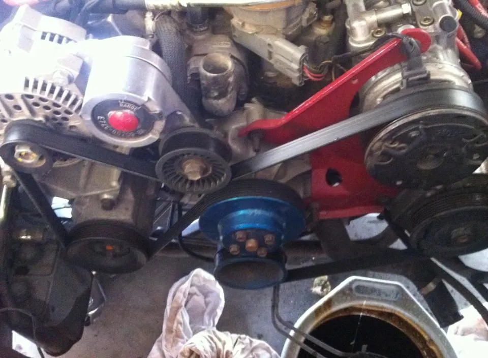

btw your A/C clutch is not connected if you are trying to get your A/C to work, its at the a/c pully/belt area
I fixed it thanks!

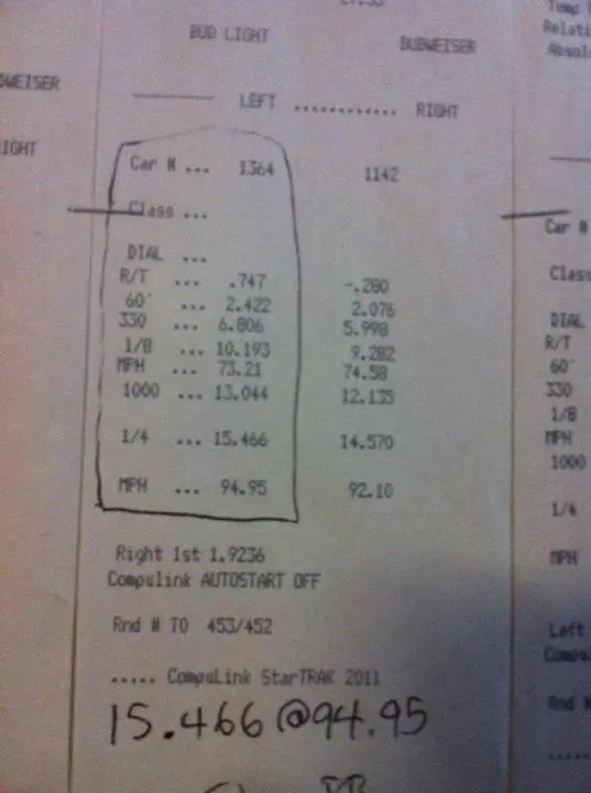

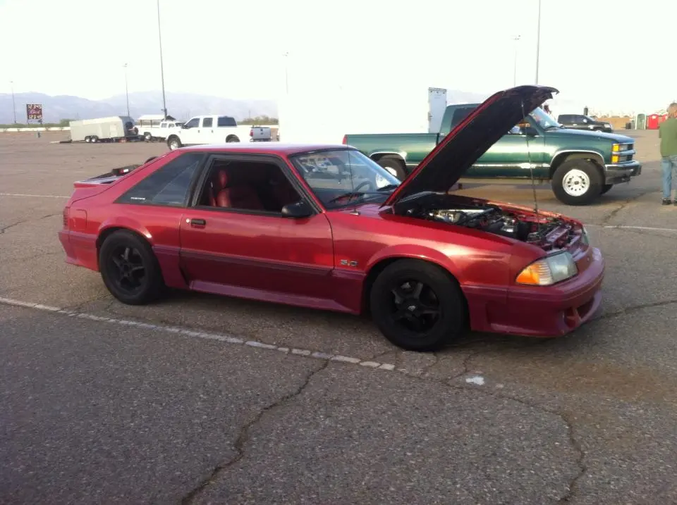

Well I took her out to the track last night... Southwestern International Raceway in Tucson, AZ. It was a great night for a Test n Tune. I got 16 runs in which is amazing. Even if I was there from 5PM to 11:30PM.
Here is my best slip.. I think I should be fast but I just couldnt get any better at all. I started in the 16s and brought her down to a consistent mid 15.
What do you guys think? Is there something wrong with it?
PB Time Slip

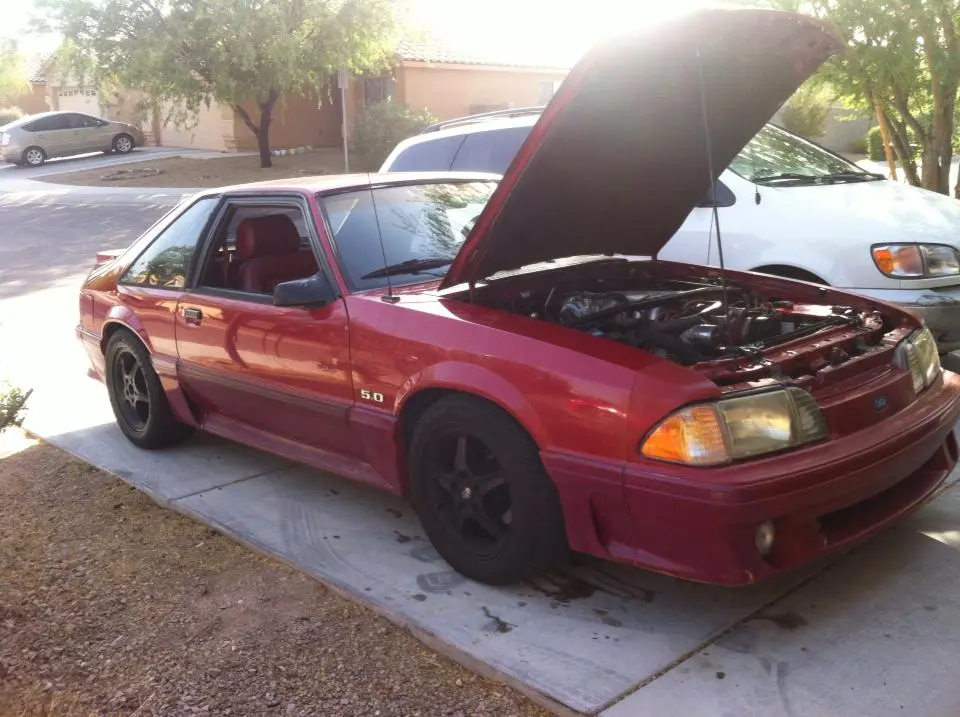

Well I just changed the oil... WIX Filter and 5W-30 Castrol Oil Non Synthetic... She is running great with just a few things to fix..
AC doesnt work, Transmission seems to have a slight leak, not horrible, but left a small spot on my driveway... I am picking up 7 boxes of goodies on Thursday morning!

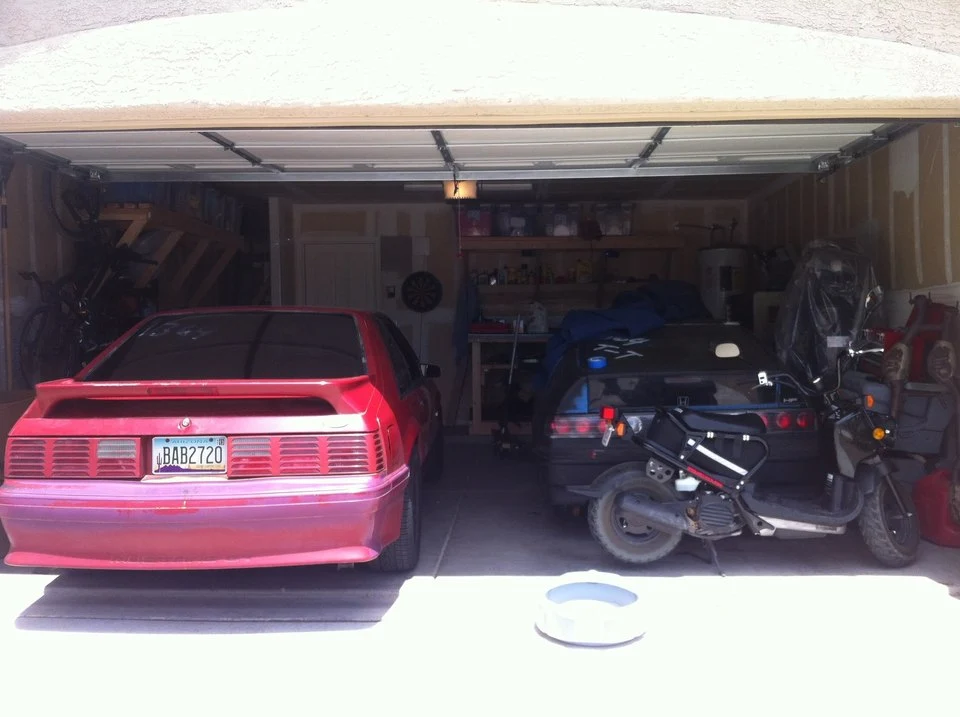

Here she is with my Scooter DD that I use if I dont have to go over 10 miles, and my Race Car CRX that I have now sold!

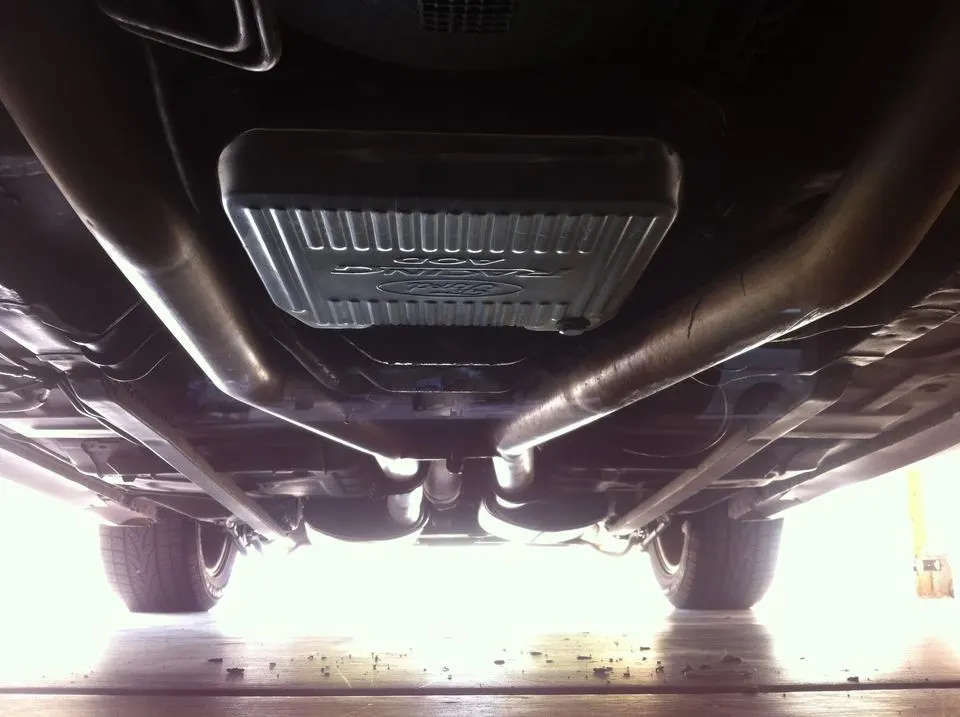

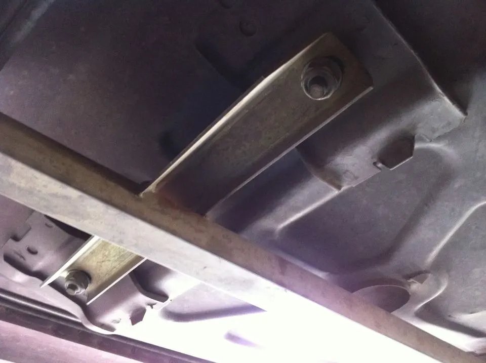

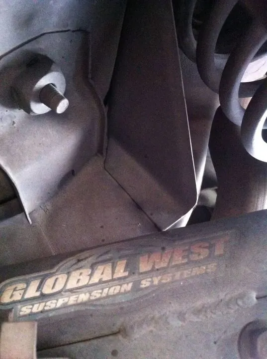

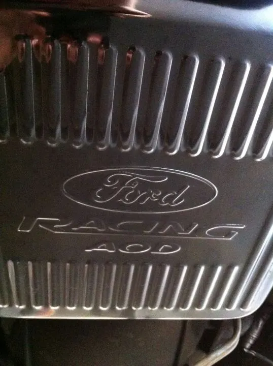

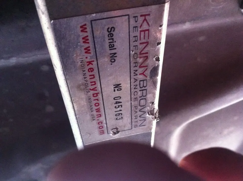

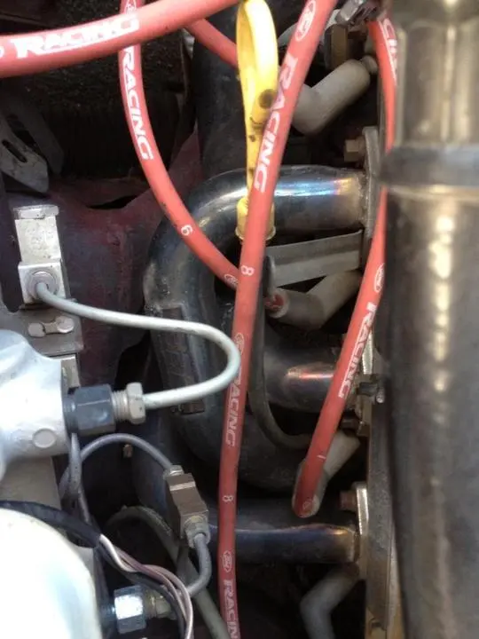

While I was under there I snapped some pictures to prove the mods are real!
Subframe Connectors...
Aluminum DS
Global West Lower Control Arms
Shiny AOD Pan
Pretty good looking belly :)

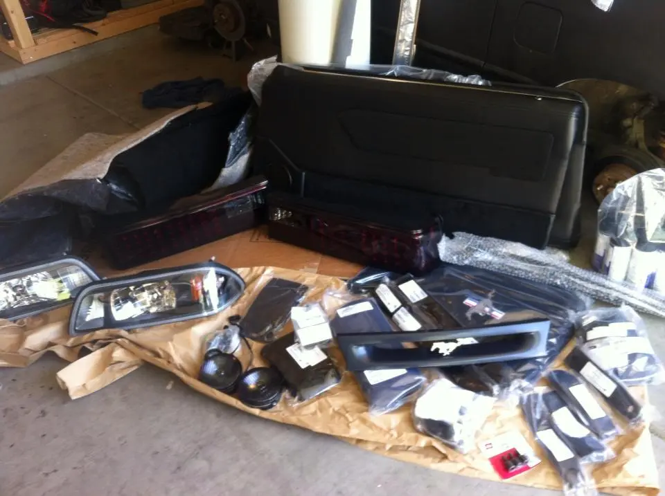

Then I picked up a bunch of boxes... What could be in them?!!?!
CAR PARTS!!!!!!

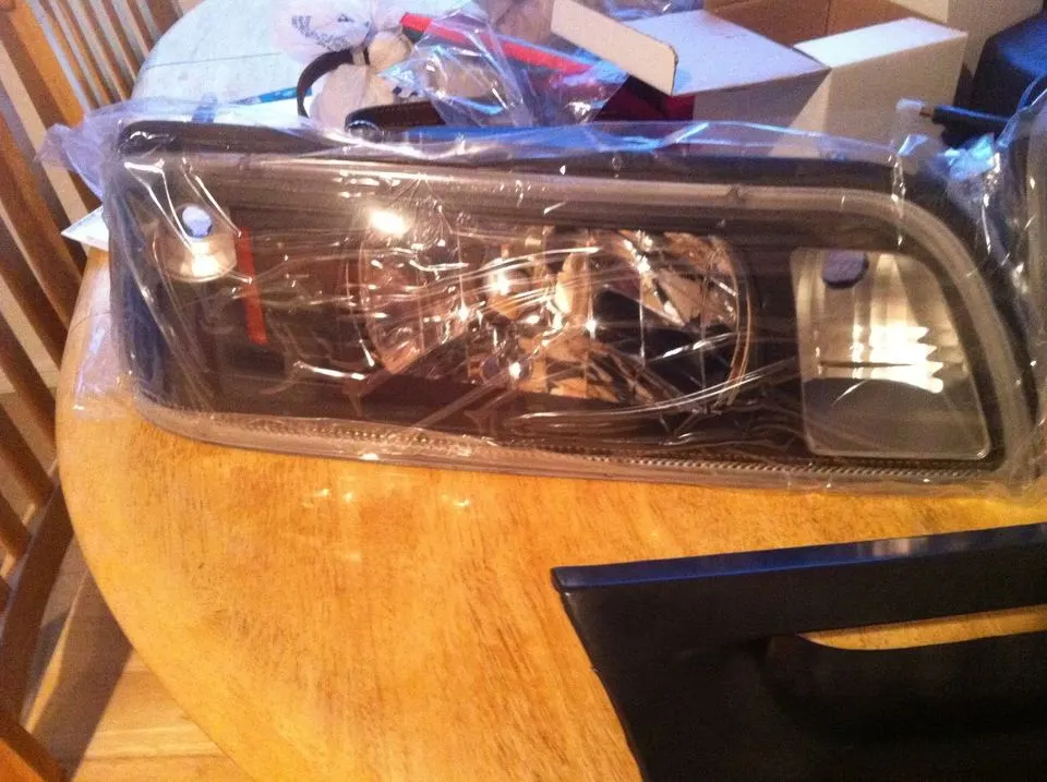

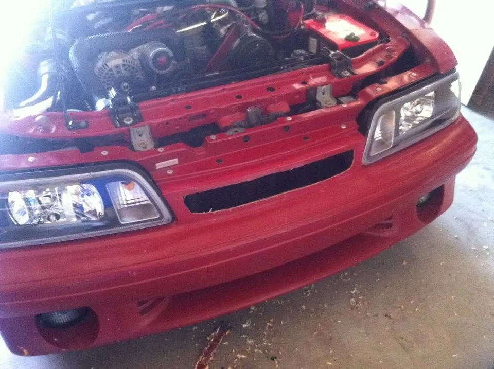

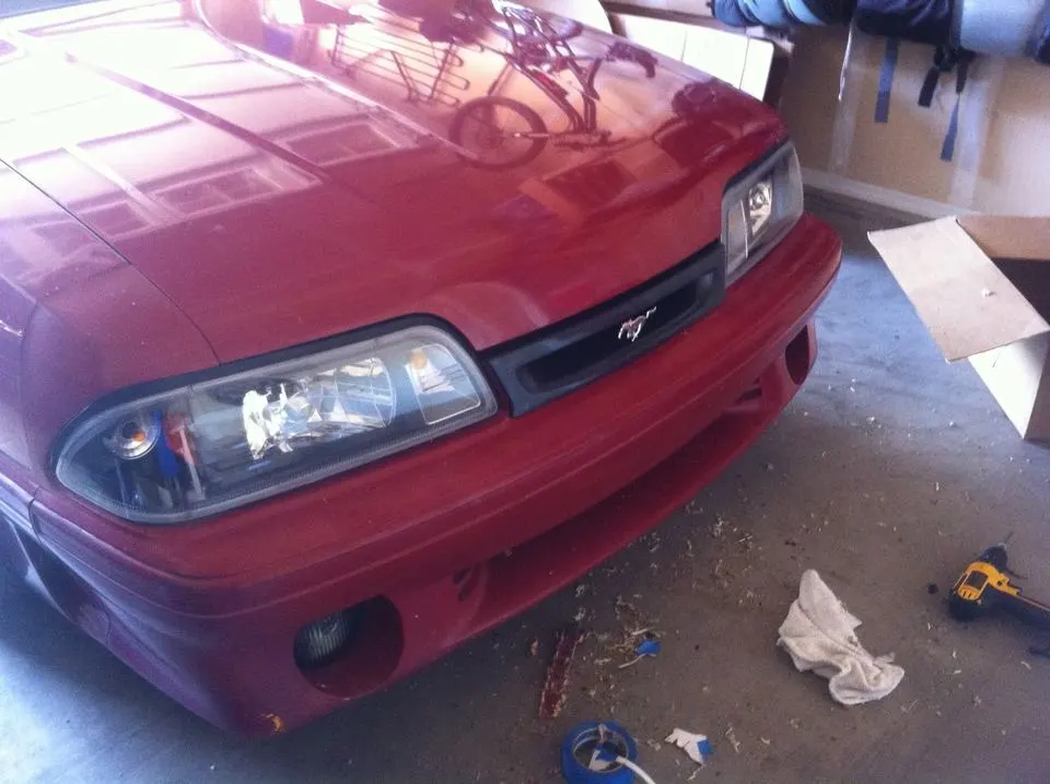

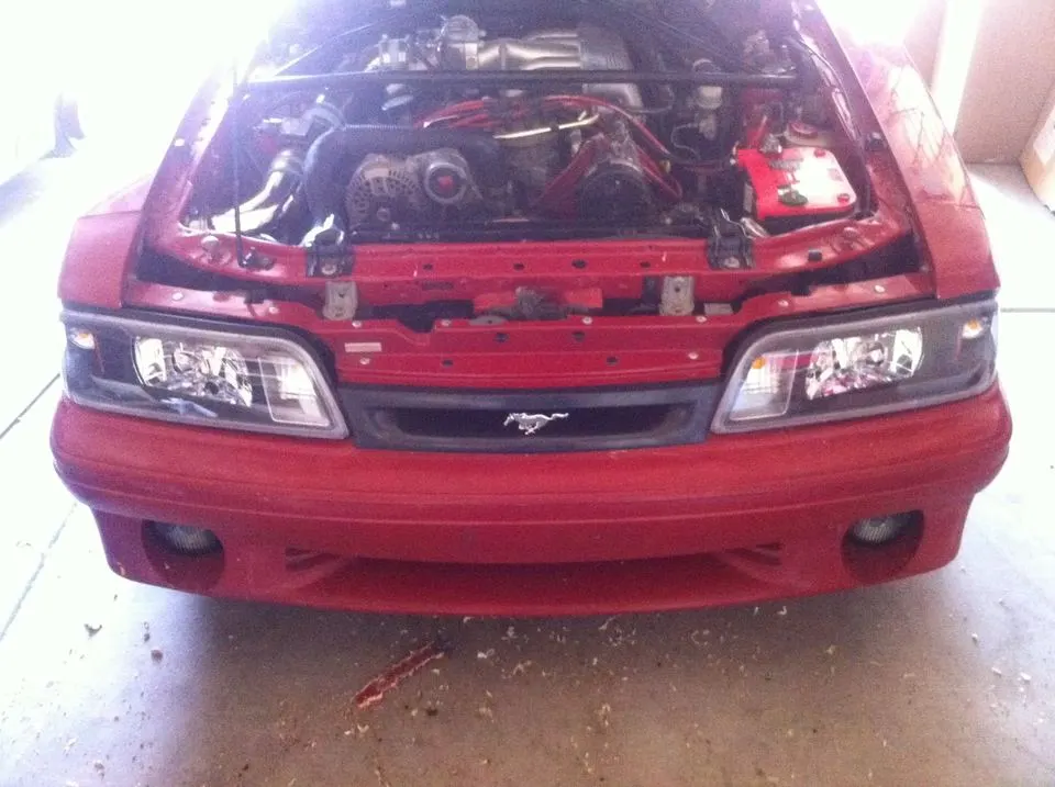

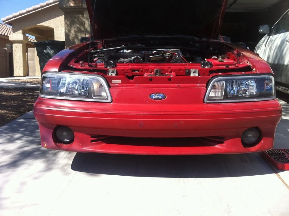

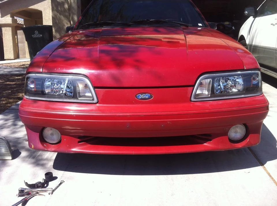

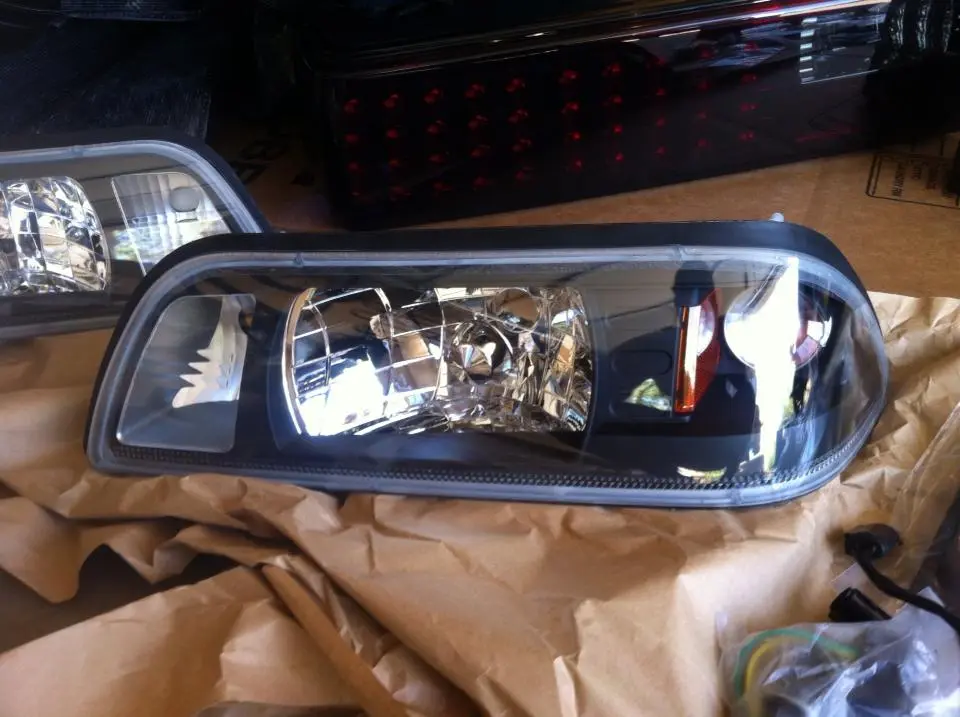

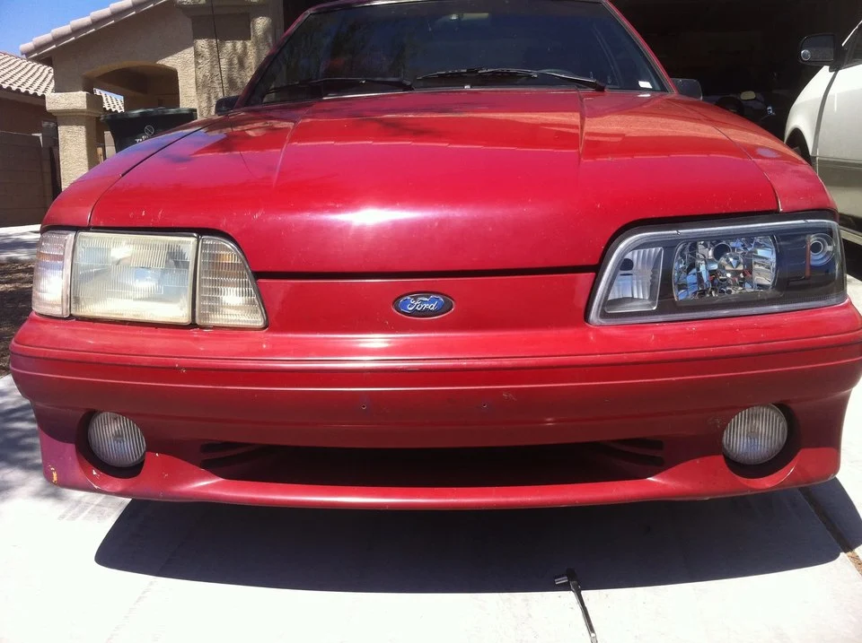

Here are the new head and fog lights... Yeah they are one piece and I like them...

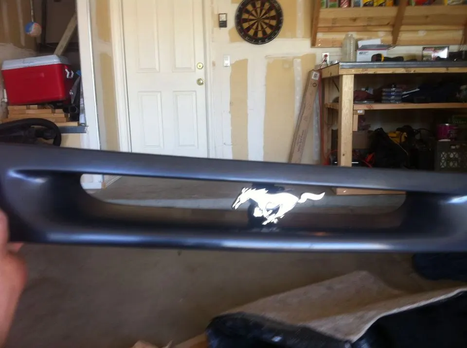

I threw a cobra grille on too.. I think it looks loads better even unpainted... I am saving for a paint job so dont say anything about leaving it like that lol.. No point.
Not a bad hole for using a dremel and melting my way through. I have hundreds of little burns now lol..
Looks good!

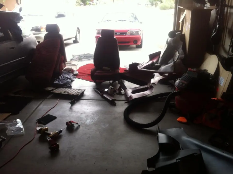

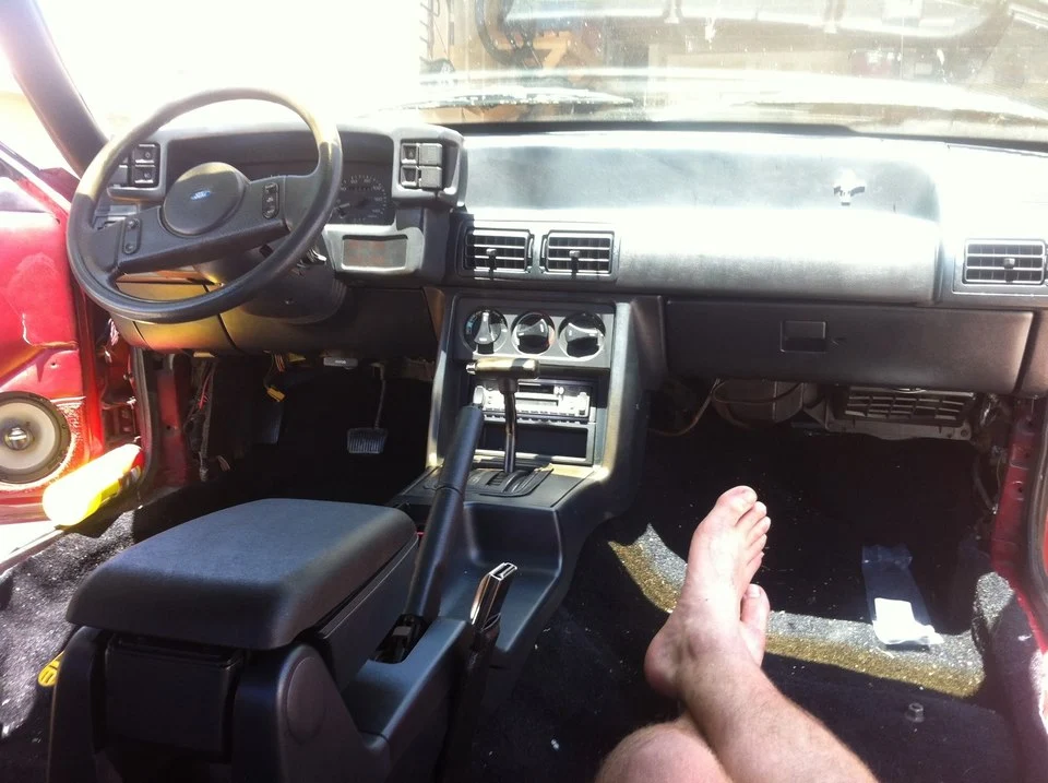

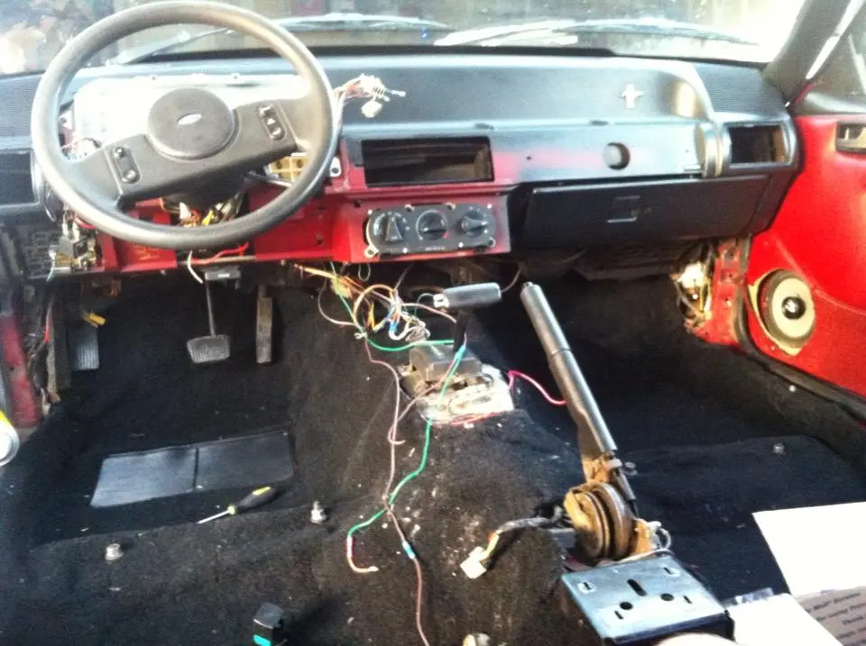

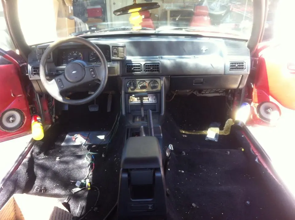

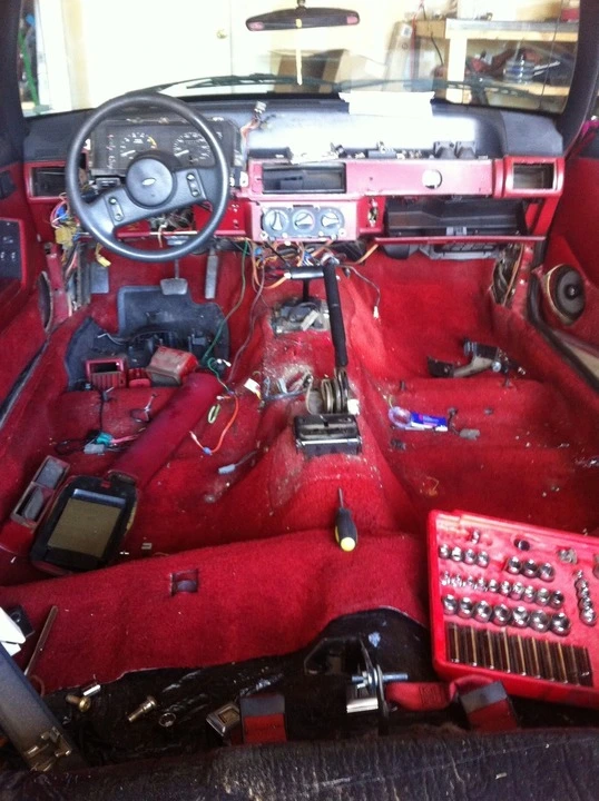

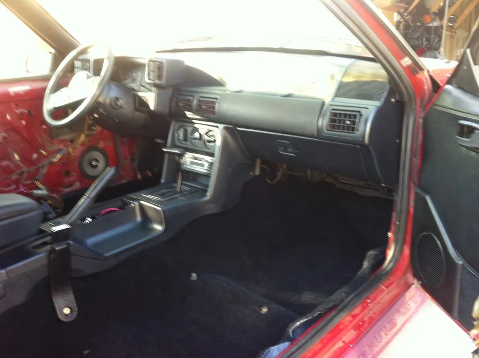

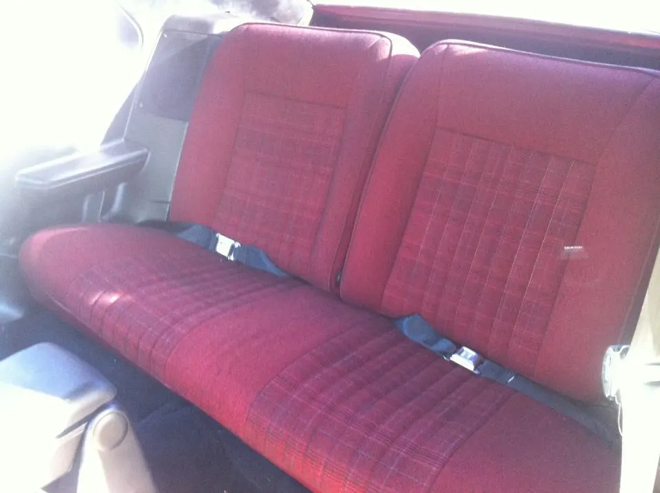

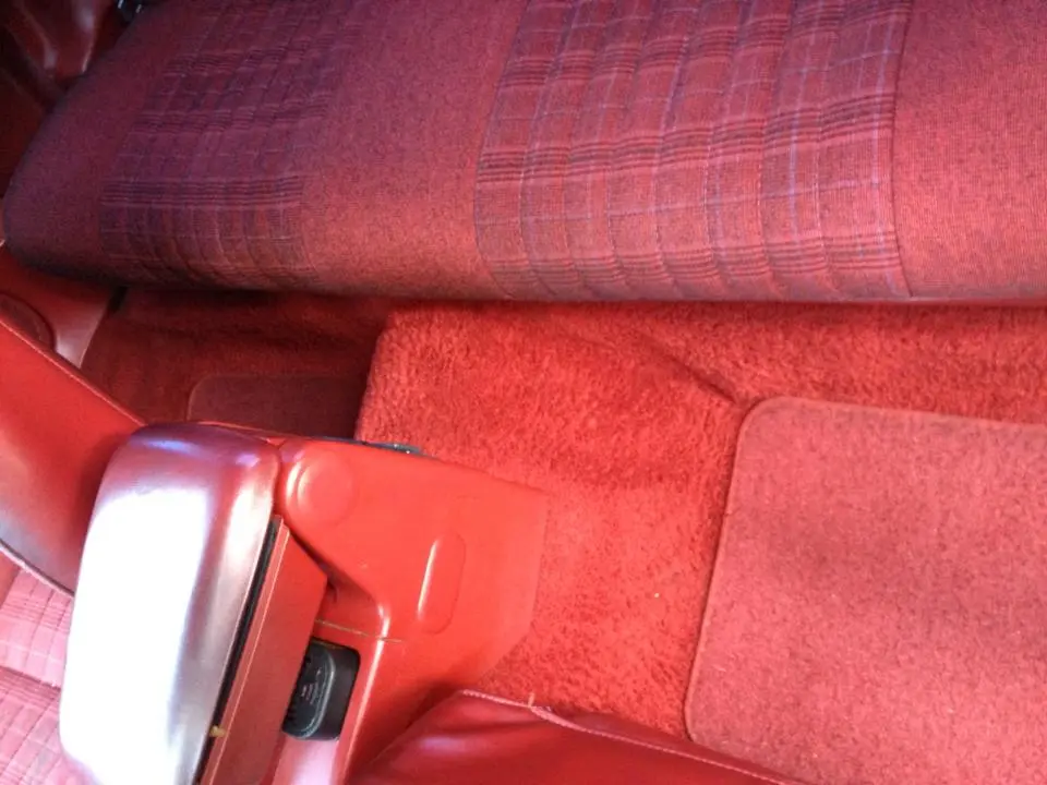

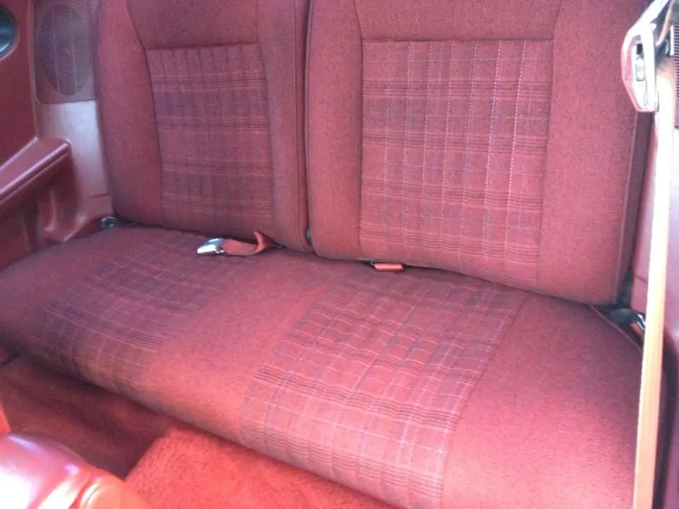

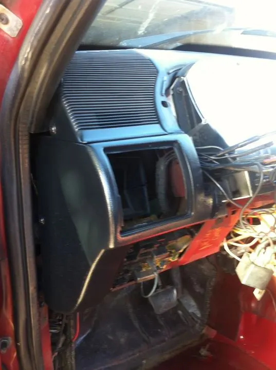

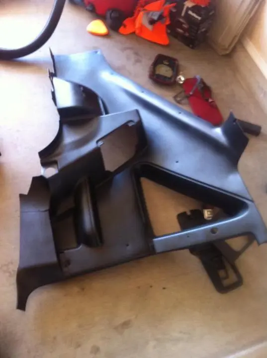

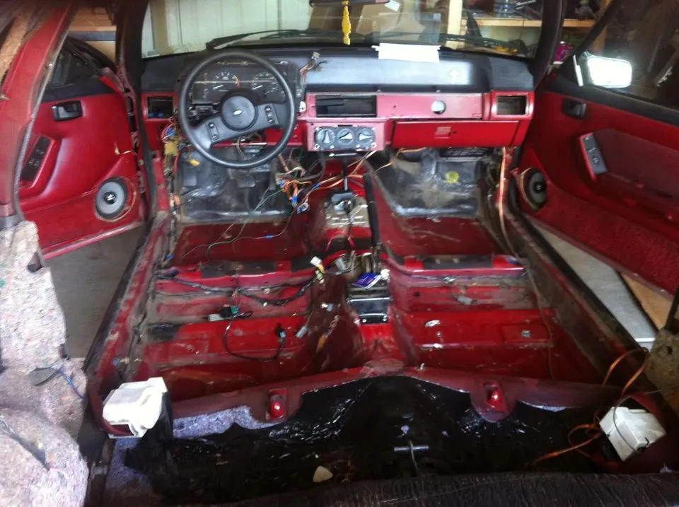

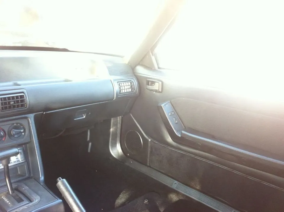

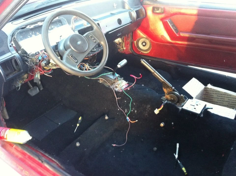

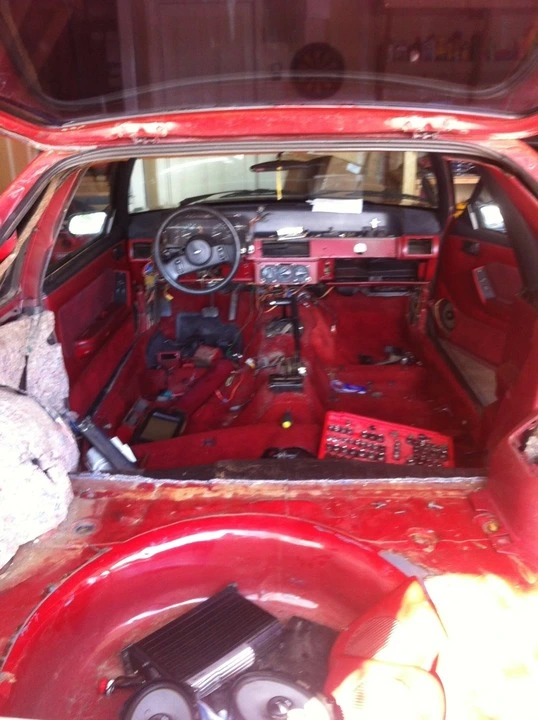

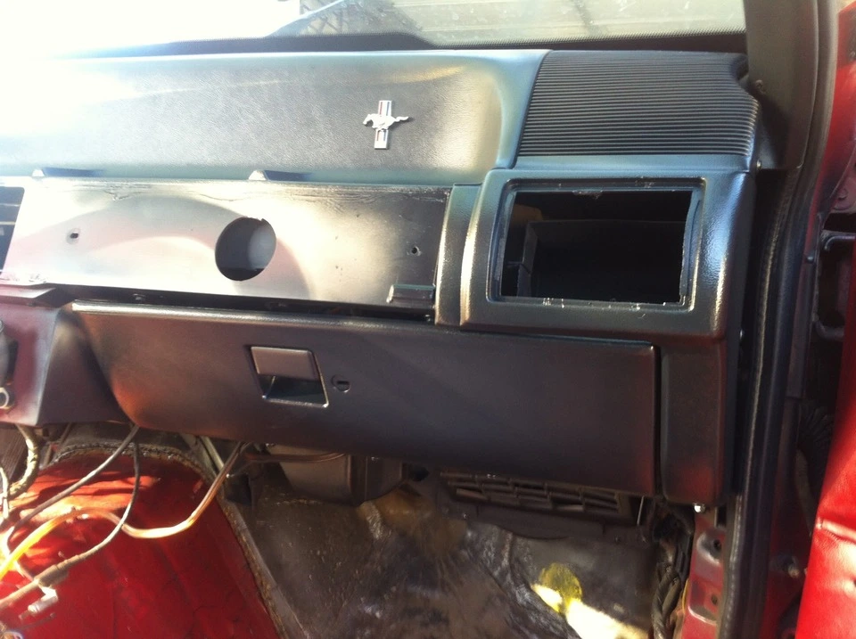

Okay now for the real interior getting down to it!
Carpet out! What a HUGE PITA man!

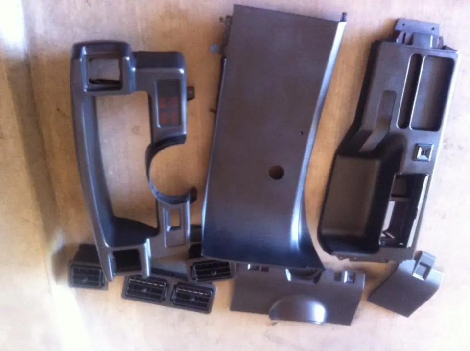

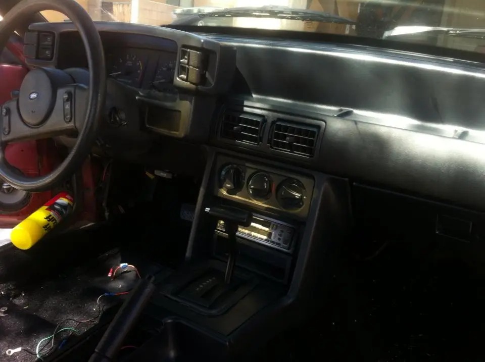

I got the corner edges of the dash cleaned and then pained... It matches perfectly!

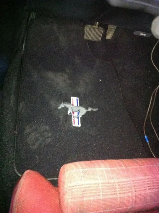

Time for carpet to go in!
Going in pretty well... It only took a few hours...

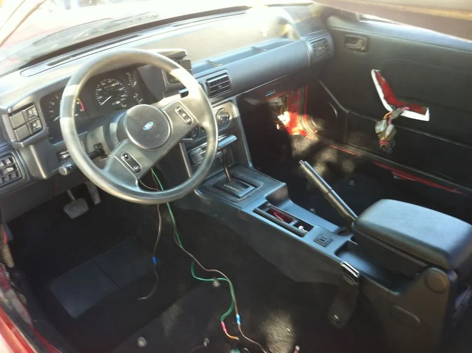

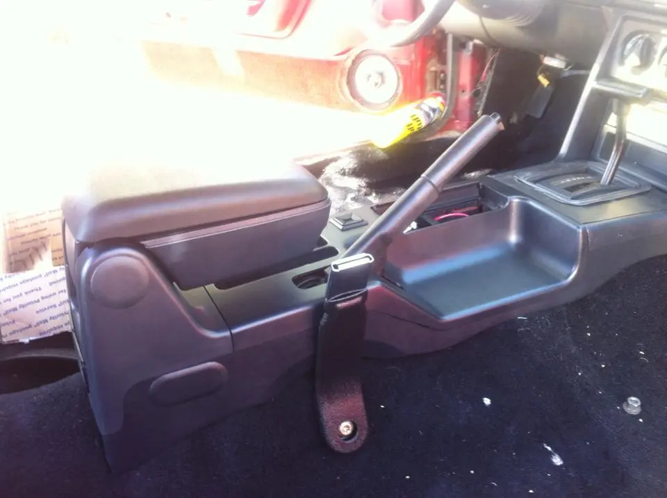

Fuel cutoff I wired in...
Brand Spankin New seat belts and plastic covers... Looks soo good!

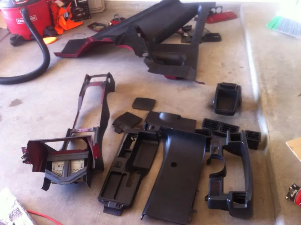

Well my garage is a disaster... But parts are clean and painted...
Installed!

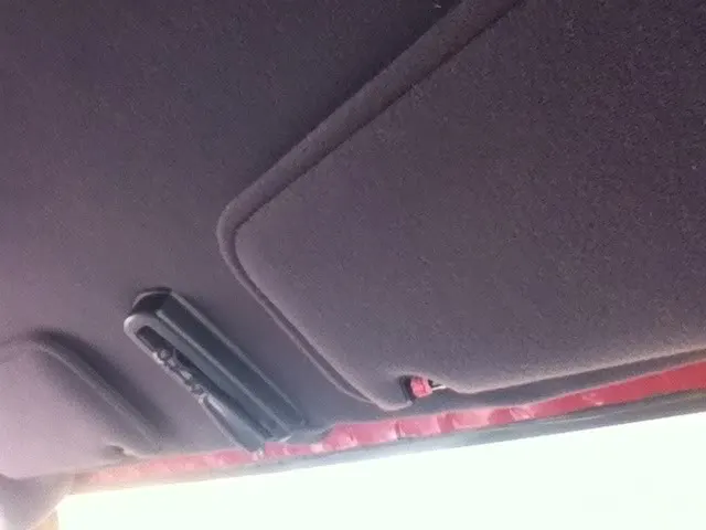

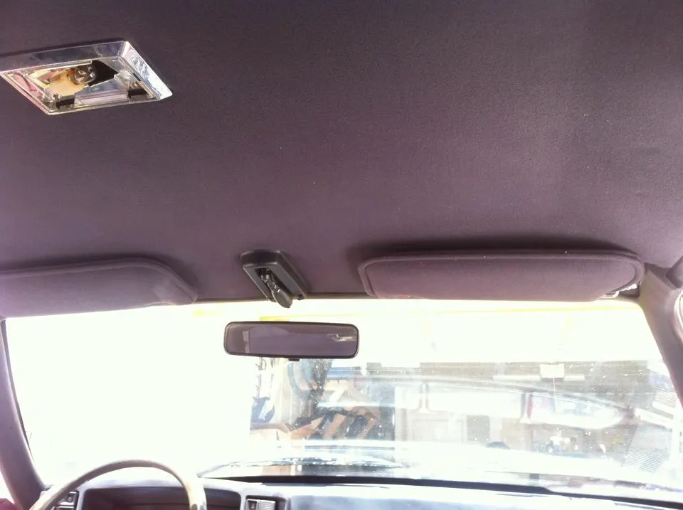

I am still working on the headliner... Who knew it would be so hard... I also ran out of black paint. Note it takes more than 4 cans of black laquer. I am betting I will be sitting around 6-6.5 total to finish it. I ordered 4 more so I will have had a total of 8. This way I have some left over for the occasional scratch in the paint...

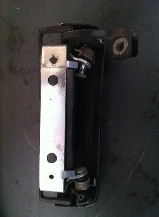

Here we go... I am at a standstill until I get more paint, and then my drivers door handle and lock actuator. The handle is broken and will not open the door!
Anyway... Headliner installed with almost all of the roof pieces, some need taken back down and painted still, but not a problem.
Relaxing and enjoying the new view of the blackness!

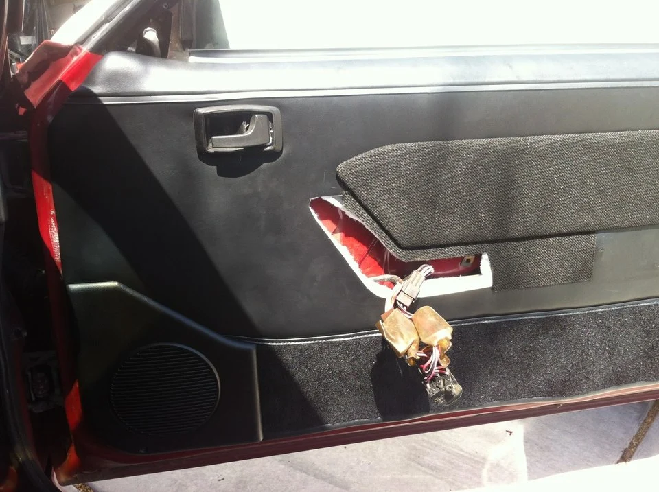

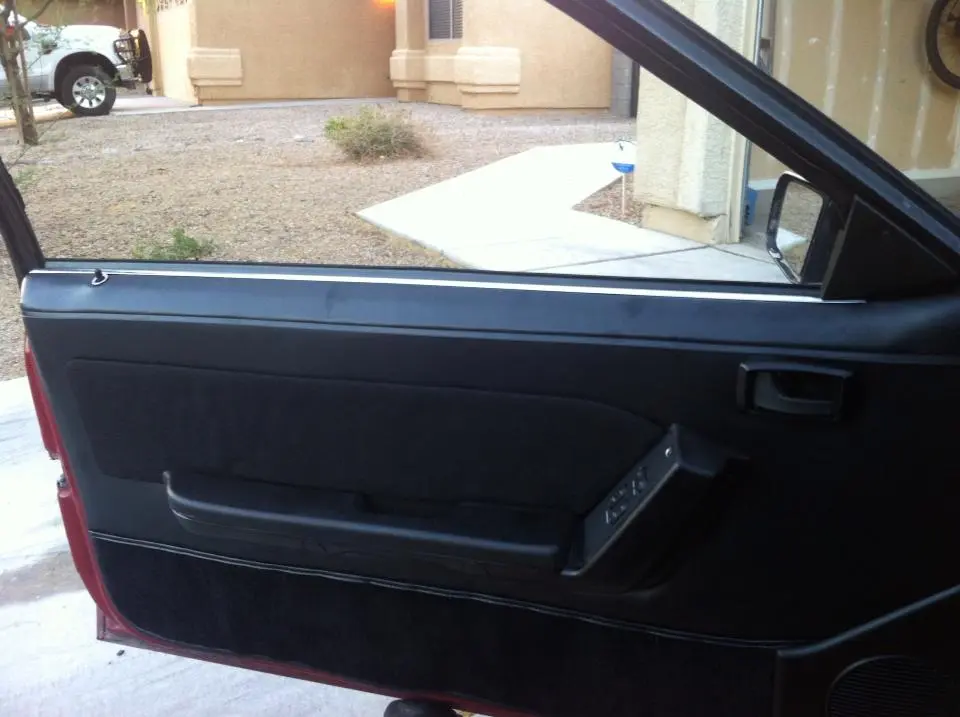

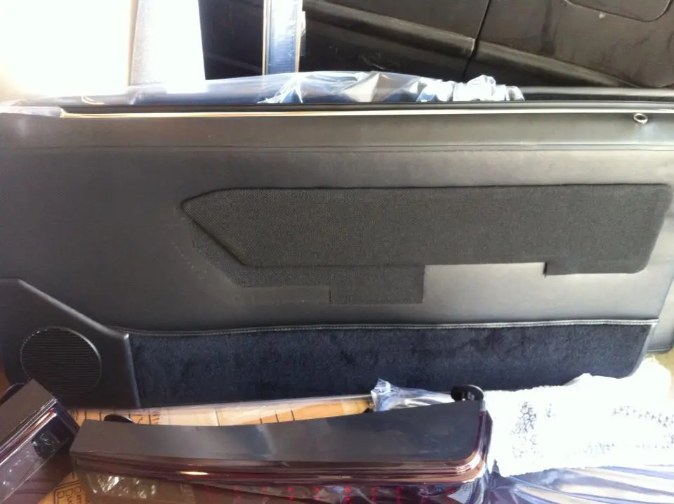

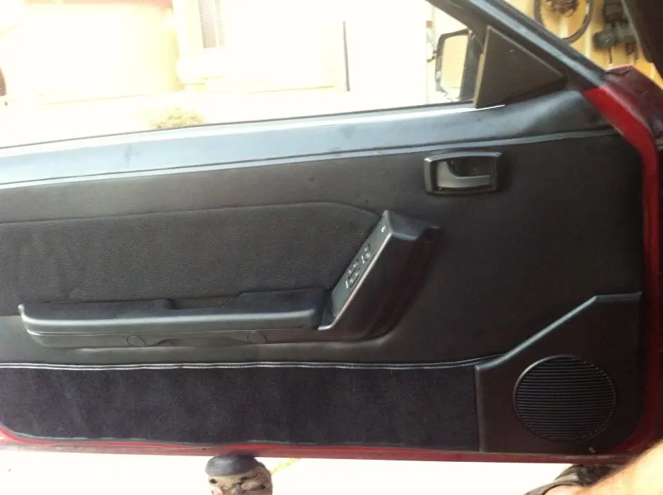

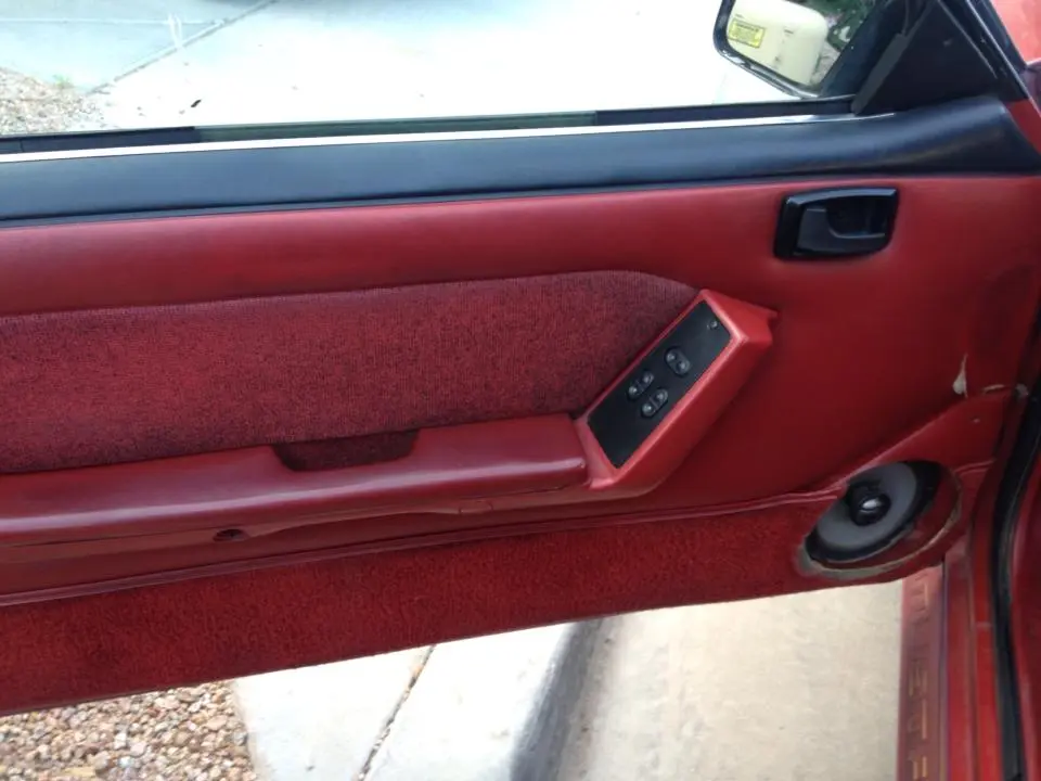

Door panel. Word to the wise.. They come solid and you have to do the cutting. The only part that is difficult it the door handle.. it looks horrible to me because I can see the white stuffing.. and I cut a little too far because the hole in the plastic backing is an inch bigger then needed...

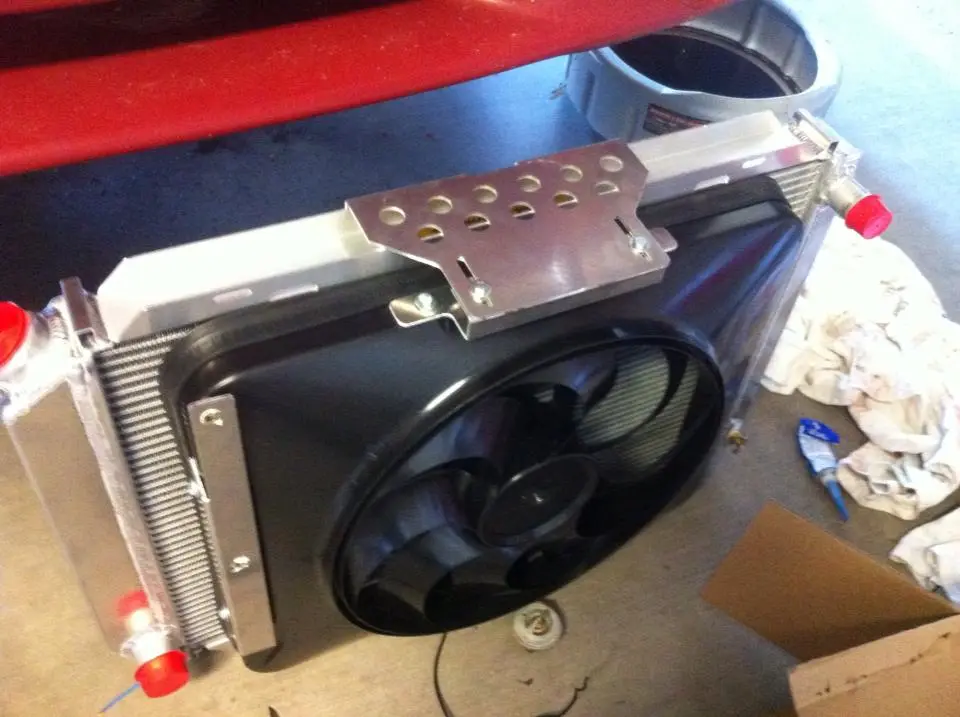

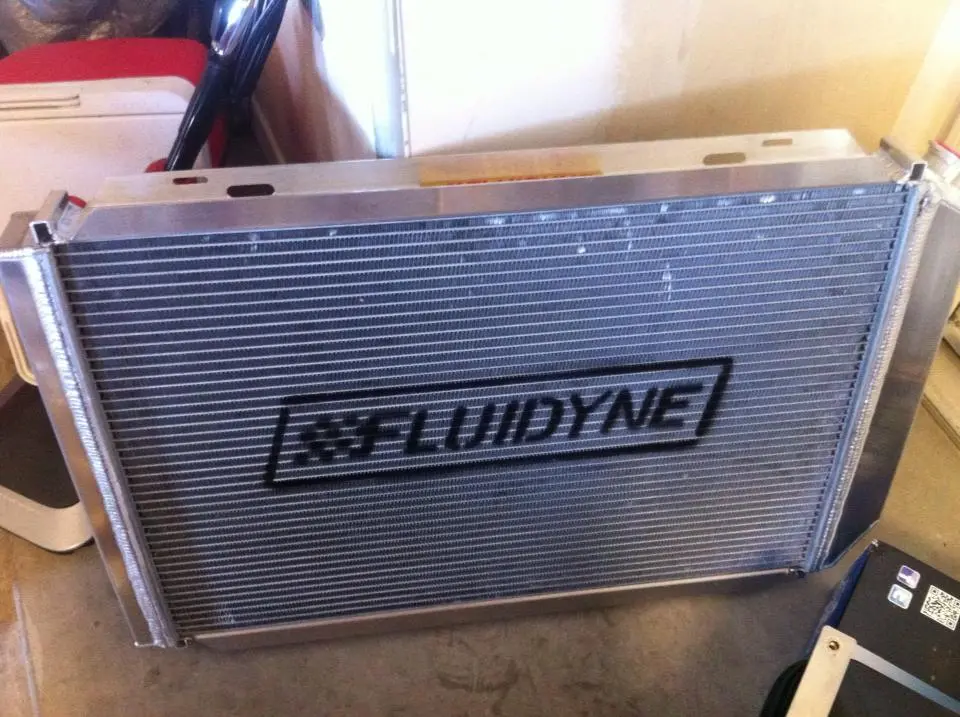

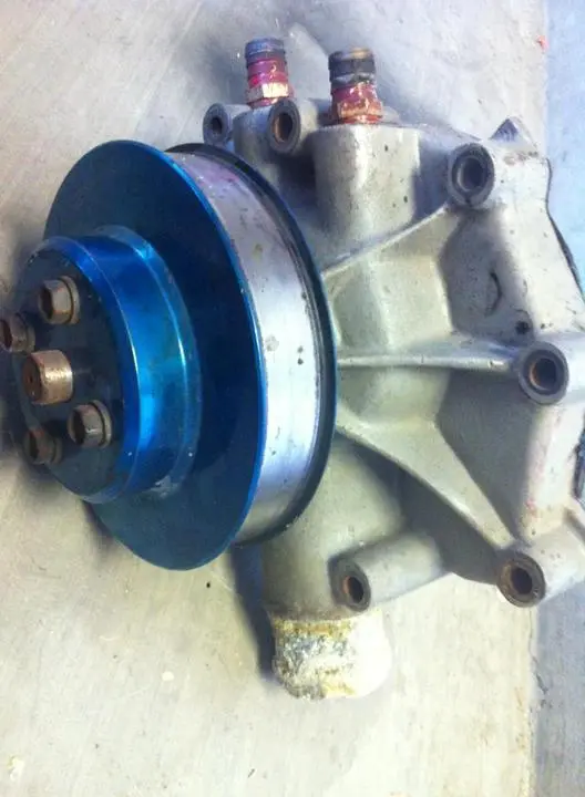

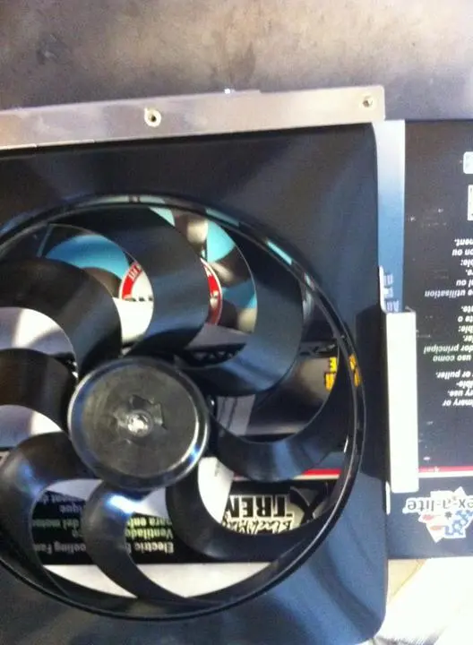

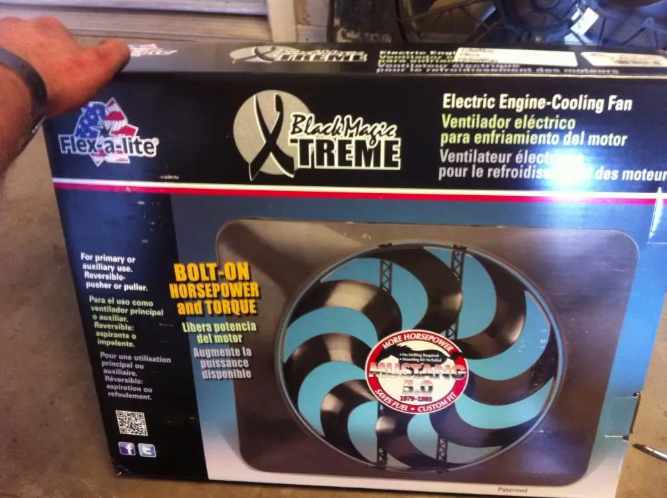

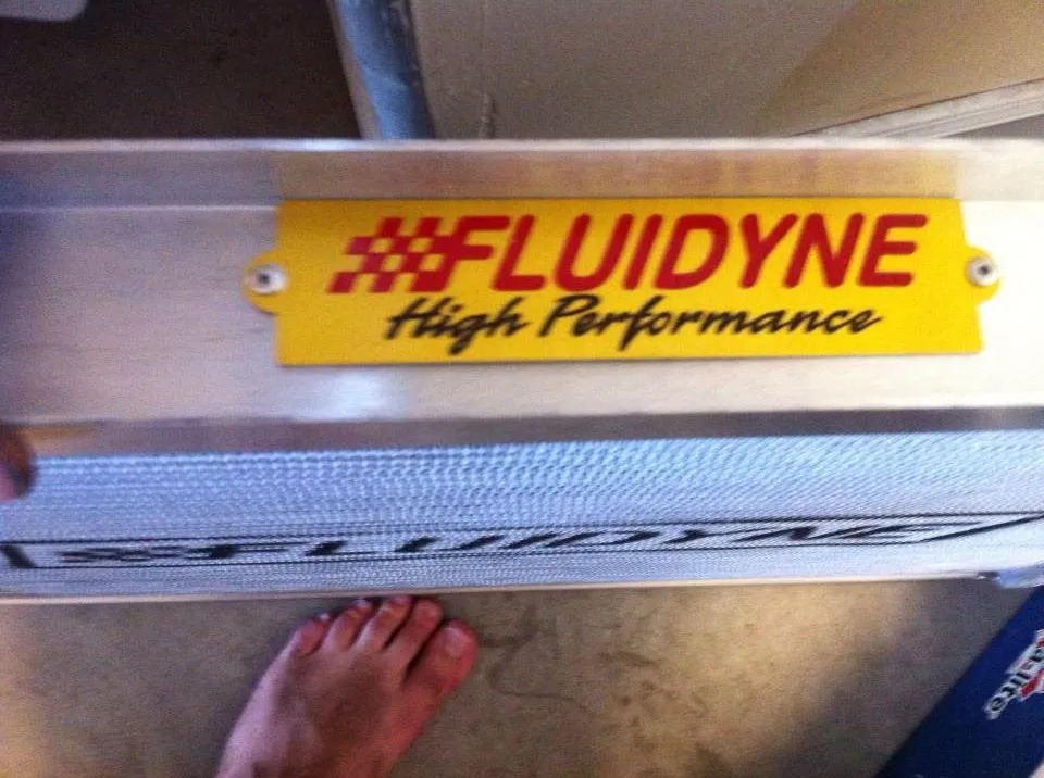

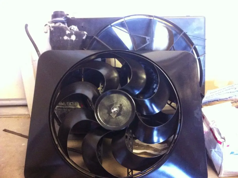

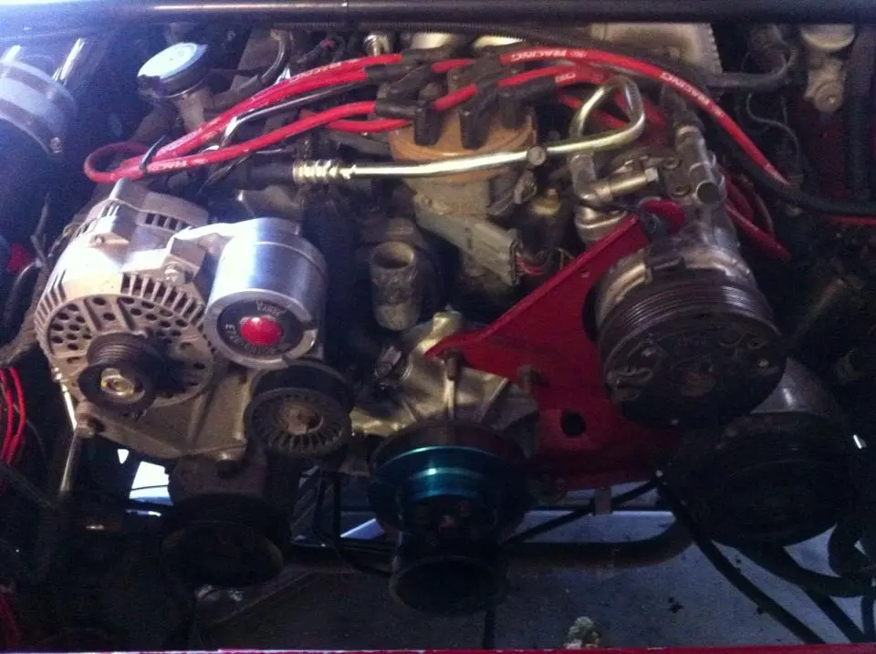

Just purchased Edelbrock High Flow Water Pump, all gaskets, 180 thermostat, Fluidyne 3 core radiator, and Flexilite Extreme Black Magic fan... 3300 CFM of breeze to keep my pony cool i hope...

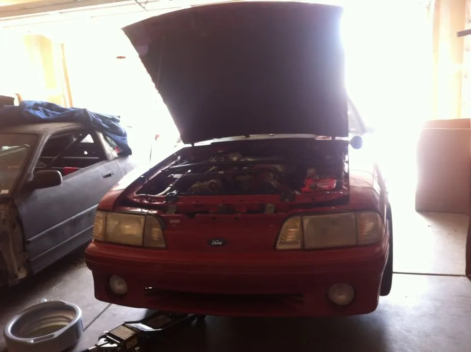

Well I got started when they all arrived! Lots of boxes!
Pulled the Box within a box out... Looking good!
Got her all jacked up and ready!

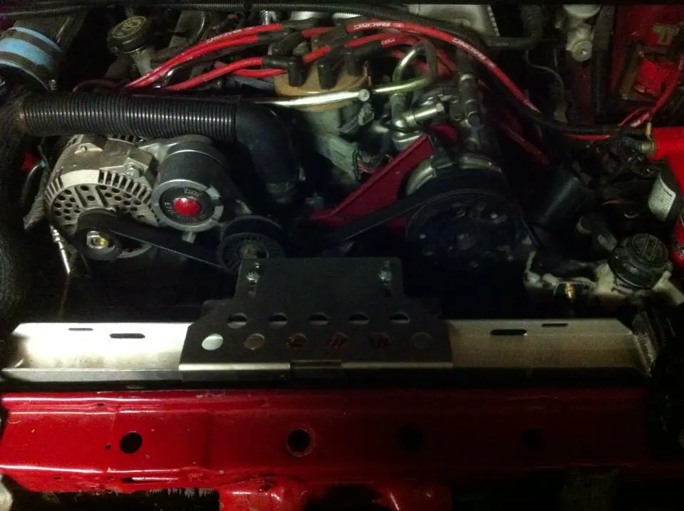

Pulled the fan and radiator...

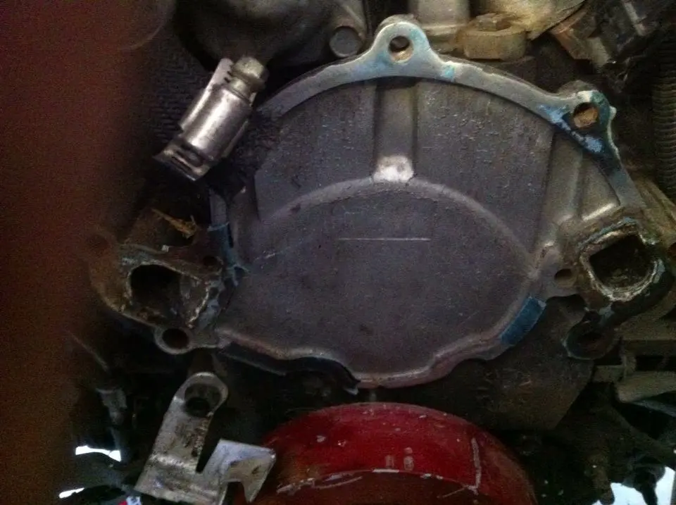

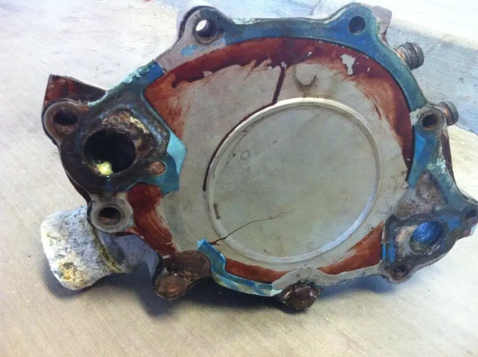

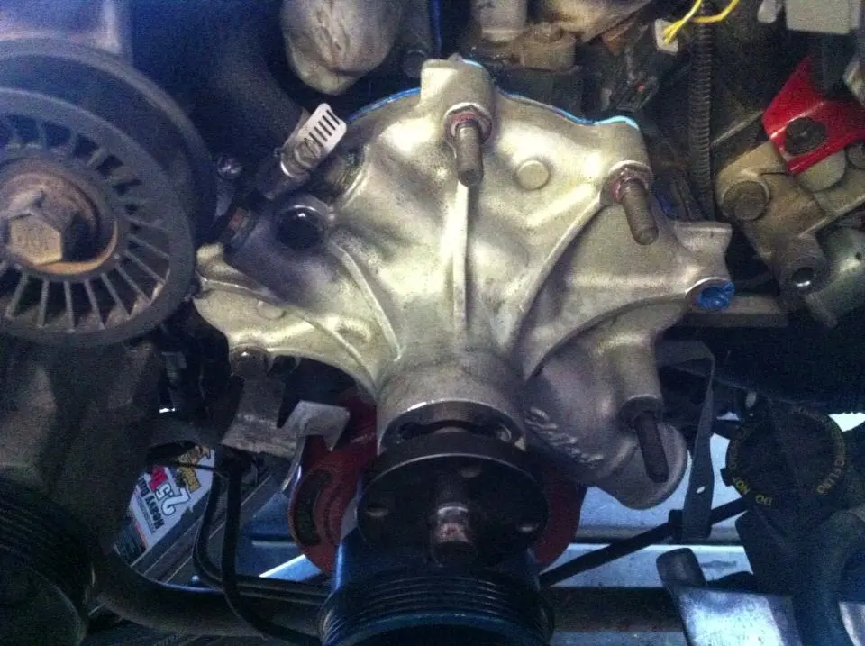

Old pump...
Engine shot where the pump goes... I see missing gasket...
New Edelbrock high Volume Water Pump installed!
Flex i Lite Black Magic Extreme Fan Compared to old fan... Not sure what the old one was...
Shiny Aluminun Brackets installed
Fluidyne Radiator! Super sexy!
Fan Installed on radiator. Fantastic fit!
Unit Installed! I have even more clearance than before! Runs super fantastic! I had a hole in my lower hose so I replaced it with a Gates Hose and it should be good now! No leaks!
I stay at this temperature or a tad lower while beating the snot out of the car, with the AC on full blast in 90+ degree heat! I also just parked it, left it running, and idled it for 20 + minutes and it still didnt move. That fan moves a super serious amount of air...
I even found a buddy to park next to!
So the results are in... This setup is off the hook. I highly recommend it to everyone!

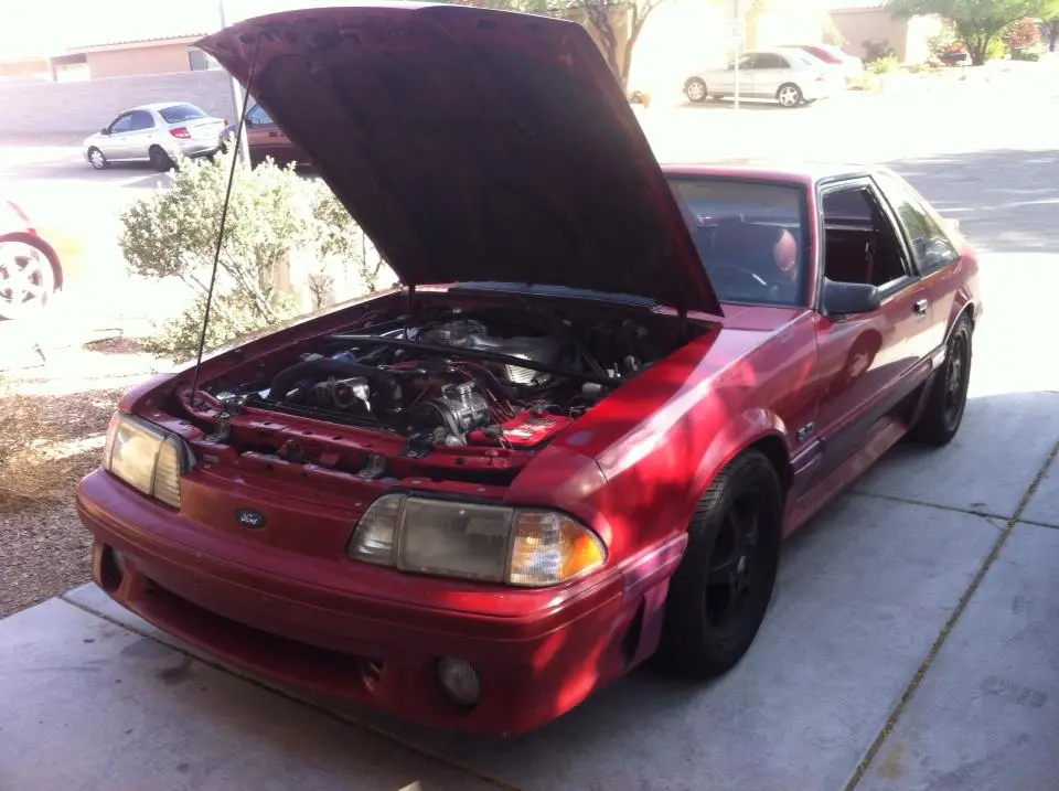

I have a metric crap ton of work to do on the car right now though and sadly I dont think I will have it running in time to go to the October Mustang Meet at my local drag strip View attachment 123746
Things to do:
Remove SMOG
Remove Pass Header
Weld flange back on to pass header at the H pipe connection
re install pass header
make sure all smog deletion is A ok and car still runs
unpack and sort boosting stuff View attachment 123747 Not telling yet..
install boosting stuff...
find a drivers seat...-sold my front seats to buy racing seats...I got the brackets and then came upon a killer deal for my boost and couldnt resist...Also bought a welder so i am limited on funds for a seat View attachment 123748
go get car tuned!!!!!!!!!!!!! another $500 i dont have yet

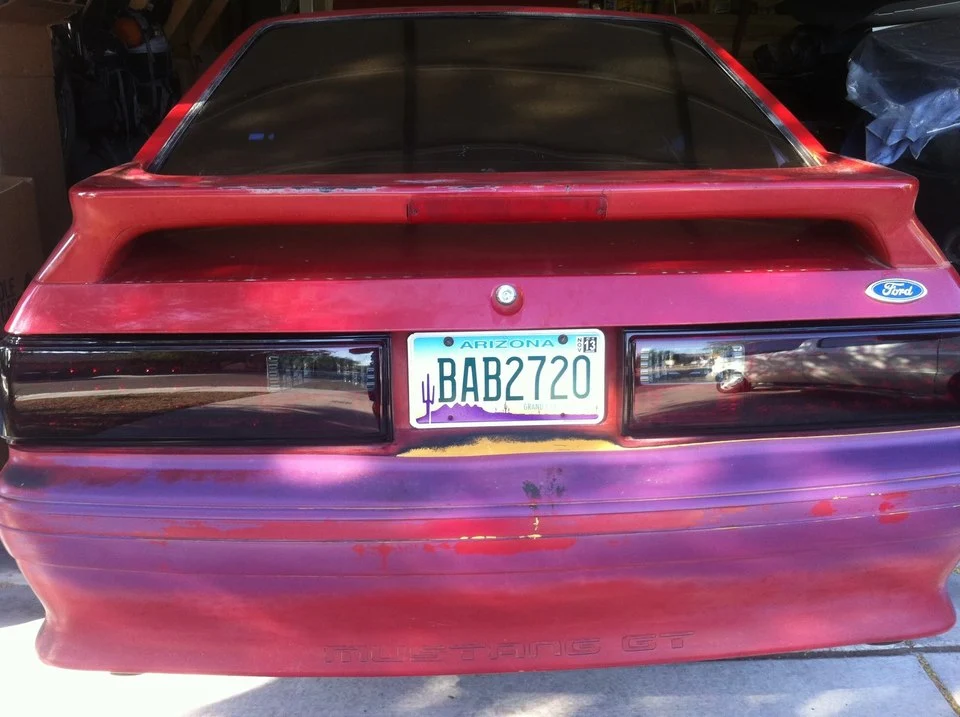

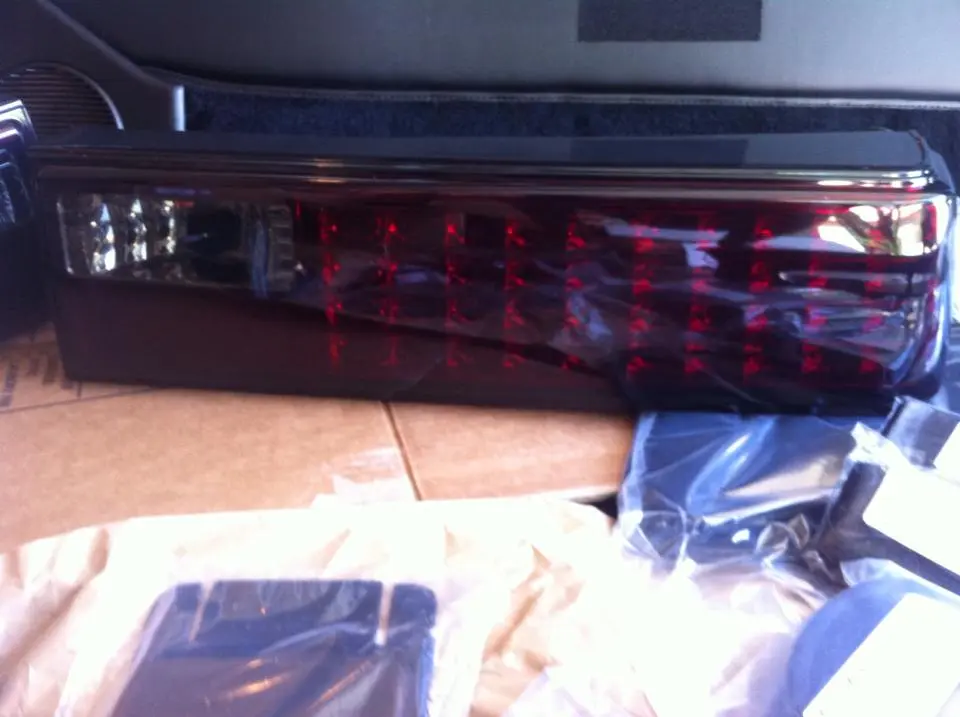

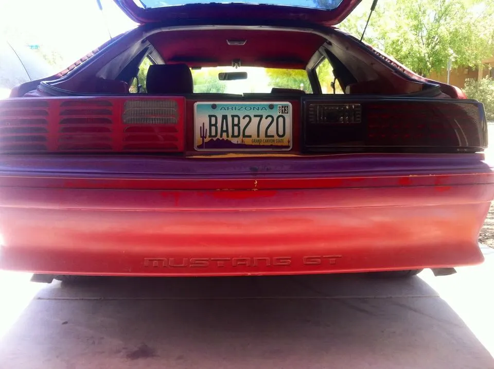

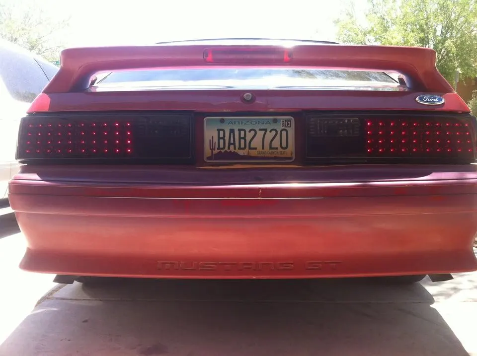

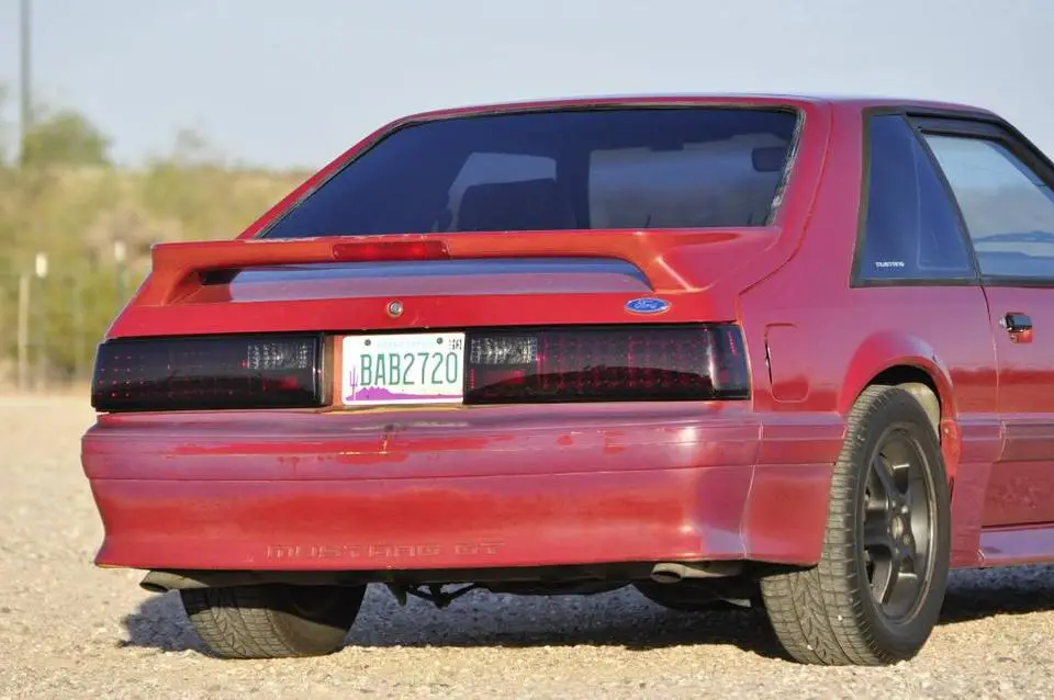

That's a lot of stuff, good for you guy. I also was wondering about the curb, first thing i thought when i seen that pick. Im soooooo diggin' those rear tail lights, lookin smooth. How long for that install btw and what the style/color code for them, smoke, black etc???
