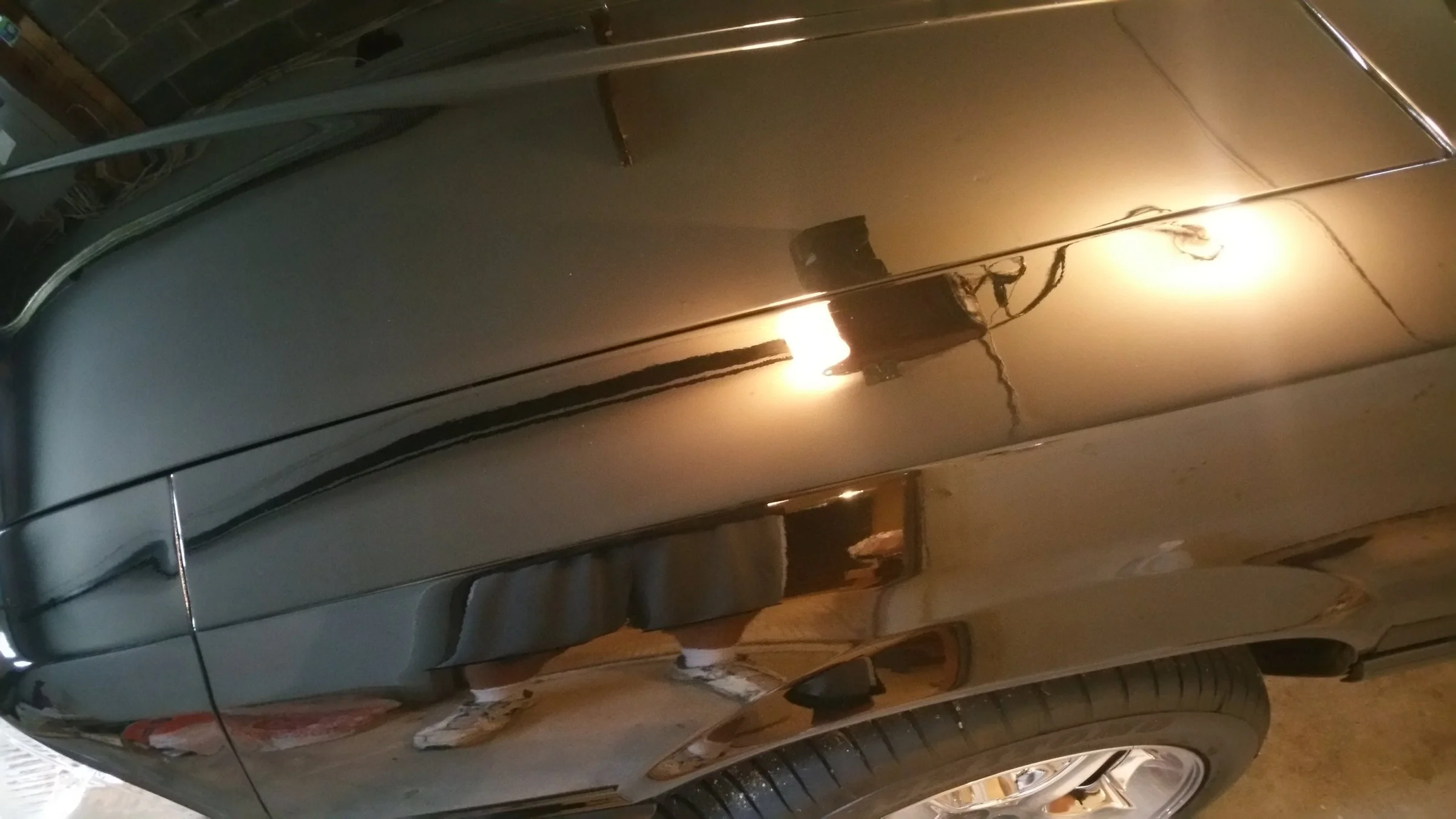

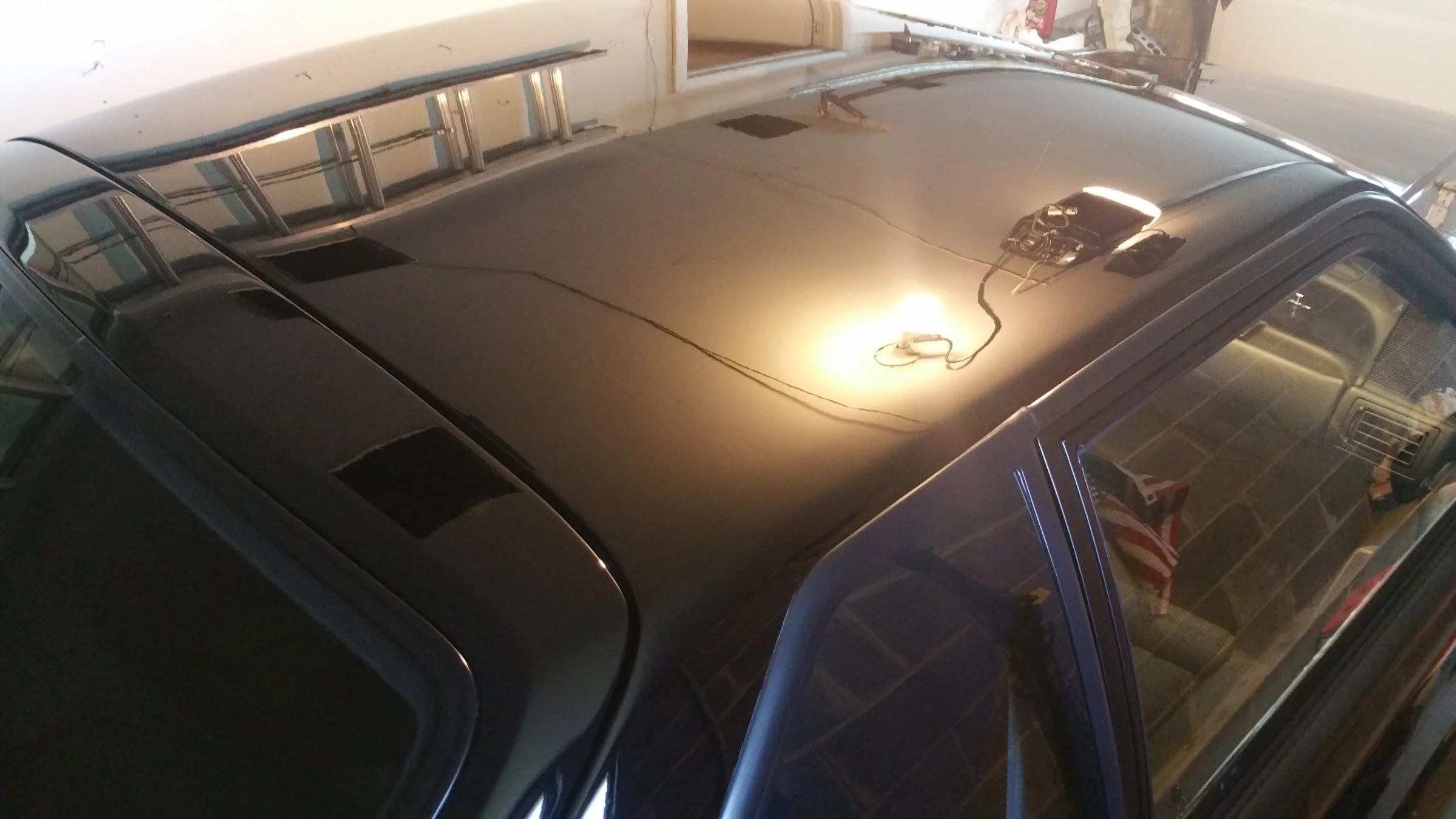

Black paint, the struggle is real !!! Now I don't wanna take it outside. On a more serious note I've decided I'm gonna purchase a Eibach pro line kit and some new struts since it'll be apart, I am curious for thoughts on this, bad , good kit ? Who has just cut coils ? At this time I'm really just interested in dropping the front down but figured I'd just get the kit if I change my mind. I am also concerned about the 9" front wheels with 245 tires possibly rubbing the crap out of the fender, maybe I need to replace them with 8"
very nice Joe. Black paint is a PITA to get all tthe swirl and scratches out of for sure. I would not recommend the sportline kit as IMO they ride like crap and lower the car about 2". I prefer the H&R or Steeda springs. If you do want Eibah, I like the drag springs better.

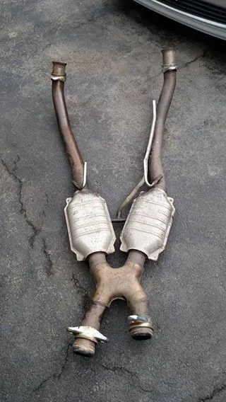

Seriously though if you are looking for a catted x-pipe I have one for shorty headers. I just switched over to the pro chamber. The friend I bought it off of said it was a Bassani but I don't see Bassani anywhere on there, nevertheless it's a well built pipe.
Reactions: Jersey Joe
I'll give it awhile longer before I decide to take it off, but you'll be the first to know.
