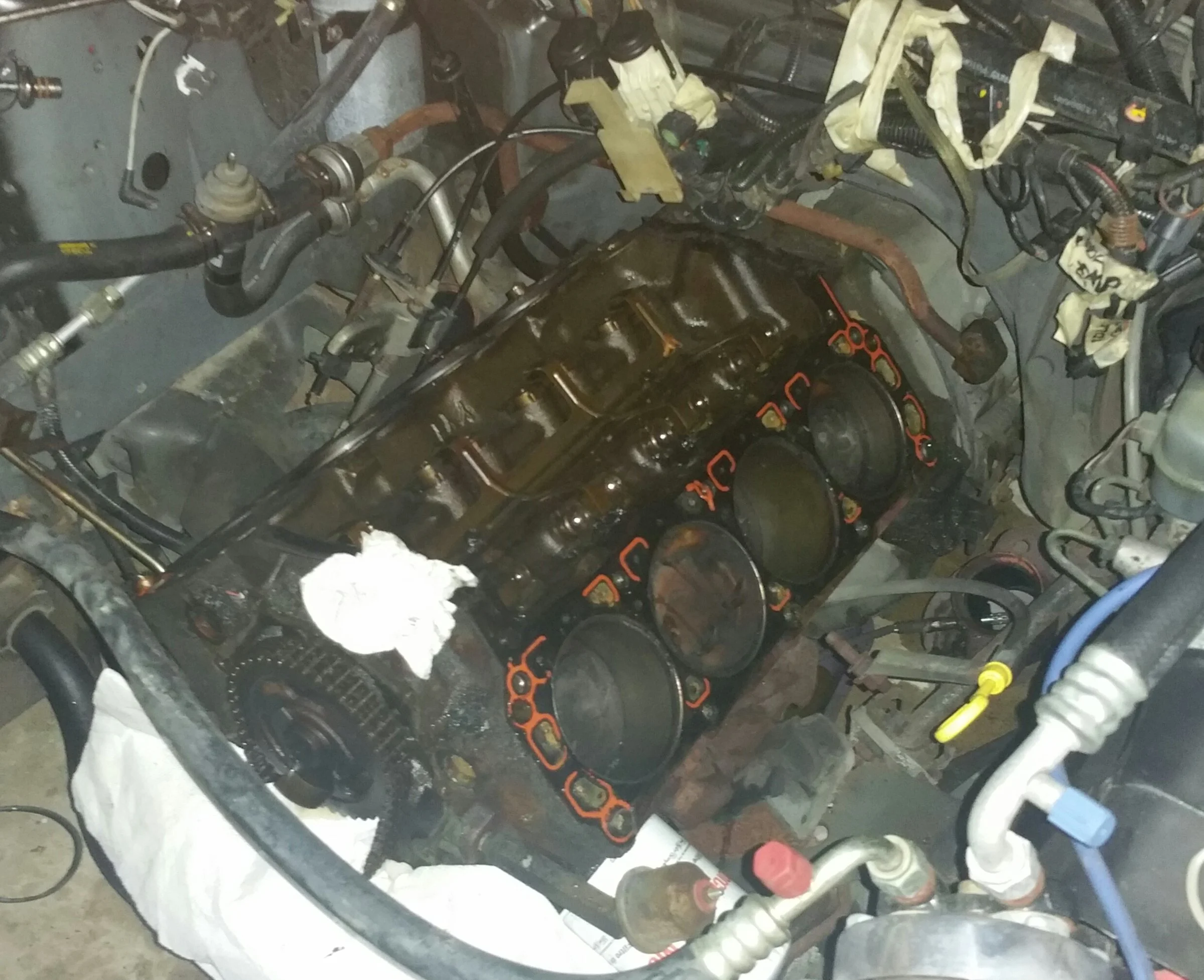

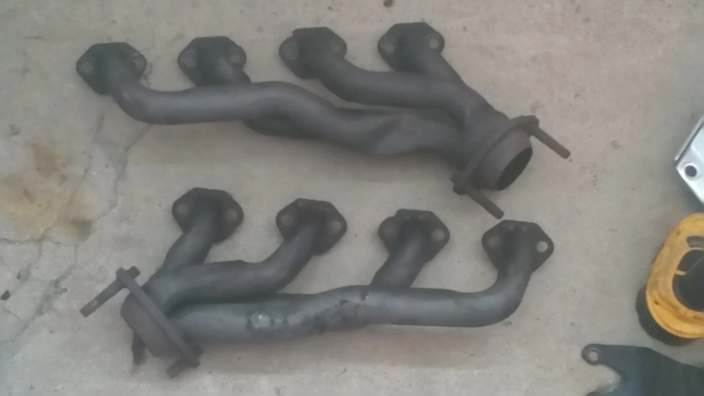

After a broken socket extension and a collector stud that finally broke, the damn things came off. This is where working in a single car garage, on the floor with a jack and jack stands is friggin torture. I hate you guys with lifts......
Wait you have a garage......:oops:, I have a sand pit with a metal plate I have to slide to jack on, which is sketchy at best. What headers did you get?
Alright alright, you win, I guess no matter how bad it seems it could be worse..haha. I purchased the ceramic coated BBK unequal shorties. I know long tube have an advantage but I'm not willing to make them fit ( maybe 20 years ago) it's not a track car its just for kicks.

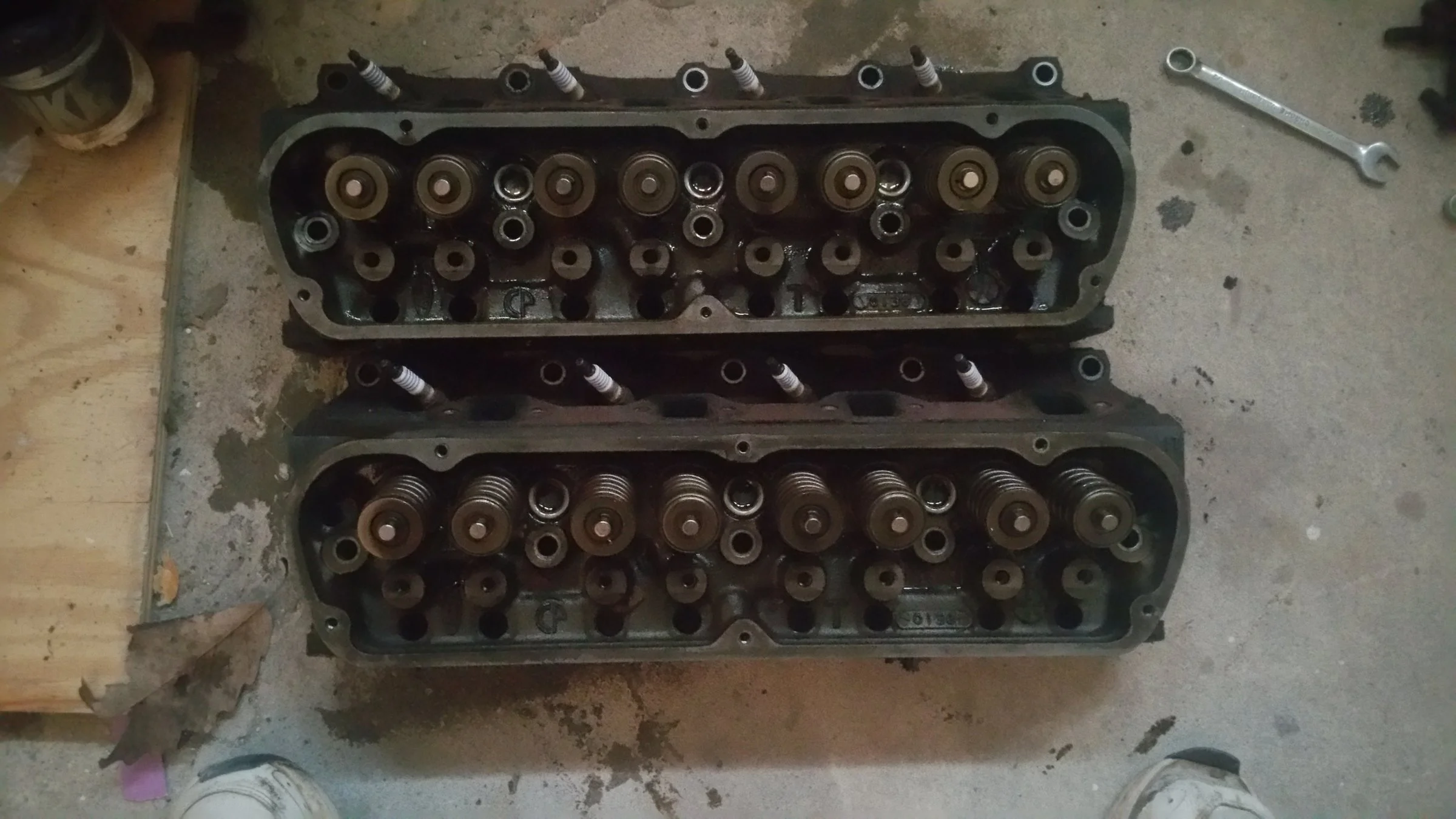

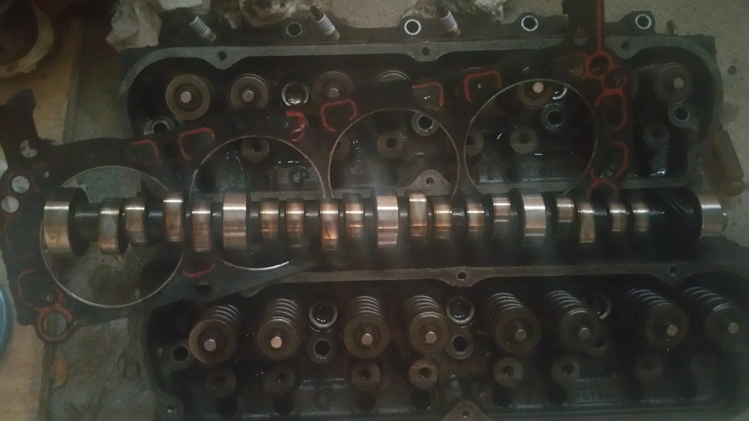

Managed to wrestle off these friggin hernia makers, smog tube bolts were a pain in the ass , every head bolt came out without a problem except one, the stud holding the fuel line bracket at the front bottom of passenger side felt like it was gonna snap, so I hosed it down with PB Blaster a few times while I turned it , then stop and hose it down again and then got it out.
You might be able to get a few bucks for the cam fwiw
My buddy wants the valve covers for his 97 5.0 explorer ( they were polished up awhile back and still look decent), I found that kinda funny that parts from a mustang were heading ovet to an explorer and not the other way around.
