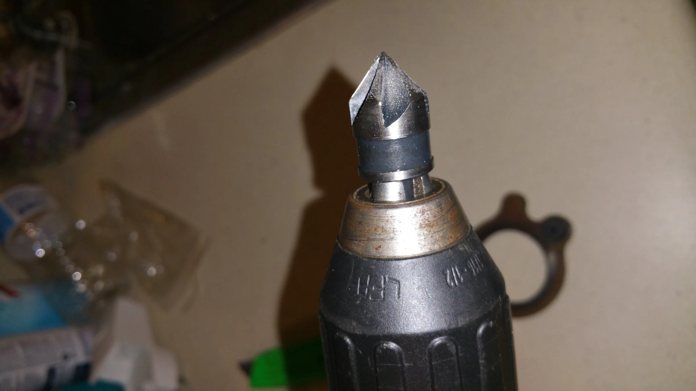

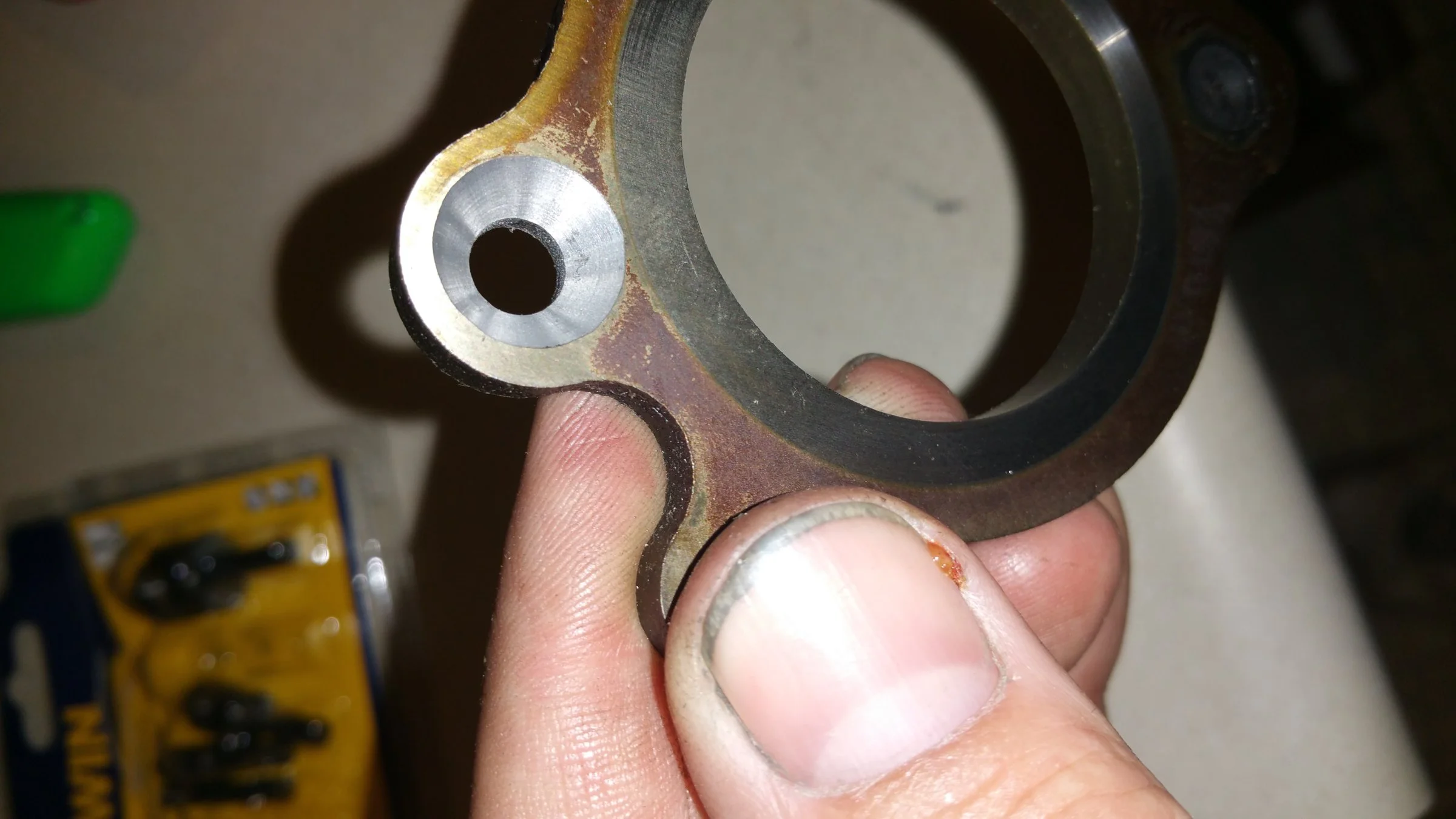

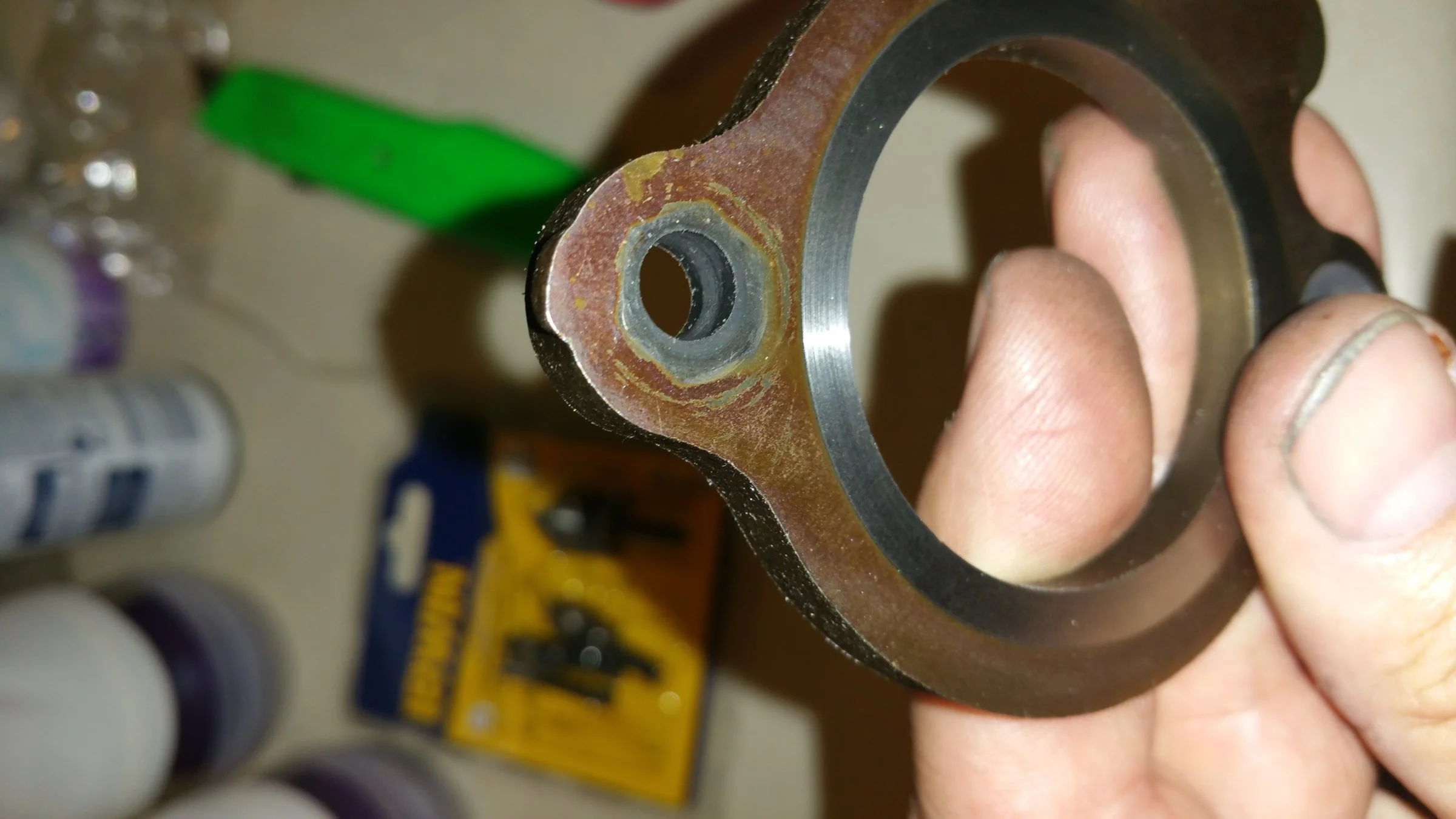

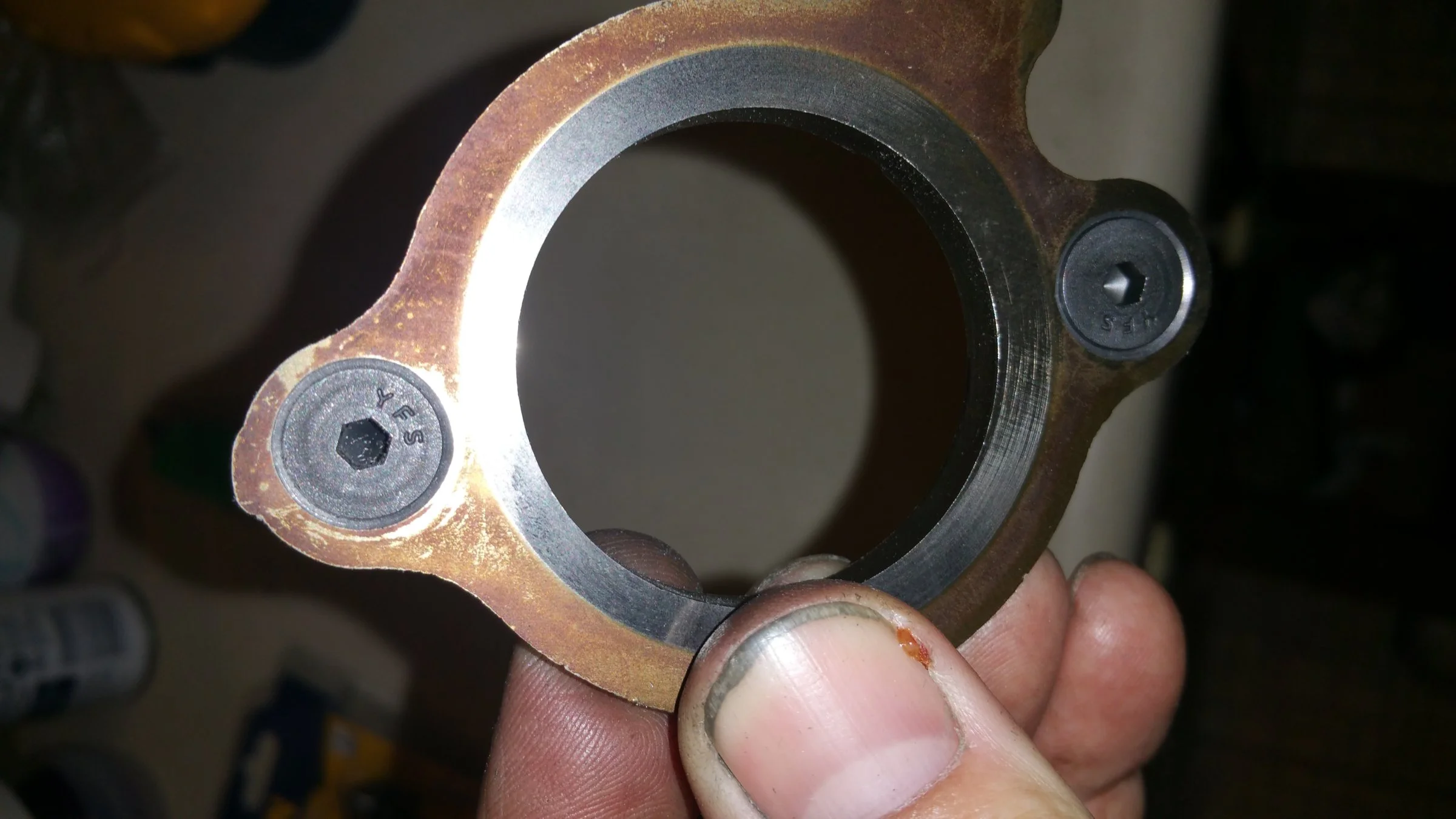

I kinda knew you had to do something weird about the cam retainer with the timing set that comes with the kit, but it sorta slipped my mind till I had to deal with it. You have to counter sink the supplied bolts into the retainer to clear the cam gear, other than needing to run out to Lowes and get a countersink it wasn't that bad.

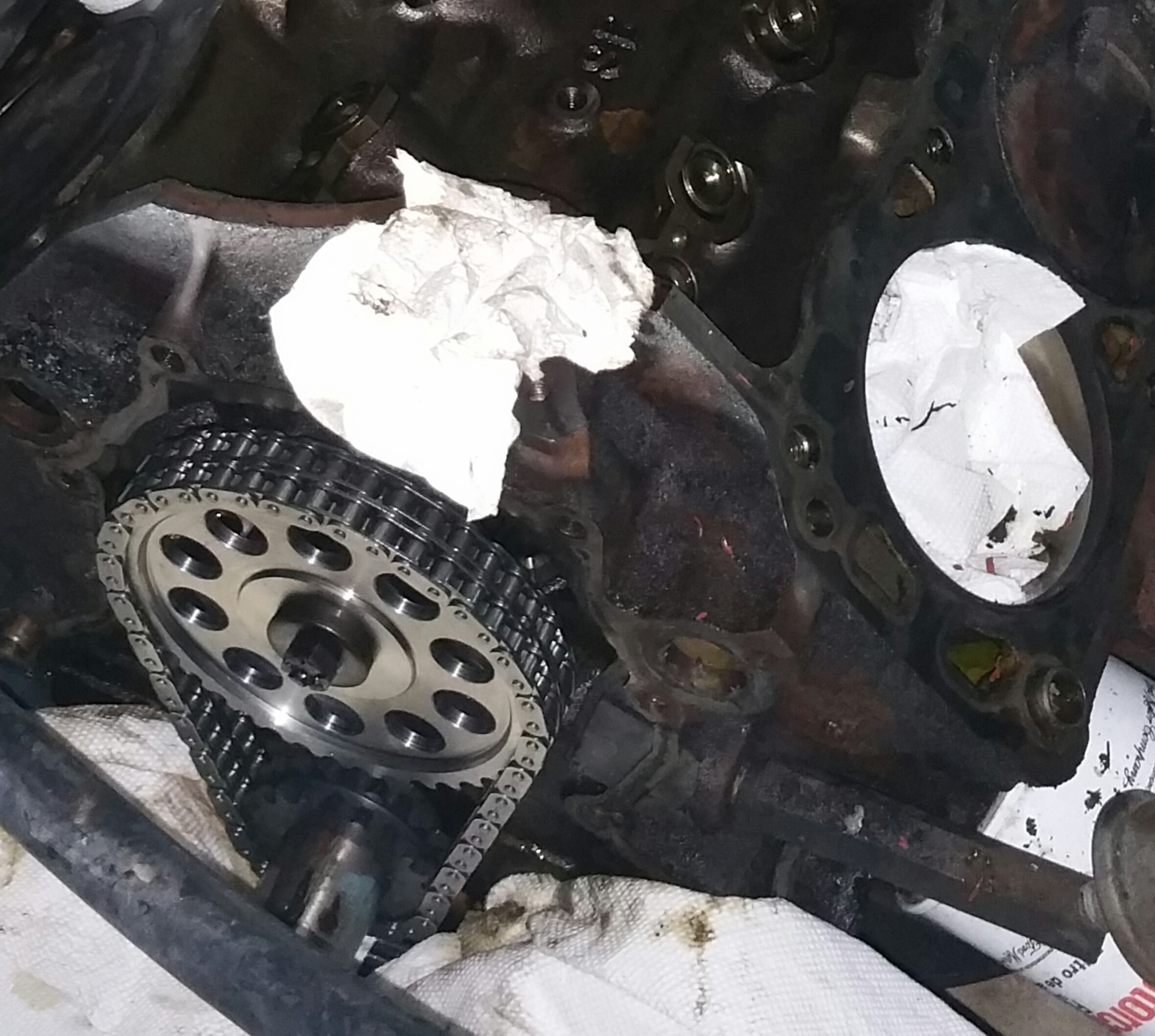

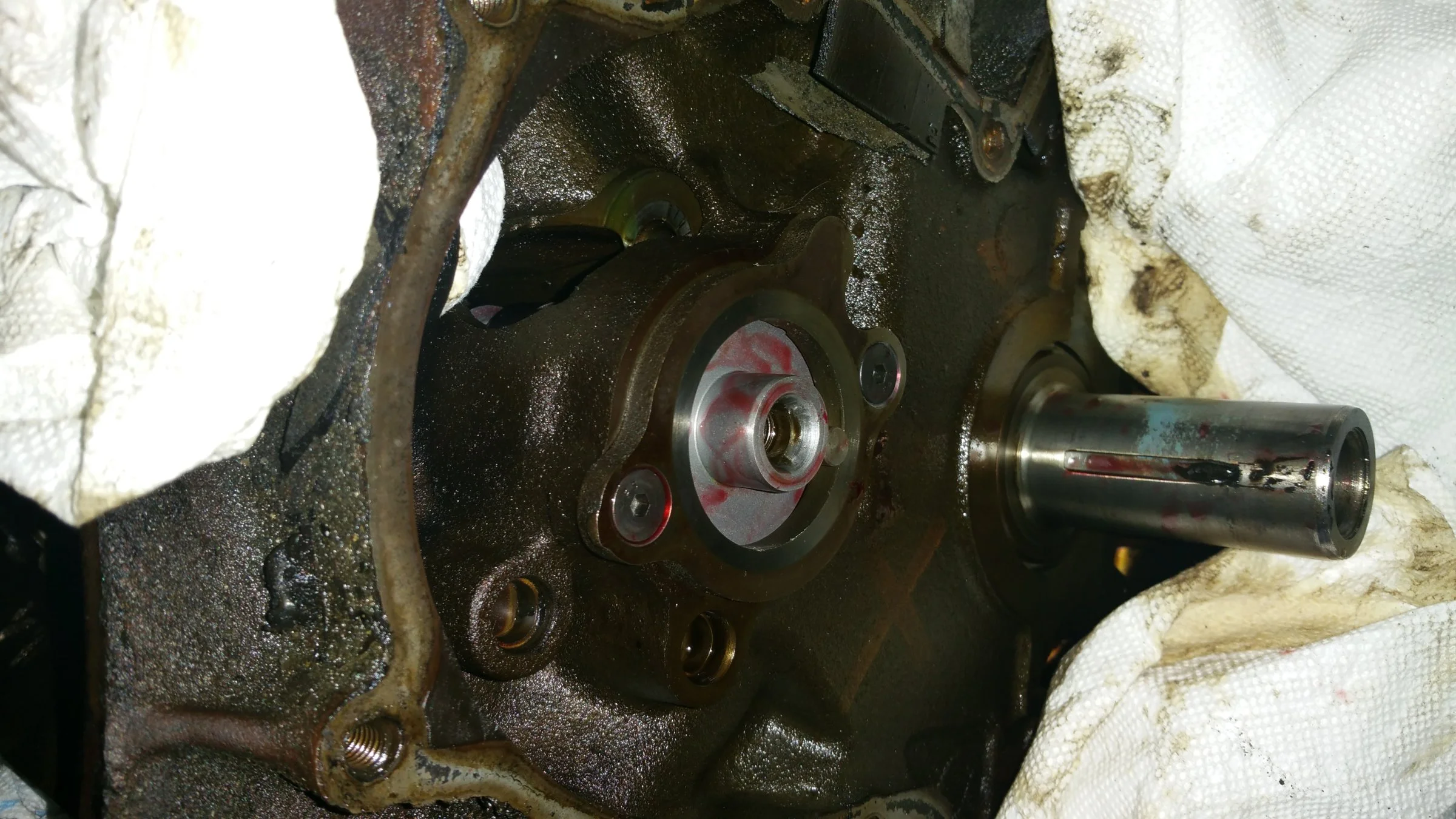

So glad I'm finally putting parts on, timing set went on without any issues.
Don't forget to loctite the bolt... I forgot then had to pull my timing cover back off and apply the loctite when I did it.
Luckily the instructions reminded me to use some red loctite on the retainer bolts or I definitely would of missed that.

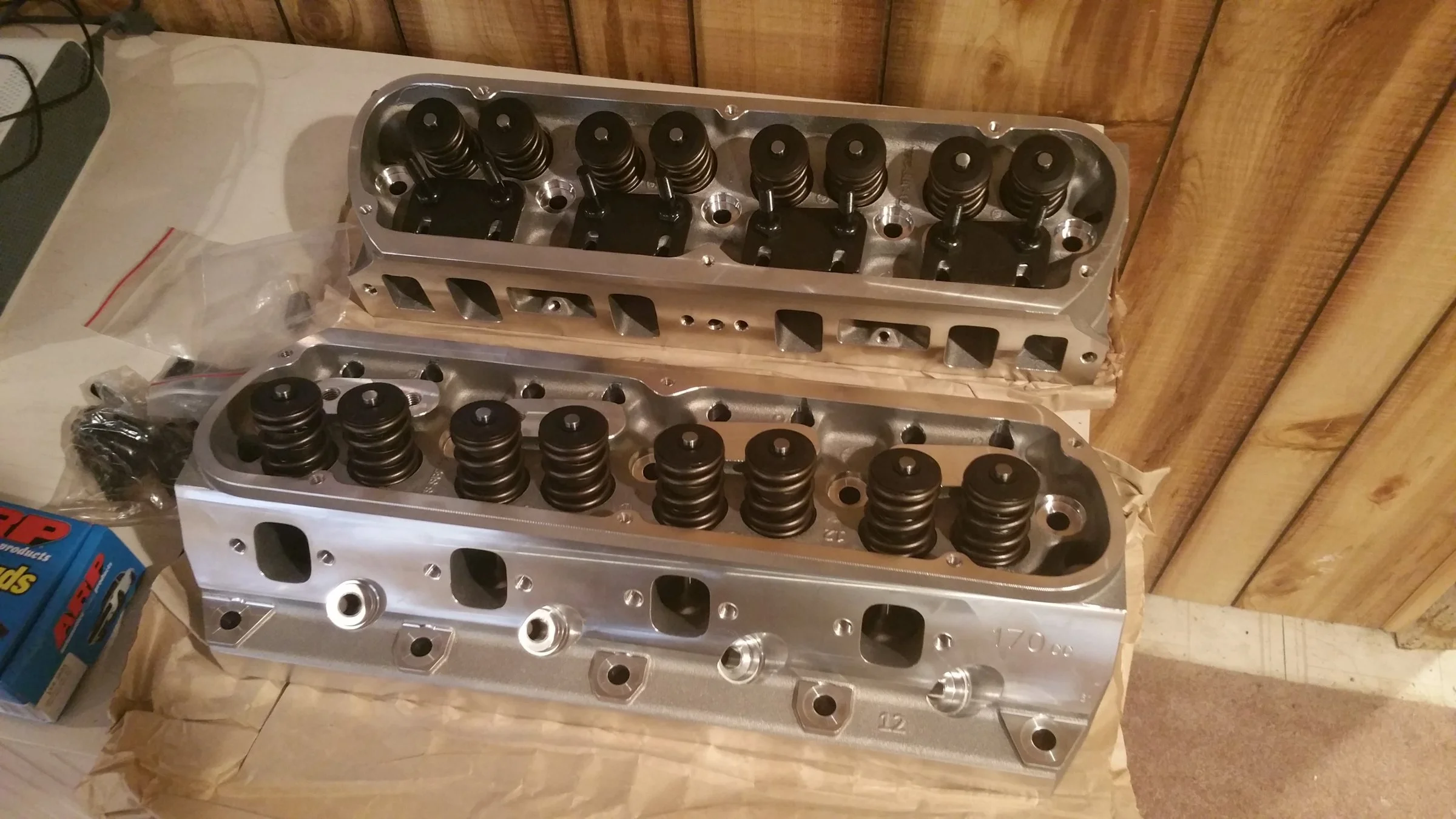

I need to install push rod guides and thermactor plugs for the front of the heads for the accessories, I'm frustrated with my lack of knowledge and what is available on the Internet about this, loctite? thread sealer ? What is best for these pieces ? When i reinstall the heads do i need to use anything for the hook up of the cross over tube ? Also I've read way too much about head bolts, thread sealer, thread lube, motor oil, a combination of both, which is it ?? Normally I put stuff together with experience, trial and error. I'm not interested in doing this twice, I would love to hear opinions on this. Thanks.
Reactions: Davedacarpainter
Head bolts bet assembly lube under the bolt heads and washers. and on the threads of the smaller bolts that do not go into the water jackets. The longer bolts that go into the water jackets get asembly lube on the bolt heads, washers and then pipe sealer on the threads. Torque them in 3 stages per the installation sheet, 30, 60, then the top at 70. the pushrod guide plate bolts get RTV or pipe sealer so they don't leak. All metal parts that touch- rocker arms, pushrods, valve stems should get a dab of moly lube. Put a dab of Right Stuff in the corner of the HG where it meets the china rails Make sure the head dowels are in place. HG go on DRY and make sure to install them with the front to the front and up. If you are not ruunning the thermactor tube, use 5.8" short plugs with teflon on the threads. If you are reinstalling the thermactor tube put some antisieze on the threads.
Short bolts go in water and get sealer, long bolts just get lubed. Rocker studs get torqued with lube (I don't think they protrude into the runners on the 170s). I'd use red loctite on any threaded plugs/reducers on the front/back of the heads. Antisieze on any other non-lubed fastener, especially stainless.
For bolt lube, if you're using arp bolts like you should, they usually come with a small packet of moly lube. If not, I think they usually say to add about another 10 ft-lb using motor oil vs the moly.
Before you put the valve covers on, squirt some of whatever oil you're going to use over the rockers and springs.
I do have the ARP bolts which did come with fastener assembly lube, I also purchased from LMR the ARP thread sealer anticipating I would need it. So I think I got the gist of this, a combination of assembly lube and thread sealer on the smaller bolts that pass through water jackets, just assembly lube on the longer bolts, there were two different opinions on that so I'm guessing here. lube or thread sealer on the rocker studs ? Teflon tape or loctite on the thermactor ? Anti seize on the cross over smog tubes ?
Long bolts are blind (don't go thru water jacket) and don't need sealer. Short ones do, as you probably saw when coolant probably started pouring out of them when you were pulling the old heads off.
