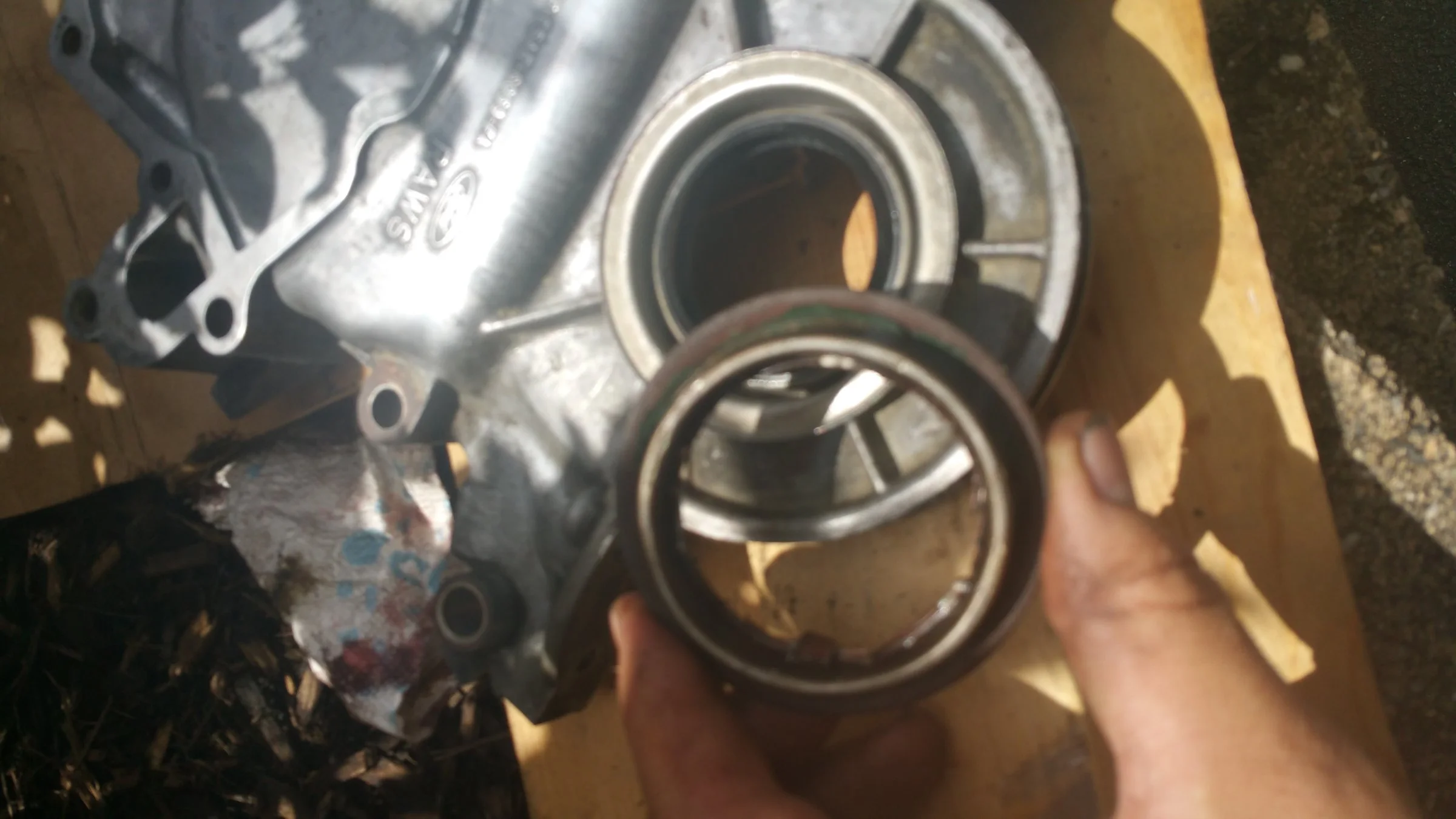

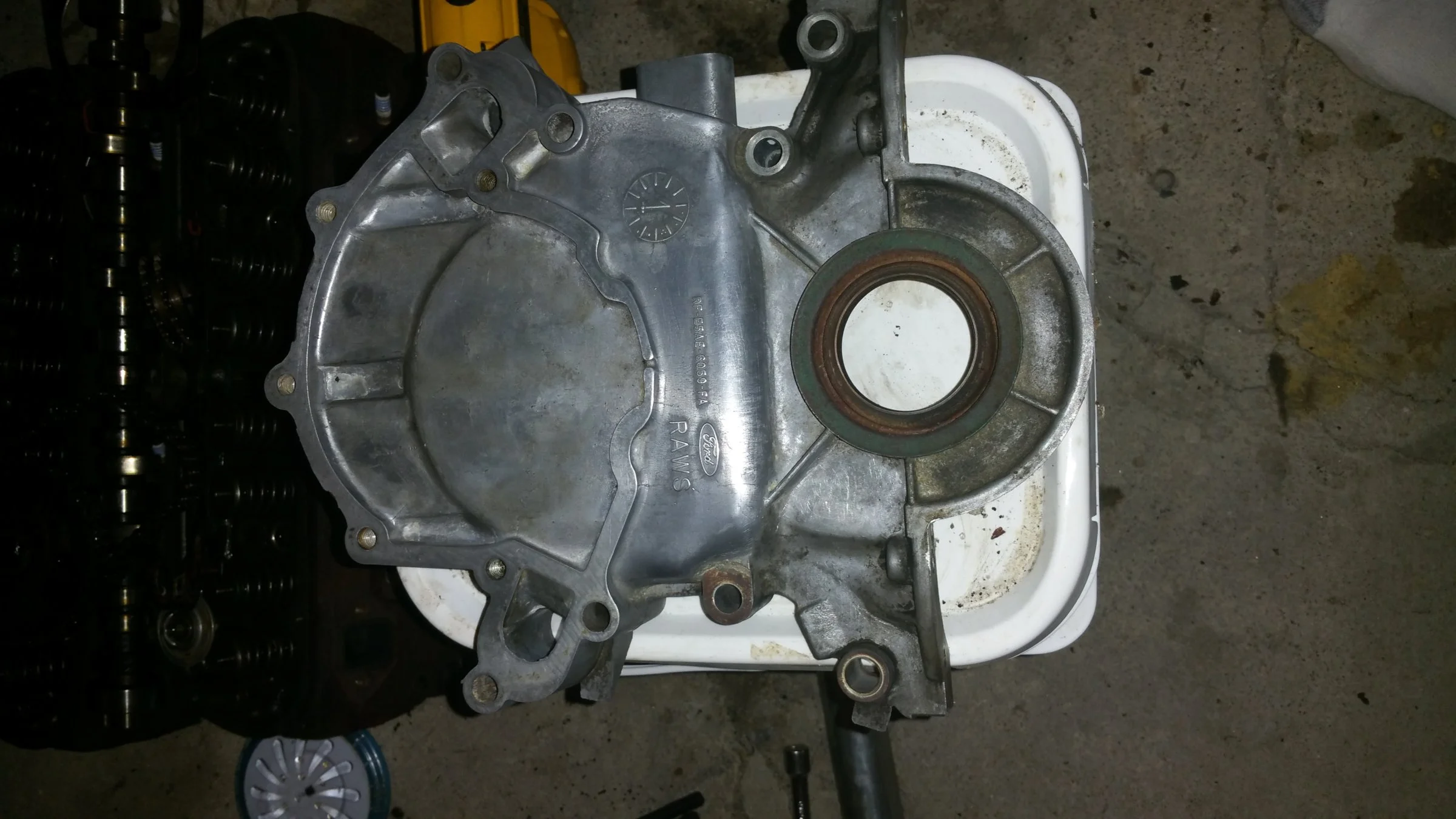

Knocking the old seal out of it is actually pretty easy, inserting the new one busted my balls all morning, I didn't really have a socket that was big enough at home, so I had to improvise after trying a few different things and failing. I ended taking the old seal and using that to beat it in, which worked really well. I just wish I thought of it sooner. Doh !!!!
Harbor freight has a real neat seal/race driver kit dirt cheap. Comes in handy all over, I used it on the rear end of my truck as well.

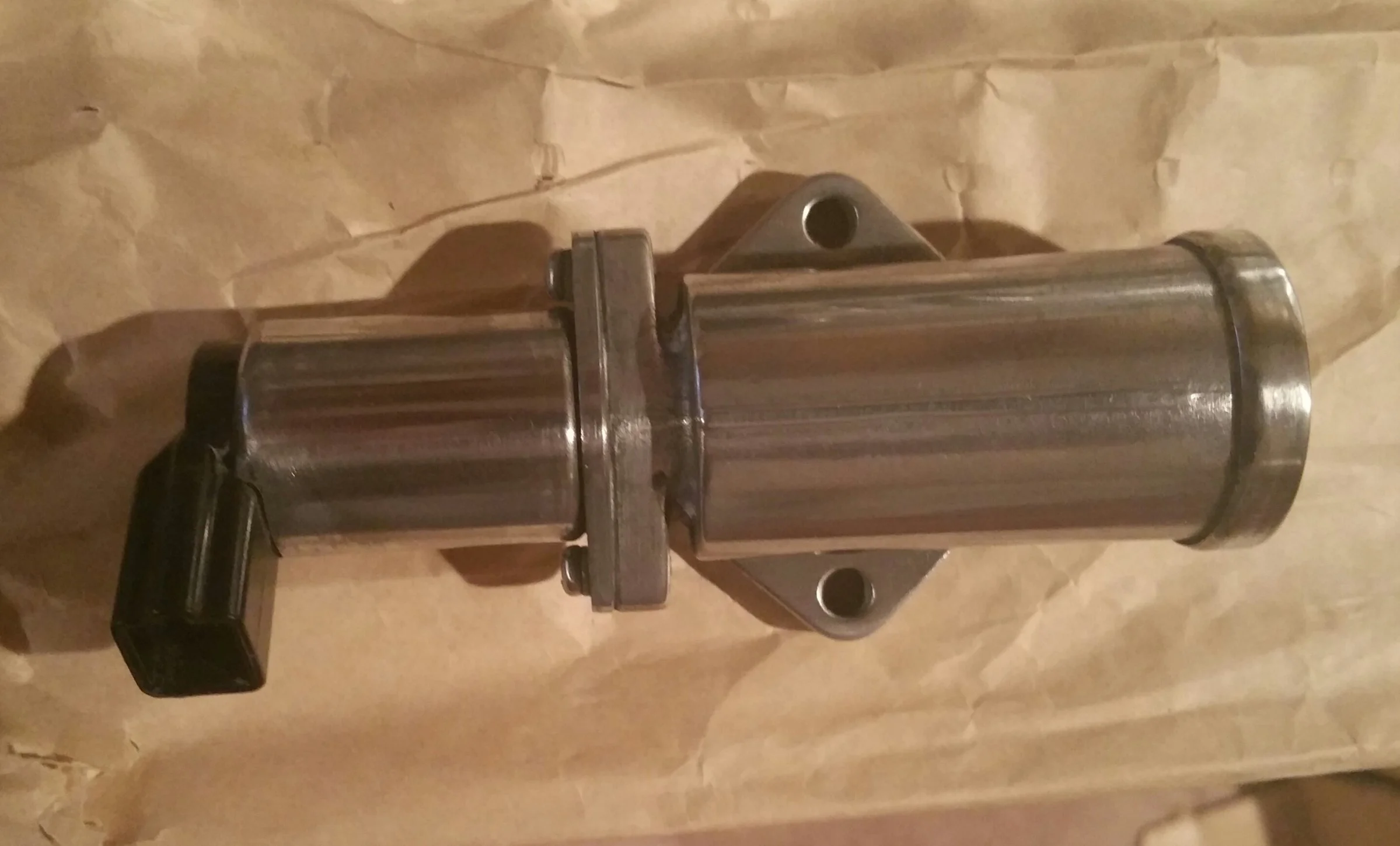

Some emery cloth, steel wool and metal polish, I think they came out pretty well for zero dollars and cents.

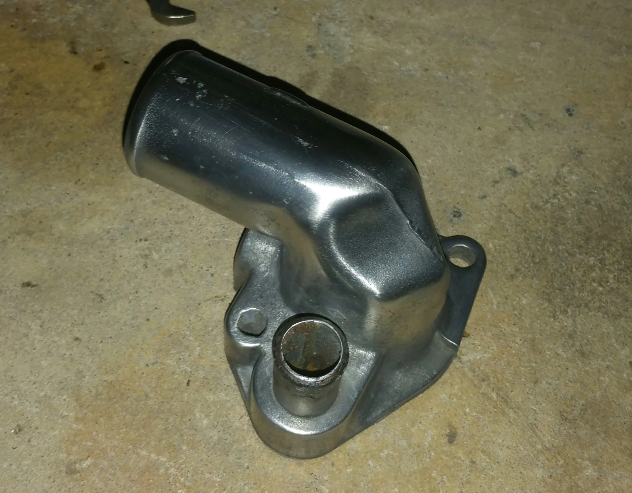

I cleaned up my timing cover and water neck as well and put some hi-temp silver paint on it but haven't done the IAC yet.

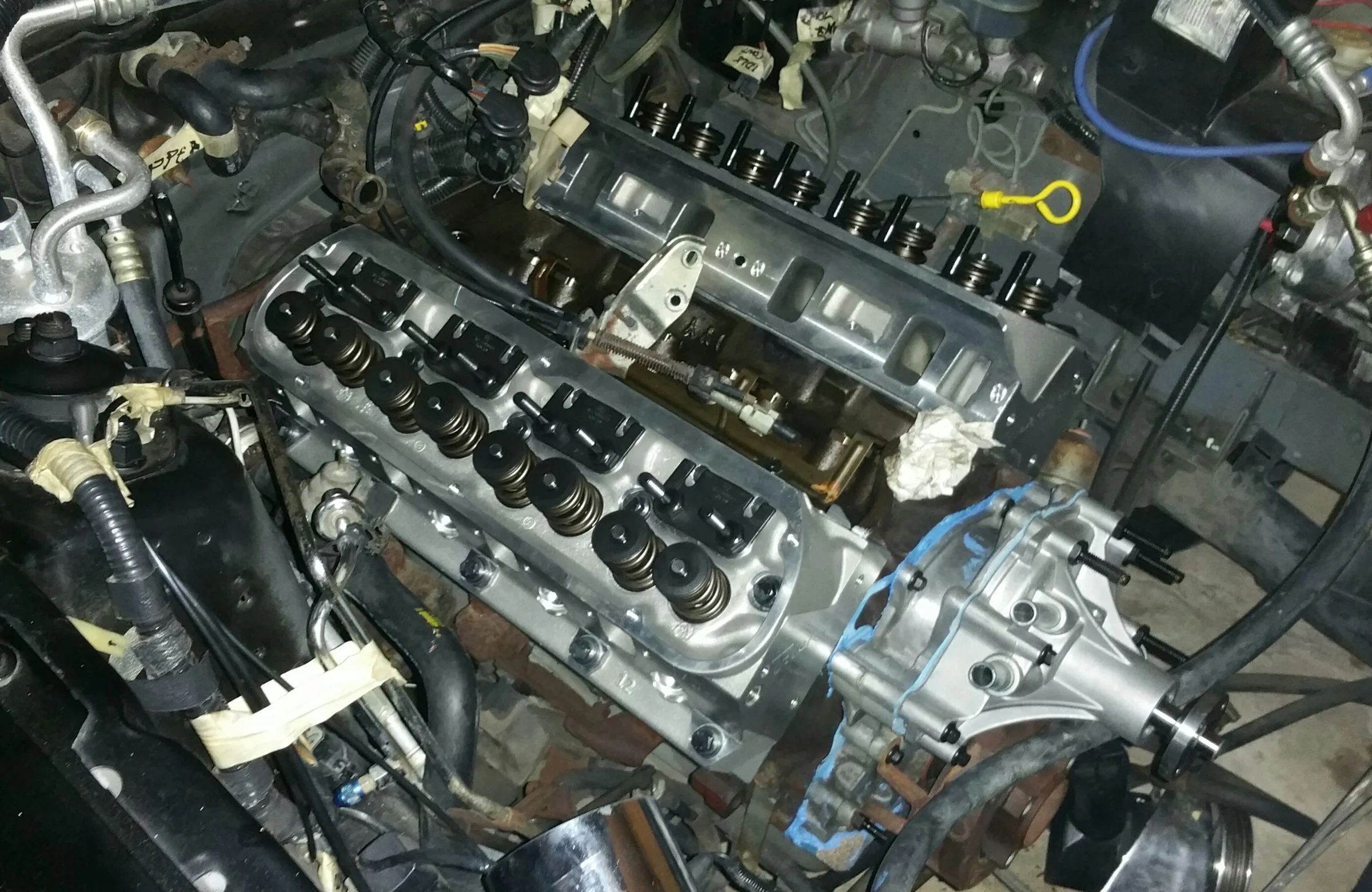

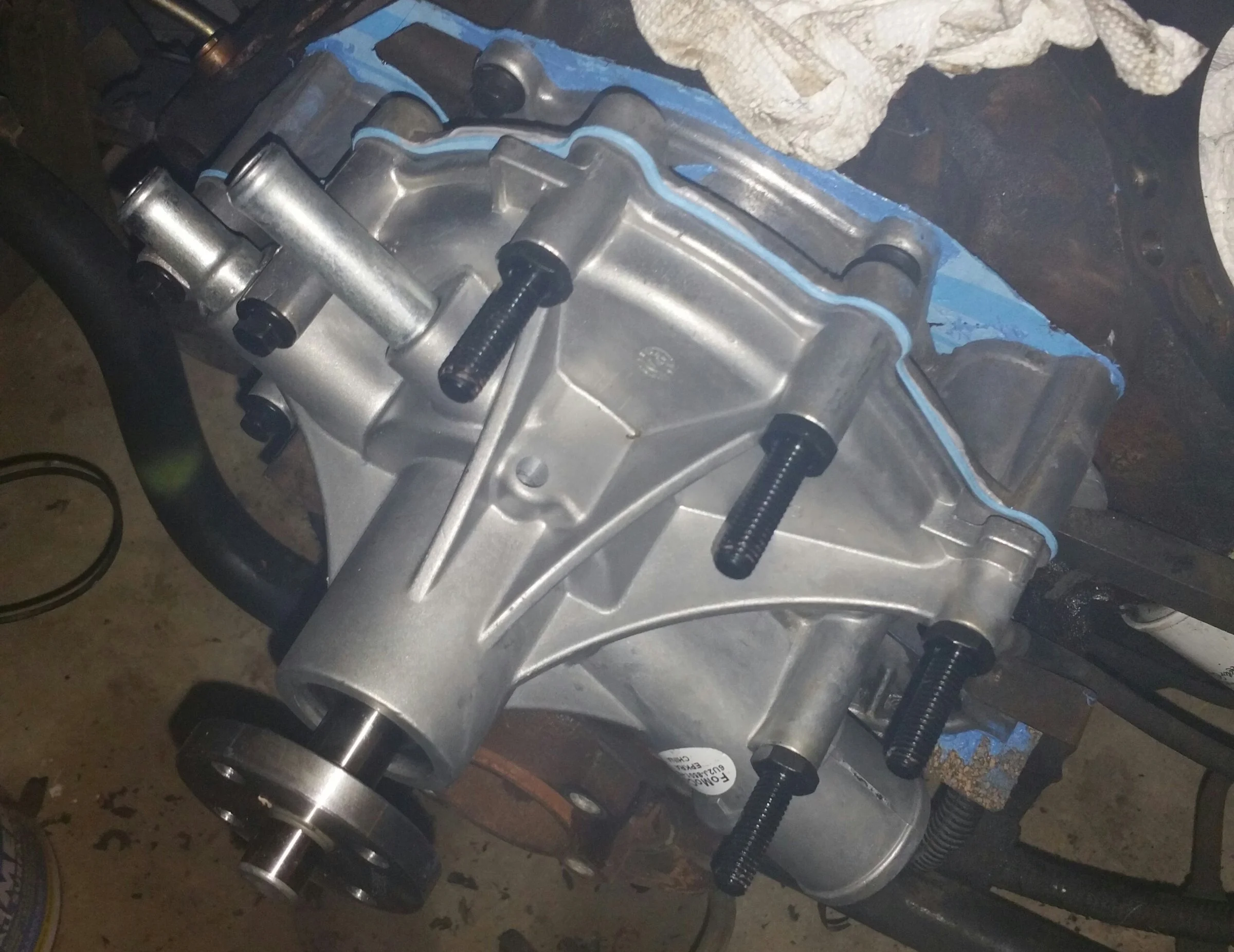

Got the timing cover , water pump and balancer on. I used the LMR bolt kit for the timing cover and pump which was nice not worrying about old bolts. Unfortunately I'm not thrilled with how the timing cover went on, for some reason I tried to reuse the original rubber pan gasket, it seemed to be in great shape but I wasted so much time trying to get it to sit on the pan and into the bottom of the cover, it just kept falling in which pissed me off so I cut the damn thing off and used the supplied stuff from felpro , things didn't go alot better, the cork corners were sliding around and I am not crazy about three mating surfaces meeting in the corners with a bunch of RTV. I guess at this point I'll just have to hope it sealed up or I'll be taking it all back off again, at least the balancer and pump went on without any problems.....nothing oviously wrong anyway...hahaha.

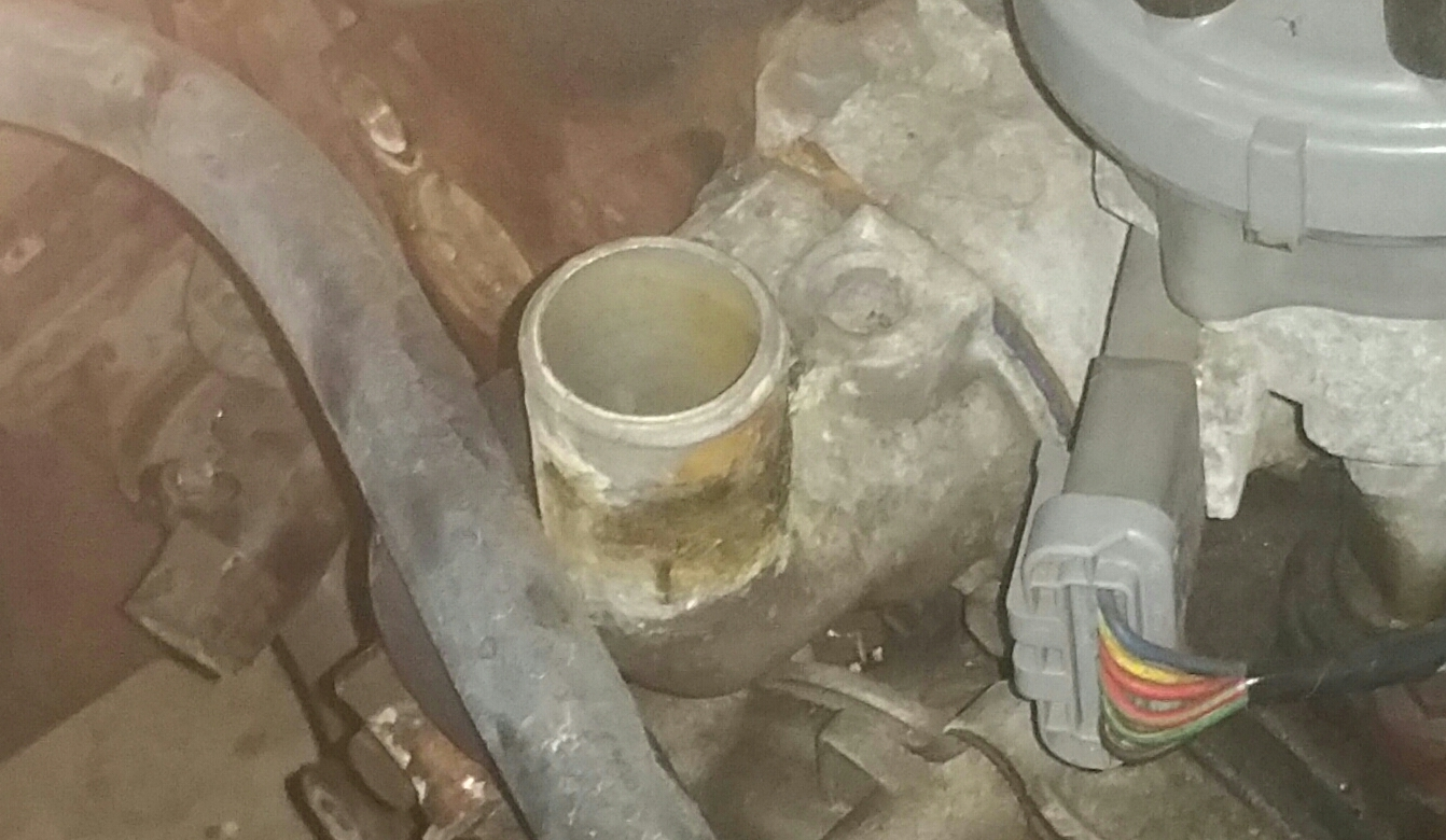

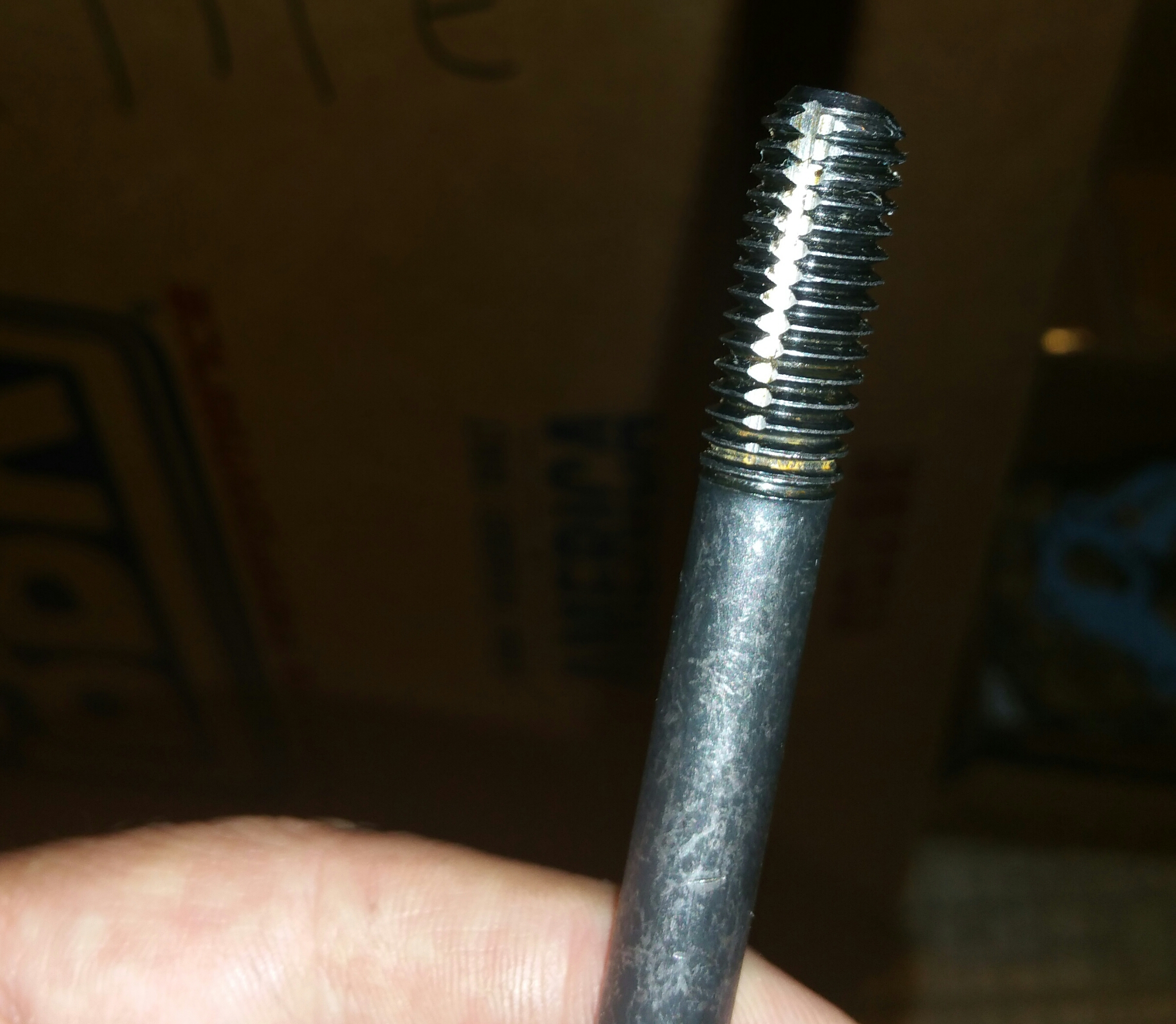

As many of you know it is recommended you chase the threads on the block that are gonna hold down the newly installed heads, gunk and grime can cause the bolts added torque while installing the heads and create inconsistencies while bolting. So I didn't have a chase handy and Lowes and the Depot just don't carry them by me. After some searching the Internet I found you can create your own using a old head bolt in good shape and cut a couple slots in it with a grinder making sure not to wreck the threads. I was fairly confident I didn't have any damaged threads in the block since removing the old bolts went really well. So I gave it a shot, to my relief it worked very well, I was able to finger tighten them to the bottom of the hole removing it once or twice a hole to clean the gunk off. Maybe it's considered a hokey way of doing it but geez I think it saved me some time and money.

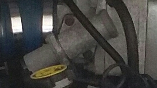

I would really appreciate it if someone could tell me if the cross over smog tube requires anything between it and the head to eliminate any potential leaks. When I removed the heads and disconnected the tubes I didn't see or feel anything on either the head or tubes. It just seems strange to me that two flat mating surfaces would have nothing between them ? Also I'm not interested in deleting it, which is really the only information available.

I don't remember anything going between the two. If it's truly a concern you can try some copper RTV it's the only thing that will hold up against hot exhaust gases
I also believe that would be the only product to use, if it don't need it that would be great considering that smearing it around back there will probably be a pain in the butt.

@Jersey Joe
EGR tubes?
Are you talking about the tube on the back of the heads?

Yes, the metal tube and flange that attaches to the rear of both heads.

That's the Thermactor Air system better known as the "Smog Pump"

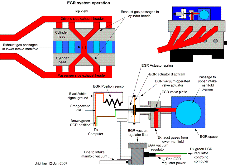

EGR System theory and testing
Revised 29-Sep-2013 to add code definitions for EGR sensor and EVR regulator.
The EGR shuts off at Wide Open Throttle (WOT), so it has minimal effect on performance. The addition of exhaust gas drops combustion temperature, increases gas mileage and reduces the tendency of the engine to ping. It can also reduce HC emissions by reducing fuel consumption. The primary result of EGR usage is a reduction in NOx emissions. It does this by reducing the amount of air/fuel mixture that gets burned in the combustion process. Less air from the intake system means less air to mx with the fuel, so the computer leans out the fuel delivery calculations to balance things out. This reduces combustion temperature, and the creation of NOx gases. The reduced combustion temp reduces the tendency to ping.
The computer shuts down the EGR system when it detects WOT (Wide Open Throttle), so the effect on full throttle performance is too small to have any measurable negative effects.
The EGR system has a vacuum source (line from the intake manifold) that goes to the EVR, computer operated electronic vacuum regulator. The EVR is located on the back of the passenger side shock strut tower. The computer uses RPM, Load. and some other factors to tell the EVR to pass vacuum to open the EGR valve. The EGR valve and the passages in the heads and intake manifold route exhaust gas to the EGR spacer (throttle body spacer). The EGR sensor tells the computer how far the EGR valve is open. Then computer adjusts the signal sent to the EVR to hold, increase or decrease the vacuum. The computer adds spark advance to compensate for the recirculated gases and the slower rate they burn at.
The resistor packs used to fool the computer into turning off the CEL (Check Engine Light) off are a bad idea. All they really do is mess up the data the computer uses to calculate the correct air/fuel mixture. You can easily create problems that are difficult to pin down and fix.
Troubleshooting:
There should be no vacuum at the EGR valve when at idle. If there is, the EVR (electronic vacuum regulator) mounted on the backside of the passenger side wheelwell is suspect. Check the vacuum line plumbing to make sure the previous owner didn’t cross the vacuum lines.
Diagram courtesy of Tmoss & Stang&2birds. (the diagram says 88 GT, but the EGR part is the same for 86-93 Mustangs)
The EGR sensor is basically a variable resistor, like the volume control on a radio. One end is 5 volt VREF power from the computer (red/orange wire). One end is computer signal ground (black/white), and the middle wire (brown/lt green) is the signal output from the EGR sensor. It is designed to always have some small voltage output from it anytime the ignition switch is the Run position. That way the computer knows the sensor & the wiring is OK. No voltage on computer pin 27 (brown/lt green wire) and the computer thinks the sensor is bad or the wire is broken and sets code 31. The voltage output can range from approximately .6-.85 volt. A defective or missing sensor will set codes 31 (EVP circuit below minimum voltage) or 32 ( EGR voltage below closed limit).
The EVR regulates vacuum to the EGR valve to maintain the correct amount of vacuum. The solenoid coil should measure 20-70 Ohms resistance. The regulator has a vacuum feed on the bottom which draws from the intake manifold. The other vacuum line is regulated vacuum going to the EGR valve. One side of the EVR electrical circuit is +12 volts anytime the ignition switch is in the run position. The other side of the electrical circuit is the ground path and is controlled by the computer. The computer switches the ground on and off to control the regulator solenoid. A defective EVR will set codes 33 (insufficient flow detected), 84 (EGR Vacuum Regulator failure – Broken vacuum lines, no +12 volts, regulator coil open circuit, missing EGR vacuum regulator.)

Very informative, really spells out what the smog pump and egr do, but I didn't see anything about attaching the thermactor tube to the head and what if anything you would use to stop any potential leaks.

Jersey Joe
I remember blowing that Monkey's ass
763
1,298
154
58
Bloomingdale N.j.
Jul 21, 2016
#79
  • Jul 21, 2016
  • #79
Chuckman said:
as stated a couple posts up, there's no gasket from the factory, but a little copper rtv wont hurt.
Thanks everybody for your input, I'm probably just gonna put a dab of the copper rtv on and call it a day.
Reactions: a91what, A5literMan and Davedacarpainter
Jersey Joe
763
1,298
154
58
Bloomingdale N.j.
Jul 21, 2016
#80
  • Jul 21, 2016
  • #80
While I was racking my brain about the thermactor air tube at least I got something done.
Reactions: stangboy, a91what, A5literMan and 1 other person
