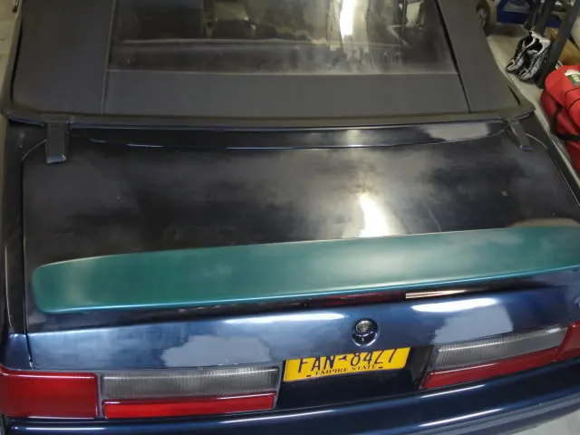

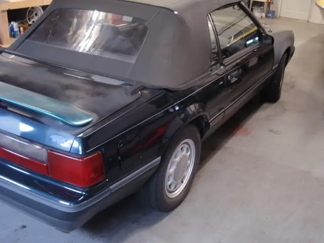

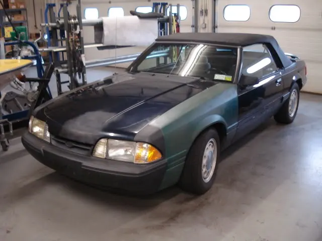

Here is where we started.

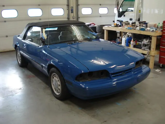

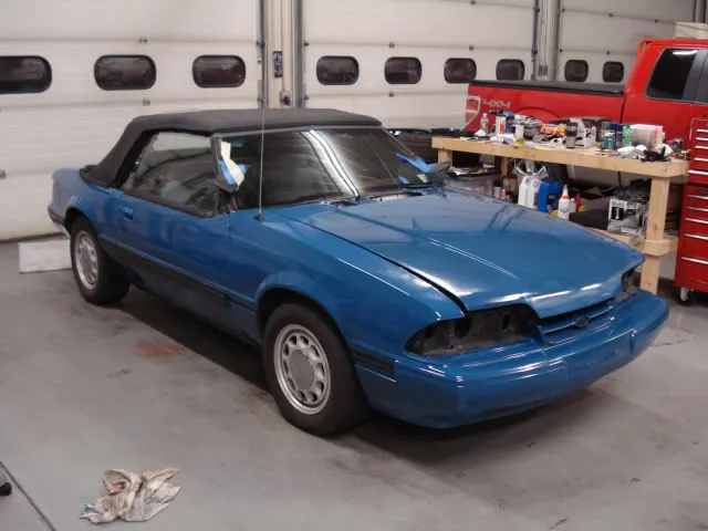

Coat # 1
Coat # 2 over that

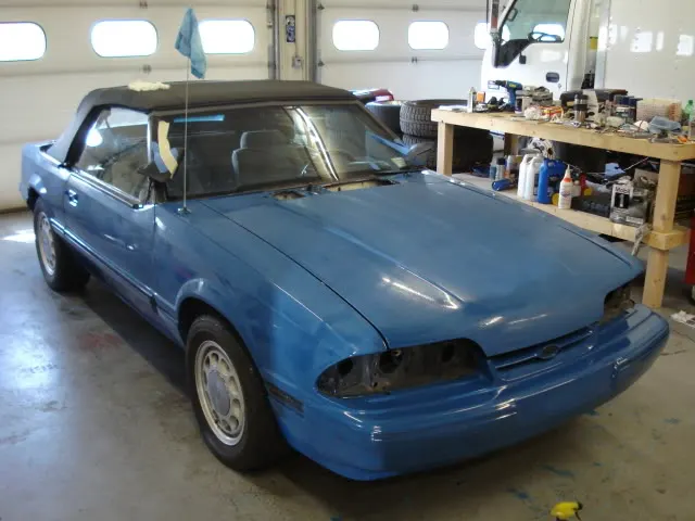

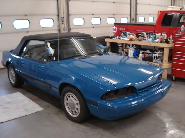

Wet sanded with 600 grit and coat # 3 applied, fish eye was a problem. Wiped down with Wax and tar remover before paint was applied...used Mineral spirits and wiped dry later on and it worked much better.

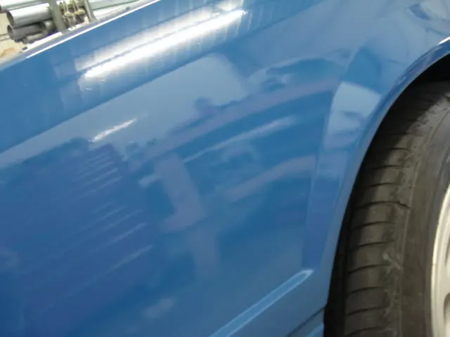

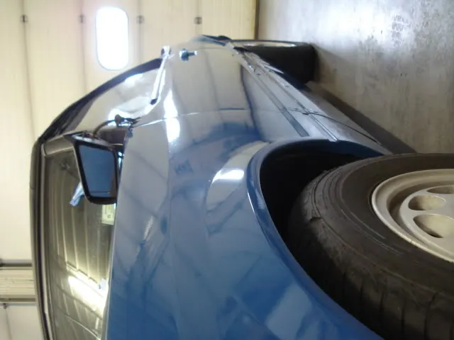

Coat # 4 over that, pretty well covered. Lots of orange peel to deal with.
Wet sanded with 800 grit, there is still some orange peel and low areas from fish eyed coat # 3, getting close to smooth but coverage is getting thin.

Coat # 1
Coat # 2 over that
