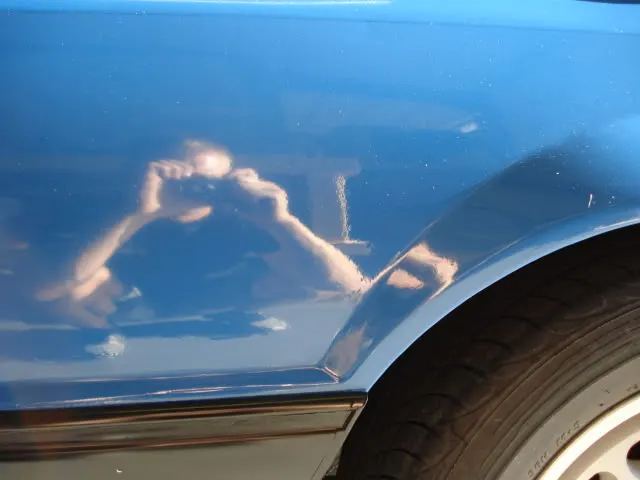

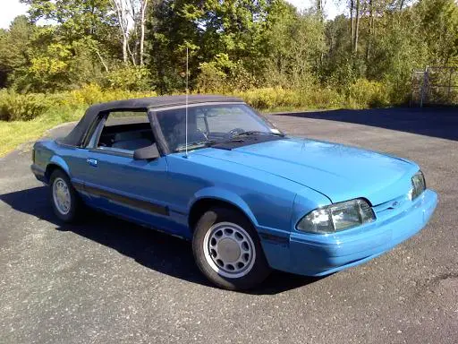

My attempt at the $50 Rustoleum Roll on Paint Job
Coat # 6 Wet sanded with 800/1000/2000. This is a test patch which came out well as far as reflection, but upon further inspection I noticed deep in the shine you could see where I sanded through the top coat and into the next...slight change in shade. So, I am going to put a final coat on and try to stay on that layer during the sanding and polishing. Thanks for looking, this is coming out great!

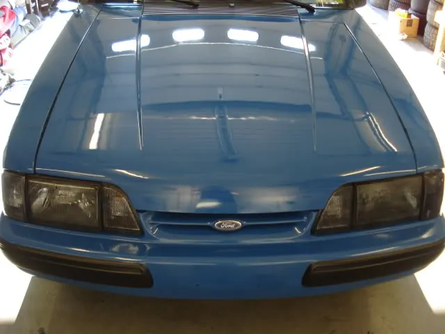

Backed out of the garage yesterday to let it get some fresh air and sunlight. This is coat # 7, I am going to let it harden a bit and hit it with some 1500, 2000 then polish.
I had some Headlights with Niteshade onthem so we threw those on instead of the faded stockers.
Sorry for the crappy cell phone pics
Still need to paint and install all the trim work and handles...might be done this afternoon!
