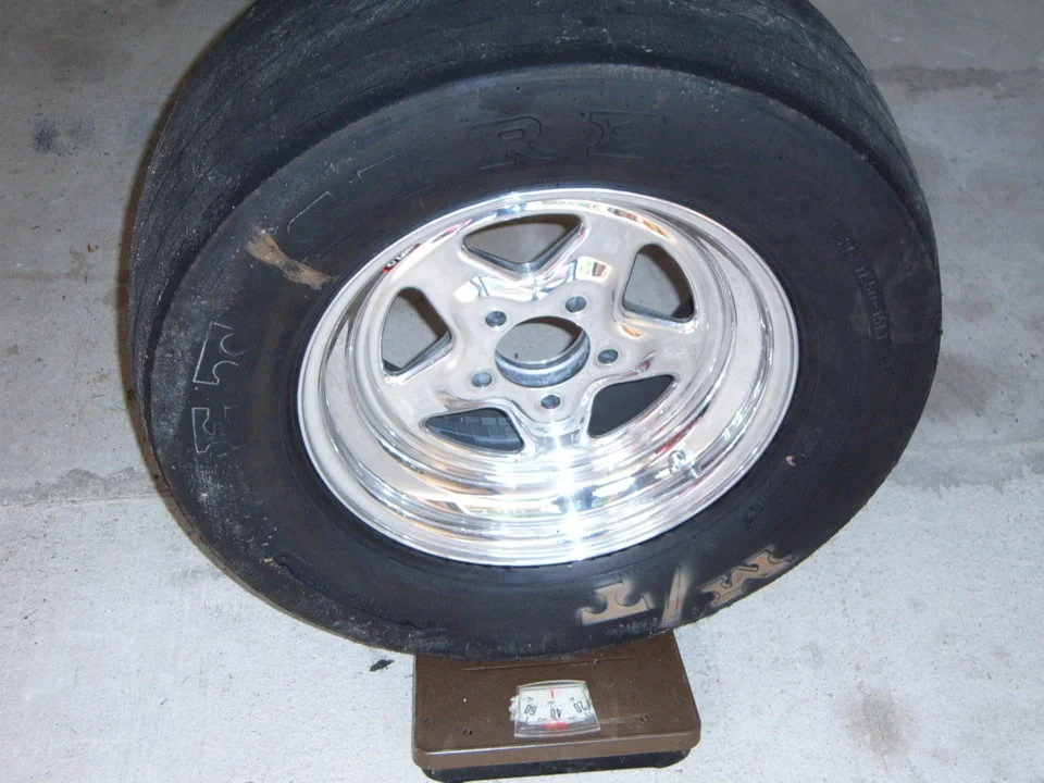

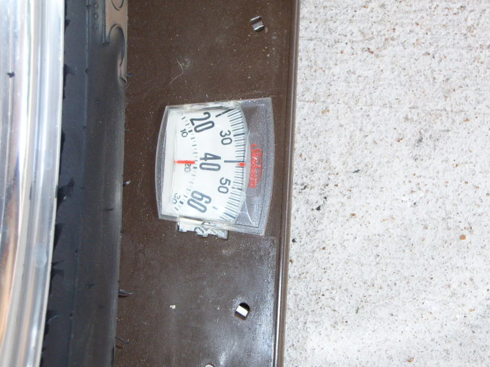

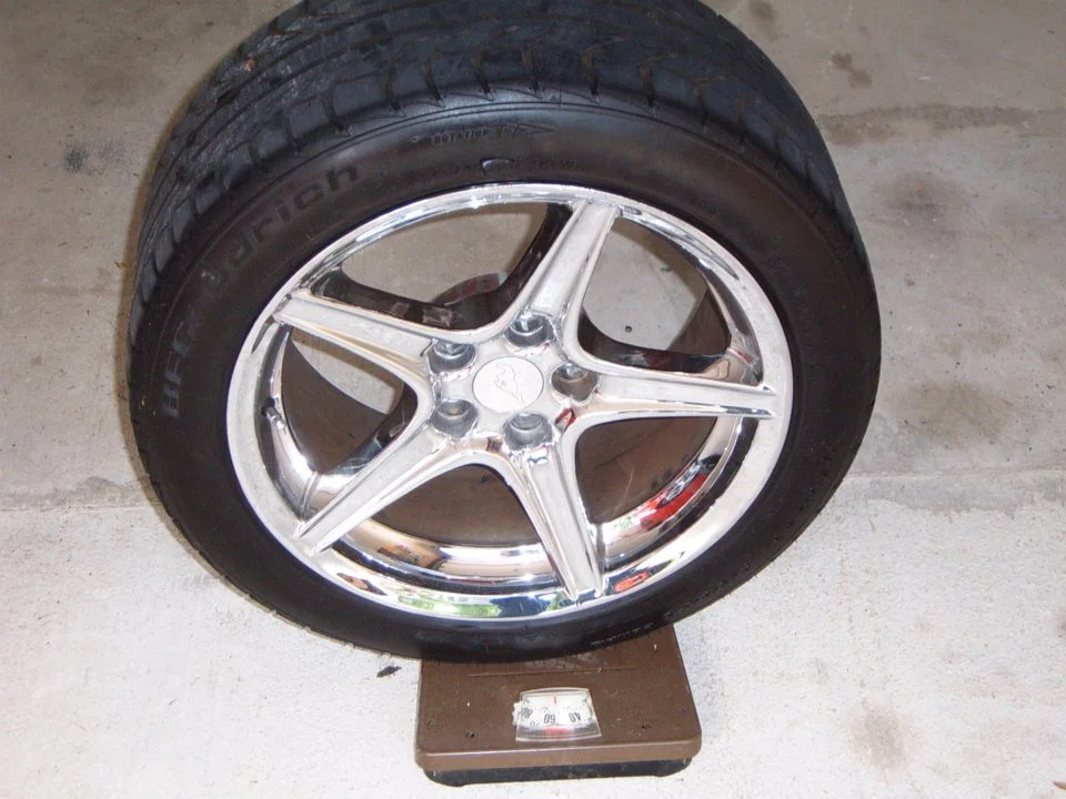

and while i was swapping tires last night and had the scale out, snapped these:
added up, its an ~26# difference. really makes me want to put a set of skinnys on the front, im sure they only weigh about 15-20#'s vs the the 50(!) lb saleens.

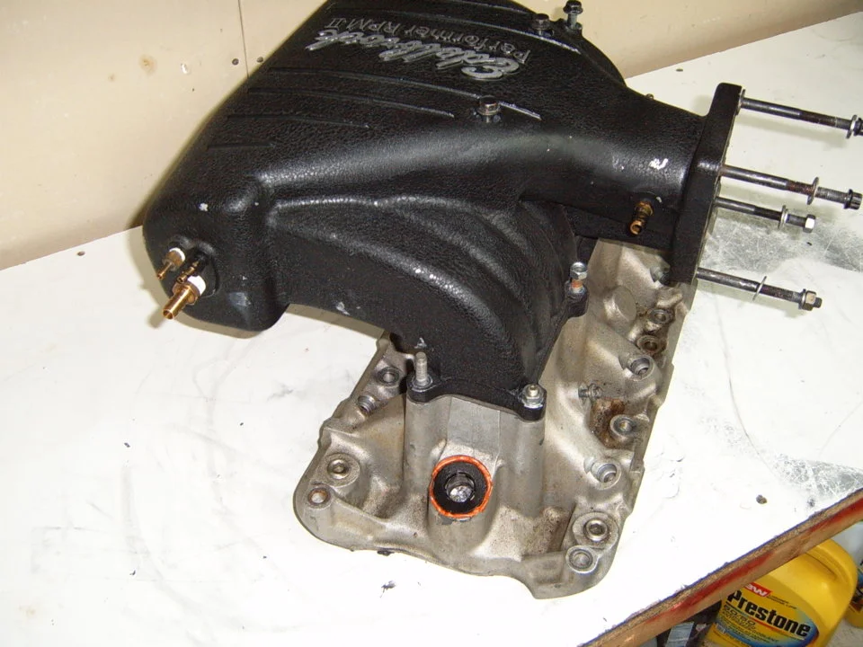

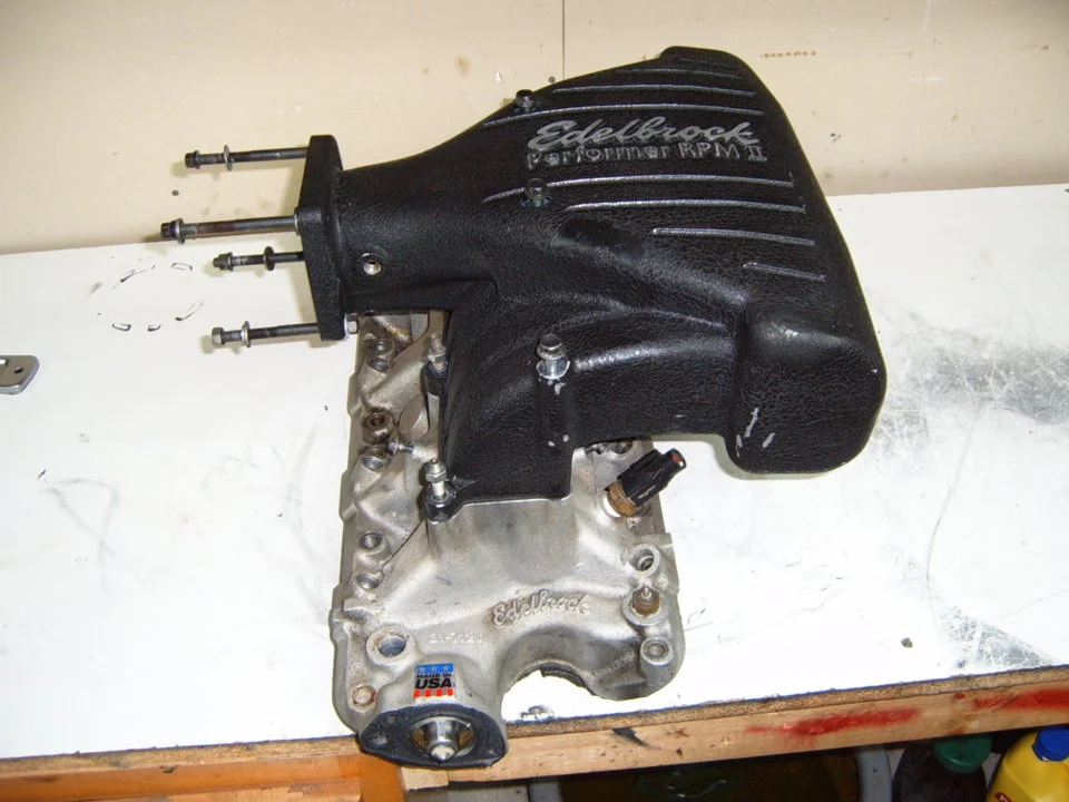

picked this up yesterday:
its dirty, badly painted, looks like it needs a helicoil (yay) and looks like the runners have at least been smoothed a bit.
also ordered a tfs stage 2. i know there's some that will think i should go custom, but this is such a cookie cutter combo i don't think its worth the extra $100+.

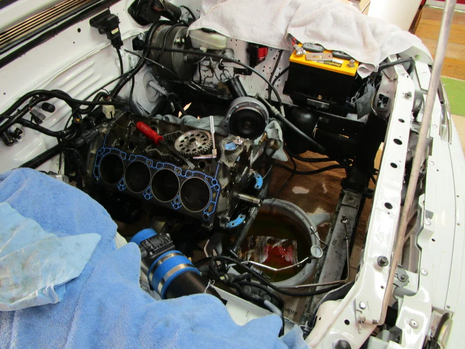

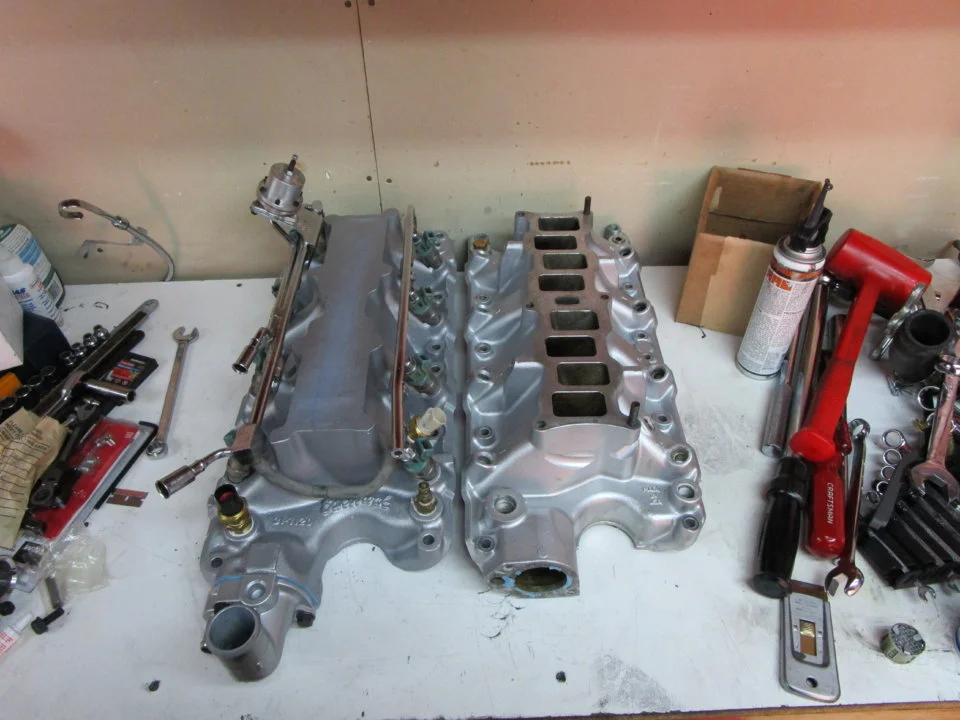

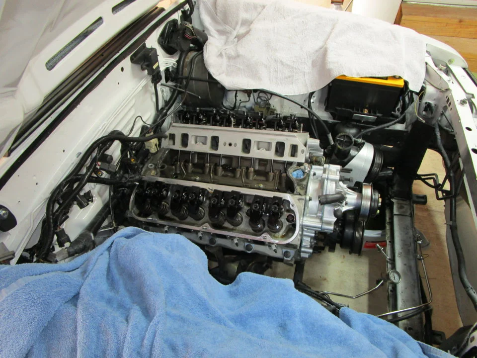

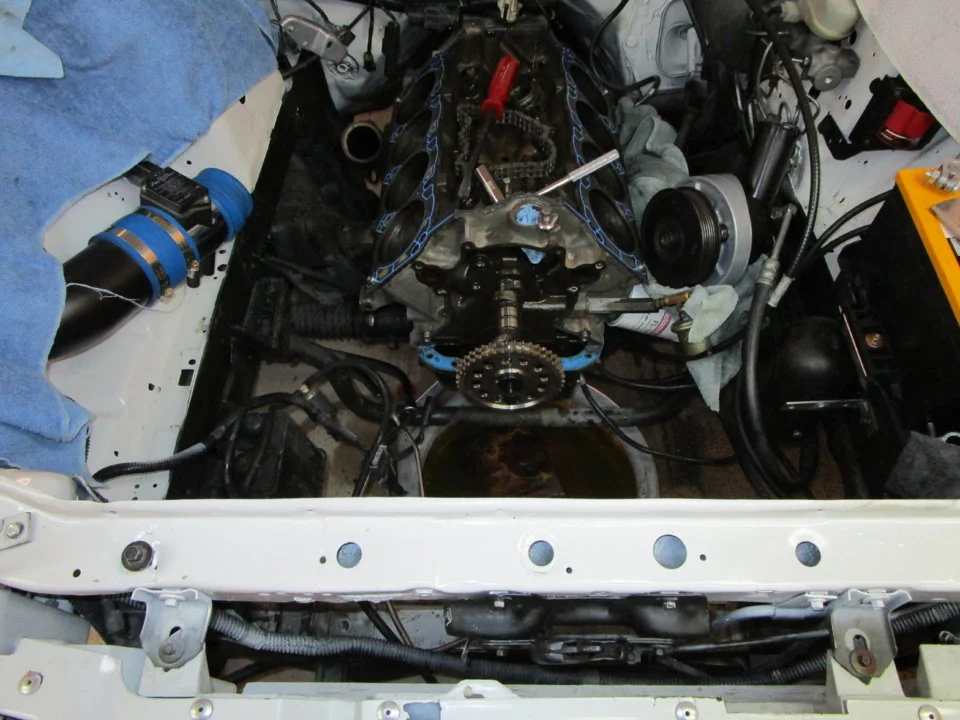

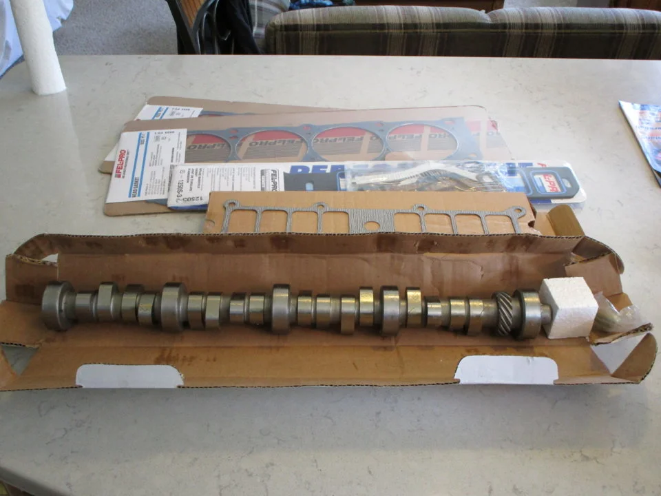

got some more parts in, work done, and a new camera to play with. figured i'd update while i'm taking a lunch break (craving some castle).
tfs stage 2, and all the gaskets (9333's this time, had 1011's on it last time)
intake stripped down
never have had intake gaskets come off this clean before

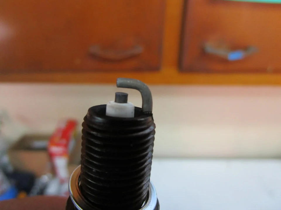

all 8 plugs looked like this, so far so good
taking the old tfs1 out
and where i stopped for now
so far everything has been going smooth, if it keeps up like that i should have it wrapped up tomorrow, and then driving on monday.
when i get back on it, i'll degree in the cam and check ptv (crossing fingers the dremel can stay put).

Plugs look good. Intake is going to look good. And if you didn't have to scrape the gaskets at all...you're living good lol. Curious to see what performance you pick up! Good luck!

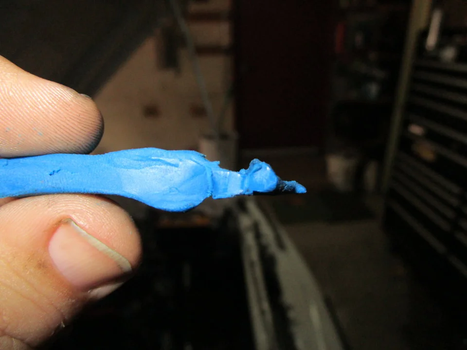

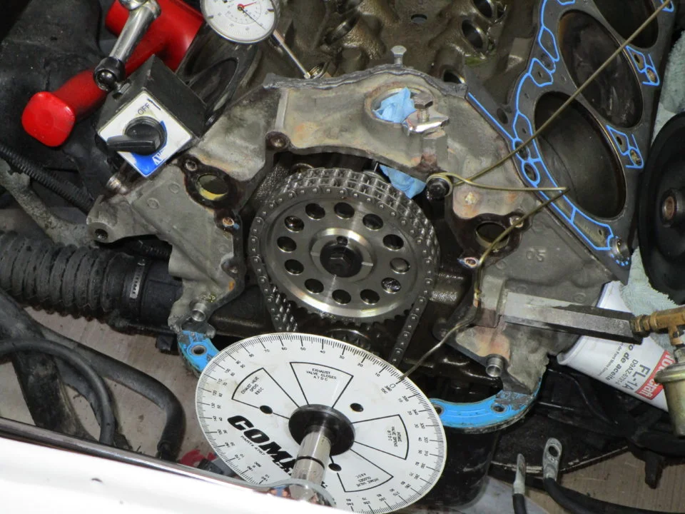

my setup for degreeing the cam (a bit finicky, but it works)

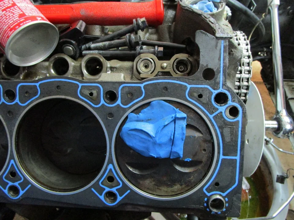

checking ptv clearance
the thinnest section here is .110"+, didnt bother measuring the exhast, it barely touched the clay

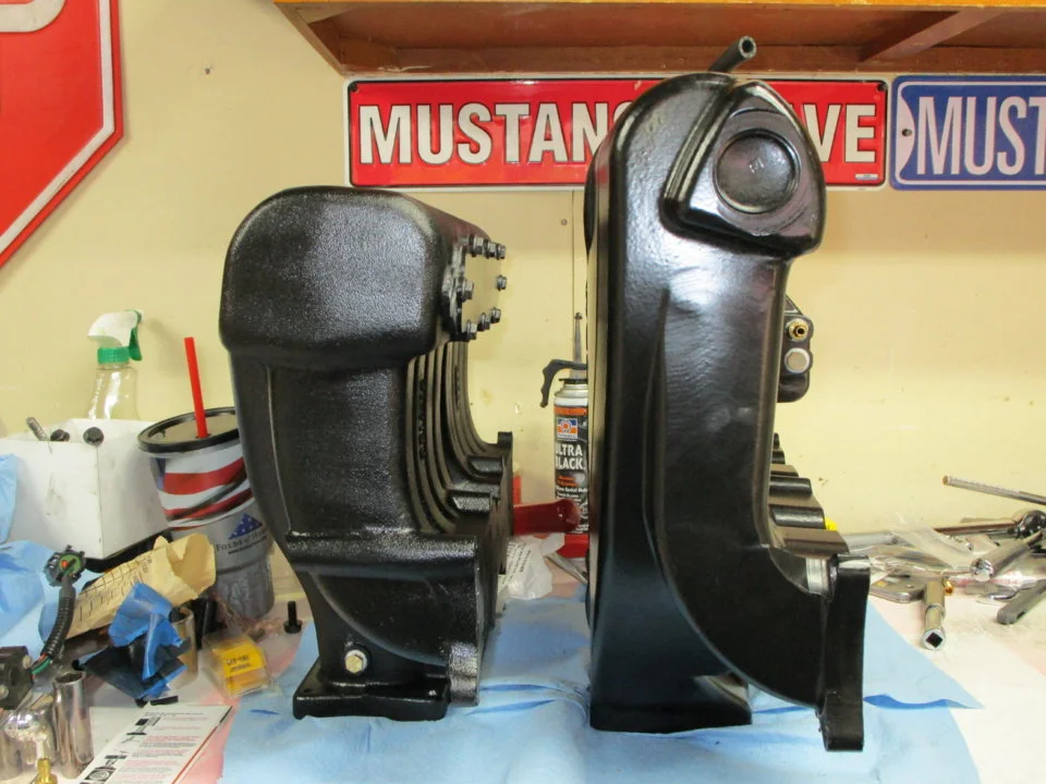

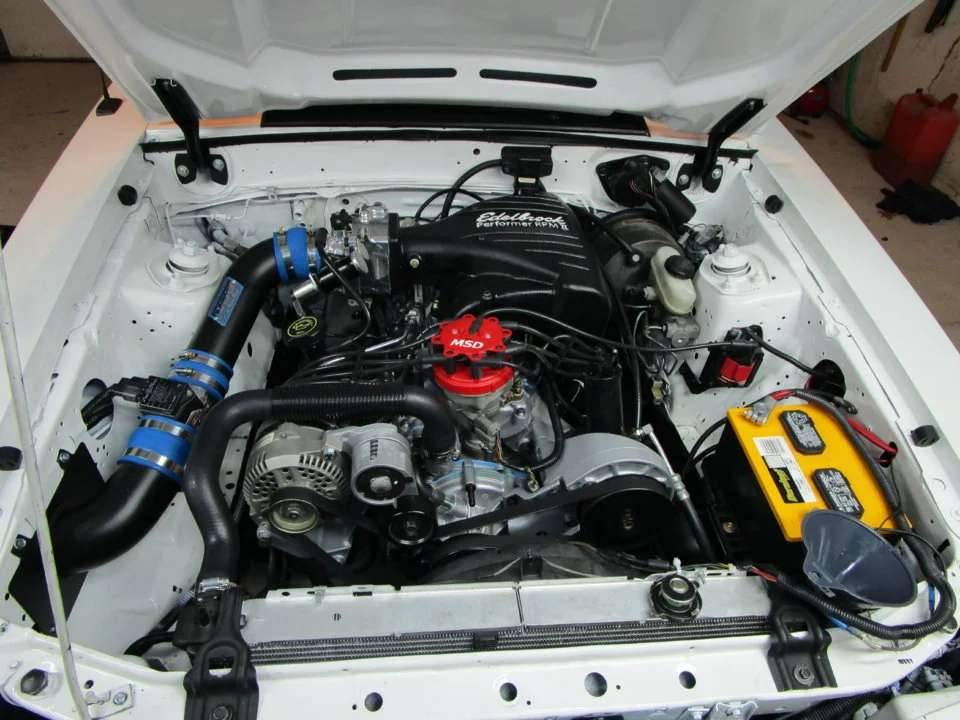

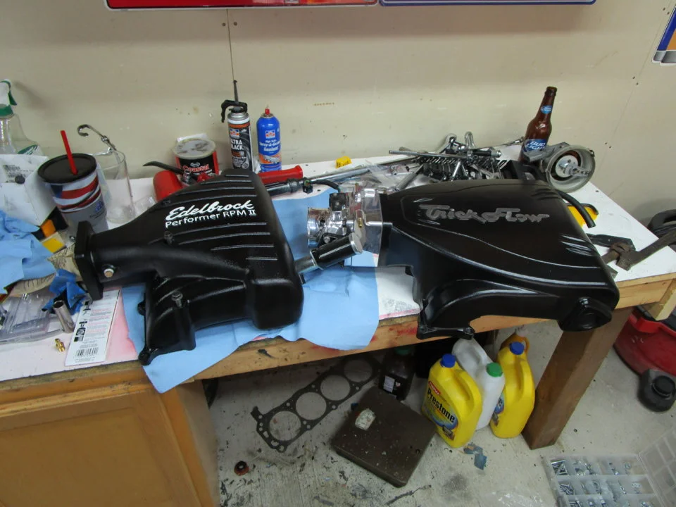

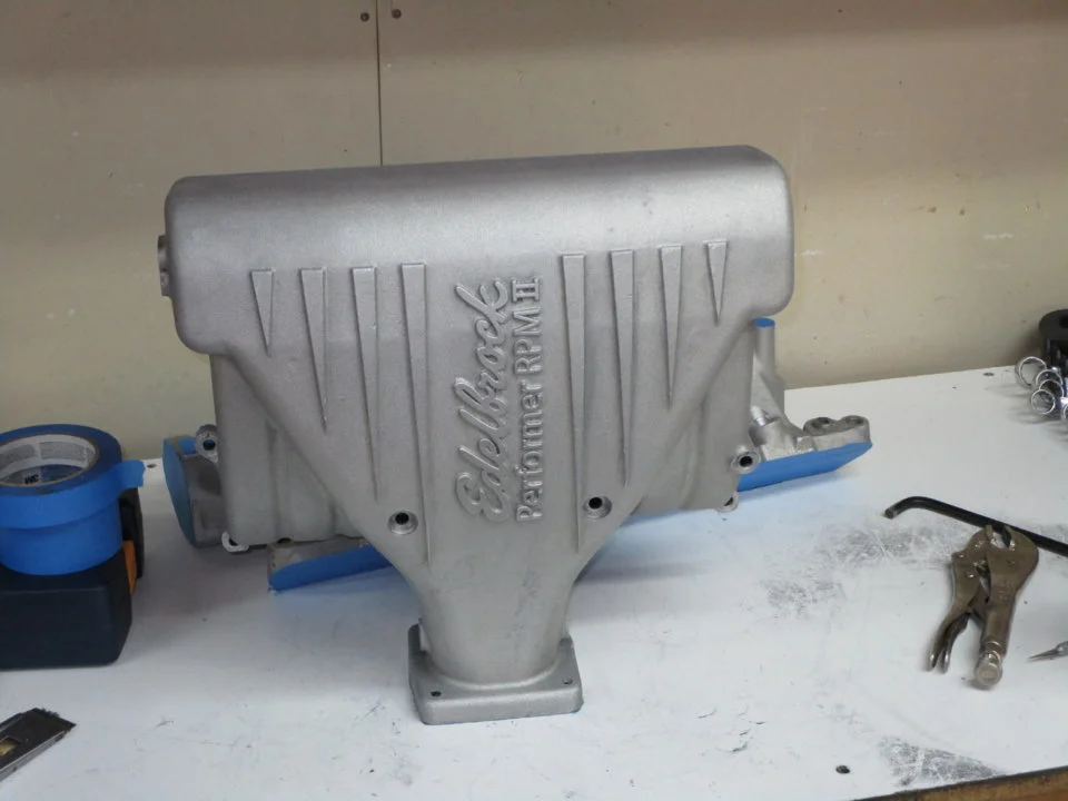

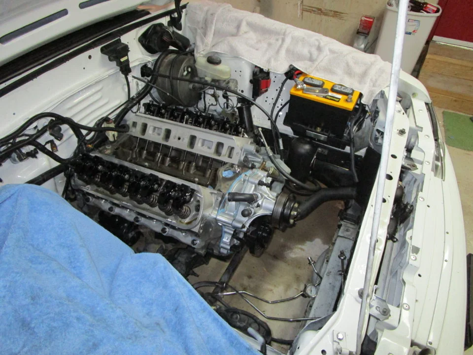

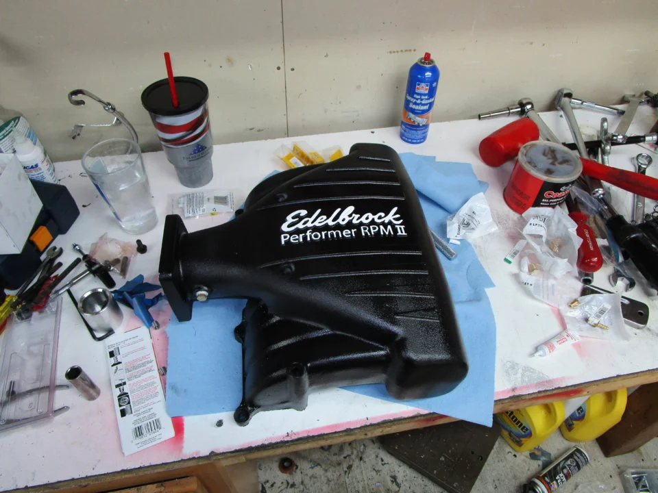

yesterdays and todays progress:
swapped fuel stuff and sensors to the new lower:

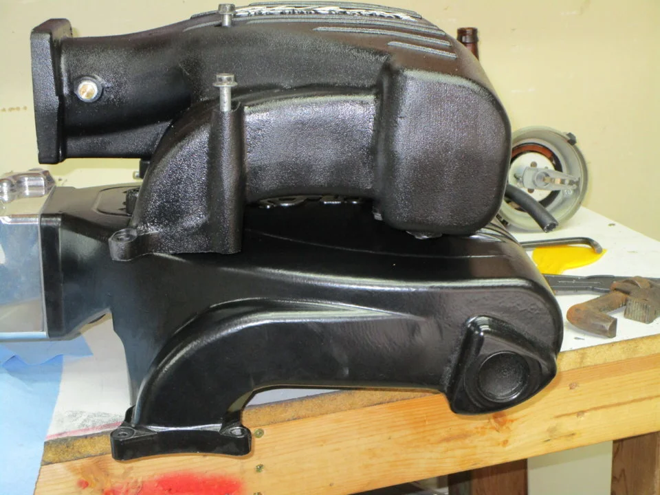

painted the upper
the rpm2 vs the tfs street, you can clearly see how much shorter the runners are on the rpm2, should translate to shifting the power band up higher (need it with the 4.10's)
and where i just left it just now since i gotta be up and moving by 4am. manufacturing hours suck for morning people, but getting out at 2:30 sure is nice except when you gotta spend an hour driving around to find all the fittings to make a vacuum system work. all thats left to do is double check that the rotor is lined up right, hook up the battery, and see if she starts.
once it starts and gets running again, i gotta fix the dash lights (the lrs dimmer switch is junk, all the contacts dont actually make contact), and find out why the rear tire scrubs all of a sudden making a hard right turn (the radials dont do this, i think it's the exhaust though, i really need a new catback but don't want to put the money towards it yet.
Reactions: Boosted92LX and A5literMan

Really like that engine bay. Very nice looking. Also very cool pic(the last intake comparison). Really shows the runner length differences. Ultimately what numbers do you think it will run now? I would think you should pick up .2-.5 in et. (12.3-12.5 and 2-3 mph)

let's see if youtube can kick my ass.....
actually started on the first turn of the key. idled right at 800+/-50 rpm without touching the idle adjustment.
took it for a drive, and its much more responsive. also doesnt buck at low rpms nearly as hard as the old setup. and it wants to run like a raped ape.
