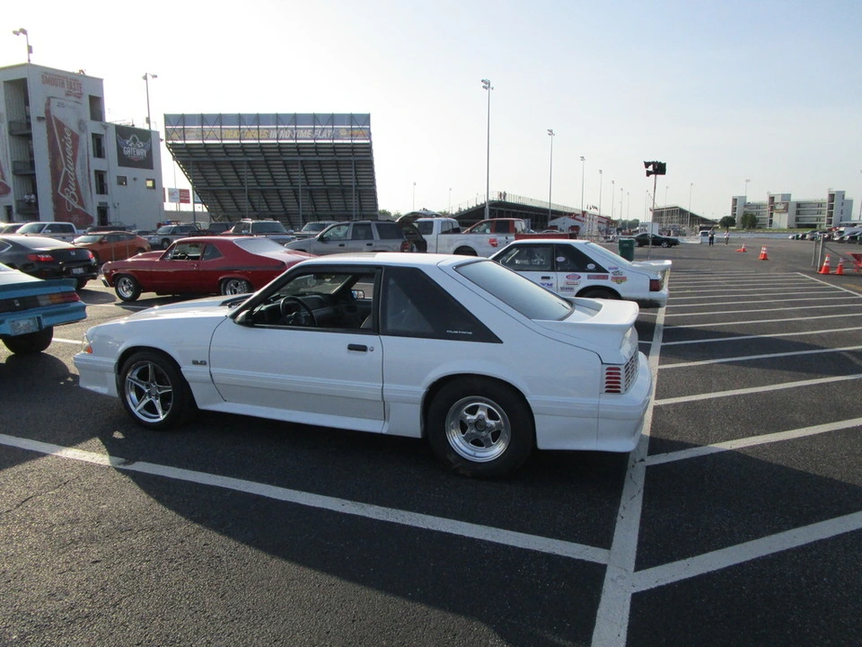

17x9 Cobra R's w/ 245/45/17 tires. It's close real close but no rubbing at all. I do have a UPR bump steer kit and MM cc plates also. I've put around 5-750 miles on it and have no complaints

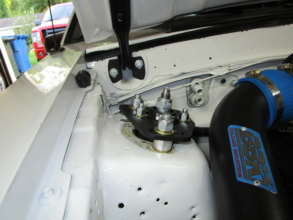

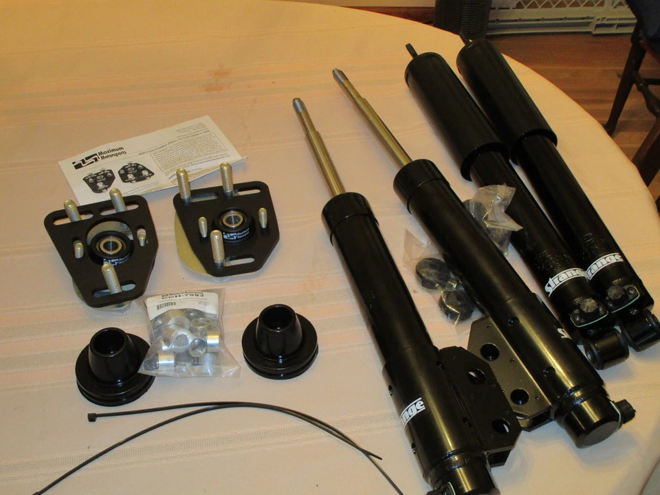

Hope your motor turns out healthy, i know how much of a bummer it is to finally get something finished just to have it blow up in your face,wouldn't wish that on anyone.I've got mine set in the middle also. They seem to give a descent ride and I can feel mine trying to work also. I still have my swaybar on for now. I was thinking of trying it at full loose and adjusting from there when I go to the track. I'm having a compression check on mine also and should have results this week. Good luck at the track I'm curious to see how the struts work for you.
Just an FYI I've read that you want to keep the rear shocks set at the "street" setting. Adjust your fronts first before messing with the rear. I have no experience with this yet personally. Just what I have read and been told by a buddy.track results to keep the thread alive.

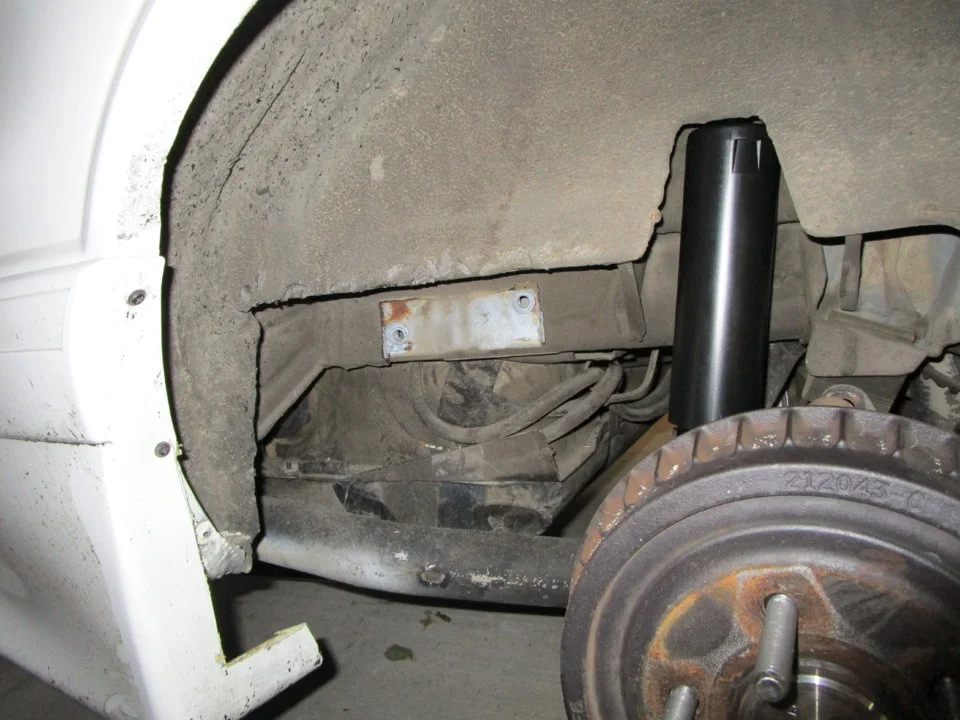

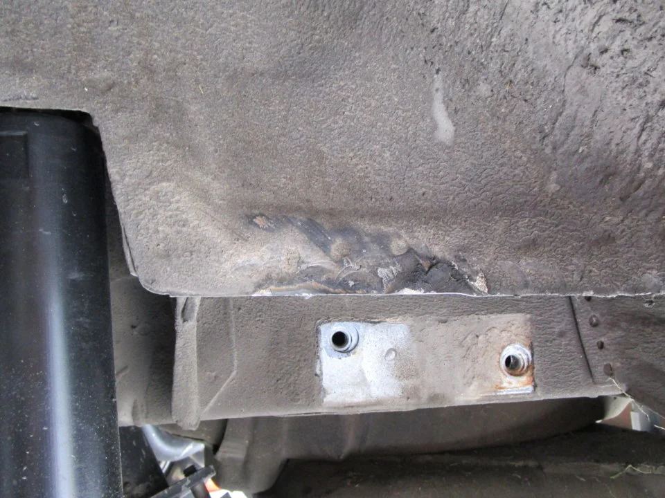

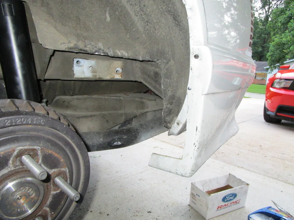

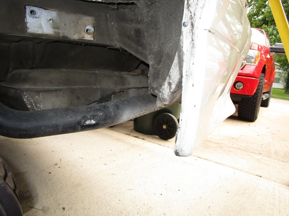

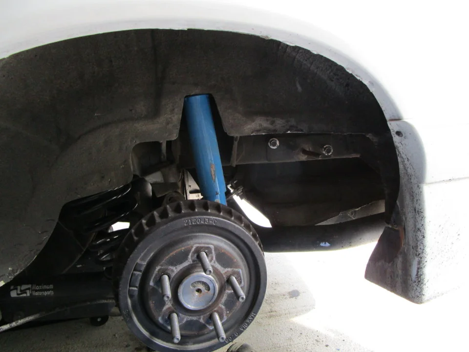

so even with all the clearancing and cutting i did, was still getting a little rub in the right rear. finally decided to investigate this afternoon.
you can see a little rubber on the inner fender here

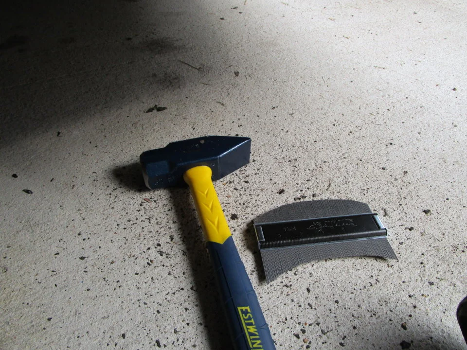

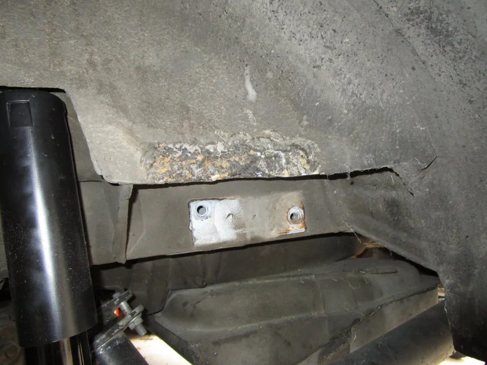

my weapons of choice (yes, that bfh is brand new, my old one was again my dad's and the head started sliding off at regular intervals). the contour gauge is to make sure the metal is actually moving since the hatch floor meets the well at a 90 right where the "hump" is.

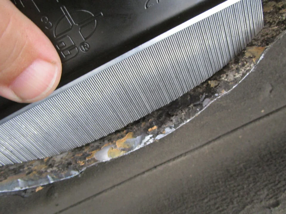

this is after resetting the gauge a second time, just barely moving, maybe an 1/8" or so total from where it started
heres why the gauge was important, with all the undercoat on this car its hard to visually see if it's working or just knocking coating off

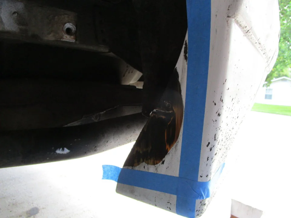

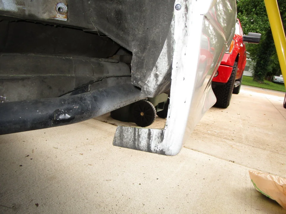

for good measure, also decided to cut this last bit off the rear spat

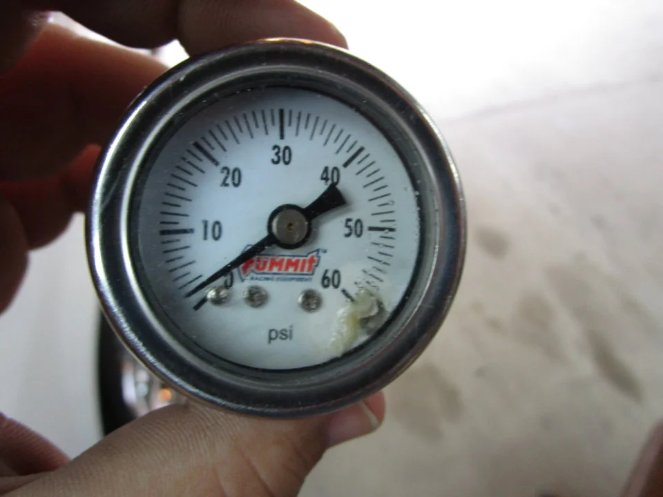

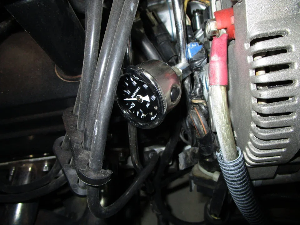

also swapped out my dried out fuel pressure gauge, im guessing the lack of liquid here is why it was bouncing all over the place. cost $12 6 years ago, not all that suprised.
the one i picked up at a local speed shop though......$40 after tax. this thing better last longer than the car for that money.

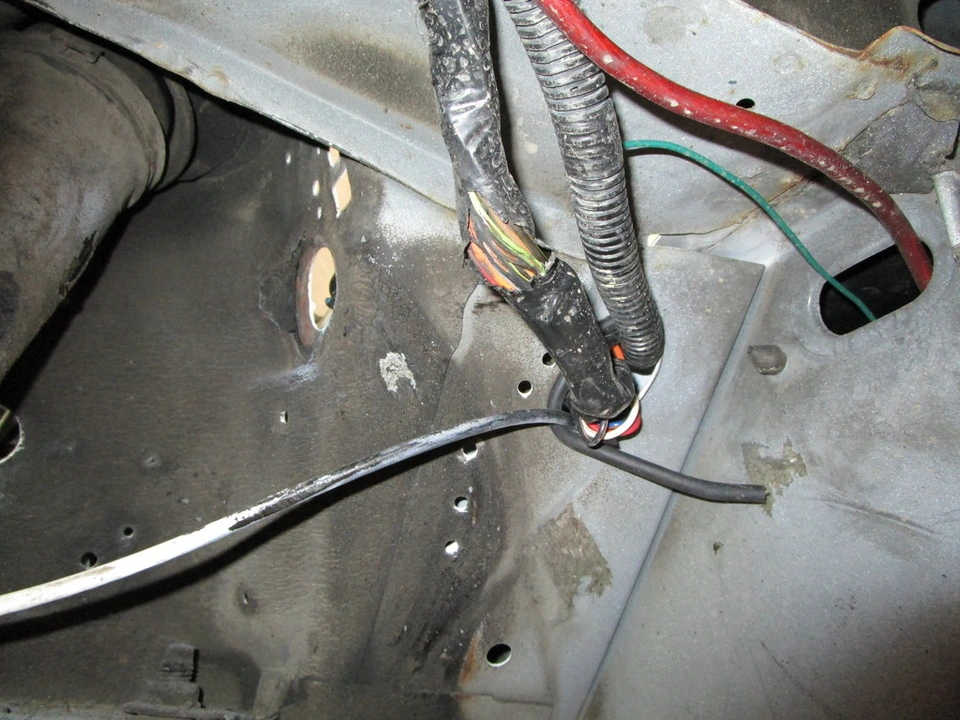

I thought the same thingReally not trying to tell you what to do, but that FP gauge next to that + alternator wire and post scares the Sh!t out of me.
