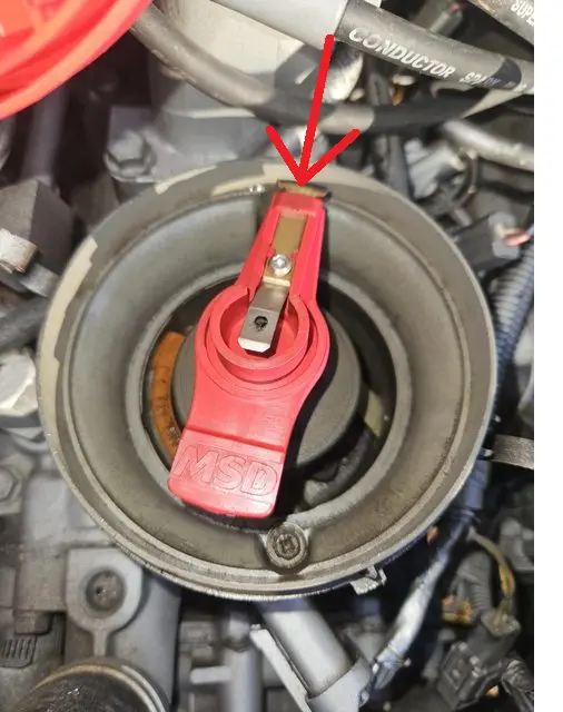

Pull your cap and rotor and look it over real good.

If it looks burned or worn away, replace it. Inside the cap, you are going to look at each of the 8 contacts that the rotor above, swipes past when the engine is running. They should look clean and flat with no gouges or galling. A little bit of discoloration means nothing.

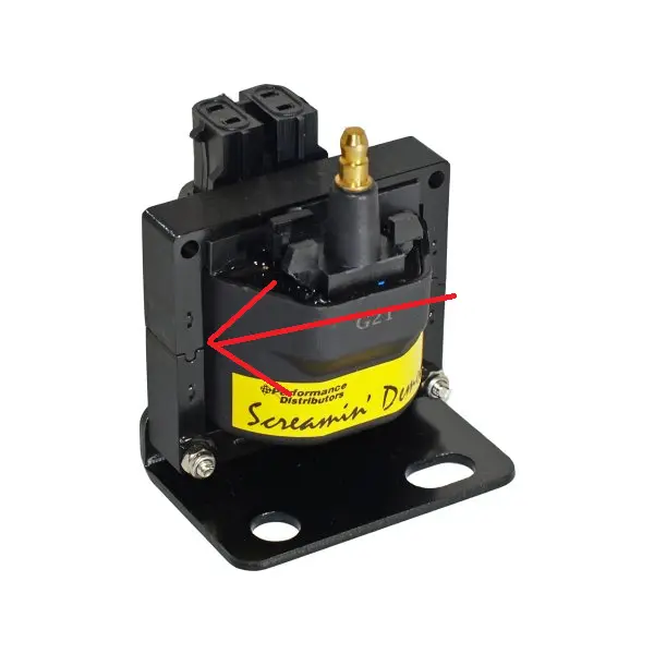

I have the MSD Super Conductor Spark Plug Wires And Screaming Demon Igniton Coils.
