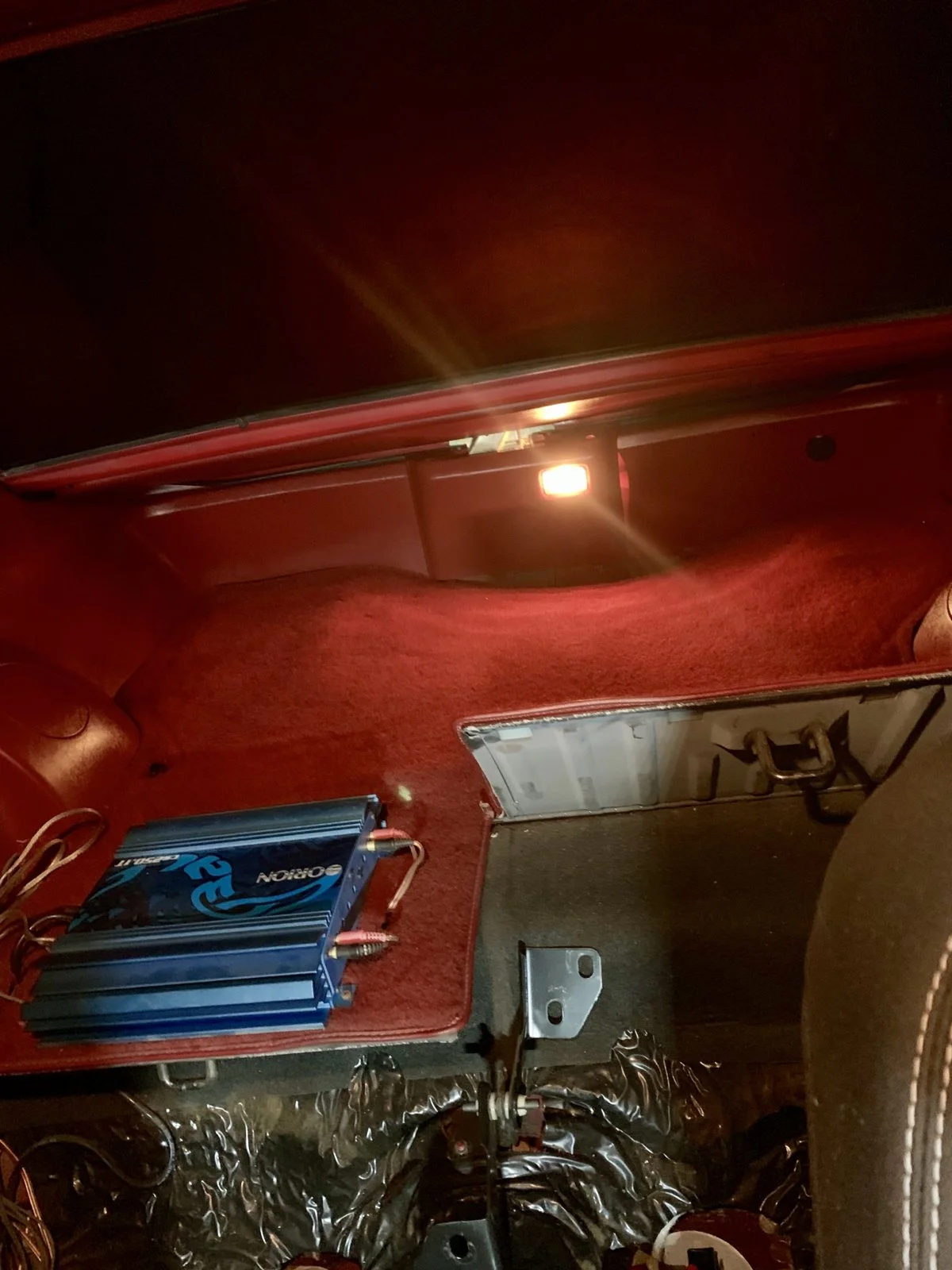

Nope I figured what’s the point of the original spare tire if I swapped to 5 lug. I have been thinking about throwing a spare out of a crown Vic in there or one out of a newer mustang. Or a custom speaker box!!No spare tire under there?
Hmmm that’s a large sheet of aluminum I need, Home Depot?Make yourself another spare wheel well cover from a rigid sheet of aluminum.
Attach the forward most portion of the new cover to a length of flat 'piano hinge' and rivet it to the cover.
Use the RED automotive two-sided sticky tape to adhere the other end of the ginge to cleaned contact surfaces on the cargo bay body.
Don't forget to drill a finger hole in the new cover. Large enough for pocket change to fall in, get trapped, and rattle all the way down the highway.

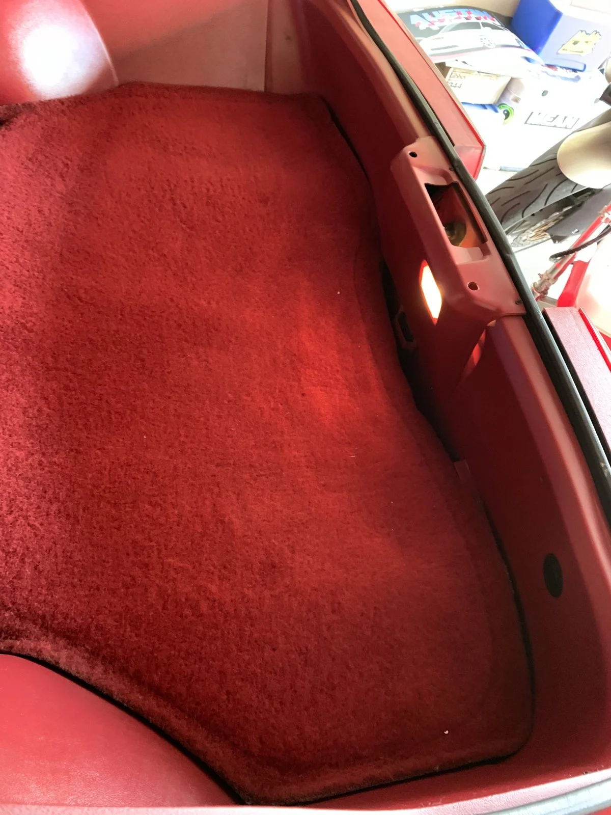

Damn. That came out really slick. Matches perfectly
Or a couple 10s in a custom box, but maybe a spare. Any good ideas for a spare option? Crown Vic’s have a 17in don’t theyOr put a spare tire back in so it will not droop anymore
