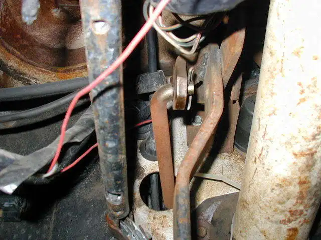

When I put the clutch pedal and associated hardware in for the Toploader swap, I of course had to punch out the hole for the pedal-to-z-bar rod. Knowing this could be trouble later, I made to sure to have the little rubber boot handy and installed it. The problem is that this rod is so off-center that it nearly touches the firewall. When I use the clutch, it grabs the rubber boot and pulls it out, making a nice little mouse expressway into my interior. I'm using the right pushrod, but I'm not sure I have a pedal out of a '67-68 Mustang; it could be from a Falcon or big car(I love ebay sellers :rolleyes:).
I'm fed up at this point. Without exagerrating, I have trapped at least 50 mice in the '68 alone and they keep coming. Is there perhaps another pedal rod I could use, or am I more or less stuck fabricating something?
by the sounds of it, it would be easier to build a new linkage, that is if I am interpreting the problem correctly. That sort of thing really isnt that hard to fabricate with a welder, vise and some steel rod but you could just move the hole in the firewall too. Just weld a small circular patch in the hole, smooth it out and redrill but I would probably just make a new linkage because there would be less work involved and less modification to the car as well.
This isn't my car, but it illustrates what I mean. I think this is a '67:

Yea, build a new rod, I would do it in the style of the accelerator linkages to allow for some adjustment of the pedal. Just bend the rod to the point where it is centered in the hole, thread the clutch pedal end leaving it straight. Then take a coupling nut and weld a rod to the side of it in the diameter of the hole on the clutch pedal. Thread that on the end of the new linkage and hook it up. That would be a cool adjustment to be able to make.
