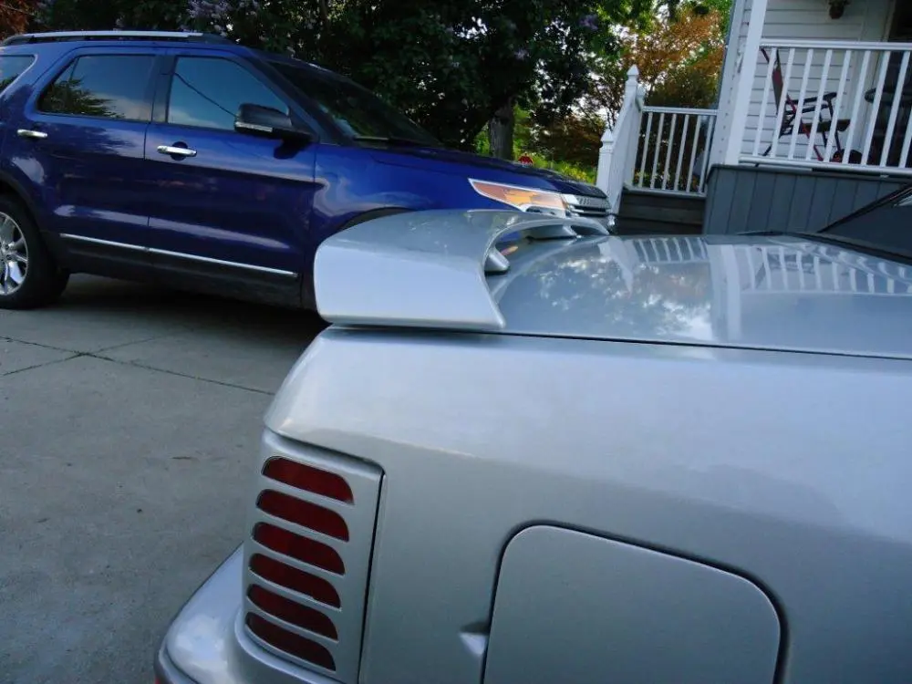

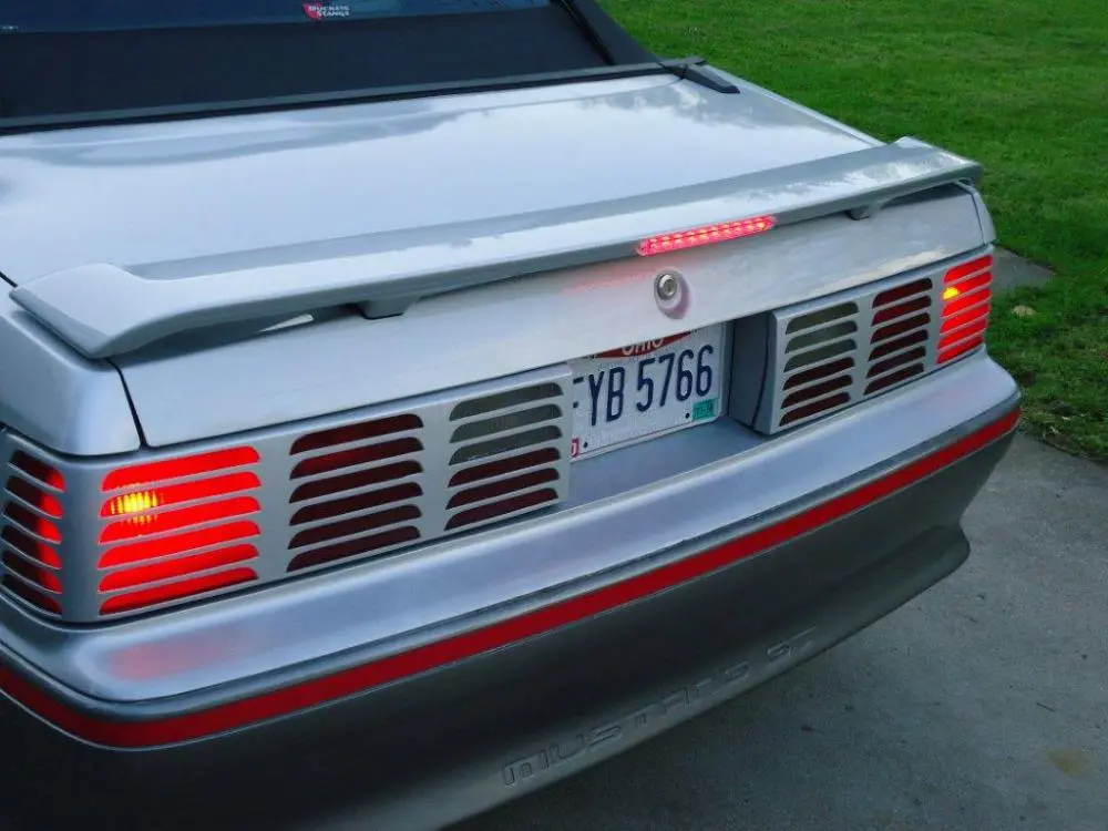

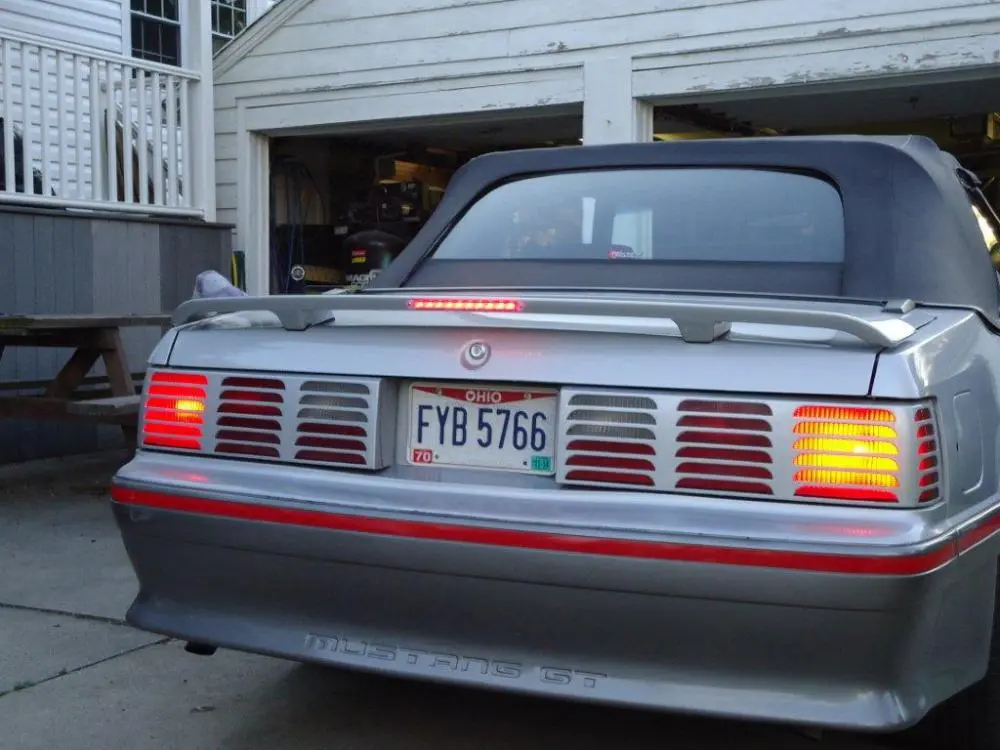

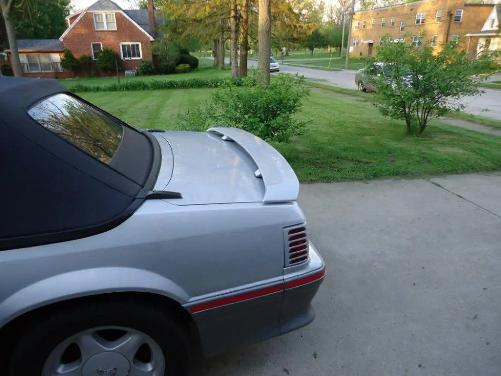

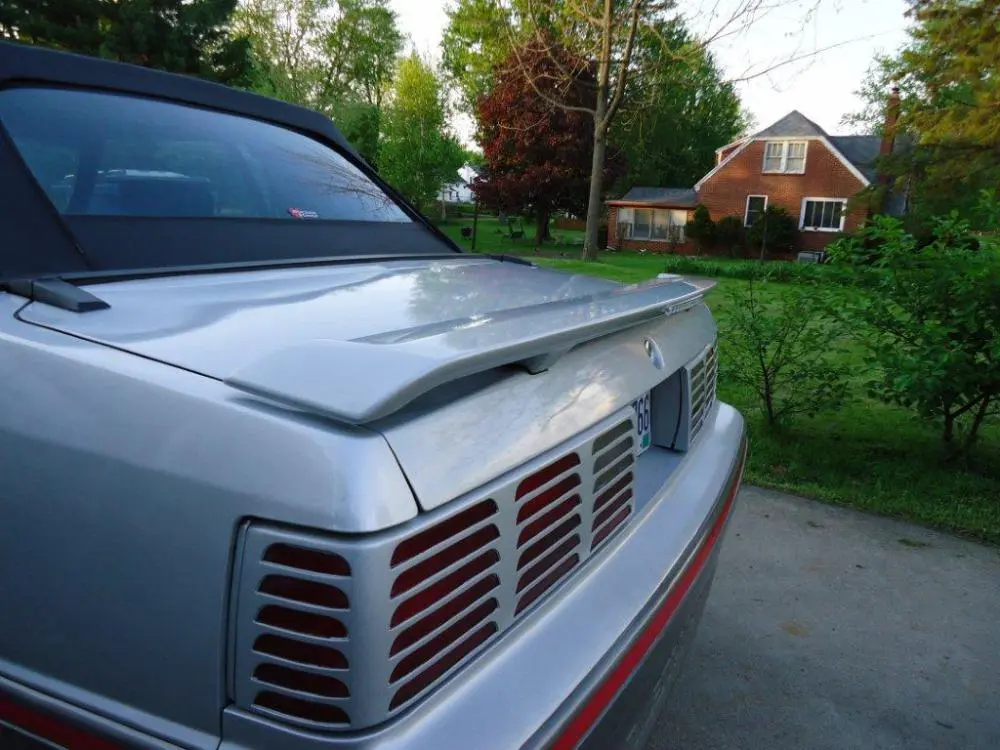

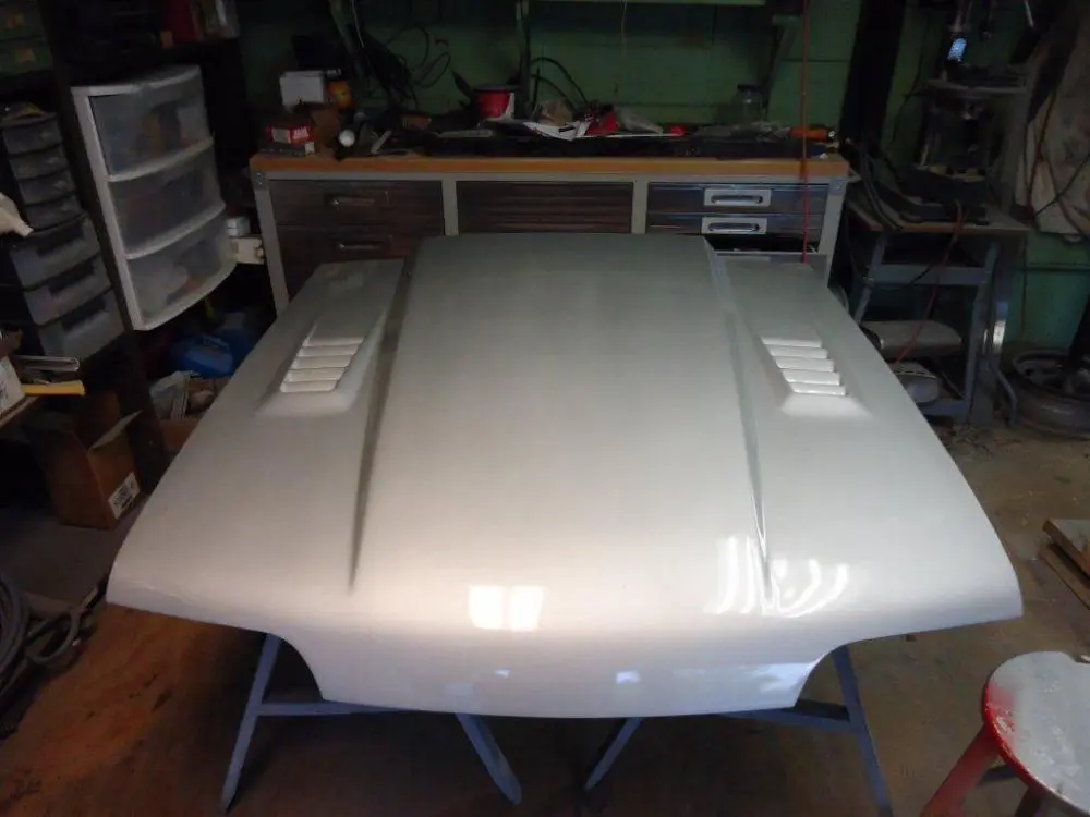

I finally got the spoiler project finished. I took a 05-09 Mustang spoiler and notched out the rear of the pedestals so it can be moved back past the edge of the deck lid. I also ended up making gaskets with a hidden spacer in the front bolt hole to level it to the body. I think it came out great. The hood is next.

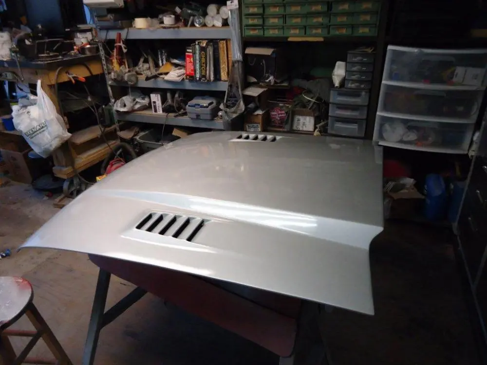

I'm removing the stock hood and installing the cowl hood. I still need to add the mini quik latch hood pins. I also MAY fabricate a screen for the heat exchanger openings.
Looks good. Where did you get the hood?
I looked for almost a year for this hood. I found it on craigslist here in Ohio. It was covered in dirt and primer which hid the damage. It took me many hours to fix it. I'm not sure but I think it's a 2" Kaenen extractor cowl.
