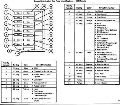

did you check the #2 fuse in the power distribution box under the hood.
