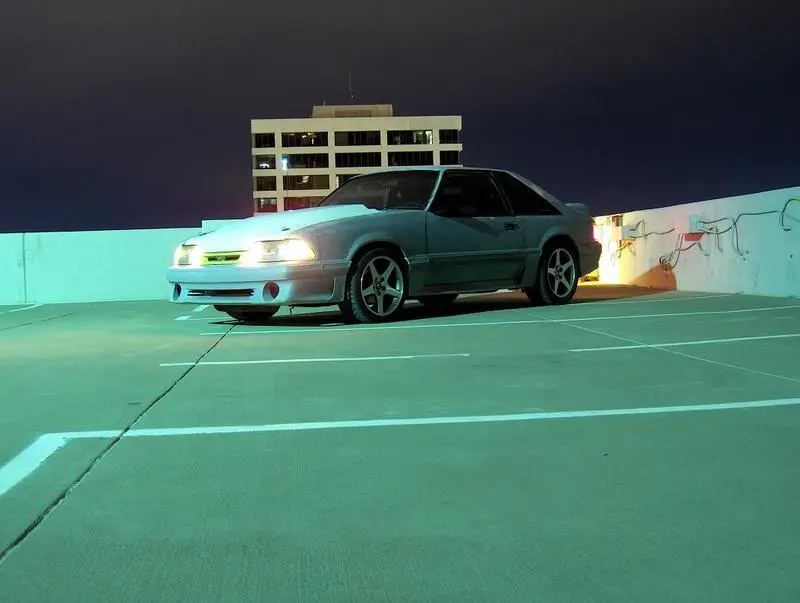

Any pictures of teh car to go with the dyno sheet?

the heads are 192cc's on the intake, right now the car has shorties on it, and the car pulls well to 5500 after that its all down hill
