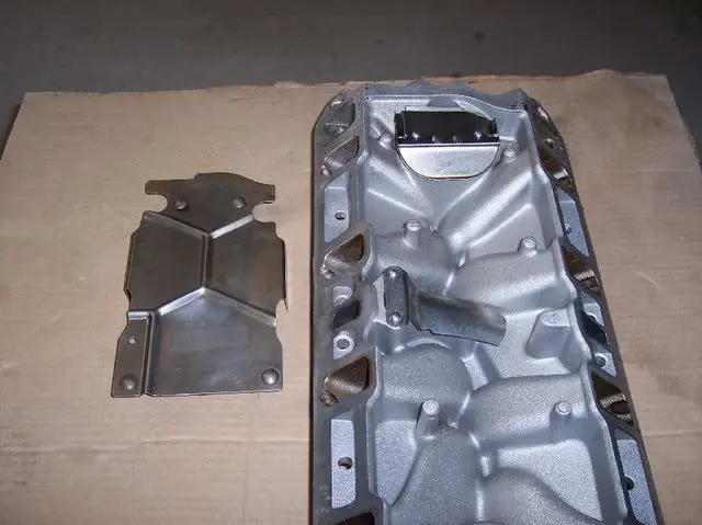

My Explorer intake lower . . .
I dare to say it mignt be a Chinese Cobra lower...
EDIT: does it have the little baffle?
I'm not sure what baffle you're talking about, this is this first explorer intake that I've seen up close, didn't know there was a chinese version of the gt40 . . . is this a good or bad thing? Gt40's are slightly better than explorer intakes, right? Also, the flanges on the upper where the bolts go through don't match up perfectly with the lower . . .
The GT40/Cobra/Explorer lowers are all the same, its the uppers that make the difference. The Chinese Cobra intakes have quality issues and oil consumption problems from what I heard.
The Explorer intake has one large baffle like the one laying off to the side in the pic.
Looks like someone is going to get bad feedback for incorrectly advertising their itake on ebay . . . that bastard
