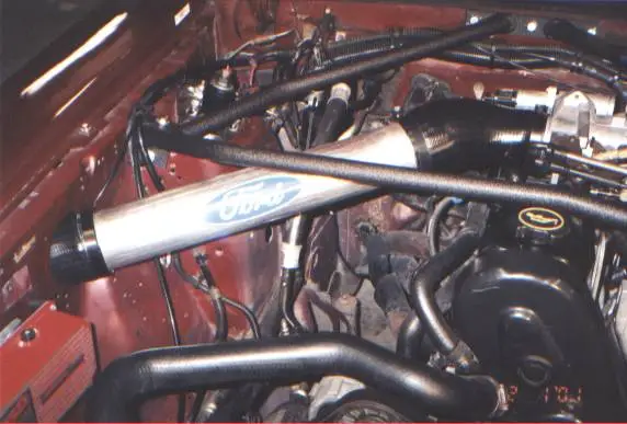

her some pics I think total with supplys 70.00 the most 95TB,pvc,supplys from lowes,Air cleaner from Auto zone And a flex Intake house of a 91' pontiac bonneville or what ever you can modify.
Plus an hour give or take. I have had no problem sucking up water runs alot better air flow wise seems a little something there!!!! But i also have a gutted upper and TB intake side has been matched to the TB.
I know she looks a little dirty been having crappy weather and can't get nothing done. Going to change tho rig up when i redo the motor. Really wanted to see the difference running it down and better.
The air below is colder then it coming throught the fender well I think!!
Like i said no water problems but i also have my front an inch lower so the bumper helps deflect alot of rain Just can't go through deep puddles..

Looks good, just slow down when your going through those puddles!
really nice cai, if rain is an issue like here in Miami Florida , you can always take the pipe inside the fender , it'll just have to be a smaller filter to try and fit in there , but it looks cool too because there's a holoe on the side where the pipe fits in perfect ! :D either way nice job man !
3.5 inch tubing from a muffler shop looks a tad cleaner imo.
