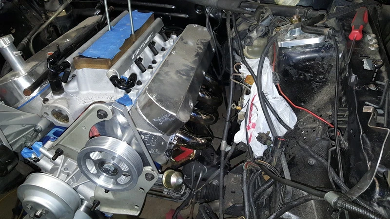

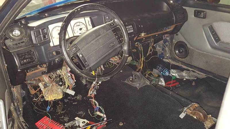

madmike1157 said:
Uhhh I don't know,..... now it makes it easier to see that you have a major ordeal infront of you w/ the wiring spaghetti hanging there. Good luck. I'm glad that part is behind me.
All that will be going into the black dash this week. If I remember correctly everything has a specific/matching place/plug that it should go right into.......I HOPE!! Its been so long since we took the dash out.

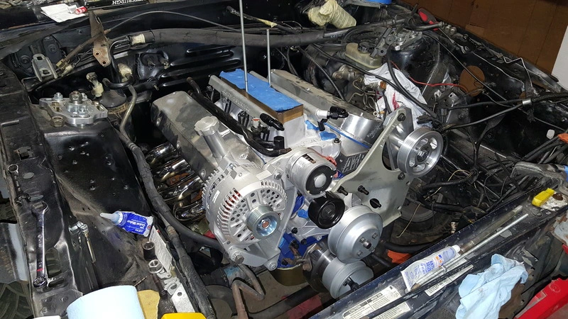

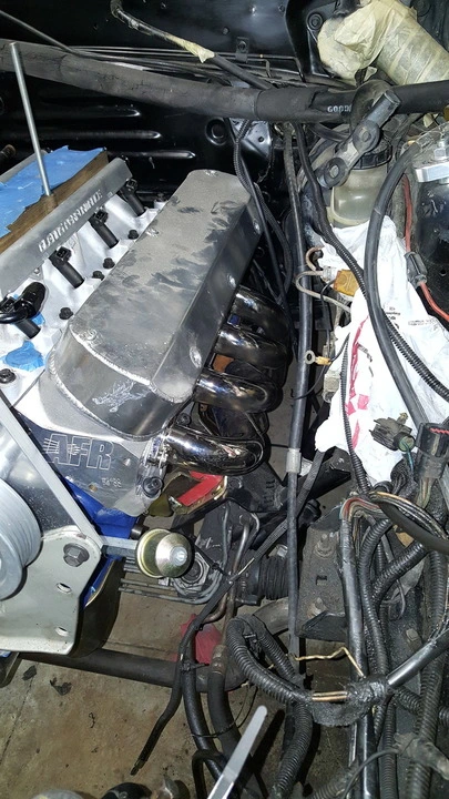

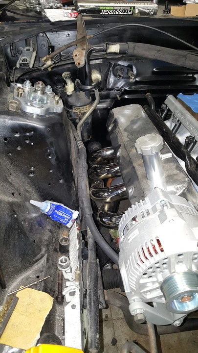

Hey guys! Remember me?
Well, I have a lil update. I don't remember the last update but I've gotten a few things accomplished. Ok so the Dash is in...correctly. We just have to zip-tie a few wires up because the 25 year old tape that was holding it together kinda stopped working. Oh and we have to bolt the fuse panel to the dash frame where it goes. BUT the steering column is in and the dash is mounted.
We installed the headers but the locking header bolts are a headache. So the locks still need to be put on.
Front accessories are mounted. Decided to delete the A/C for now due to my valve covers not allowing to the compressor to fit where it's supposed to be.
Started installing the fuel system. That's not turning out the way it was supposed to. But nothing to lose my mind about....yet. Sorry, no pics yet. The tank is mounted, the line from the tank to the filter is on, and I started running the return line but it's longer than it was supposed to be. This is actually allowing me to mount the regulator wherever I want instead of on the rear of the passenger side strut tower. I think I might put it on the passenger side firewall right in front of the strut tower.
And look what Santa brought!
Front accessories look good.. I'll just tell ya right now,....Santa didn't check if there's a noise ordinance in your state. Cause if there is, you'll be in violation with those babies.
I live in New Orleans. They don't give 2 s hits about noise or smog tests....yet. Plus, I think my car qualifies as a "Classic" now so it would probably not be subjected to those tests anyway.

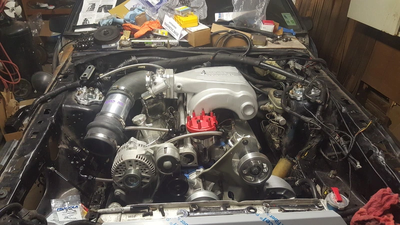

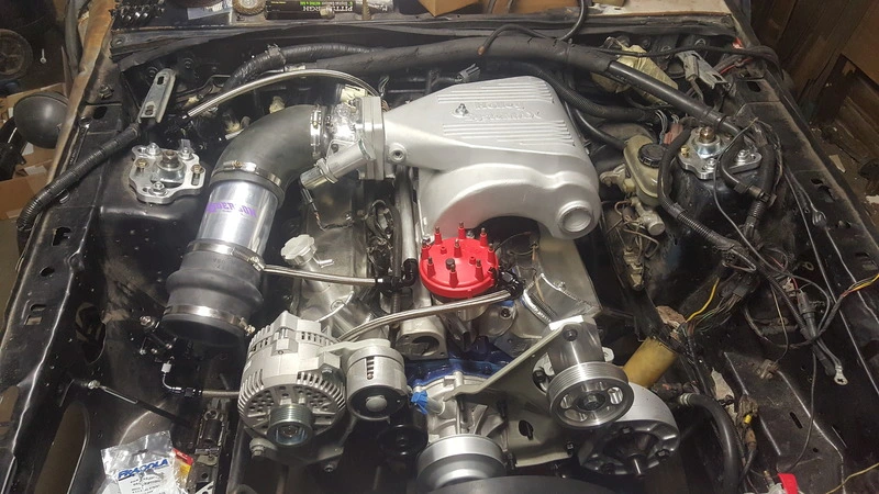

Made a little progress...
I still have a lot of little things to do:
Mount and/or wire:
starter
alternator
fan
Install:
Vacuum lines
T-stat and waterneck
hoses(radiator, heater)
battery
put the chip in the computer and mount it
grounds
steering shaft and tighten all steering components
We are pushing to start it no later than next Thursday. Then I have to get the exhaust done and the rearend RE-done.

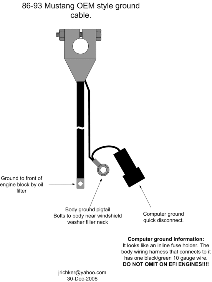

@jrichker can you post a schematic of all the grounds under the hood of a fox body mustang so I can make sure I I don't miss any grounds? I bought new grounds straps but I know there are more that have to mounted to other parts of the block. I'll do a search on how to wire in the starter with my existing solenoid under the hood. Thanks!

I don't have a diagram of all the grounds, but I will post a list of what to look for...
Grounds
Revised 28-Oct-2012 to add signal ground description & possible problems if it is bad
Grounds are important to any electrical system, and especially to computer controlled engines. In an automobile, the ground is the return path for power to get back to the alternator and battery.
Make sure that all the ground places are clean and shiny bare metal: no paint, no corrosion.
1.) The main power ground is from engine block to battery: it is the power ground for the starter & alternator.
2.) The secondary power ground is between the back of the intake manifold and the driver's side firewall. It is often missing or loose. It supplies ground for the alternator, A/C compressor clutch and other electrical accessories such as the gauges. The clue to a bad ground here is that the temp gauge goes up as you add electrical load such as heater, lights and A/C.
Any car that has a 3G or high output current alternator needs a 4 gauge ground wire running from the block to the chassis ground where the battery pigtail ground connects. The 3G has a 130 amp capacity, so you wire the power side with 4 gauge wire. It stands to reason that the ground side handles just as much current, so it needs to be 4 gauge too.
The picture shows the common ground point for the battery , computer, & extra 3G alternator ground wire as described above in paragraph 2. A screwdriver points to the bolt that is the common ground point.
The battery common ground is a 10 gauge pigtail with the computer ground attached to it.
Picture courtesy timewarped1972
Correct negative battery ground cable.
3.) The computer's main power ground (the one that comes from the battery ground wire) uses pins 40 & 60 for all the things it controls internally: it comes off the ground pigtail on the battery ground wire. Due to its proximity to the battery, it may become corroded by acid fumes from the battery.
In 86-90 model cars, it is a black cylinder about 2 1/2" long by 1" diameter with a black/lt green wire.
In 91-95 model cars it is a black cylinder about 2 1/2" long by 1" diameter with a black/white wire.
You'll find it up next to the starter solenoid where the wire goes into the wiring harness.
All the grounds listed in items 1,2 & 3 need to bolt to clean, shiny bare metal. A wire brush or some fine sandpaper is the best thing to use to clean the ground connections.
4.) All the sensors have a common separate signal ground. This includes the TPS, ACT, EGR, BAP, & VSS sensors. This ground is inside the computer and connects pin 46 to pins 40 & 60, which are the main computer grounds. If this internal computer ground gets damaged, you won't be able to dump codes and the car will have idle/stall/ performance problems
5.) The O2 sensor heaters have their own ground (HEGO ground) coming from the computer. This is different and separate from the O2 sensor ground. It is an orange wire with a ring terminal on it. It is located in the fuel injector wiring harness and comes out under the throttle body. It gets connected to a manifold or bolt on back of the cylinder head.
6.) The TFI module has 2 grounds: one for the foil shield around the wires and another for the module itself. The TFI module ground terminates inside the computer.
7.) The computer takes the shield ground for the TFI module and runs it from pin 20 to the chassis near the computer.
See http://assets.fluke.com/appnotes/automotive/beatbook.pdf for help for help troubleshooting voltage drops across connections and components. Be sure to have the maximum load on a circuit when testing voltage drops across connections. As current across a defective or weak connection, increases so does the voltage drop. A circuit or connection may check out good with no load or minimal load, but show up bad under maximum load conditions. .
Voltage drops should not exceed the following:
200 mV Wire or cable
300 mV Switch
100 mV Ground
0 mV to <50 mV Sensor Connections
0.0V bolt together connections
Extra grounds are like the reserve parachute for a sky diver. If the main one fails, there is always your reserve.
The best plan is to have all the grounds meet at one central spot and connect together there. That eliminates any voltage drops from grounds connected at different places. A voltage drop between the computer ground and the alternator power ground will effectively reduce the voltage available to the computer by the amount of the drop.

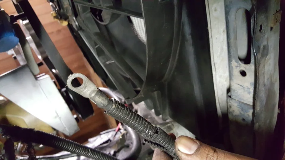

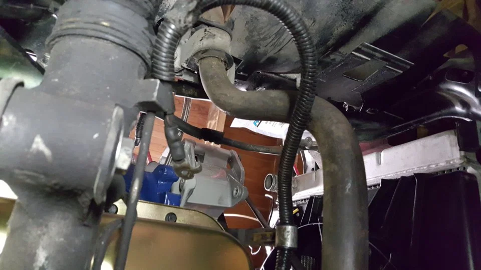

Is this eyelet supposed to attach to the motor mount bolt for ground?
...and does this of that connect to the left post of the starter solenoid?
