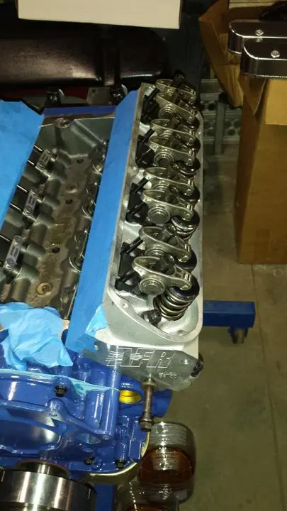

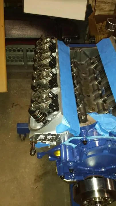

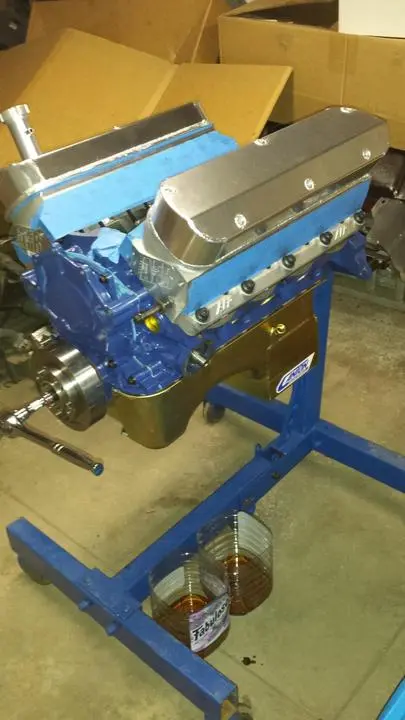

I finally got some pushrods! Installed them and set my rockers last night. I'll finish closing up the rest of the top of the motor next week. OH....and since I had to take 1 of the heads off for the process of measuring for pushrods I checked how far in the hole my pistons are and I was able to get an accurate calculation of my compression. I'm at 9.77:1 so it may not be as much of a dog as I was originally expecting. :banana:
I also got my bellhousing and a few other brackets powder-coated. I forgot to take pics of them last night so I'll have pics of those next time. I also have to chase the threads for the oil filter adapter and the oil pressure sending unit port in the block. The filter adapter just wouldn't screw in smoothly but I also have to get a large allen wrench to screw it in all the way. But the oil pressure sending unit port has paint in it and the sending unit extension wouldn't screw in past the first thread....the paint is THICK in there. Oh and I ordered my MGW shifter today. :banana:
Well here are a few pics.

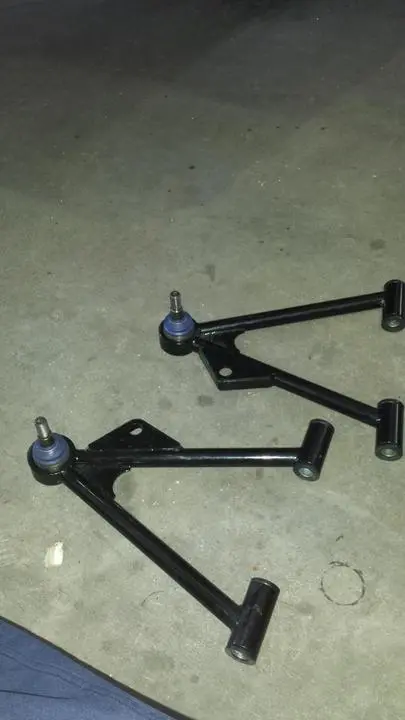

Oh, and I changed the ball joints on my A-arms to 94-95 ball joints. It's so easy when the A-arms are off of the car and you have a press. I've NEVER changed ball joints that quick!.

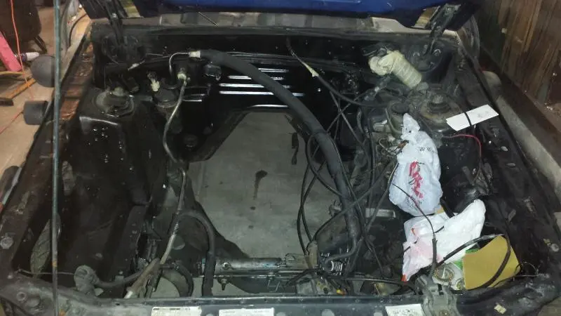

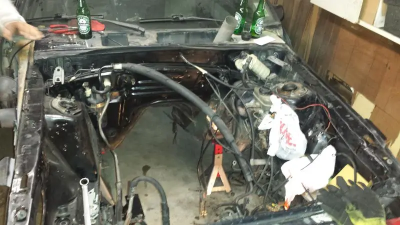

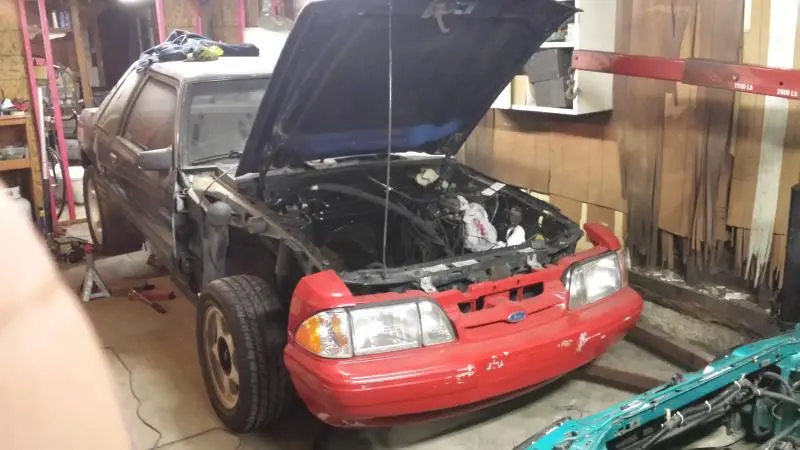

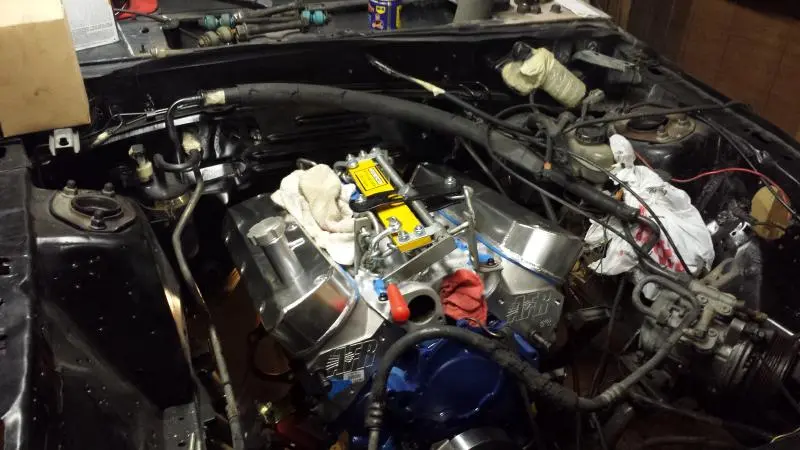

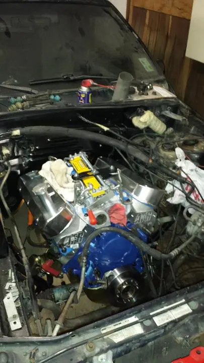

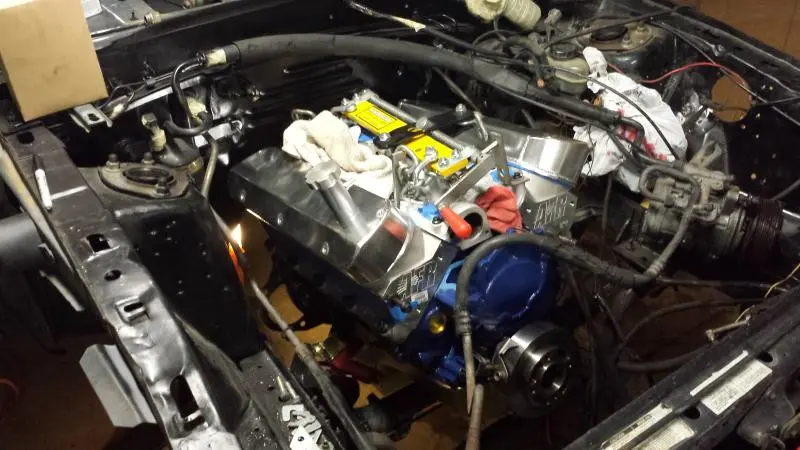

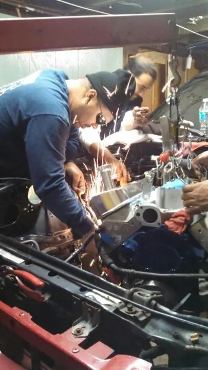

Made some progress on MY car finally. We removed the stock front suspension and installed the UPR k-member...no, the a-arms are not in yet. We dropped the motor in last night, not without some grinding on the k-member tho. o_O The little nipple on the motor mount didn't go into the second slot on the k-member so this was me last night
Now, here's my concern about that. I don't know anybody that has had to grind on a UPR k-member just for the motor mounts to fit. So I'm wondering if the k-member is the correct one for the car. This was the only fitment issue I've had so far but I can't deny that I'm slightly concerned. This is not the time to start having problems like this because the car has to be running, tuned and street worthy by March 19th. My whole purpose for the push to get the car done right now is to have it at TX2K15. Anyway, I have a few more pics of the progress.
Stock front suspension in:
Stock front suspension out:
Motor in:
Hopefully I'll be able to get back over there so I can put the tranny and the headers in.

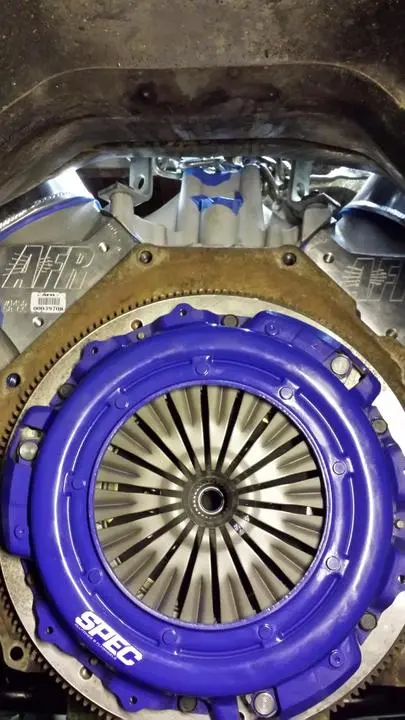

Ok so I ran into another issue. I installed the flywheel, clutch, and bellh......WAIT A MINUTE!!!! Why won't the bellhousing go all the way on?
WTF!!!! The flywheel is too BIG????? I swear, if it ain't 1 thing it's something else. :nonono: So I placed ANOTHER order(I ordered about $500 in other stuff earlier that day) with LMR at 12:20am for a new SPEC flywheel. 1 more thing to slow down progress. :mad:

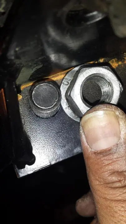

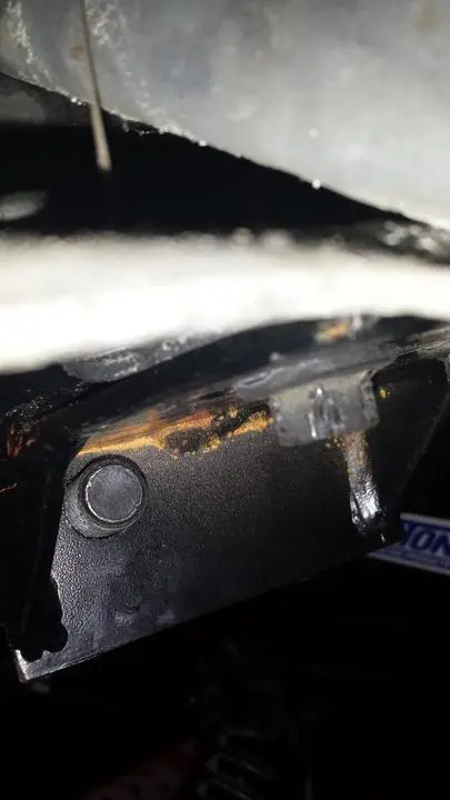

Yeah, I've never heard of anybody having this issue with UPR k-members. I already have it set in my mind that I'm going to purchase a UPR k-member from UPR....not somebody selling one on Craigslist. The reason I trusted it was because all the other parts like the coilover parts and spring were UPR so I just assumed it was the mild steal k-member from UPR because its black and that's the color of the mild steal ones from UPR.
This shi t is just getting better by the day. Now I have to get a different nut for one of the motor mounts AND 2 of the a-arm bolts because the stock flanged nuts won't fit on this POS k-member.
Not gonna get the nut on that bolt
Here's the nut next to the bolt

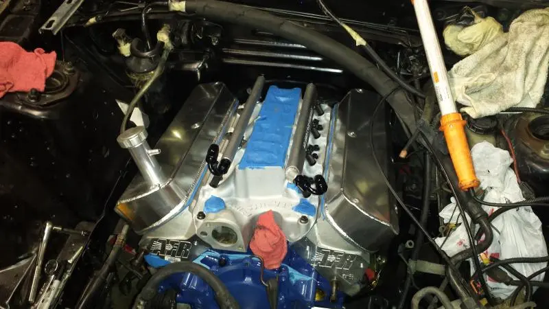

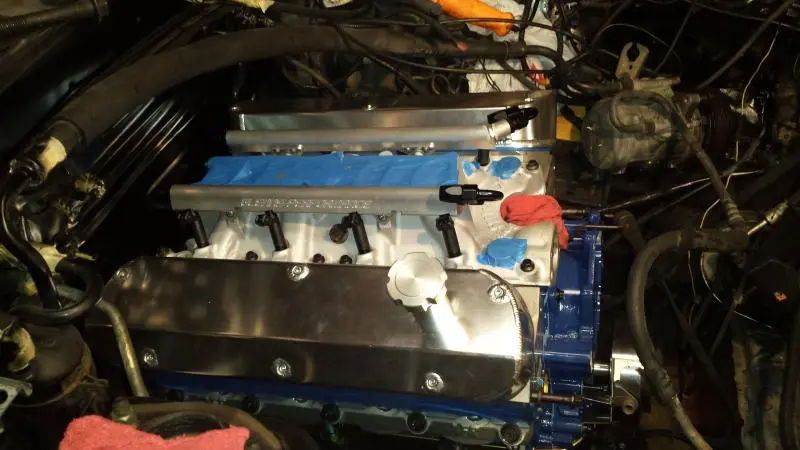

But I did put my fuel rails and injectors on.
