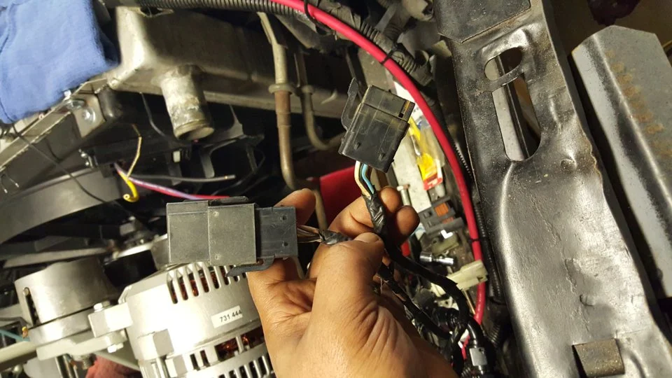

Nevermind, I figured out that that is the starter wire. But I can't figure out what plugs into these 2 white plugs
Also, what relays are these? Will the missing one keep me from starting the car? If so, where can I find one? Will Ford still carry that? @jrichker
one white plug is the ECT sensor, the other white plug goes to the Evap Valve for the carbon canister.
The purge valve solenoid connector is a dangling wire that is near the ECT sensor and oil filler on the passenger side rocker cover. The actual solenoid valve is down next to the carbon canister. There is about 12"-16" of wire that runs parallel to the canister vent hose that comes off the bottom side of the upper intake manifold. That hose connects one port of the solenoid valve; the other port connects to the carbon canister.
The purge valve solenoid should be available at your local auto parts store.
Purge valve solenoid:

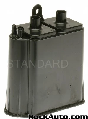

The carbon canister is normally mounted on the passenger side frame rail near the smog pump pulley.
Carbon Canister:
One relay is for the A/C - every relay is available at any well stocked auto parts store
The other connector goes to the stock 65 amp alternator
Carbon Canister:
http://www.stangnet.com/mustang-forums/threads/3g-alternator-install-a-how-to.646825/#post-6673702
ECT meaning Engine Coolant Temp? If so, that can't be it because that sensor is on the heater tube and there's not enough slack for that plug to reach it and I already have a plug plugged into that sensor. Also is the carbon canister absolutely necessary to have on the car? I took it off when I started this build thinking I wouldn't need it anymore.

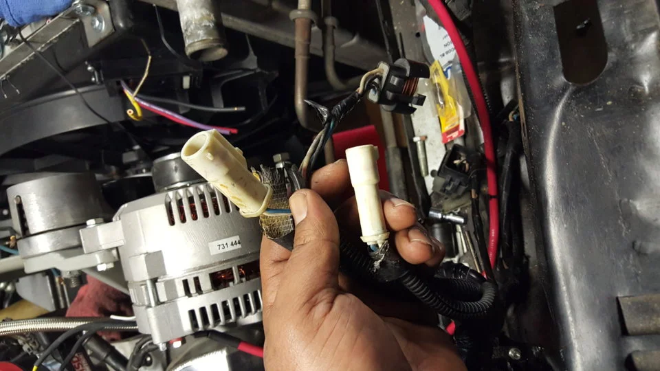

What color wires are on the offending connector?
If you don't want the car stinking up you and your garage the carbon canister is a must have.

I'm not where my car is right now but from what I can see on the pic it looks like a white wire and a light blue wire on both.
If I vent the tank to outside it will still have the inside of the car stinking of gas fumes? Is it really that bad? Do you have a pic of how all the lines go to and from the canister so I can see if I still have all that stuff....which I don't think I do?
