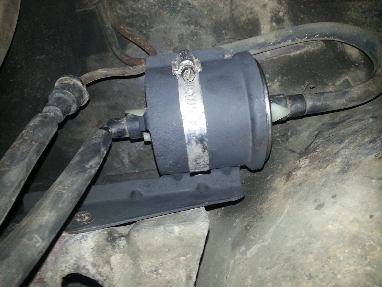

Hey Guys wanted to give an update. Everything is back to normal I did some double checking and cleaning yesterday and here is what I found out:
  • NGKs where not spaced properly, swapped them out for my Motocrafts I spaced (and re spaced) The tips on those NGKs all had a white film on them (not sure if that's significant)
  • Checked my MAF, Cleaned it with a Q-Tip and some MAF cleaner (rubbed the wires, didn't break one thankfully :nice:)
  • Check my connections on my CIA (all fine)
  • Changed my fuel filter, pretty sure this helped a lot because this thing looked like it had not been moved since 1989 (Pictures attached)
Once I got all that done I started back up and it ran much better. Still has a bit of a timing issue but its nothing like before. It is smooth and I think everything will time up perfectly now.
I will get the car timed and check the codes ASAP.
Thanks for the help guys!

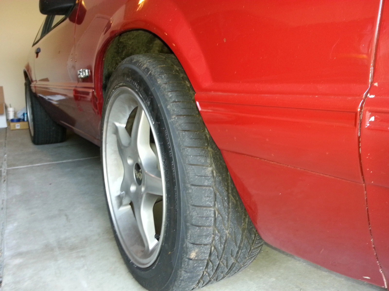

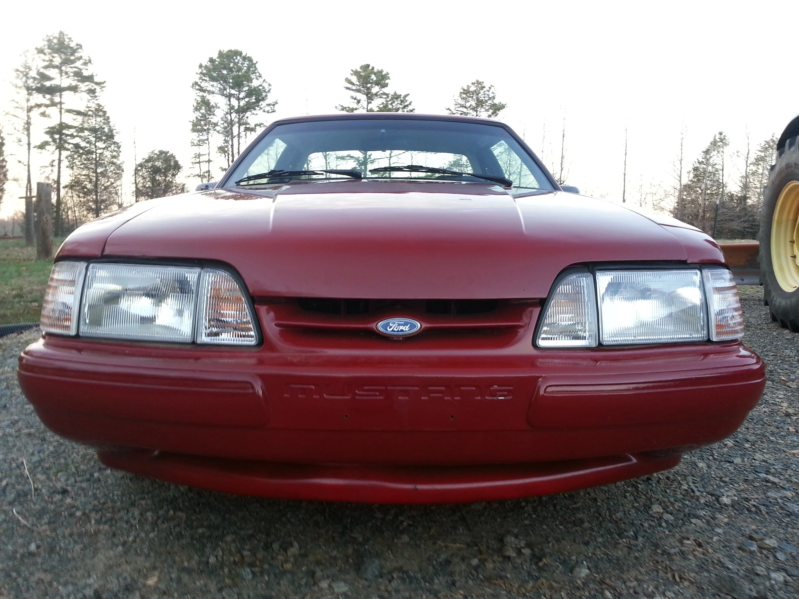

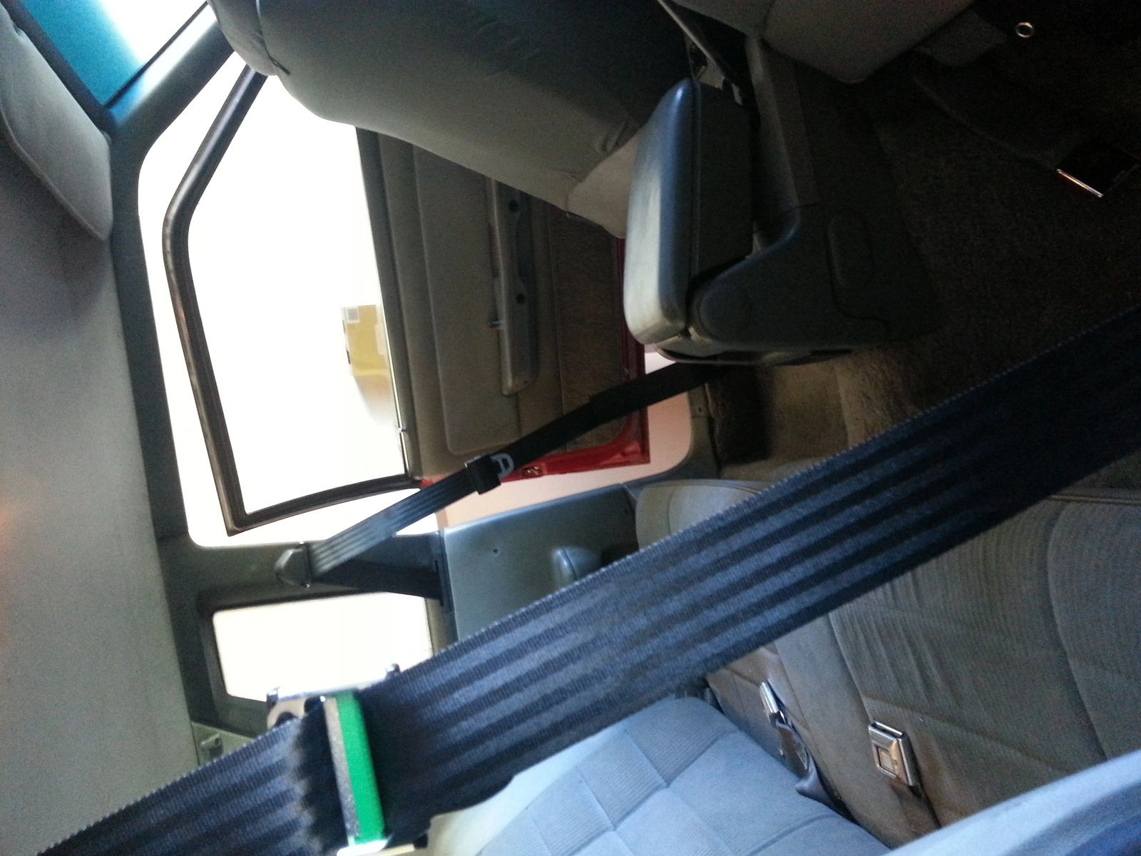

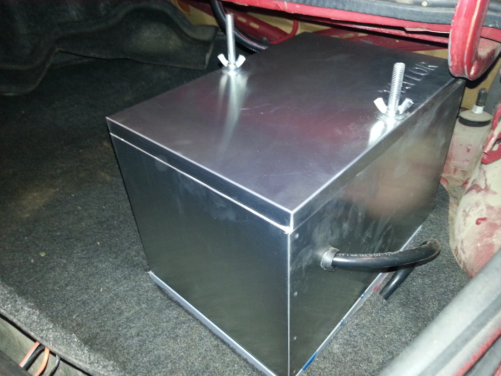

Hey Guys,
Its been a while so I wanted to give an update on my project.
  • Got all the simple stuff cleaned up on the car - Fuel Filters, Timing, Changed out all the fluids, Etc....
  • Got some New OEM Headlights
  • New front seat belts for safety
  • Set of New Nitto Motivo Tires
  • Took my new battery (that was not secure in the engine bay) and put it in the trunk thanks to a Taylor Box
I have been driving the car around and even took it to work a few times. It drives pretty nice on a smooth road, but a suspension overhaul is in this cars near future. The Fox Body does not have any major issues and the 5.0 only leaks oil in the usual spots. It will all get handled in good time but for now I'm just enjoying driving my project around and showing it off :nice:
~Take it easy
20140520_183503.webp 20140520_183132.webp 20131019_163700.webp 20140225_180259.webp 20140503_173006.webp
